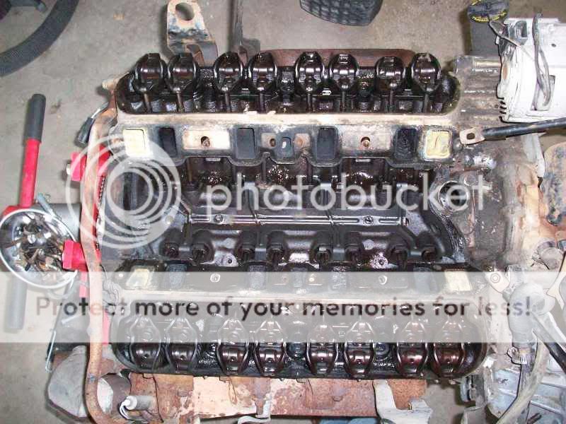

I am pretty sure the ports in the center are below the intake/water ports on the E6 and E7 heads I have played with. There is a small port in the center of the head that collects carbon. I think it has something to do with EGR.
The water ports are only at each end of the heads, there is nothing in the middle that should be wet.
Here is my engine right after I ripped the stock intake off, it is newer than yours so maybe they changed those ports between here and there. The white ports at each end of the heads are for coolant.
