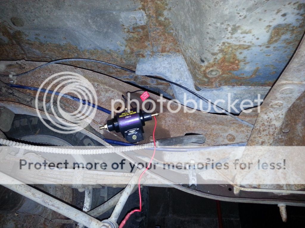

Yeah I put it all together last night, I'm not 100% sold on the setup I did as it has to many spots to leak. What I have done I am going to run with till it's all up and running and then redo it.
Just the pump mounted
Plumbed

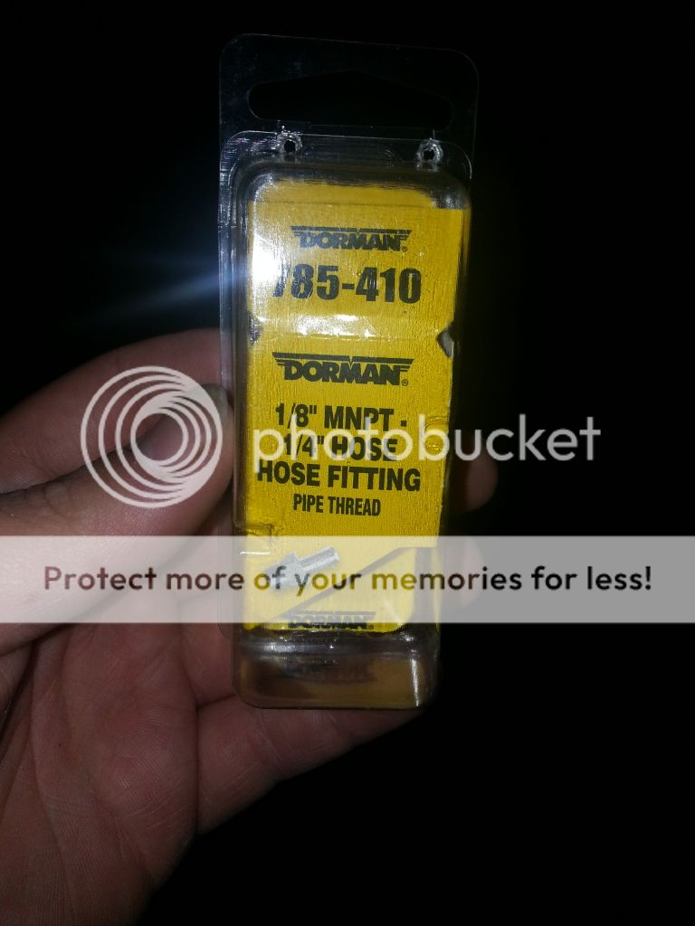

That's the exact way I pictured the filter setup to be, even that exact filter.
What size is the threading on the barb?
Sent from my rooted SPH-D710 using Tapatalk 2
I didn't trust the nylon inside a hose. I turned down two brass barbs, rammed them in the nylon and then clamped them.
You have a lot more going on there then I did, my frame is straight. :icon_twisted:
It is a little small, I have another slightly bigger one I am going to switch to
Yeah, almost couldn't find a suitable spot for it lol
