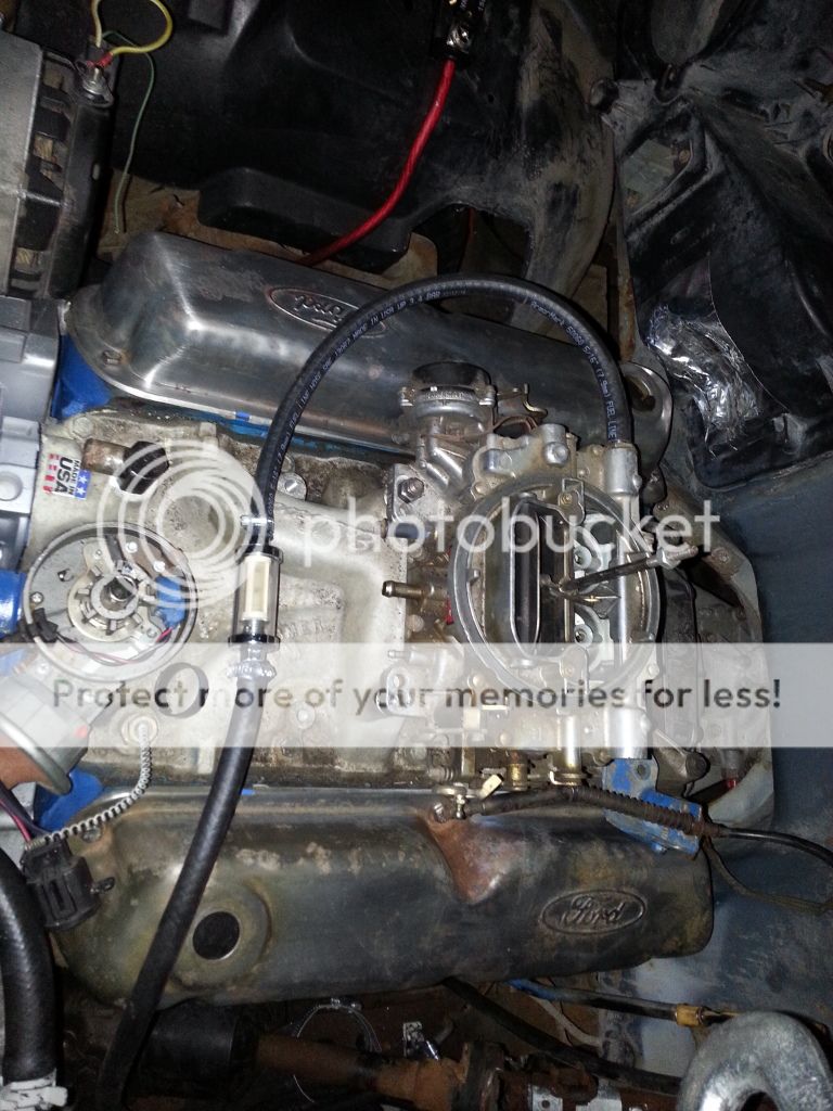

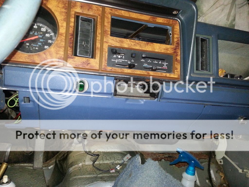

Got the fuel system all done, got the pump wired to a switch in the cab and it finish plumber. Got the exhaust manifolds all bolted up with gaskets. I need get all the gas currently in the tank as I don't think it is any good after 1.5 yrs. I can't get my t case in myself because that SOB is f-ing heavy, so I have to wait till Thursday or Friday for my brother to help me. Really what's holding me back right now is money, it's not easy to buy stuff when you only have $30 in your bank account lol.
Where I mounted switch, don't think the cigerette light worked anyway, I'll prolly wire in a fuel cut off later down the road.
How the fuel system sits in the engine bay.

Should use a relay setup that turns on when your key is on but not when cranking.
I had my fuel line over my intake till recently. I move it along the fire wall to keep some more of the engine heat off of it.

The relay setup is a good idea, I'll have to look into that. Currently it is wired to a switched 12v. The fuel line across intake isn't permanent, and I just remember I should prolly get a fuel pressure regulator.
