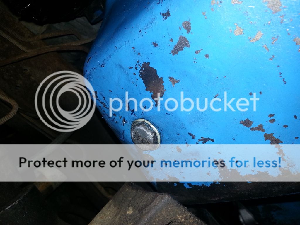

While bolting the engine mounts down, I was surprised to see that the rear oil drain bolt isn't going to interfere with the ttb bracket like everyone said it would.

You must have got your engine way back to do that, which is fine and a big plus for you.

Yeah I was surprised because I didnt think I got it that far back, guess I did.

I think a lot of it is probably how the body is sitting on the frame, mine is nowhere near that cherry but I am less than an inch from the firewall.
Or maybe Ford wasn't that picky on how their firewalls were stamped...

Well whatever the reason I'm delighted that it clears it.

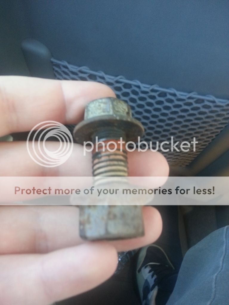

Does anyone know what the size of the bolts are that hold the transmission crossnember to the frame?
This is the bolt.
I don't remember, IIRC they were metric...
Better question, what size drill bit do I need to use, to drill an adequete hole for one to pass through?

Drill a new hole and use a new bolt.

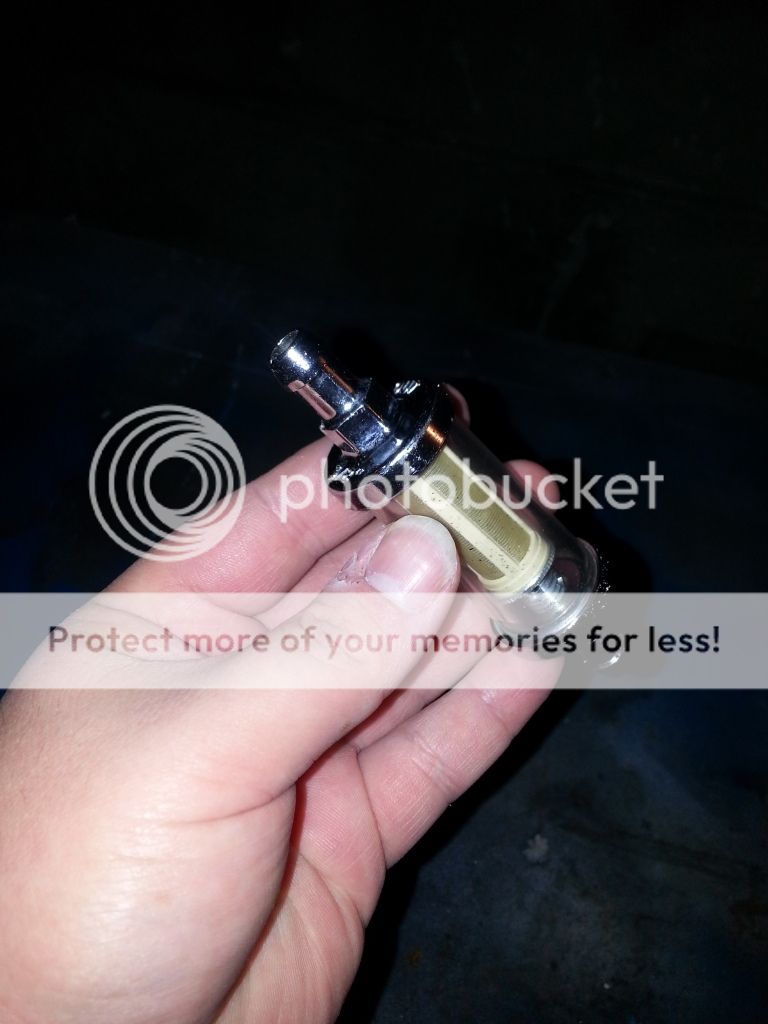

Ugg hate how much time school takes up. Anyway, got new holes drilled in the frame for the transmission cross member. Got the cross member put in and bolted down and the transmission bolted down. Tomorrow I am going to try and get the fuel pump plumbed in. Question about the filter, I've seen a couple people reccomend to ditch the filter that comes with the pump (Mr gasket 12s) and use a different aftermarket one. Is there a specific reason for that? Is it just a terrible filter?
I found a different aftermarket one from my buddy that I'm going to use.

Adobe say to put a nipple fitting in the filter location so and put a length of house on that and the filter on the hose. Make for changing the filter much easier and you can use about any filter of your choice.

I used the filter that came with the pump on the pump and put an inline filter behind the carb. I just used a plain Wix steel can inline filter.
Well the plan is to use just a small barb where the filter would go on the pump and use the one I found from my friend before the carb. Think that would mess something up?

I don't think it would hurt a thing, I plan on doing the same thing one day. But be sure to run a folder before the pump. I run a clear filter before my carb. My filter on my pump didn't need replaced but it's recommended to change it every year anyways.
