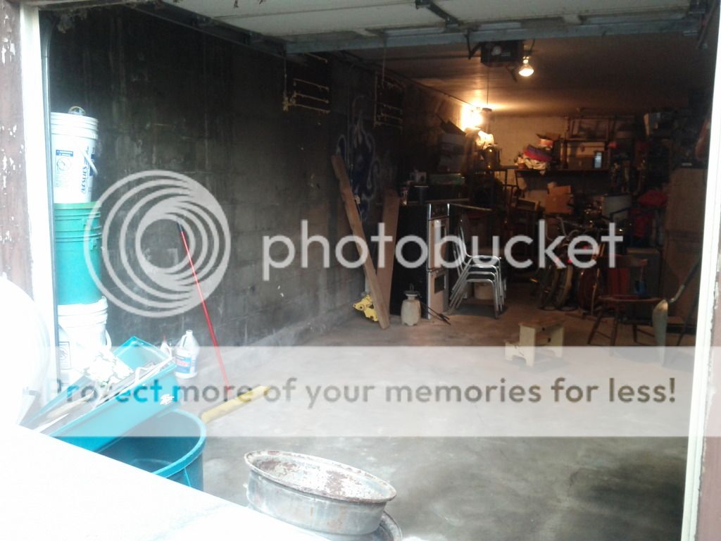

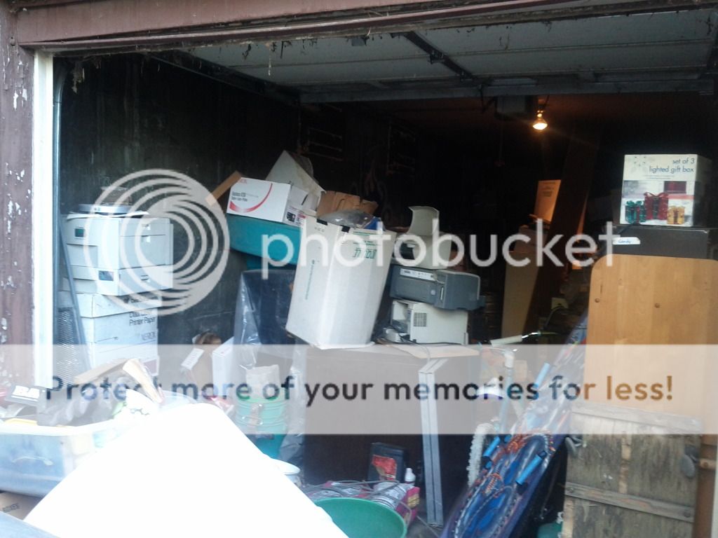

Not much to add, bought a power steering bracket from 85_Ranger4x4, also finally got a place to work on my truck. After 5 days of hard work, i cleaned my garage :yahoo:
Before:
Twister 85 B2 Build
After:
Twister 85 B2 Build
:yahoo::headbang::yahoo::yahoo:

So you had a place to work, you just didn't have it cleaned out.

Good deal on getting the garage cleaned out, that makes everything easier. :icon_thumby:

Yeah i had the place, but it took a 16 cubic yard dumpter to use it, now just to get my brother to ditch his 87 E150 :D
It was a good feeling finishing it, it has sat like that for atleast 13 years, it took me about 30-35 hours over the last 5 days to get it done.
