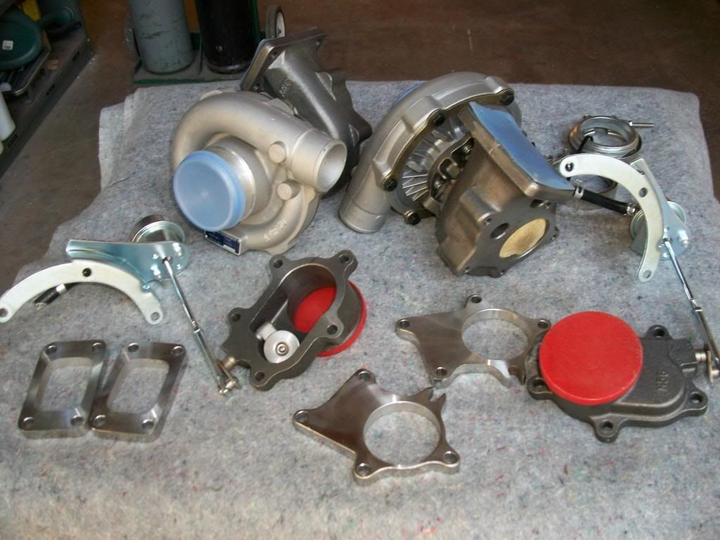

So, I figured this was a good deal ($250 + free shipping) and I get kinda impatient and just do things so... I bought em. Hope they work =)
It will work, the problem is not if, but how long. Thats another reason I was suggesting the GT45. They tend to last alot longer than the t3/t4s. Seams like the most I have really heard of with them is 15,000 to 25,000 and thats with good ones. Make sure you have the oil return on the turbo's figured out right off the bat.
10-4 on that, I hear you, oils the life blood. I was planning on doing a oil reservoir, everything I can to keep them healthy. I will likely upgrade in a year or so the turbos and my motor once I feel confident in my turbo tuning. I have another motor I'm rebuilding for that time and ill keep my ears out for upgrades as I get my truck dialed in.

Got any info about timing under boost? So far I've got my turbos, walbro inline, arleromotive 13301, wg's and bov, fuel lines and fittings. At the momment Im relocating a Bronco II tank to where the spare goes to make room for plumbing behind the cab.
