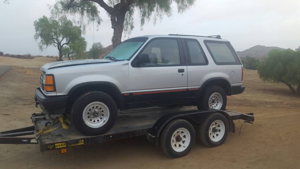

thank you that really clears up a lot for me and I hope it answers somebody else's questions later on down the road. maybe one day ill give this a shot but i just scored on a 92 explorer sport 4.0 4x4 with a 5 speed manual transmission for $300. found a dana 44 ttb for $100 with manual hubs out of a 85 bronco and still have the full width 8.8 from my f150. I'm sure I'll have more questions soon but I feel like most are answered in your previous post. I'm gonna start a build thread and show personal progress im looking to follow the og 94 explorer build thats on dezertrangers.

Looks like it has some damage to the front, but great score nonetheless for $300.
That thing should be pretty wicked with a 5.0L in it. Good luck with your build. :icon_thumby:

yea the front right had some damage hints the price but the drivetrain and interior are almost perfect
5.0 will be sweet one day but for now im just gonna focus on suspension
