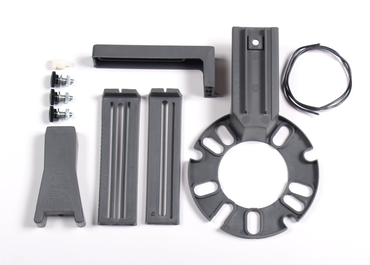

trial-and-error, maybe stick some foam rubber to the inside and see how much room you have.
I was trying to measure the back spacing last night on the stock 14s and it looked to be around 4 inchs or less. I couldn't get a good measurement because I didnt have anything short enough to sit on the back of the rim but i have time today so I'm going to double check that today.
Thanks! Doesnt have the best reviews but looks like most figured it out anyway so I'm sure I could figure it out. 70 dollars is a small price to pay when looking at a set of 4 wheels for 750 dollars haha.
There's pricier units out there, but I'm sure for everything but an all out stance nation style setup and the millimeter accuracy they require this would do just fine.
