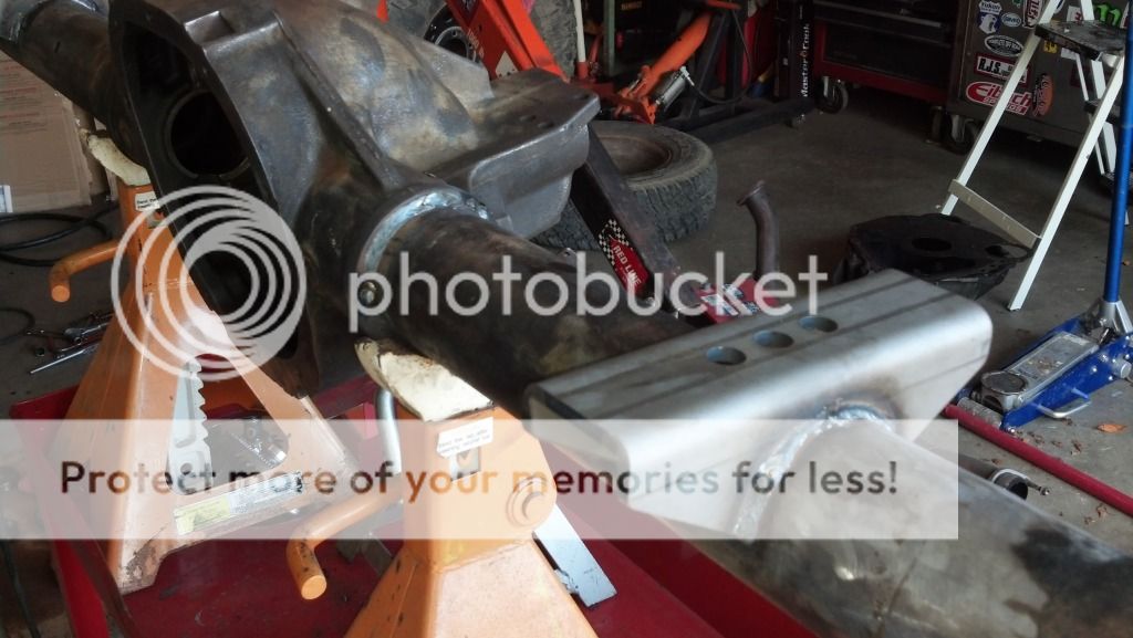

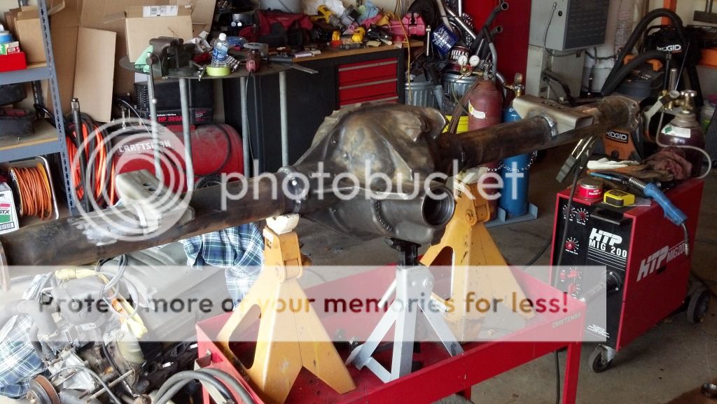

Looks like I am keeping the rear drums. The axle tapers down too soon and the axle flanges would need to be turned down to fit the rotors. But at least with the drums I will be able to keep the parking brake, and that will be a big plus with the manual trans swap.
Also the shafts I have are wore down too much where the bearing rides. Pulled two sets at the JY this morning and they had the same problem. Looking at the 1541 shafts that broncograveyard sales, looks like a good deal.
I have used repair bearings in a few axle builds that move the bearing in a tad..
And on my B2 I went with this parking brake and have been very happy with it. Just mounted it where the stock hood release handle was.
http://www.speedwaymotors.com/Park-Lok-Hydraulic-Brake,1970.html
Just ordered some Timken repair bearings from rockauto part # TRP1559TV
I was out bid on one of those barking brakes on ebay last night. Probably just rig up a hand parking brake out of a car that uses cables. And maybe run a hand throttle.
Gregg, look at Dustins thread. He ran into the same problem but found small flange fw 8.8 shafts...
SVT
I was talking about the shafts themselves, the flanges on the fw 8.8 was too big, as in your case, but he did some digging and found smaller flanges shafts for the fw 8.8, what disk brake setup are/were you going with?
