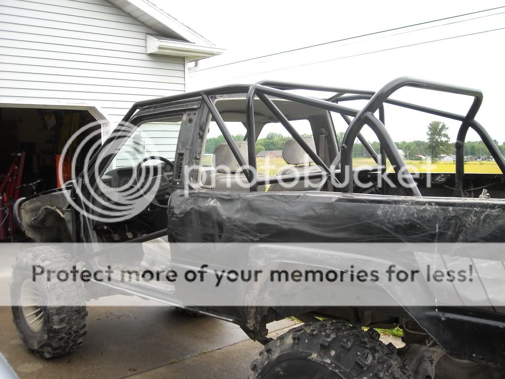

I kept the body and went doorless on my toyota. This is what it looked like before I got rid of it.

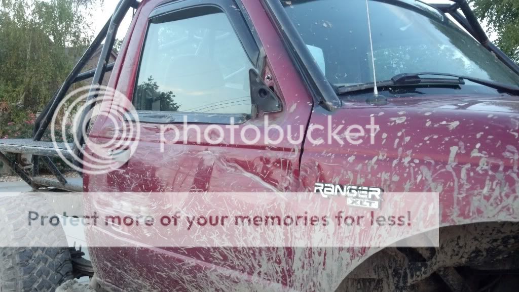

This is the damage to the Ranger last weekend when it bounced into a tree at the top of that hill climb in the video.
That is after I knocked it back out so the window would roll up.

Might look something like this When it is done.
Not a fan, but again, to each their own brother. It will be awesome, there is no doubt about that, but styling tastes differ. As long as it works for ya, that's all that matters
I don't see anything wrong with this. I like it.
Thanks, I don't know why nobody else on here likes buggies:dunno:

Yes! This looks fawking awesome! This is exactly what i was talking about doing.

Fully tubed will be cool, but PLEASE don't make it an f-toy (f-ford?). I have faith that you can build something with more character.
