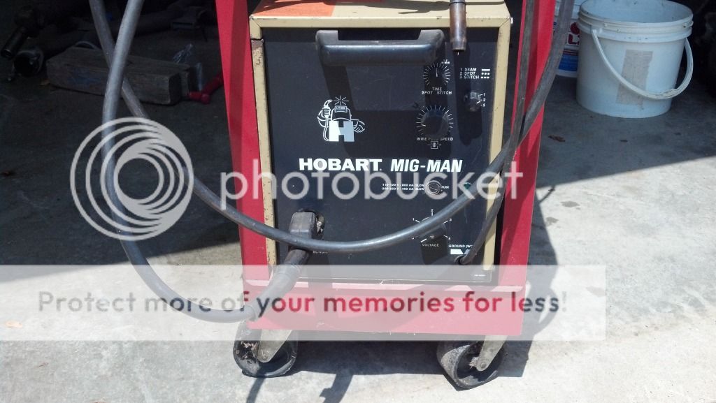

A Hobart Mig-Man welder probably from the 80's

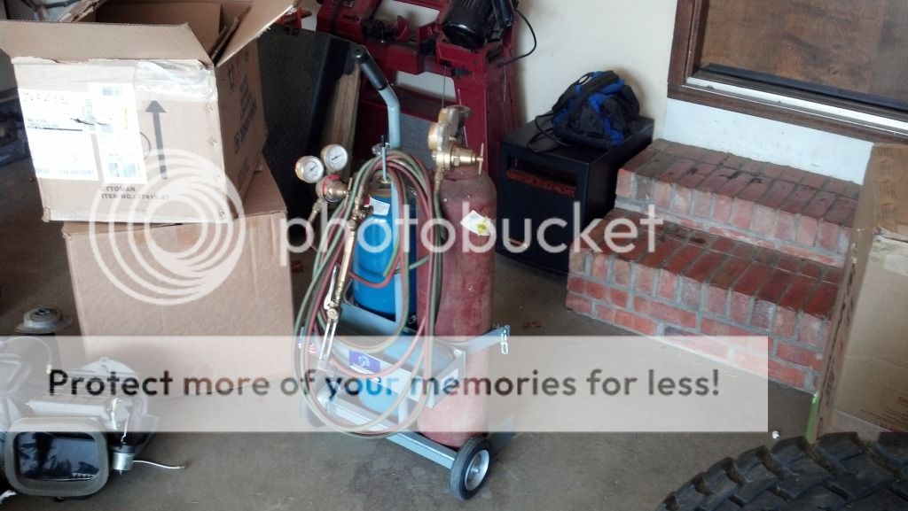

Finally have a torch setup.

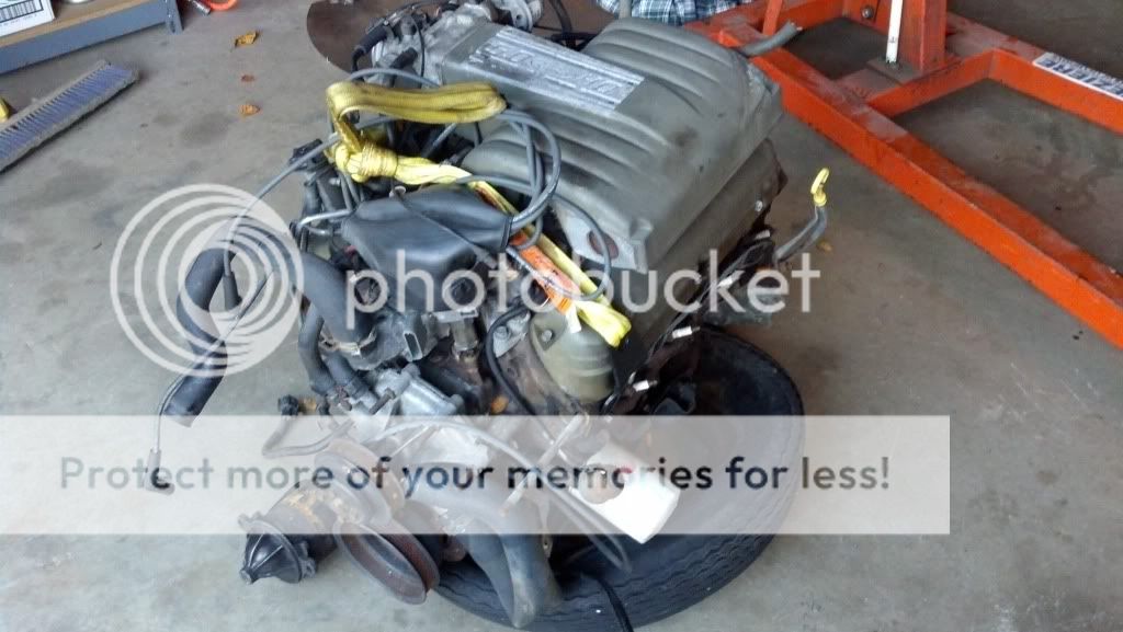

And a Mustang 5.0 longblock.
When cools down tonight I'm going to start cutting the brackets off the fullwidth 8.8 so I can tryout the torch.
sicckkkkk.....looks like well have to play off of one anothers engine swaps :) tranny/tcase choice?????

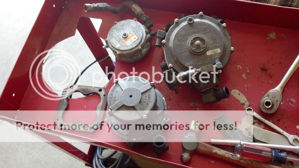

I already have the trans and tc Np435 and a 205. I'm hoping it will be a good combo for the wheelin I do. I will be pulling my intake and ignition for the 5.0 because I'm going propane. So if you need any of those parts let me know.
And the swap might happen earlier then I was thinking. Yesterday I started loosing reverse but I let it cool down and it worked fine after that. But I'm sure it is on it's way out. Won't have those problems with the np435. 4.0 is also loosing power on hill climbs at WOT half throttle it does fine. I don't know what is going on. I'll just keep wheelin it until it quits or the swap is ready.
going with 'pane eh? nice. I need an ECU/MAF/ignition stuff/passenger side valve cover/power steering/alternator brackets....if you have any spares lying around :) ....I have to convert my 88 speed density motor to MAF, and the motor didnt come with any of the ignition stuff....

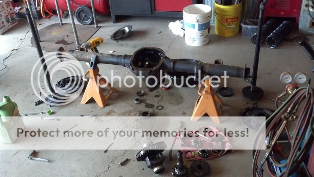

Got the axle stripped down but probably wont mess with it again until Thursday.
nah thats ok man dont worry about it. on another note, I have a set of 8.8 bearings I made into setup bearings, if you want to borrow them.
Nate
I think I have a set but thanks anyway.
Another thing I broke my harbor freight axle shaft bearing puller. I have the receipt but it is about a year old so I hope they will give me a new one. Don't want to rebuild the axle and not change the outer bearings and seals.

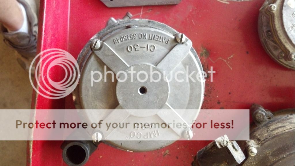

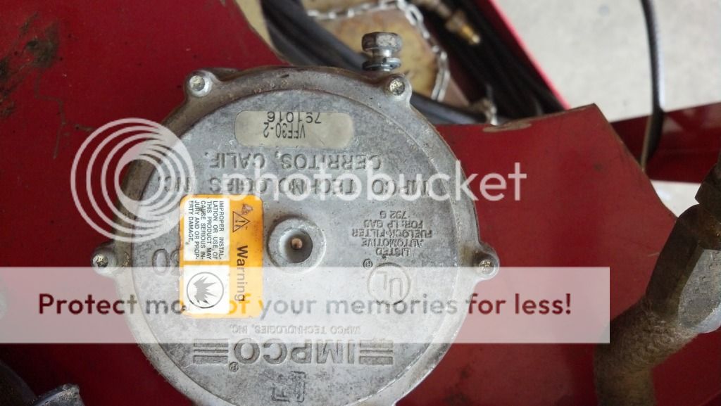

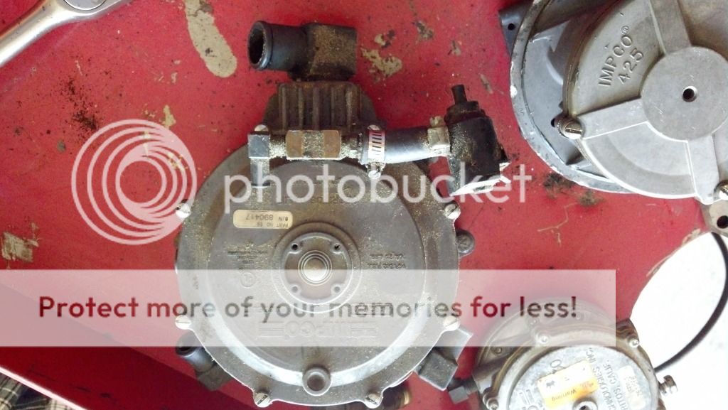

Yeah those are the same parts I would of ordered... I called Nash Propane and they are sending me a complete kit minus the parts I got from you. I know it is hard to believe they would do that but they are and he said they would throw in install and tuning instructions, can't beat that. Oh ha and free shipping.
