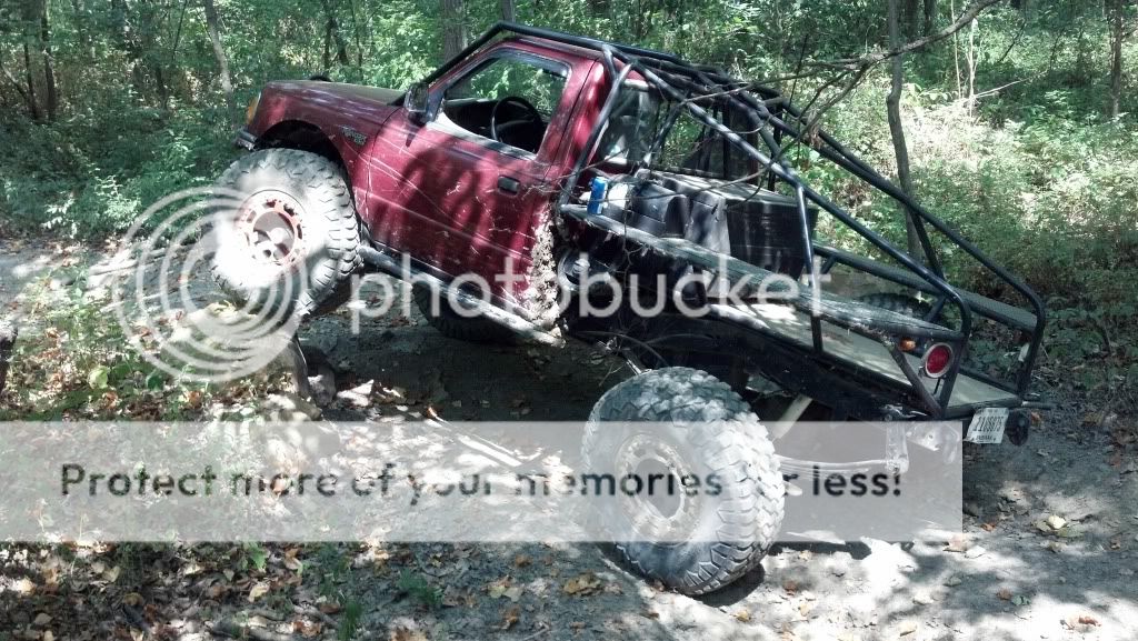

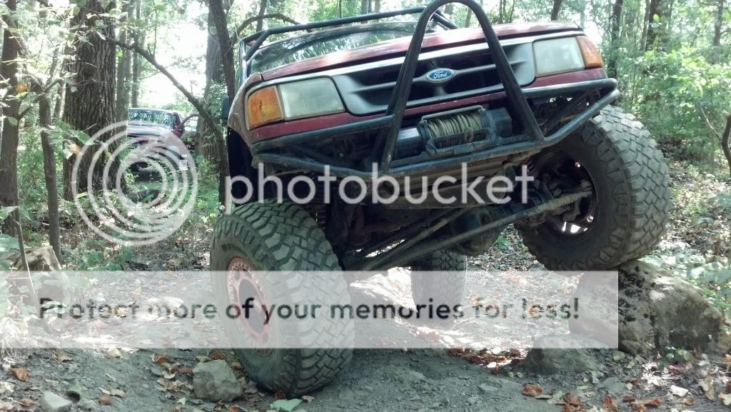

Took the truck out yesterday beadlocks worked great with 10 in the front and 8 in the rear.

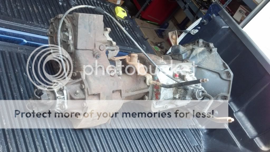

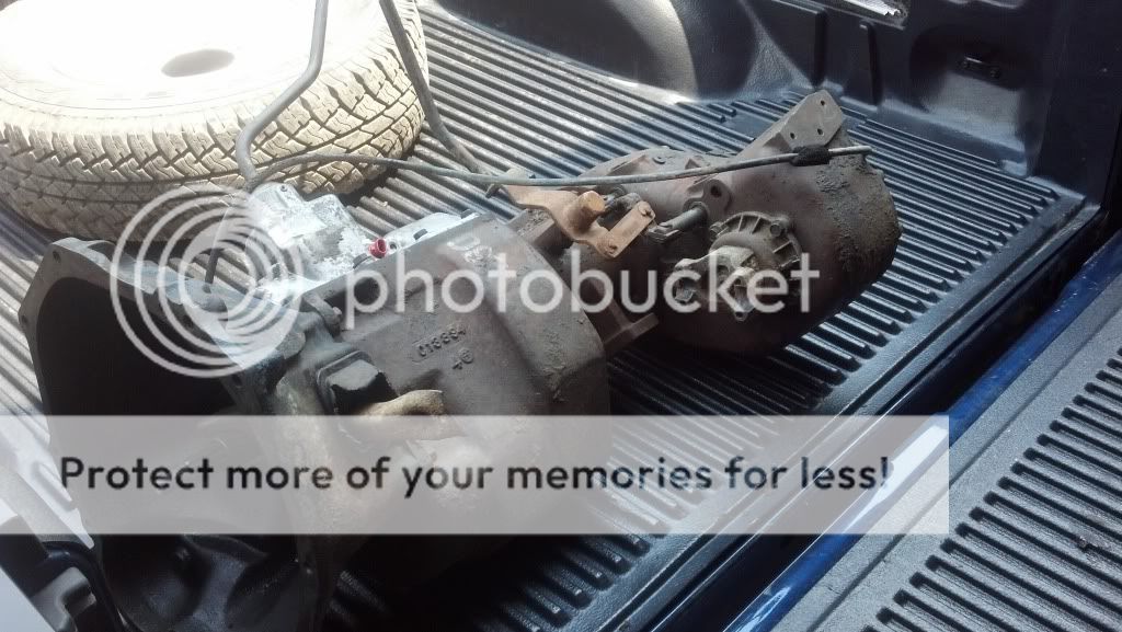

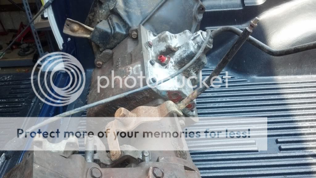

Picked up some parts that will go in this coming winter. np435 and a 205 out of a 79 f250.

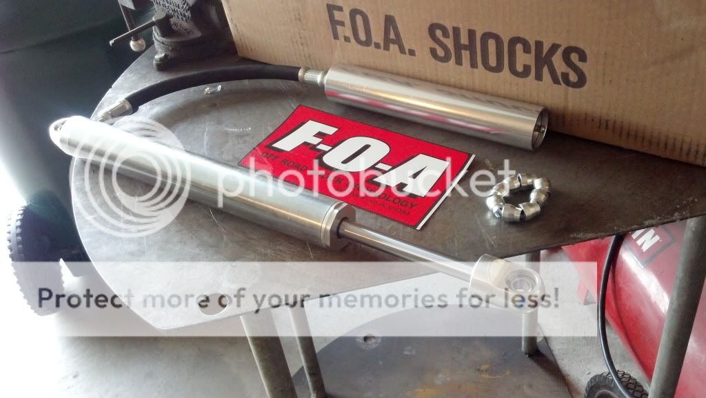

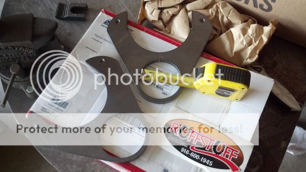

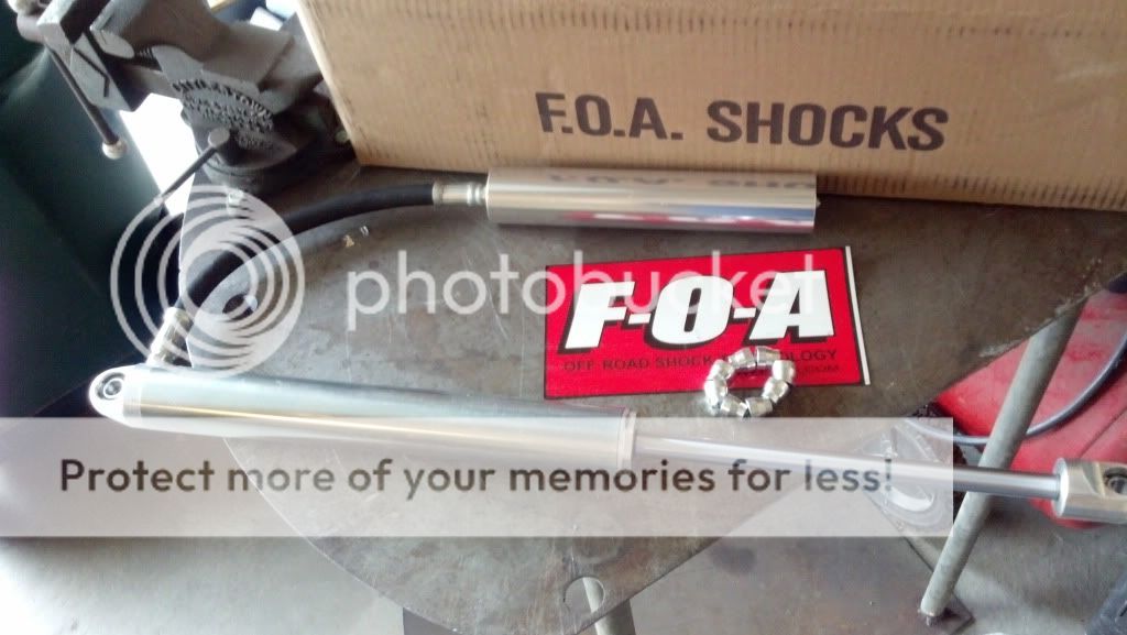

Disc brake bracket will need half the 3.25" circle cut off. And the shocks are 12" travel.

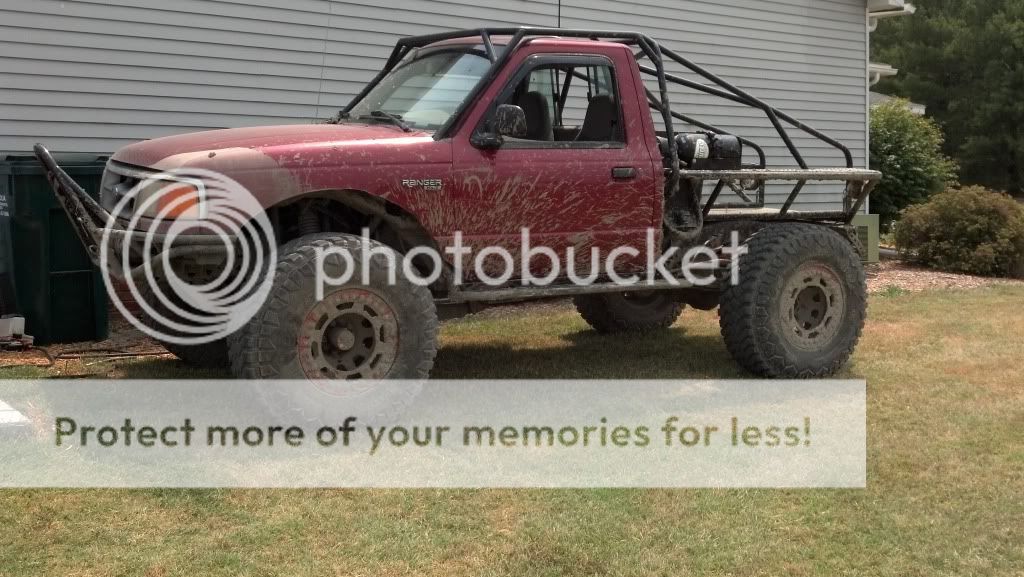

What do you guys think about this idea?
302 with propane(2 barrel got propane kit) and duraspark ignition, np435 trans, 205 with twin stick, ditch the cab but keep the rear tubing and tube out the front.
Also move motor and trans back about 6 inches to keep driveshafts the same length.

I got the np435 so I wouldn't need a doubler. Yeah I might be less likely to wheel in bad weather. And the axle probably will be in before the WBR ride.
Keep the cab other wise it is just another buggy.
It would be a Ford buggy and will have a buggy sooner or later anyway.

I was thinking the same thing but my truck does great. I have looked into building a real buggy and I can't afford it. I figured at least $15,000 and then I would be taking the chance of the setup I build not working any better than the Ranger or worse.
To buggy the Ranger I need seats $500 already have harnesses pedals $0-$250 steering column $0-$250 steel about $400. Total is under $1500 and I know it will work.
