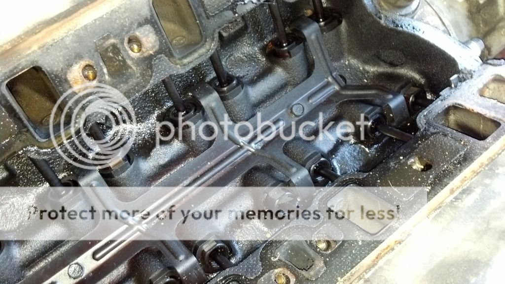

I was surprised how clean it was under the intake.

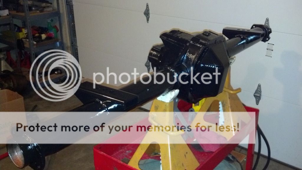

Also got the rear axle painted. But still waiting on parts from rockauto.

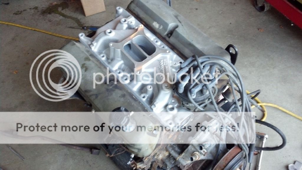

What distributor you put in the motor?

85 carb 5.0 mustang distributor with a steel gear. I'm just going to run the DurasparkII setup, no msd box or anything like that. I want everything simple and reliable.
If you want reliable I would steer far away from the duraspark setup. Those boxes never seem to last too long. I don't know if they don't like shock or vibration or what, but the die, often. If you do go that way at least grab yourself some extras to keep as spares.
