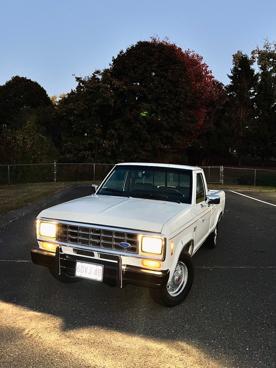

I'm hesitant to buy these without knowing if they will fit, I like the look of the wheels that I have, but I might need to go up a size to 15, much more tire options if I do. Pic of my truck, just because :)
Welcome to TRS.
That is a nice looking Ranger you have, and I like the old steel wheels, too.

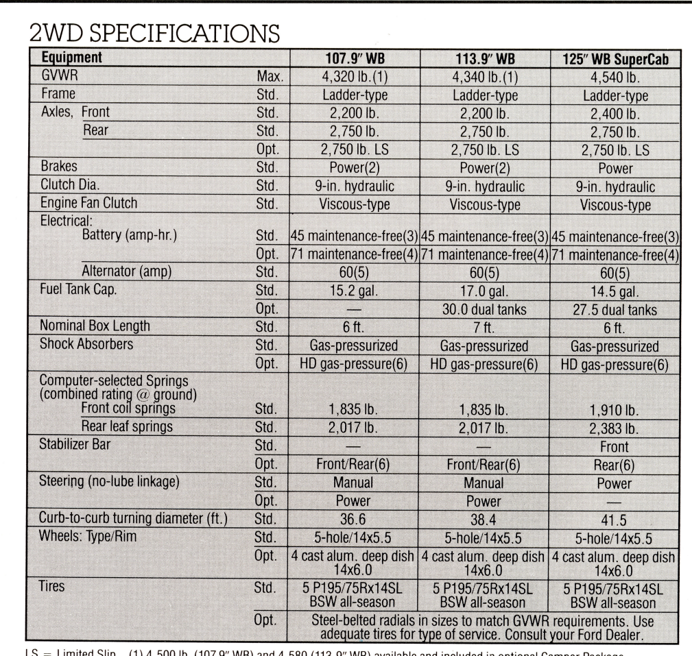

Another possible option I've been considering might be these Goodyear Wrangler AT LT195/75R14 Amazon Link
The salesperson from Tirerack thought these Wranglers would also fit, my local tire installer said they would not. From reading the original brochure for the 1988, it looks like the '88 Rangers came standard with this tire size, and since my wheels are the base standard option, I would assume they should fit no problem... screen shot from the brochure attached for reference.
There are some other cheaper options out there for regular tires, but I would like to get an all terrain tire on the 14s if possible. The Wranglers are pretty pricy for such a small tire, that's my main hesitation for those, and why I'm gravitating towards the General Grabbers.
Not a chance in hell.
I mean technically they would fit, but they'd be smaller than what you have now (which is already small) and way too high in price. I also think that that you'd hate the ride of that 6 ply sidewall.
Personally I think you're messing up by trying to put an AT tire on that truck. You'd be better off sticking with a lighter weight street tire. That truck isn't going to have the power to need ATs anyway. If you take it into mud, the treads are going to get packed, and you wont have the power to spin them and clean them out. The grabbers are going to look like a tiny aggressive tire on a tiny truck that can't use them. The Wranglers are an AT in name only. Functionally they'll be little if any better than a street tire on that truck.
