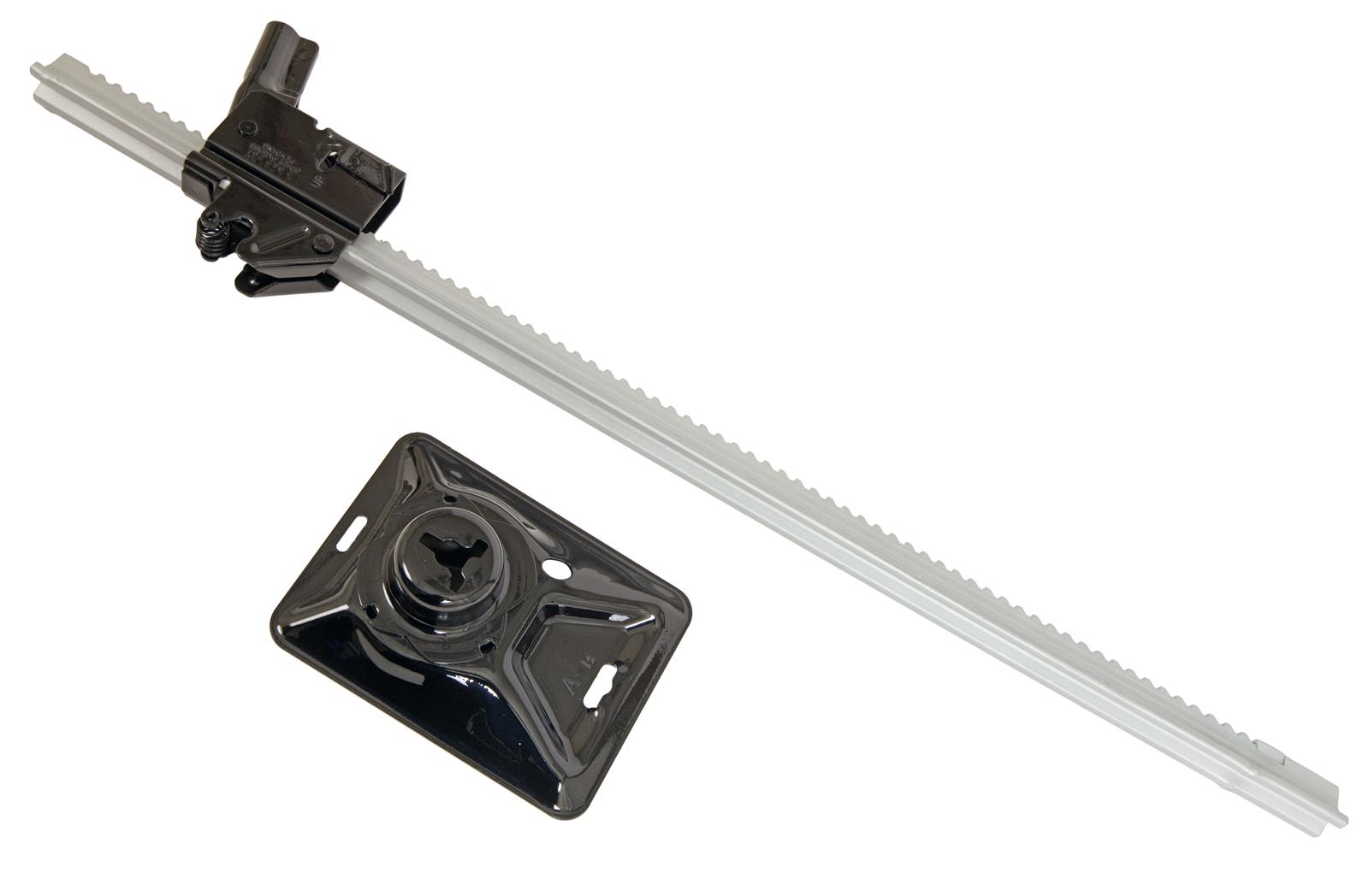

If you think scissor jacks are bad, you're either too young to remember or have blocked the memory of these:
Tire jack replacement suggestions

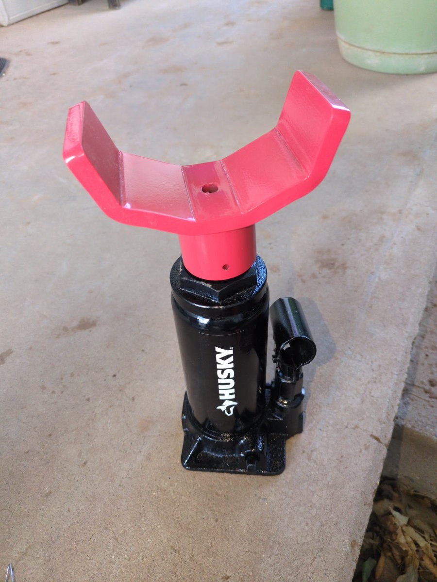

Update: this is what I ended up with.
So for my '99 stock ranger I jacked up the car and measured I needed a good 15", preferably 16" to comfortably change a tire. This was measured on a slightly sloped surface, like when you'd pull off to the side of the road. The salvage yard could not help me, so I ended up with a 6ton husky jack and a "U" bracket which comes with an insert to prevent it from wobbling on smaller jacks like this. Not pictured but also in the car is a piece of plywood to give the jack a better footprint on the dirt.

That looks surprisingly similar to the factory Jeep (85 Cherokee) jack I use. Of course the arch isn't so high and it's a rotary jack.
