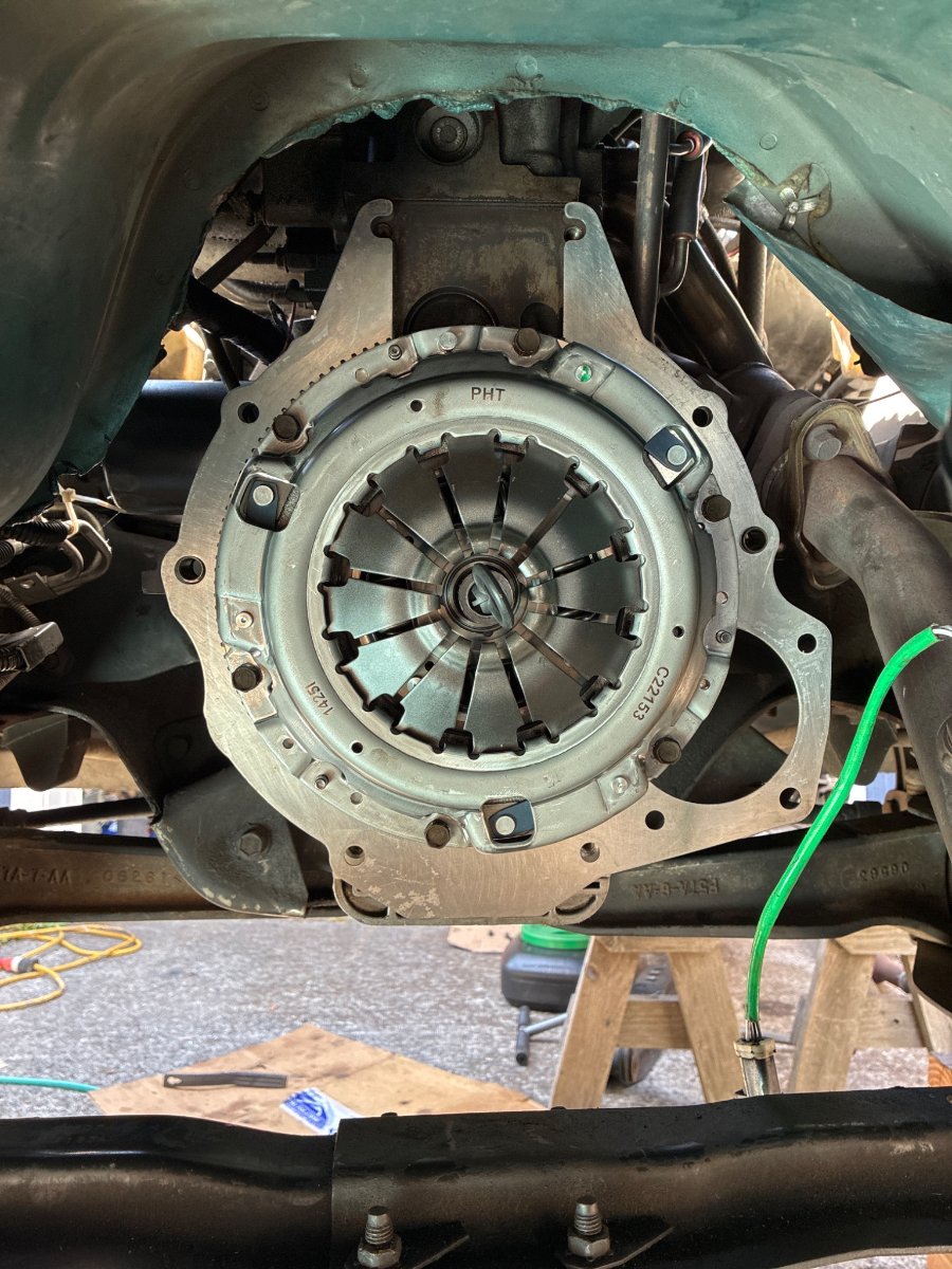

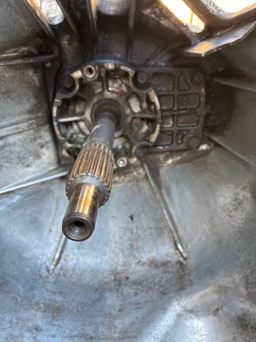

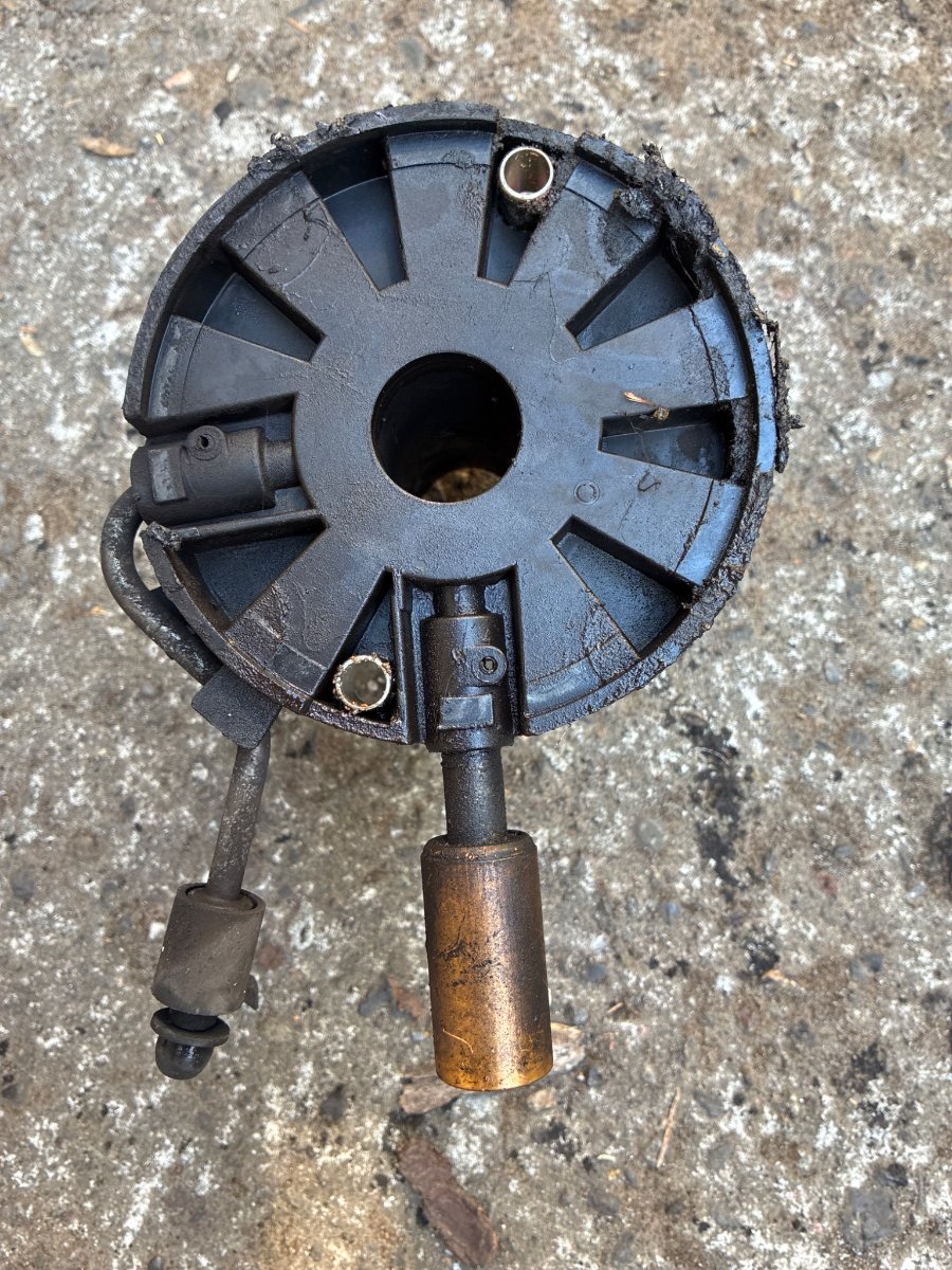

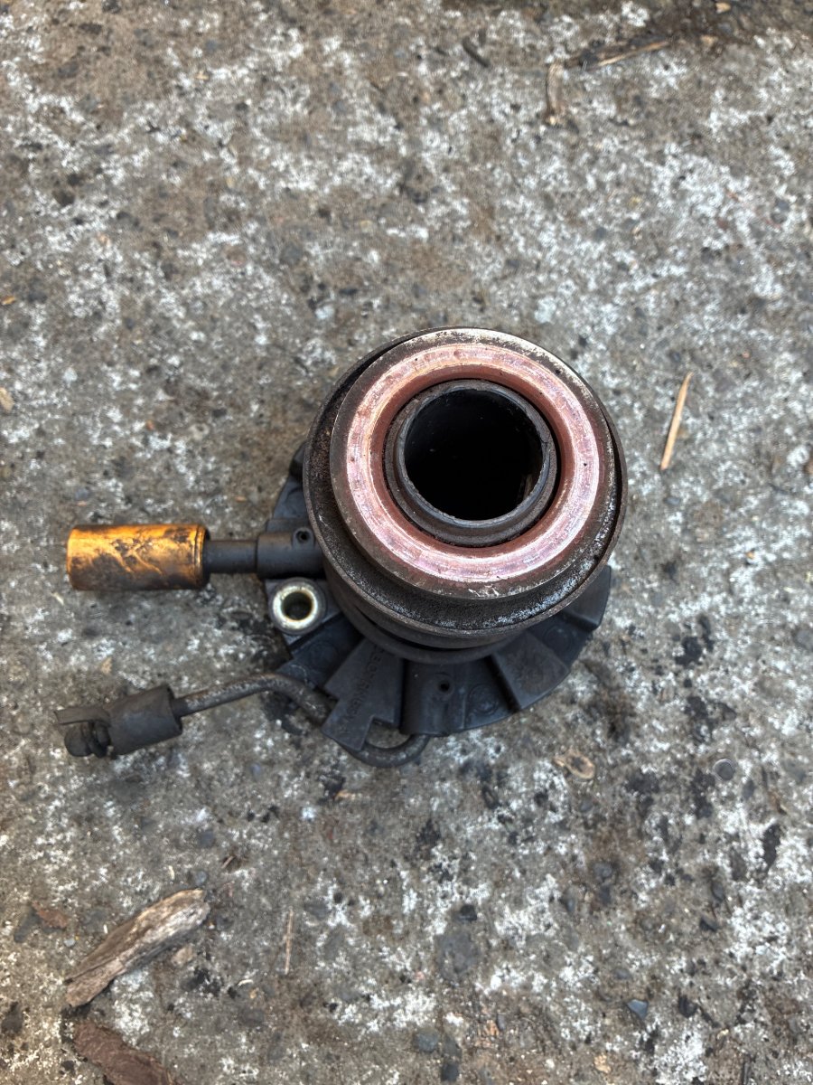

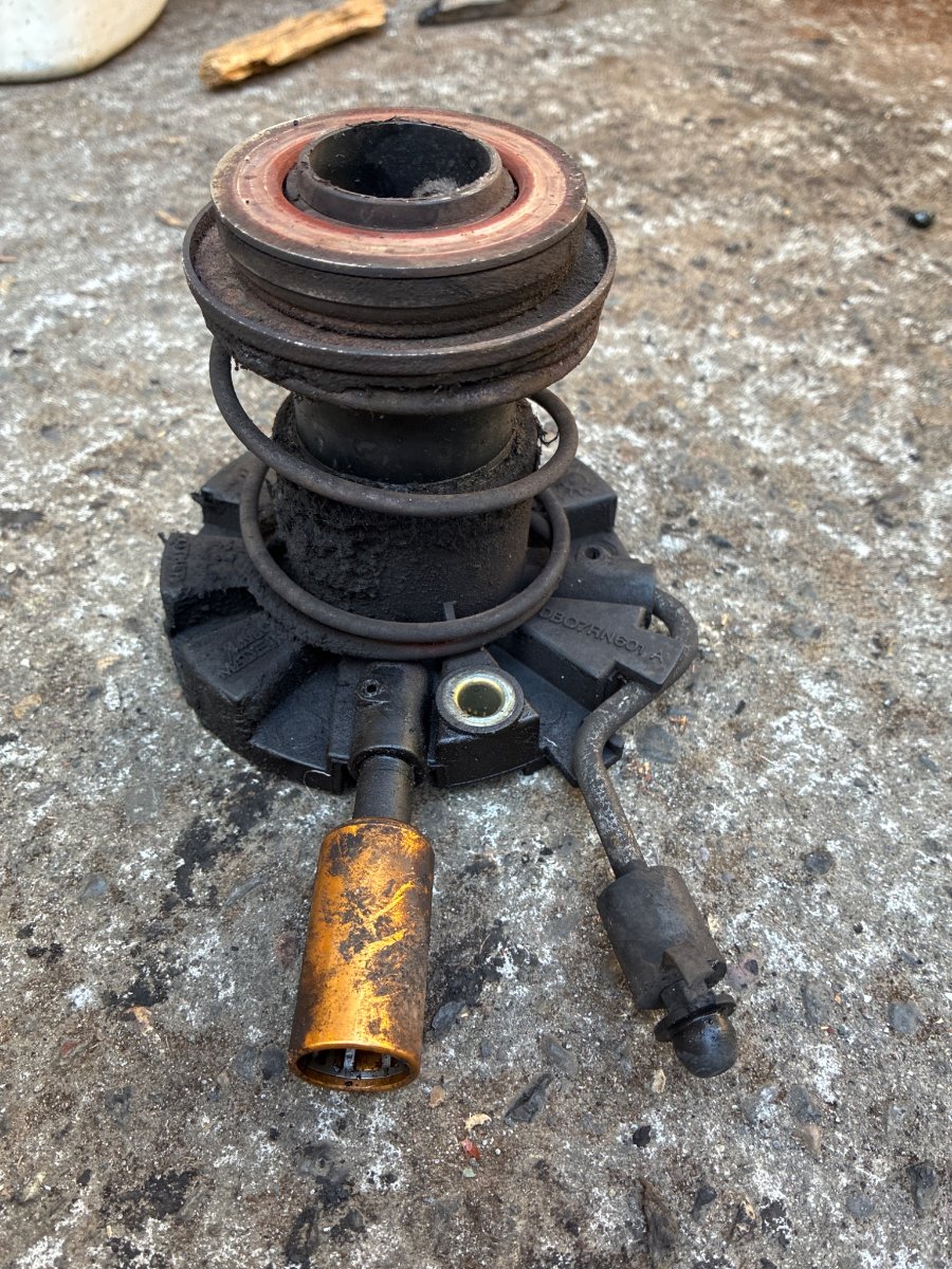

I've got the tranny all cleaned up and the slave cylinder out.
Is there any reason to open up the cover behind the slave cylinder? Or just surface clean and call it good?

Don't pull that front cover off the transmission, it holds all the oil in and has a little bit of bearing preload on it and is just sealed with RTV...
copy that. i didn't pull it. working on getting the tranny back in now. what a beast with that front cross member.

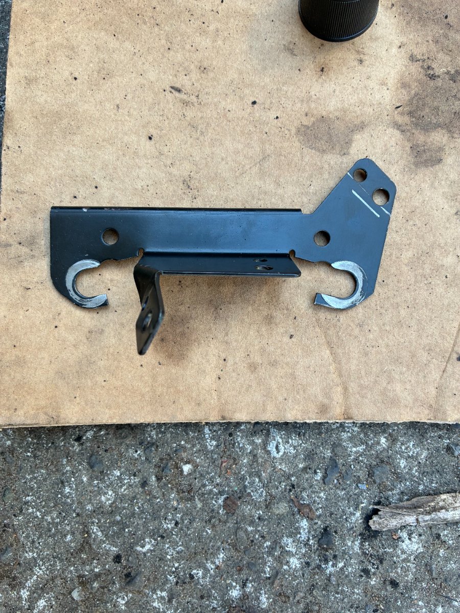

any tricks to getting the stamped bracket to seat into those upper bolts. I can sit under the tranny and wrap my hands around both side (even touch my fingers together) but I can't seem to get that bracket in with the tranny about 1/2" from the block.
Time for a new clutch 96 2.3
nevermind. my brain is mashed potatoes. I was trying to get it between the plate and the bellhousing. sheesh.

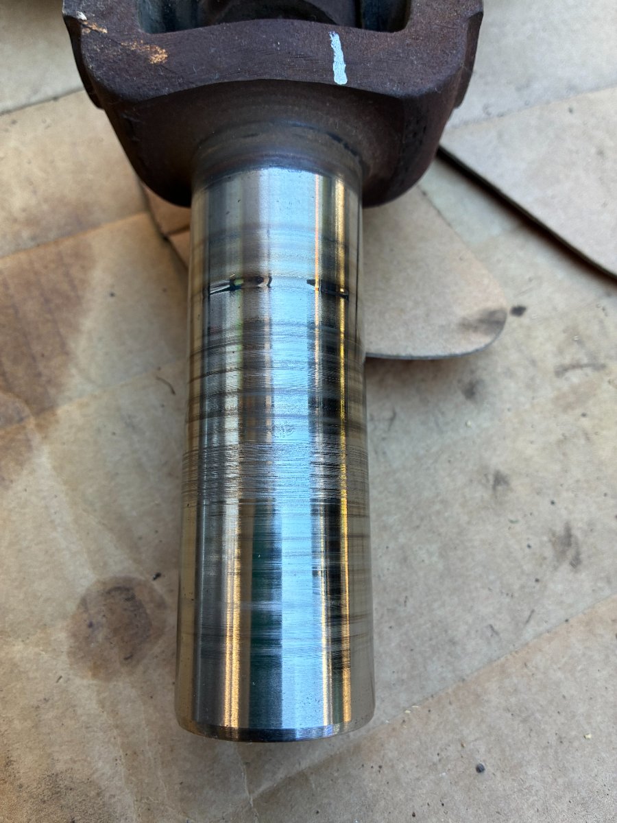

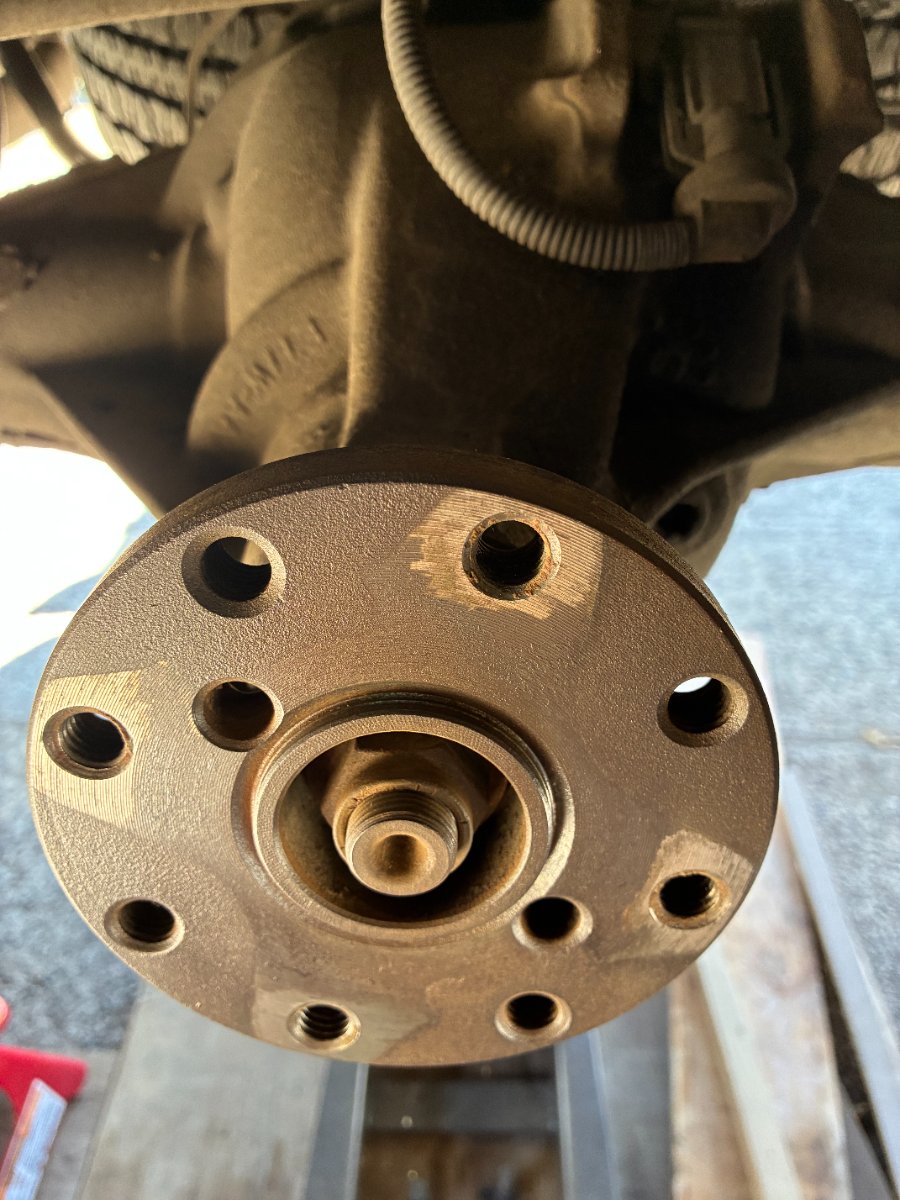

Getting ready to re-install the drive shaft. The slip has very light grooves. Nothing that really "catches" my fingernail but they're still there. There was no evidence of seeping before the job.
OK to use this slip?
I don't think anything rides against that other than the seal which I'm pretty sure is living where the super shiny groove is. I'd just run it.
OK that's what I was planning on and hoping for. At least if it presents a problem i don't have to remove the tranny again.

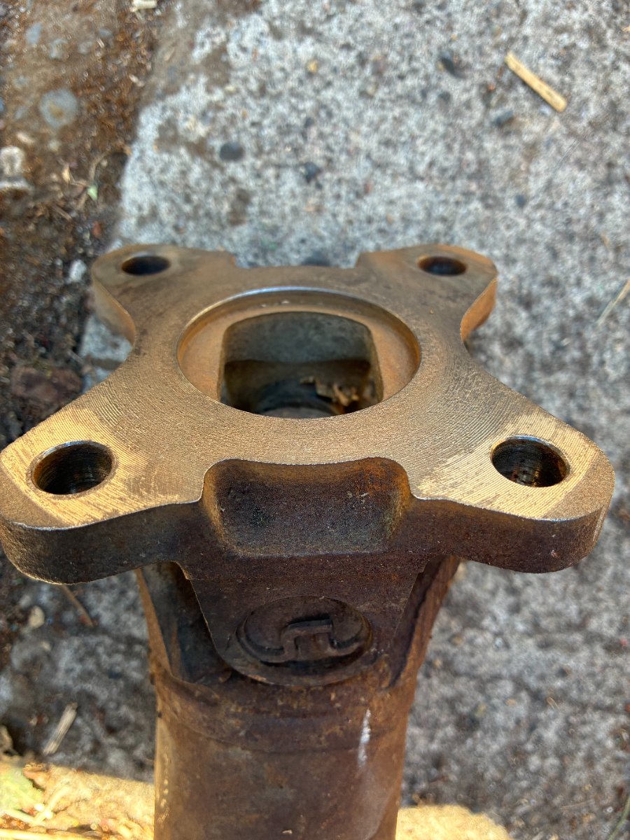

is this clean enough for the mating surface or does it need to get down to near shiny metal?
