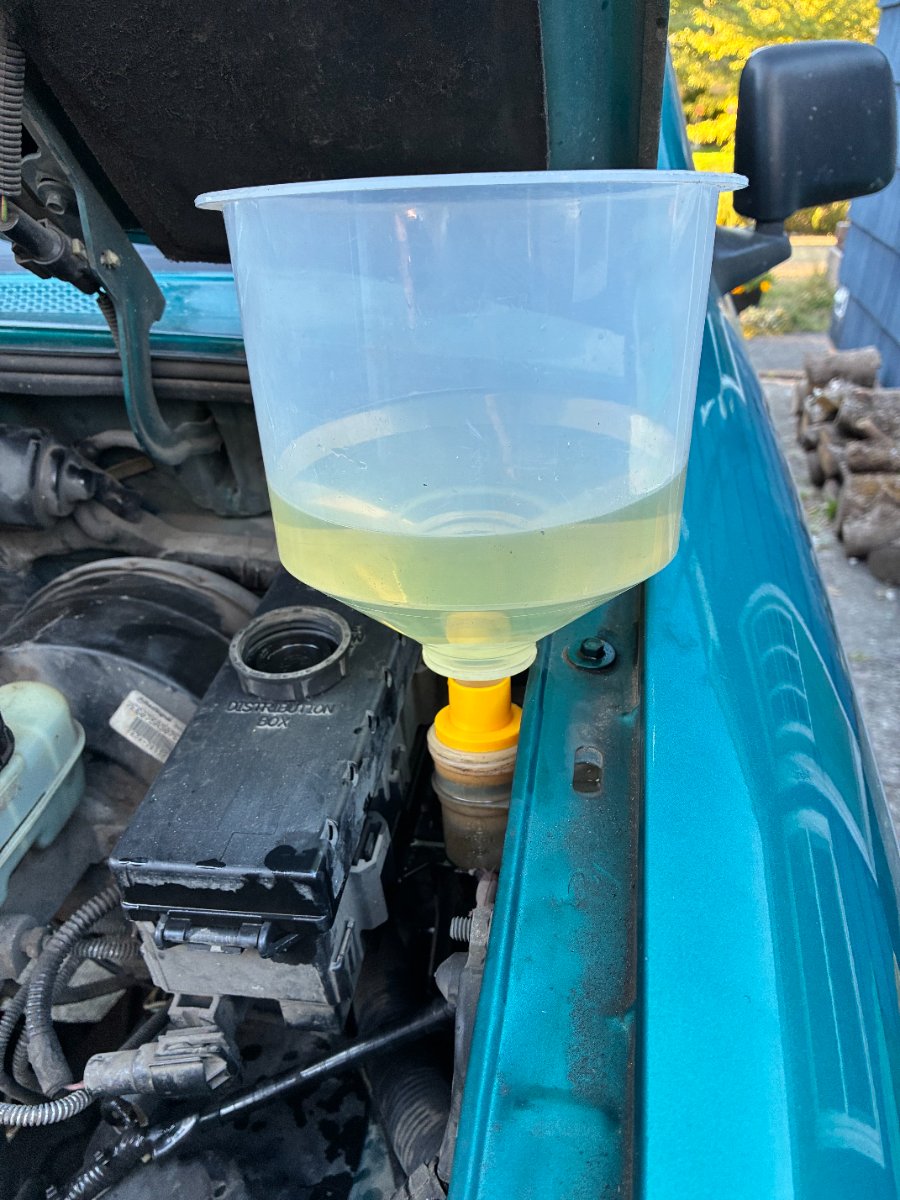

The problem with these clutch systems is the master cylinder is pointed down not horizontal so air gets trapped in the master cylinder piston and can't get out to the reservoir and doesn't want to go down to the slave cylinder either...
