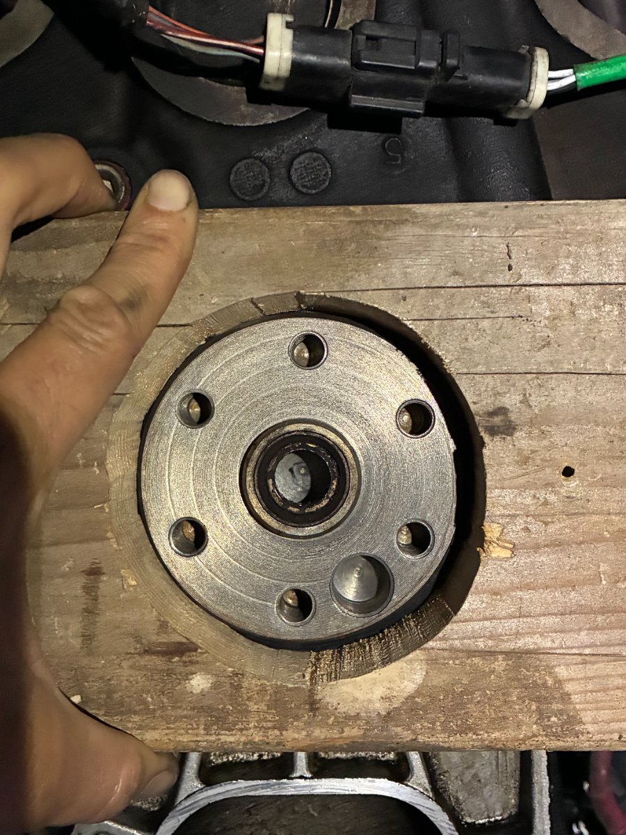

On the RMS i made what you're talking about out of a 2x6 block and then secured a 2x4 over the hole for even distribution. I still can't walk the dang thing in. Took the night off to start fresh tomorrow.
  • Time for a new clutch 96 2.3

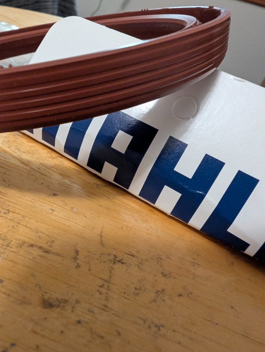

I got a caliper and measure the old and new seals. Measured 4 places around each seal to get an average.
The old seal averages about 107.60 mm.
The new seal averages about 108.22 mm.
Average difference of roughly 0.62 mm (0.024")
Seems pretty big for such a tight press fit seal?

Oh wow, yea .024" is not going in. I mean it could go in, but it would be bent up or something.
I have a new rear main for my 3.0 I can measure and see if I can get an idea on what the tolerance is supposed to be
My new Mahle 47753 is 108.28. After looking at it, I think the .6mm might be ok because of the soft ridges on the OD. would allow it to press in.

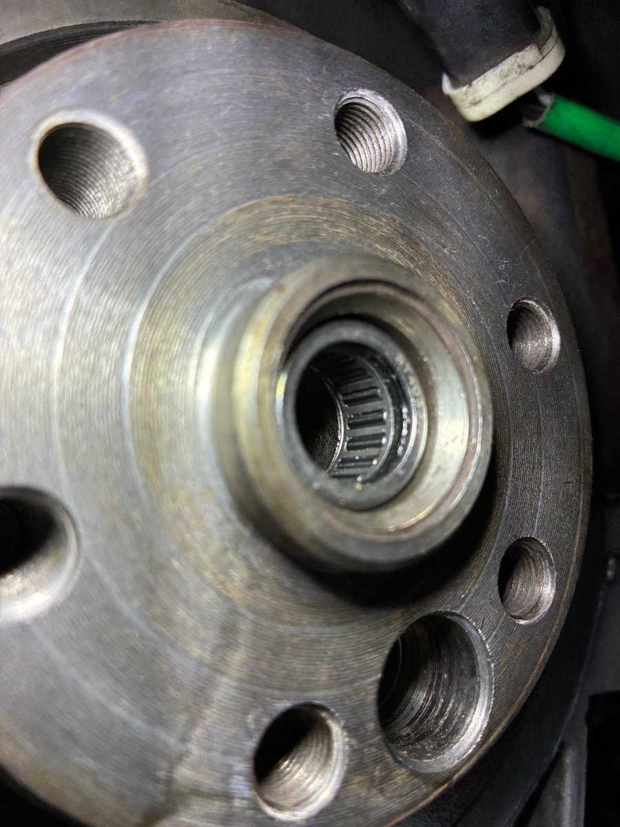

is there a "stop" inside the bore for how deep to drive the pilot bearing?
here is the new pilot bearing installed. I think i hit some sort of "stop". is this set at the right depth?
