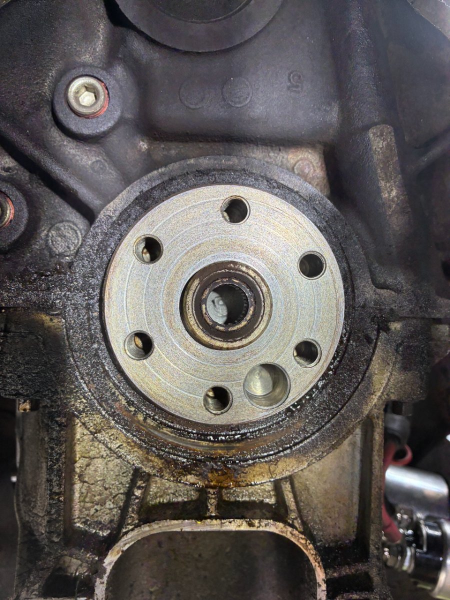

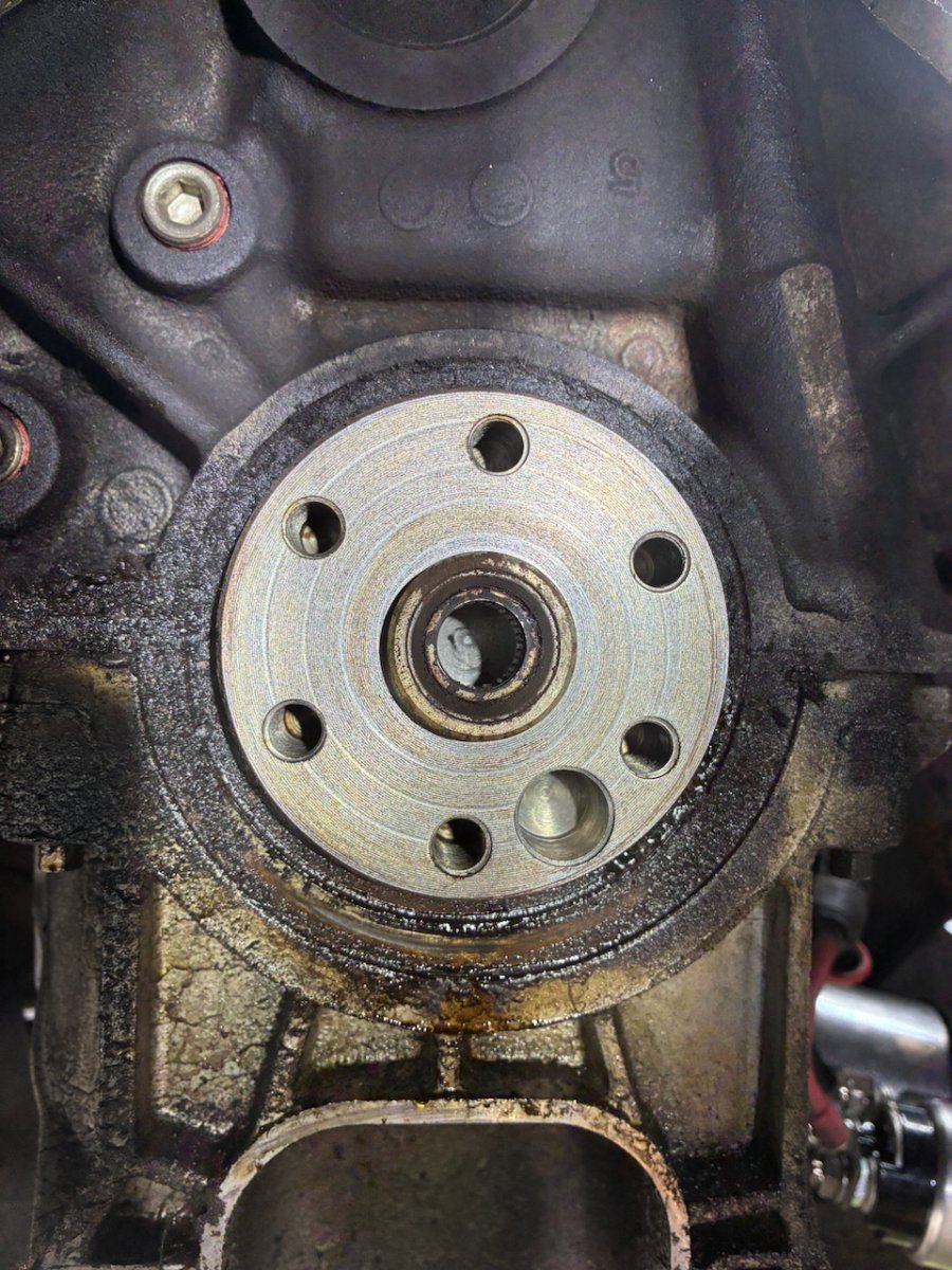

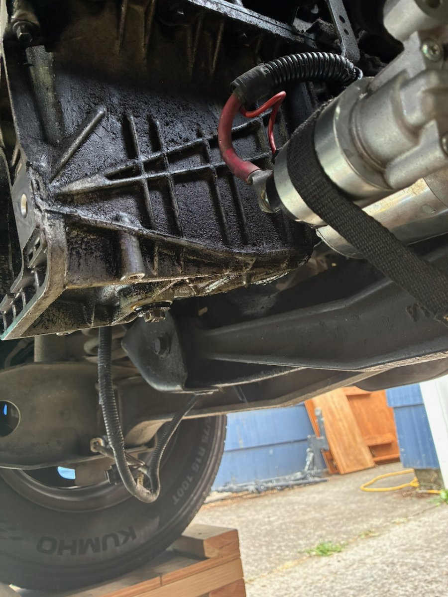

Does this photo tell me i have a leaking rear main seal? the clutch was completely dry.
Time for a new clutch 96 2.3

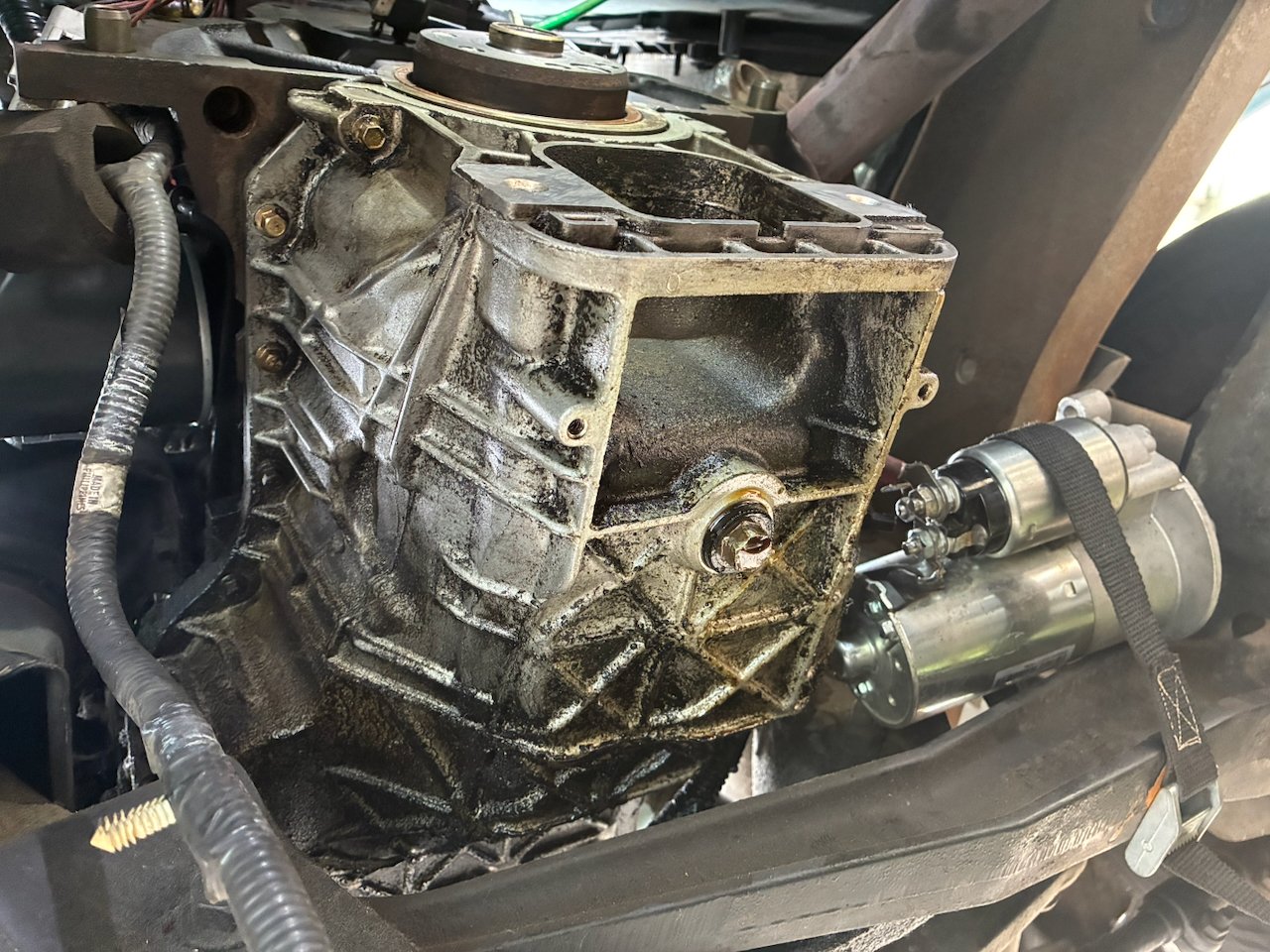

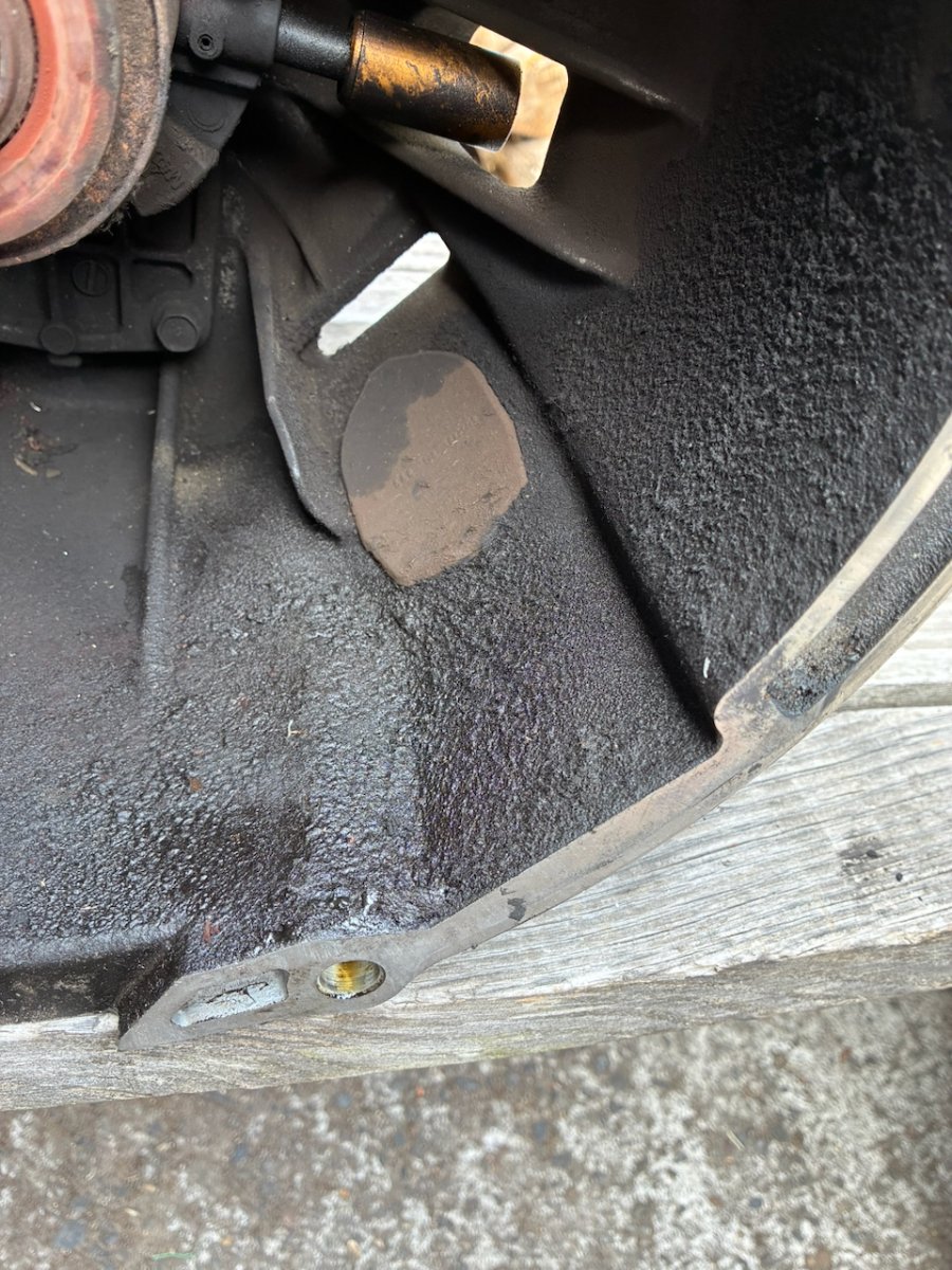

well, the clutch is bone dry and the bell housing doesn't show signs of leakage, though there is a little grim built up (pic 2). maybe some seeping? I do have an oil leak somewhere as the oil pan shows a lot of signs.
i'm leaning toward not replacing the rear main seal.

I'm inclined to leave it alone. I once replaced a seeping rear main seal because I already had the motor out. Dam if it didn't leak worse after...
I decided to replace it. Is Victor Reinz any good? Might not be able to get my hands on a Ford OEM today.
Should be fine.

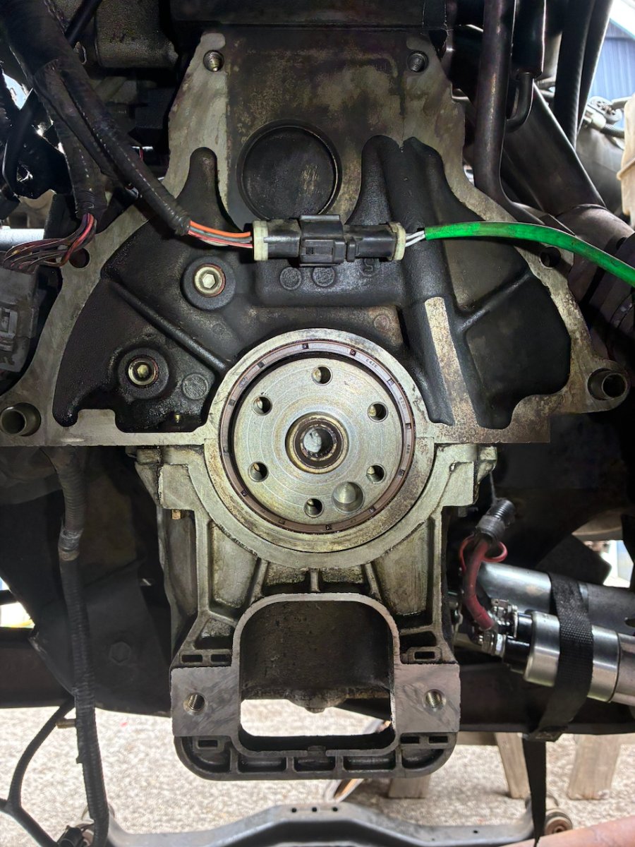

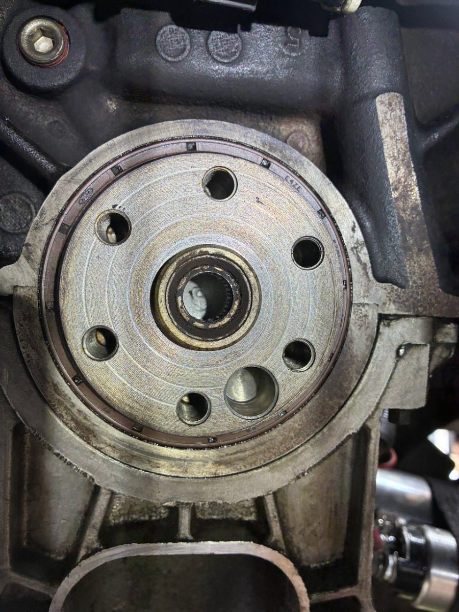

ok rear main seal in hand. Never done one but it looks straightforward though I understand it requires great care to not have it leak in the future.
i rented the tool but the largest disc isn't big enough. I could find a plate and drill a hole. I assume it just needs even pressure?
it comes with a plastic sleeve I assume is part of the install process?
That sounds right to me.
old seal is out. I'm reading conflicting information about installing. I think I'm supposed to install it dry, it came with a plastic install sleeve.
  • Let the oil finish dripping
  • Clean the bore and crankshaft with brake cleaner.
  • Wipe everything completely dry.
  • Install the seal with the plastic sleeve still in place.
  • Press it in square.
  • Remove the installation sleeve if required by the seal design.
  • Do not rotate the crankshaft immediately afterward.
Does that sound right?
I once followed the instructions to install a front main seal dry to the crank surface. This was in a Haynes or similar book for a 4 cylinder in a neon. It was wrong. I cooked that seal on first startup. Regardless of what they tell you be sure about installing dry, be wary. Perhaps the outer edge to the block is dry but crank contact I feel needs lube.
