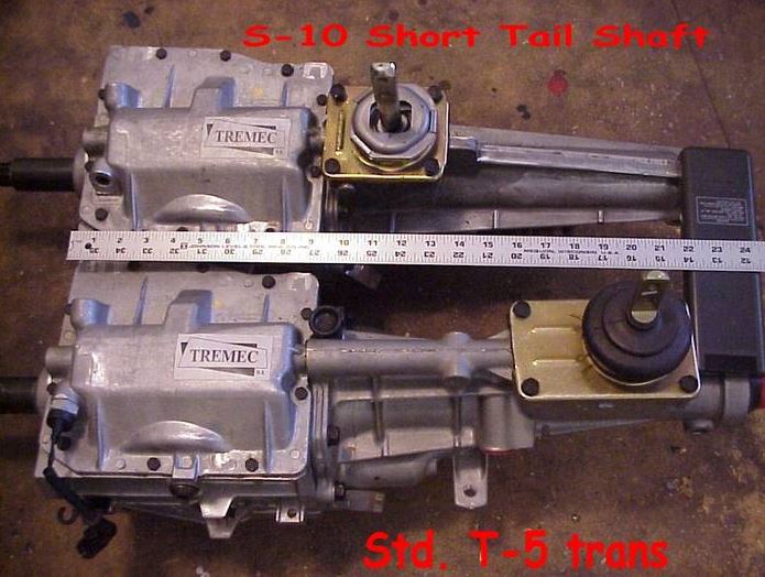

The Mustang T5 puts the shifter slightly behind the front edge of a 60/40 split seat (with the seat all the way back. The "historic" solution was to get an S-10 T5 and pull the rear housing off...which puts the shifter more/less in correct position.

For the tail shaft of an S10 trans, could I heat and bend the shifter of the T5 as to not have to buy that part? I’m very comfortable with Jerry rigging.

Don't know if you can bend it that far.
Not a good place to be cheap. Buy the right part or live with the new shifter location. if the latter either modify the seat to clear or switch to buckets.
