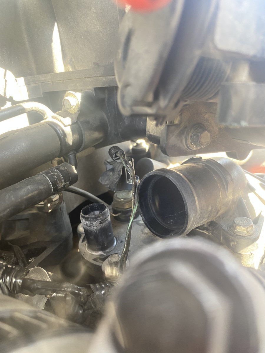

I have 09 ranger sport that I am looking for an aluminum housing for it looks like this

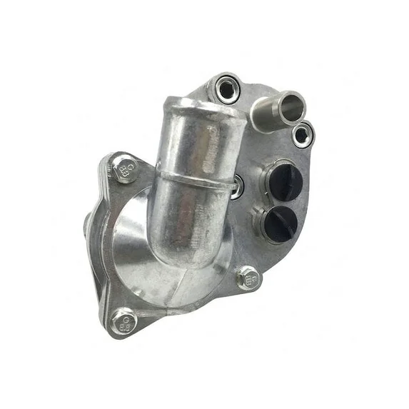

Having only one plug in it and I keep finding housing with 2 plugs

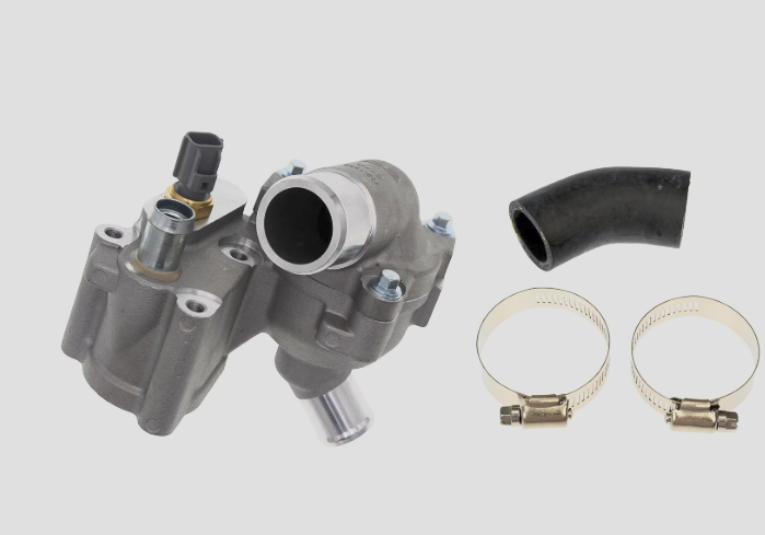

or bare housing like this

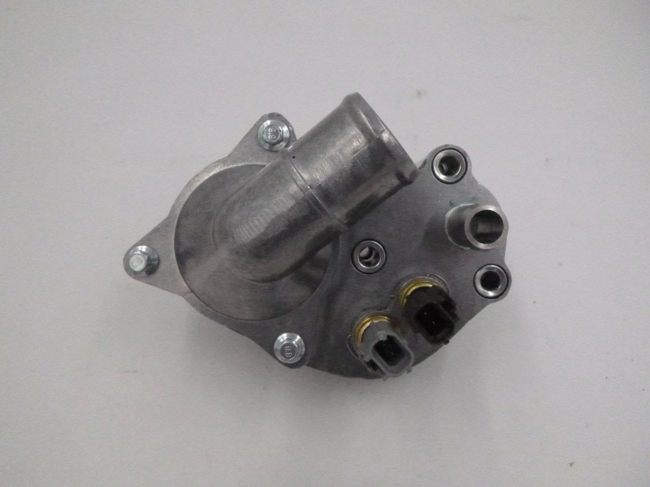

I fought this housing from dorman/duralast one

Has anyone else encountered this problem and which one did you go with?

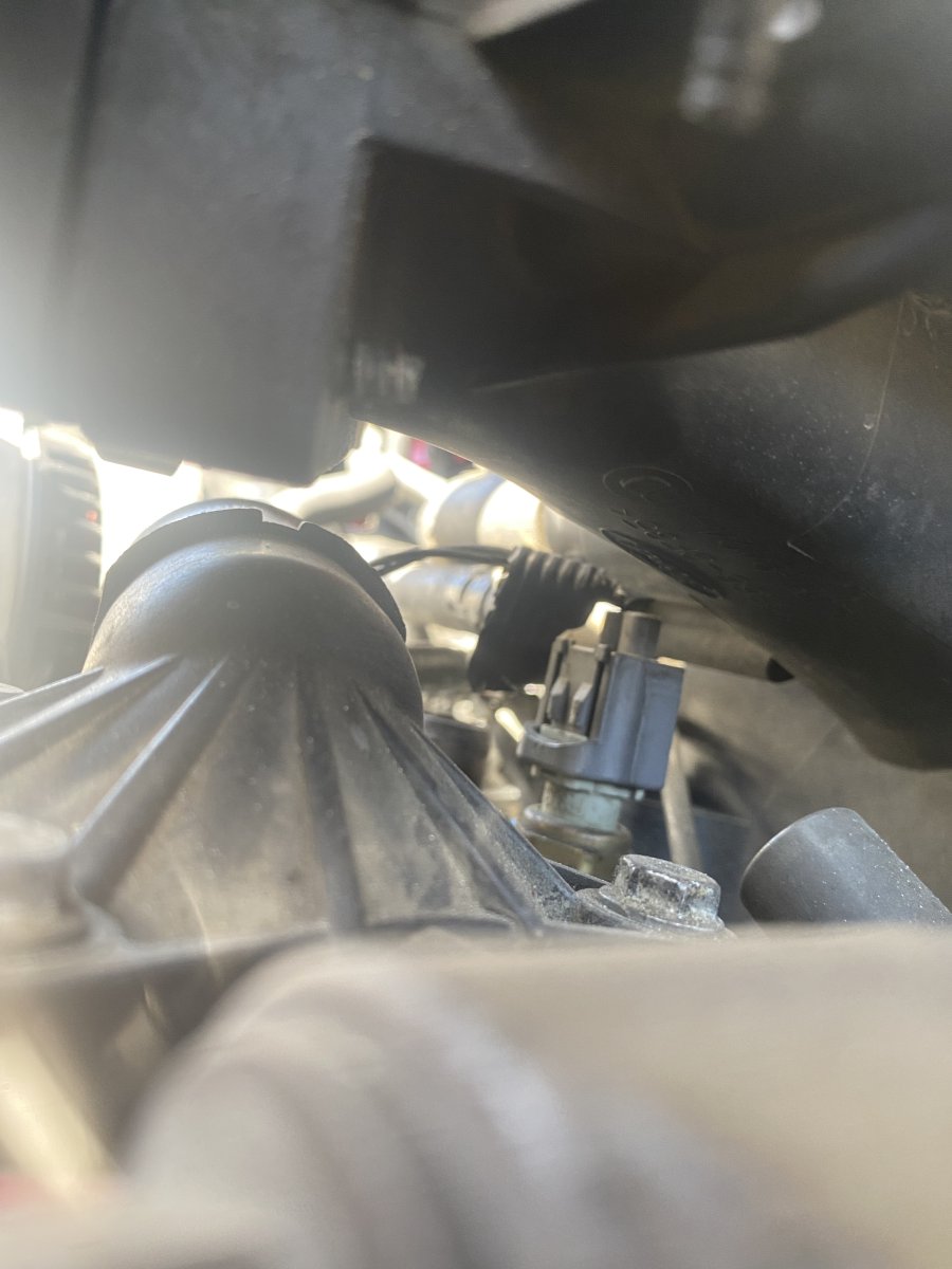

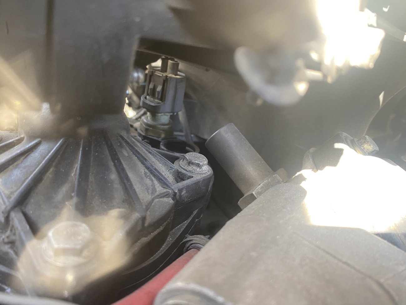

Your plastic housing looks like it has the space for that second sensor. I don't see why you couldn't use the first and just leave that sensor unplugged. If having it sticking out bothers you, it might be a pipe thread. If so you could buy a plug at any hardware store.

I installed a new alum thermo hsg back in Dec 2025 to replace the leaking OEM plastic. I only had one temp sensor connector... IIRC. I ordered mine from Simmons Auto. It was more expensive than any others. But was recommended over the others by most of the folks on this forum.
