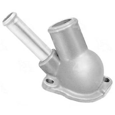

Hi, my Ranger's thermostat housing finally gave it up, and it rusted through where the upper radiator hose goes. I'm pretty sure it's a particular part for this model year, and it does not have a sensor on it. Does anyone have any experience with bending the tubing on a later model 2.3L (1992 -97 I think) to where it'll line up with the rest of the plumbing? That's as far as I figure I can do maybe, since the original one is unobtainable at the moment. Thoughts and suggestions are always welcome! Thanks!

Is this what it looks like?
Negatory, it is similar to the one with a sensor plug, but the angle of the pipe for the heater isn't quite the same., Thank you tho!
