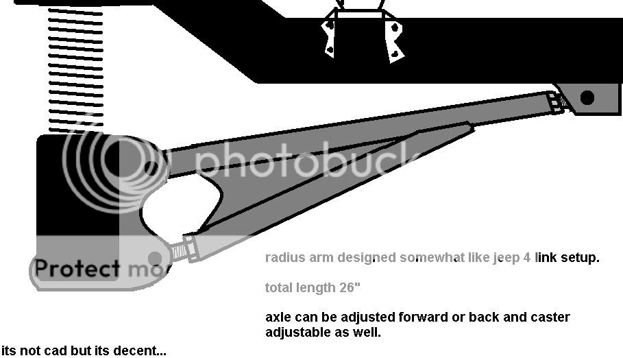

need some criticism...
would this work for extended arms?
it'd give a lot of flex by using heims or johnny joints, adjustability to center axle in wheel well and caster angle too. let me know your thoughts on it.
ok instead of that i decided to do the easy way. i'll be gettin 3 feet of 2" .25 wall dom and cuttin the thread plug out of the stock arms to extend mine. the same way blackbII, 4x4 junkie, todd and a few others have done. i wanna extend mine to maybe 18" since i have no tranny x-member holdin me up. tips tricks help?

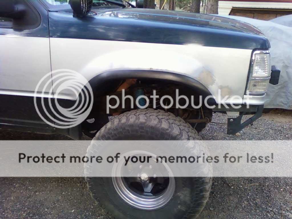

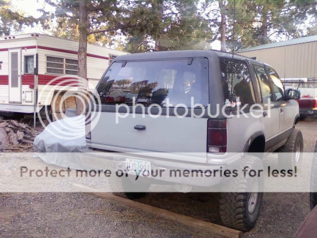

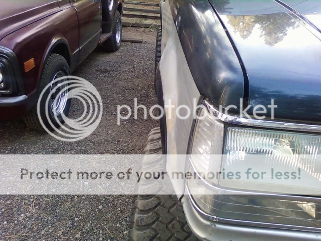

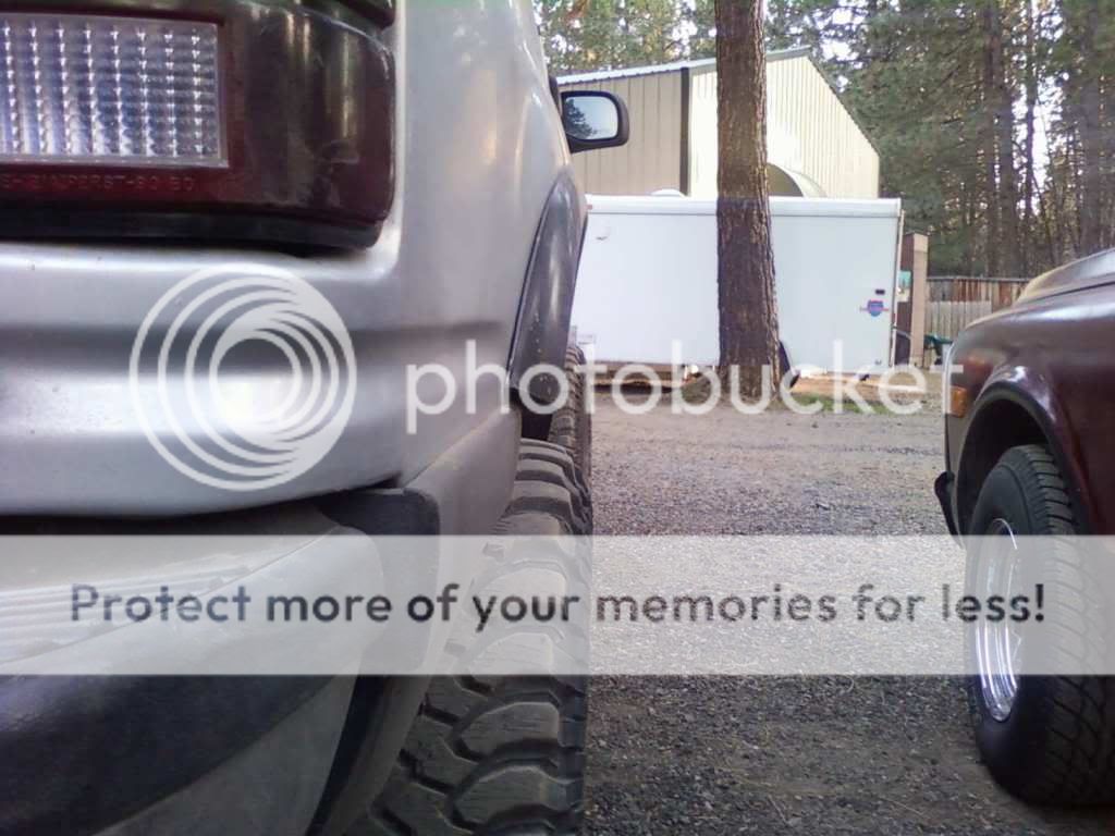

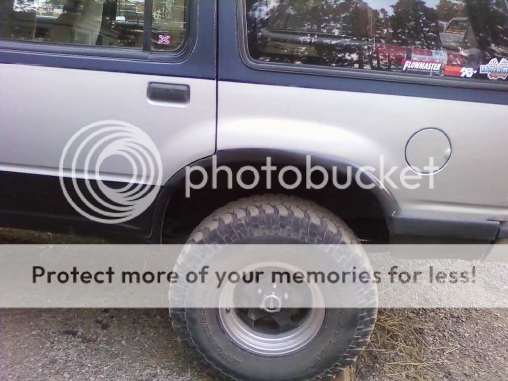

i got my flares off of the X sport installed n painted. then i got my hatch fully shaved n painted, got it on the truck also. what do you guys think?
Front flares
Rear Flares (will cut off rear quarters later on)
The Shaven hatch (third brake light, wiper 'n' washer, emblems, trim, key hole)

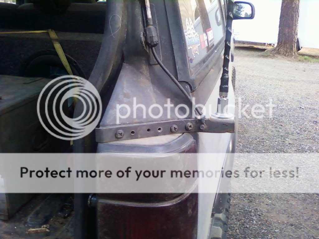

my cb antenna bracket (made up of 16g steel)
