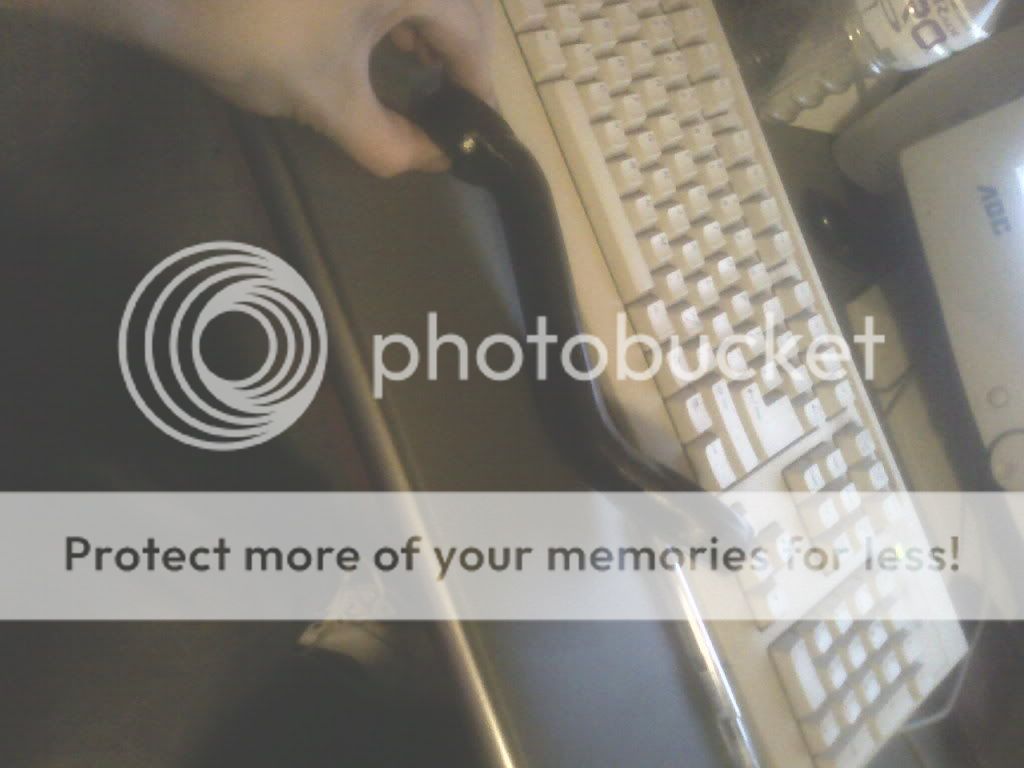

Pitman arm that just came in
Skyjacker FA600
Judging by your pics, I think someone sold you the wrong arm, that does not look like the FA600 arm to me at all :dunno:
Check it against here
Truck looks good otherwise though. Now you just need a bumper for it :icon_welder:
looks like a stock arm to me. does it look stock to you?
its the standard dropped arm. measuring down from where they measure, its 5-5.5". so its the middle image.
Yeah, I'd take that back (especially if they charged you for a FA600 arm), I can see it's too short looking at the linkage in your pic.
so i looked back and found out that it was sold to me as a FA400 arm. i must not of been thinkin about it and thought it was a fa600... but hey, i may have it back up for sale after using it for only a few weeks. i need the FA600 because i may still add 2" more of suspension later.

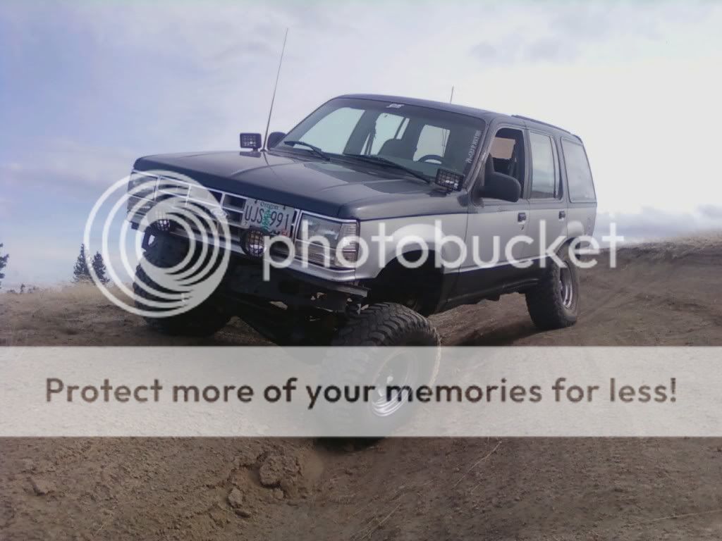

wheelin pics
well i went out to take posers for the first time with my lift on today. the tires (33" bfg muds) GRABBED the rocks and they were just awesome...
i didn't know that SOA gave you this much flex (for an explorer)
i'll shut up and let the pics talk...
well... good or bad?
