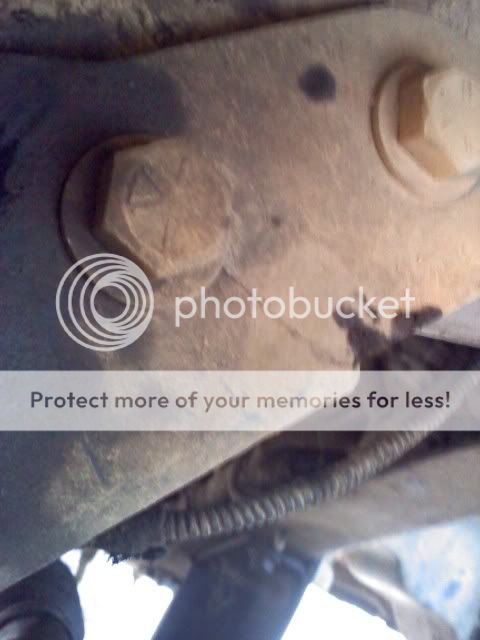

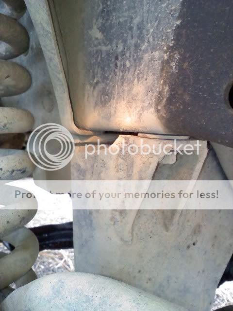

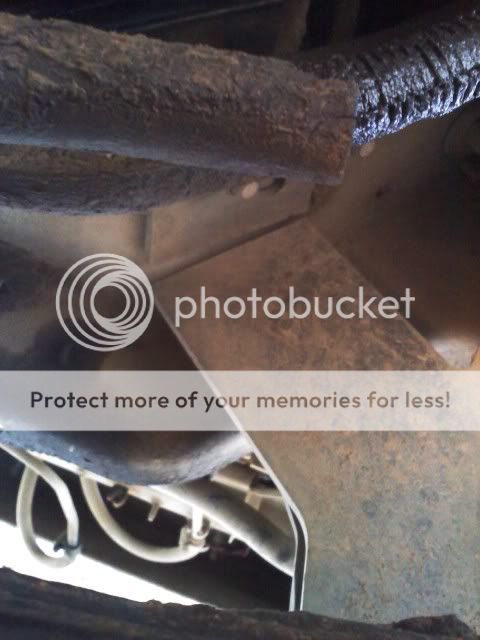

newest update...
BRACE YOUR LIFT BRACKETS!!!!!
I looked under my truck and looks like EVERY single bracket broke...
