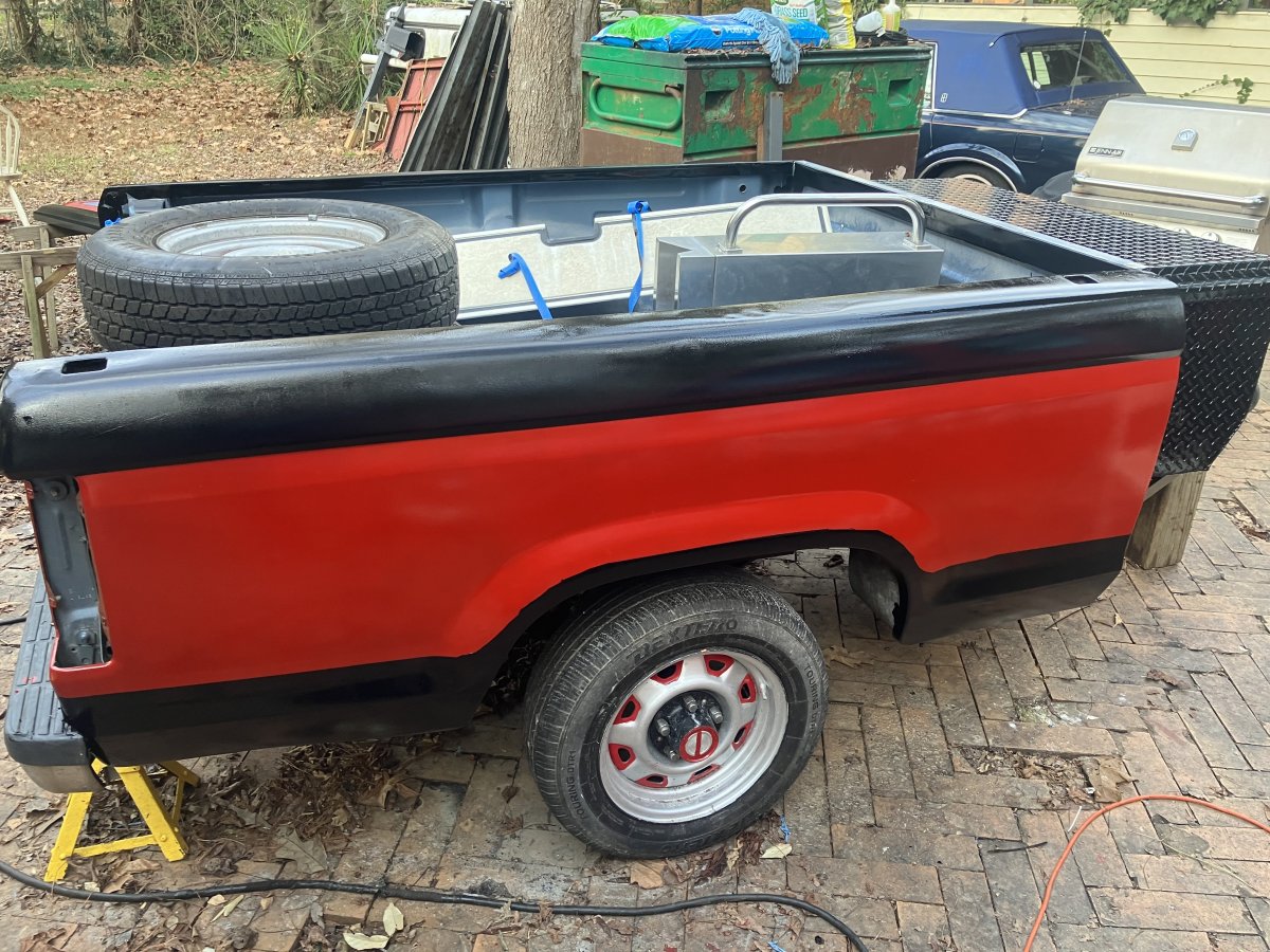

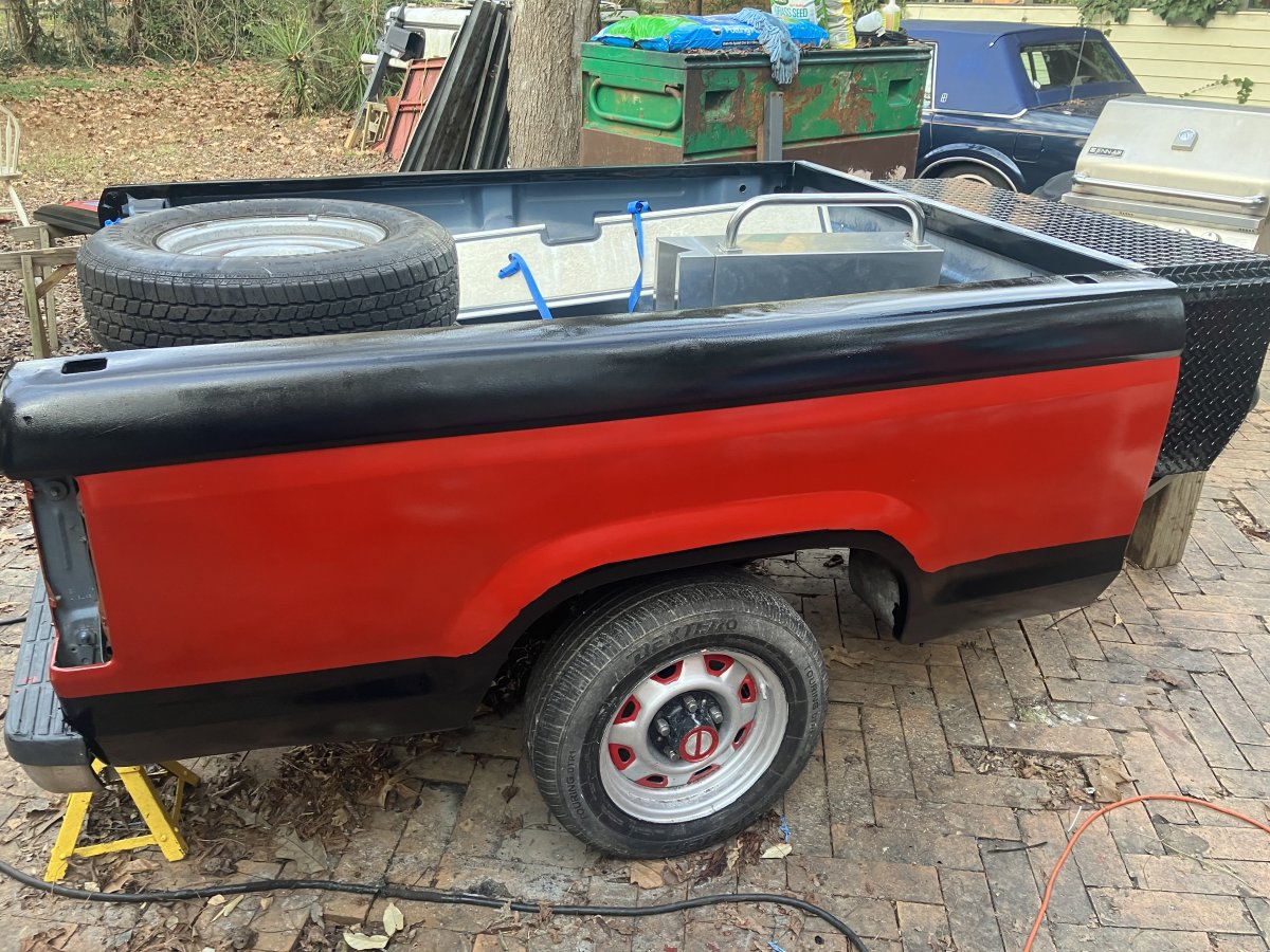

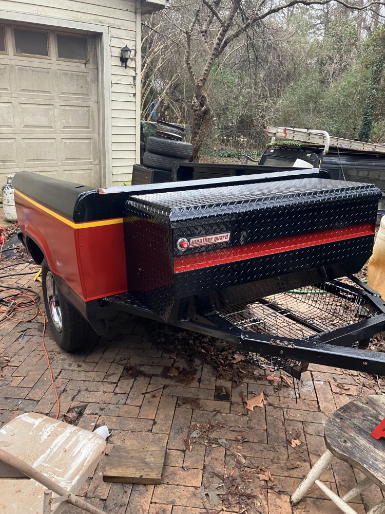

Everything I know about Rustoleum says you can’t use it below about 45°. So I’ve had the trailer ready to go, but I have to put the coats of paint on it when the temperature gets up a little bit. I got the two coats of red on, and then today I got the two coats of black on.
View attachment 104525View attachment 104524
Before you zoom in and get critical about my lines, keep in mind that the breakpoint from red to black will be covered by reflective pinstripes like the truck
I still haven’t finalized how I’m going to do the Pintle hitch. Tomorrow I will mount the 235s, and in the process make sure my skinny spare will work in an emergency.

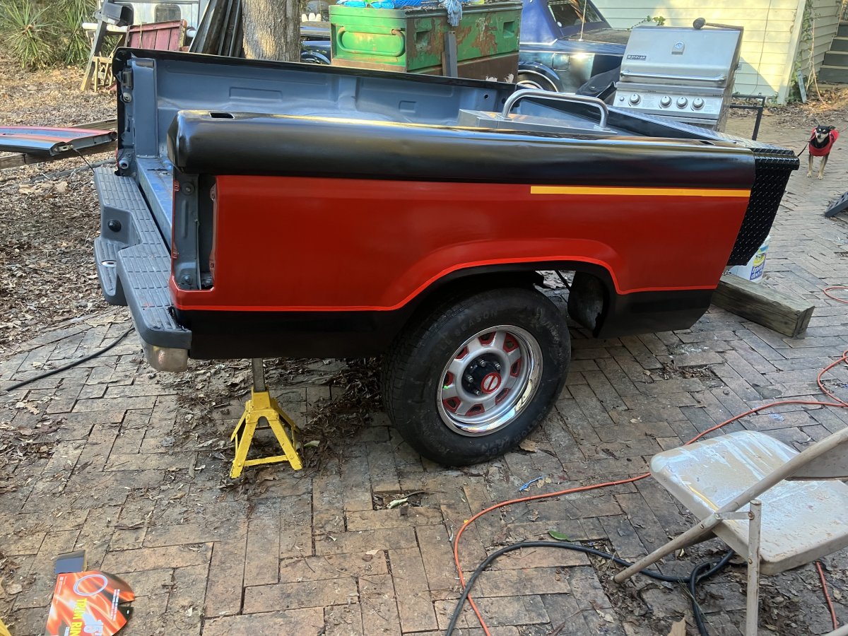

I finished the red reflective pinstripe except the tailgate the other day, and then I ran out of the amber reflective.
Man, a coat of paint will help anything!

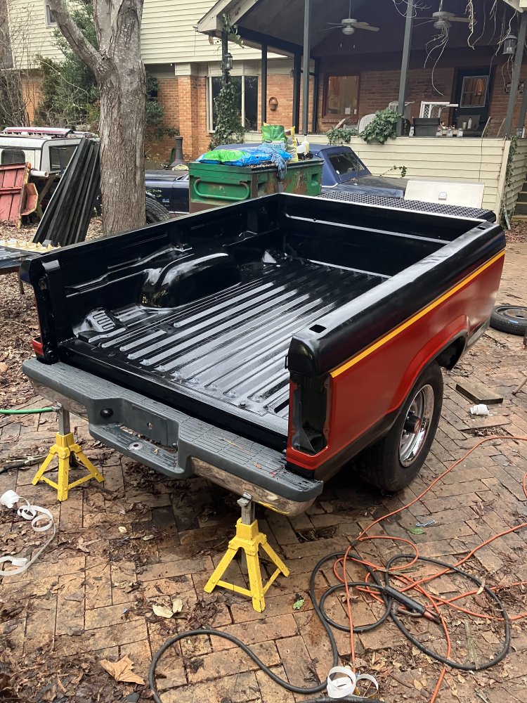

I got the inside painted with the semi gloss. I used a roller with a 3/8 inch nap. Gives it a hair of a texture that covers up a little bit of the scratches and dents. It looks gloss now because it’s not dry yet. I used the roller on my wire shelf spare tire basket, just to knock out most of the white, and that worked pretty well.
Then I went to finish up the yellow reflective pinstripe, and the new stuff is a slightly different color than the old stripe left over from when I did the truck, so I just covered the old stuff and then finished it off. I also finished painting the tailgate.

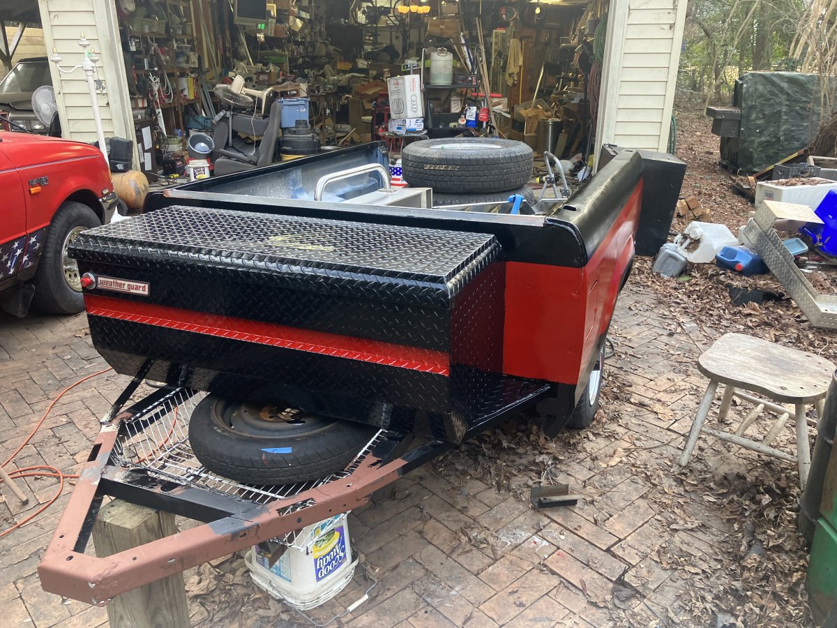

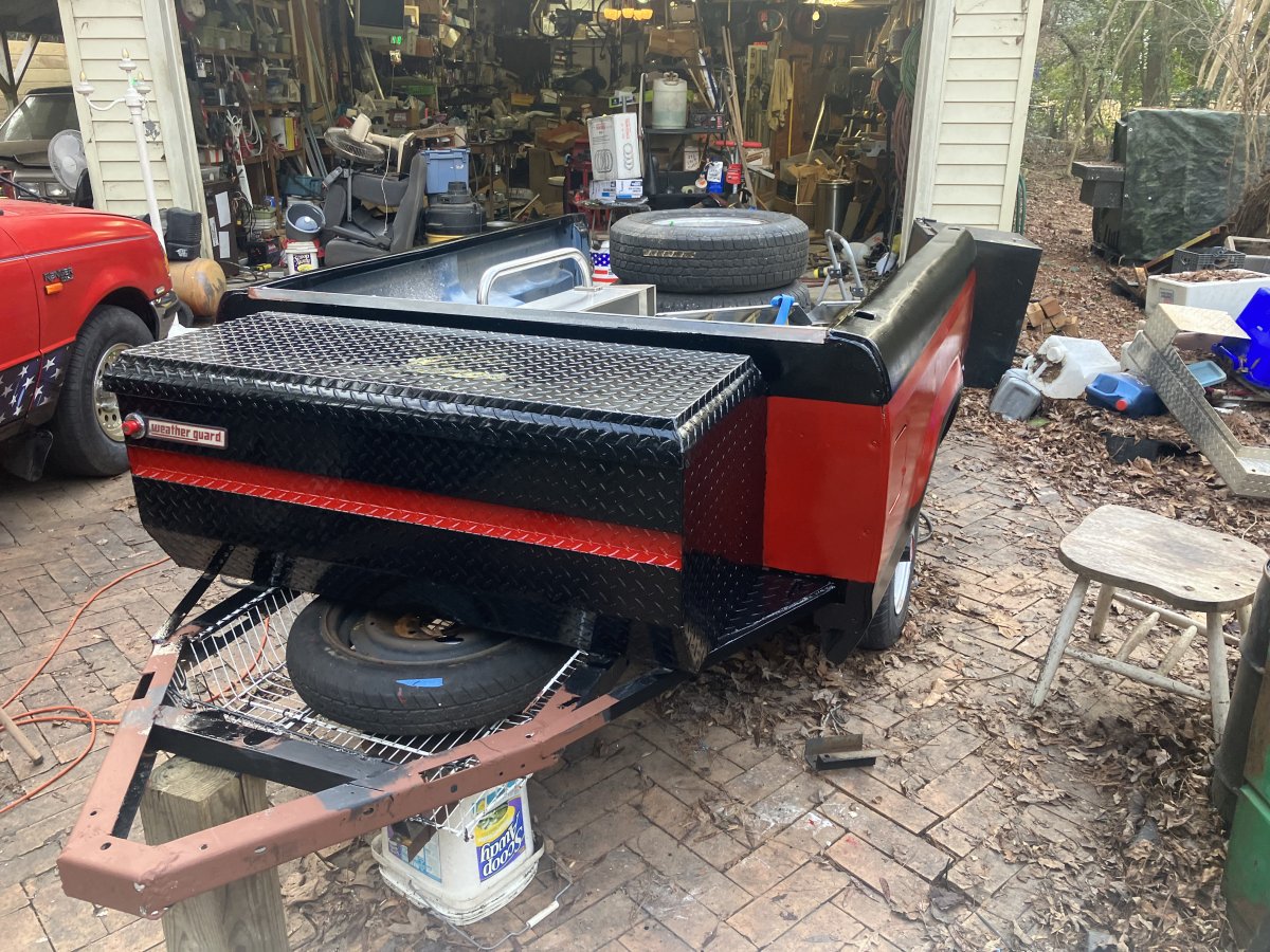

I finally figured out what I want to do for the hitch on the Towncart. I wanted a military hitch, and I wanted it like a drawbar in a receiver, so I could take it out to improve theft security. I just couldn’t get a vision on how I wanted to do it. And of course, without spending any money.
A while back, on one of the Pull-A-Part bargain days, I bought two pair of the tow hooks/eyes on the front of an F350 or 3500 or something like that. One set was a closed ring, and the other set was a hook design. They were $1 apiece, $4.
On the closed loop ones, if I cut a little bit off the truck side, I end up with a relatively rectangular tongue. And you know all those hitches I have accumulated real cheap? I can take one of those, cut the ball off, and slot It, so I can slip that tongue in it, and weld it up. It’ll be better than anything I’ve seen, look cool, and probably stronger. And I’ll have like no money in it and also have a removable ring.
When I figured this out, I was so excited, I went out to the shed of miracles, found the loop, and cut it off in the chop saw. Then I took a piece of my 2 x 2 stock, and I measured and marked it to cut the slots. The tow eye has a slight angle upward, so if I cut my slot at an angle, it will come out straight.

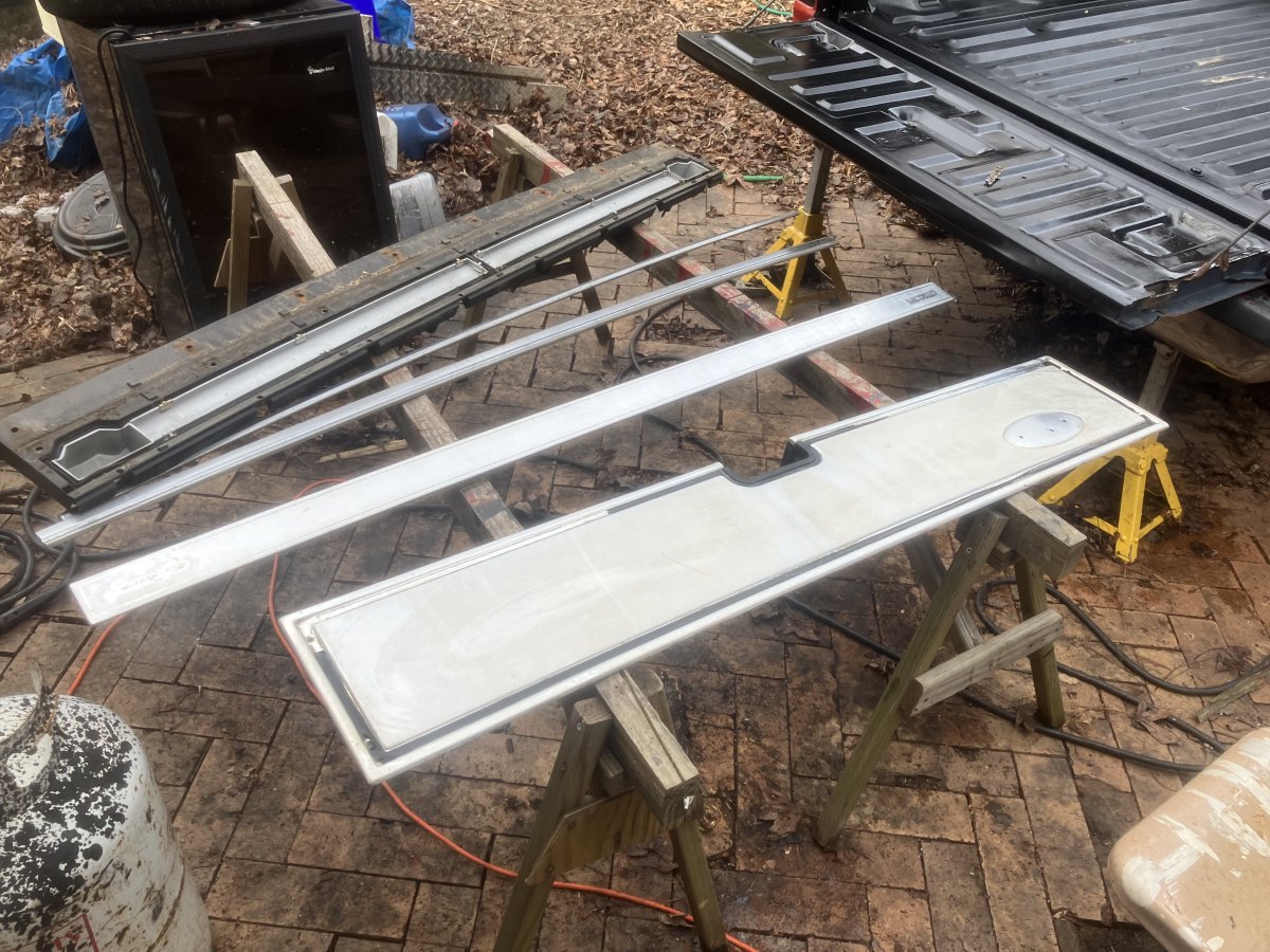

I took the spare rear panel for my Towncars apart for the parts for the Towncart. I also took the tailgate dress panel from the Ranger, and took the logo off. I also took the four center caps that were painted black, and set them up.
Then I suited up in throw away clothes, put on my 9mil nitrile gloves, and my face shield, and I used that old fashioned nasty as hell stripper to take the clear coat and paint off everything, and got the glue off.
I don’t want to say again that this stuff is nasty, but I went through a pair of new nitrile gloves on every center cap. On the last one, I put on the new nitrile gloves, and then put on an old pair of throwaway work gloves, and that lasted me through the fourth center cap and the three panels.
When I washed up from that, I set the tailgate on the back of the Towncart, and, of course, I scratched it when I was picking it up. It’s like rustoleum grows on trees.

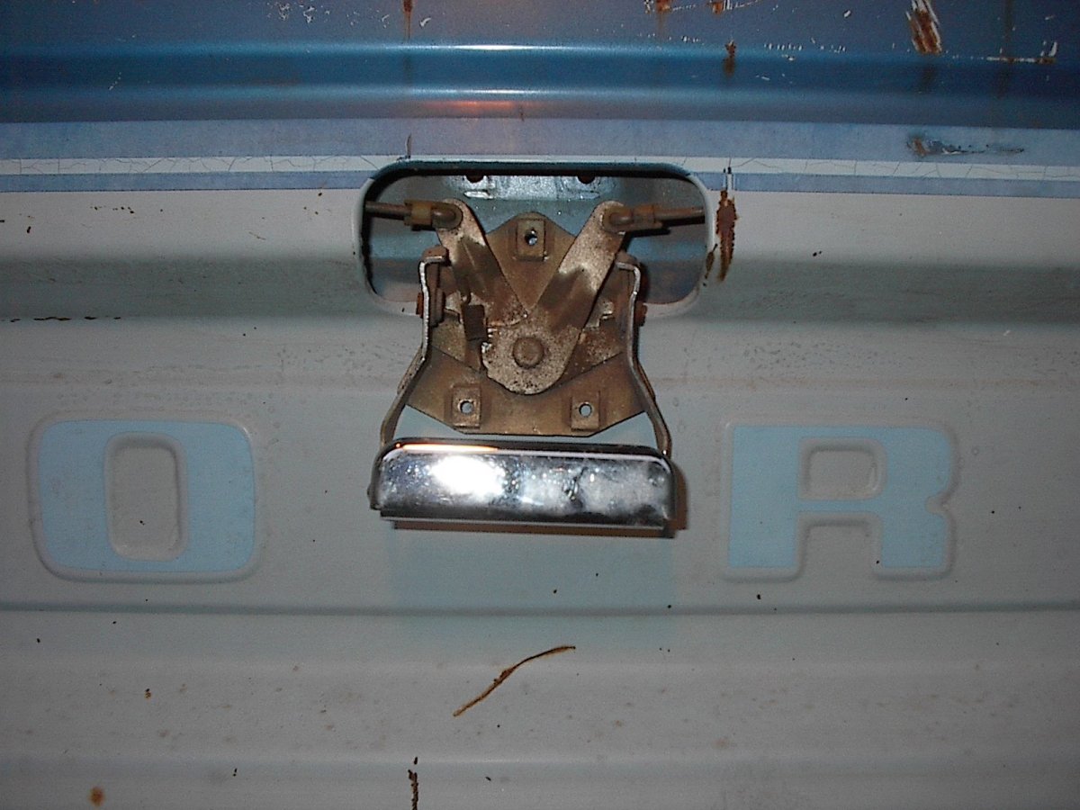

Then I slammed it shut to check the fit, and couldn’t get it open. Somehow the mechanism was a little seized up and rusty from sitting in my yard without being used for a few years. How do you get that thing out of the tailgate? Some penetrating oil and spray lithium grease took care of that.
The skinny ones are stainless. That stripper really is amazing. It only takes a couple minutes if you survive it.
PITA Gotta work it all through the handle opening. Extra fun changing when changing broken plastic clips.

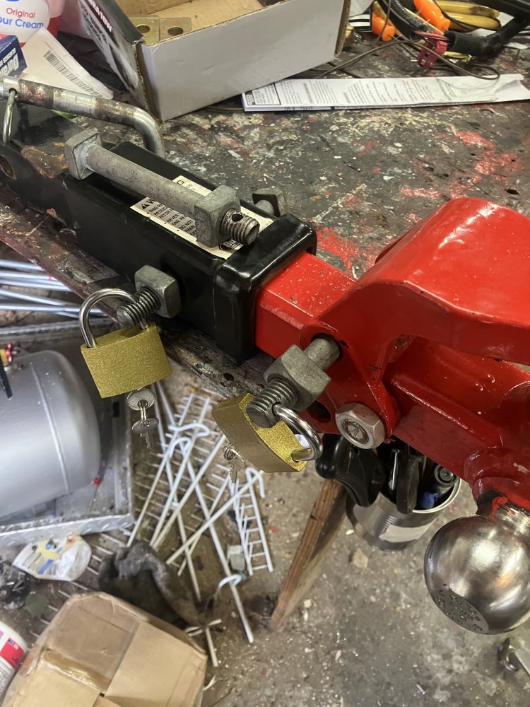

Locking hitch pins:

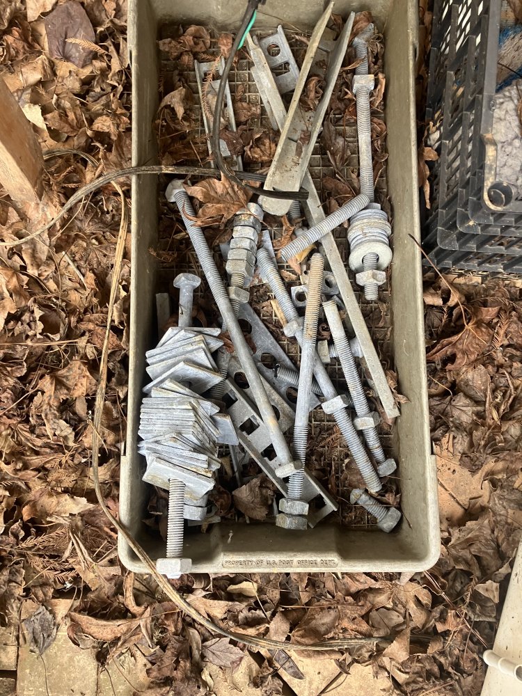

A while back, I bought a small box of telephone pole hardware. You’ll never guess, I found it on craigslist. $20 if I remember. Already used half of it on whatever.

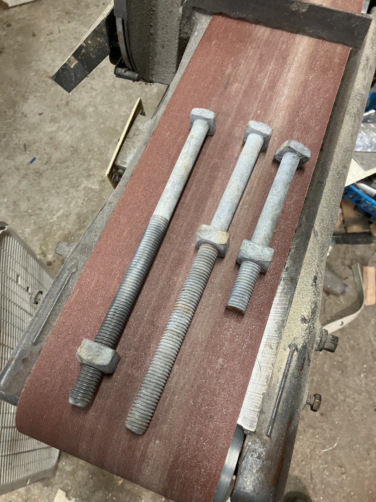

I took three bolts (they’re 5/8 inch), with a long enough shank that they’ll go through the 2 inch receiver and you can put the nut on the other side. Then I cut them off about 3/4 of an inch past the nut, and then drilled a hole through them that allows a dollar store padlock ($1.25 now).
tah dah!
That’s how I locked up the tri-Ball Pintle on the back of the Road Ranger. If somebody really wants to get it, they can break it loose pretty easily, but it will stop the casual target of opportunity scum in the Walmart parking lot.
