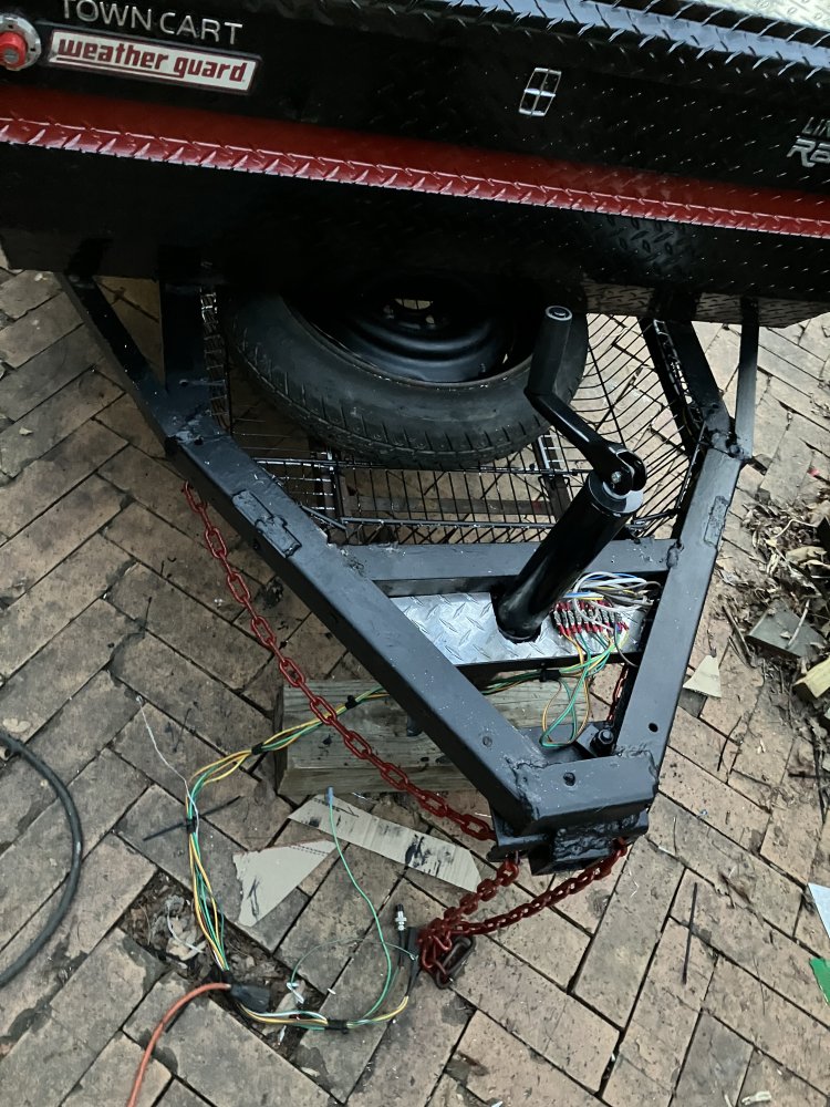

I went into the wire box in the shed of miracles, and pulled all the wires from the various lights up to the tongue. Just hanging under the trailer right now until I get all the circuits tested. I temp mounted a terminal strip to hook everything up and test it, which I will relocate to a more hidden position later.
I mounted all of the strobe and marker lights, the third brake light under the tailgate, and mounted the new OEM tail lights with the Lincoln star.

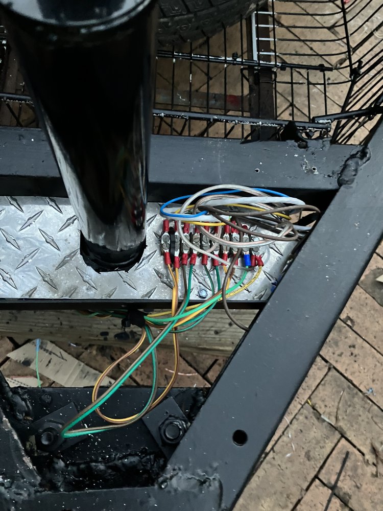

Truck side, the 7-blade connector I worked up is somewhere in the twilight zone section of the shed of miracles, so I made another mounting plate for the 7-blade I’m putting on the truck plus the 4-pin aviation connector for the strobes. I want all my vehicles capable of pulling a trailer with brakes.
On this trailer, no brakes, so I’m going to use an adapter and then a simple 4-pin connector, plus the 4-pin aviation connector, and then a single blade connector for the third brake light. A little crazy, but the other three trailers have/will have a seven blade plug plus the aviation connector, and I wanted to keep them all wired the same.
Baby steps…
Afterthought, I also made up the pigtail behind the truck outlets, and I made the plug cords from the trailer. Since I had to paint the new mount I made, I had to leave it at that point.

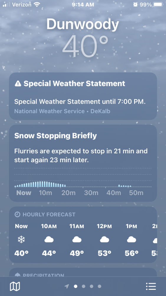

I was just about to head out, looked at my phone, and Siri says it’s snowing here in Atlanta! It’s a very fine white powder. I think Siri was sniffing it.
They say we don’t have four seasons in Atlanta. Not true, yesterday morning we had winter, then spring at 10-11:00, and then early summer in the afternoon, sunny and 65.

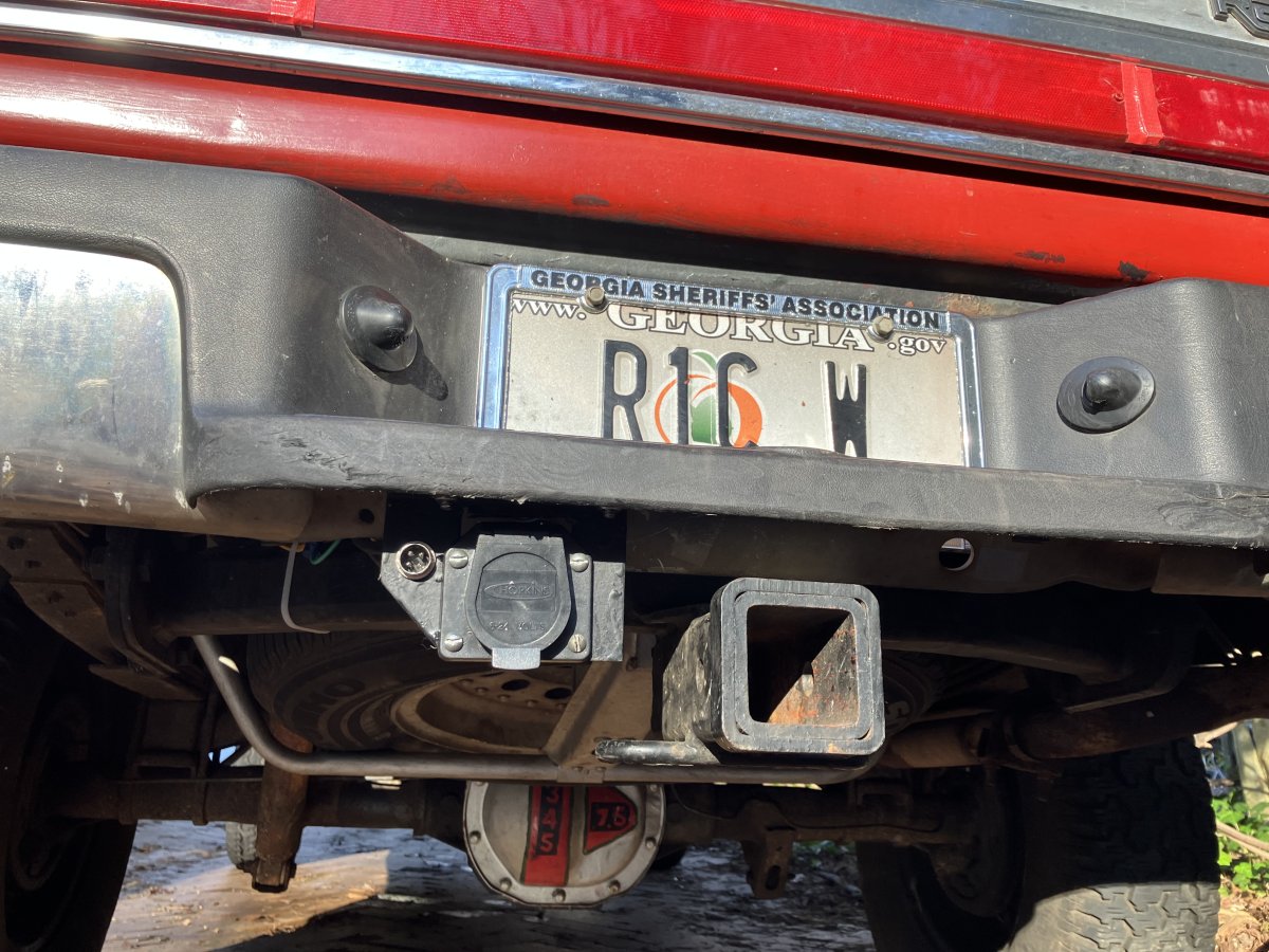

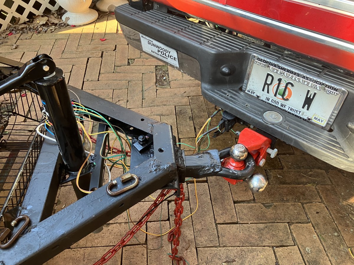

Anywho, I finally installed the 7-blade trailer coupler on the truck (it hasn’t had any trailer connector since I’ve had it) along with my strobe connector.
The Missing Linc (1987 4WD 2.9 5spd short short)
Note the aviation connector left of the 7-blade. I put my Craigslist and Rustoleum tri-ball Pintle on, and dropped the trailer on it for the first time to finish up and check all the wiring and chains and such.
I had to use penetrating oil and a small pipe wrench to open up the connecting links in my grand daddy’s vice. No telling how long I’ve had them or where I scavenged them. I picked them out of my chain scrap bucket, & they worked fine once I oiled them up.
The strobes all worked the first time, but the ones on the passenger side are a little weak. I must have a weak connection somewhere in the 4-pair ma bell wire I used (2 lines, one color per line). I haven’t tied up all the wires under the trailer for exactly this reason, I have some troubleshooting to do.
Then I connected the 7-blade, and got absolutely nothing. Fortunately, it didn’t take me long to figure out that the male wasn’t going all the way into the female. I mounted the whole thing thing bottom side of the step bumper, and my bracket had the 7-blade too close to the top, and the male wouldn’t go all the way in.
I didn’t have any fur to put around it, so I got a couple of 7/16 nuts, and used them as spacers to move the bracket down about a half inch. Then everything worked like it was supposed to, with one exception. Each directional signal works fine, but when I put the 4-ways on, it flickers. I guess I’ll have to put in a stronger flasher button in the Missing Linc.
I moved the trailer back to its parking spot to finish up the tongue. I made a little plate to go around the jack stand and hold the terminal strip and installed that.

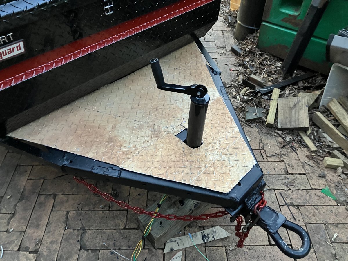

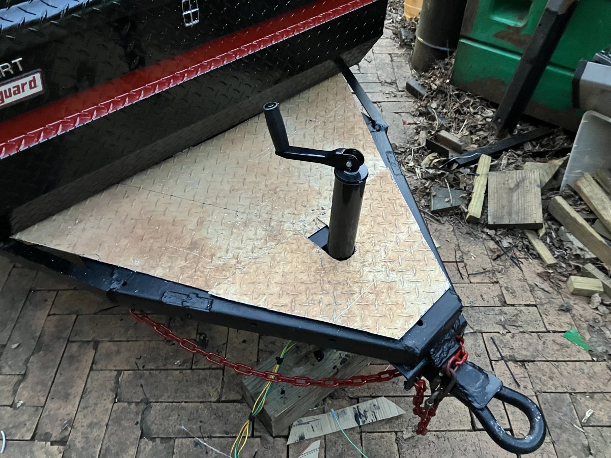

My plan for the top of the tongue is to put two overlapping pieces of diamond plate, behind and in front of the tongue jack, that will be held down with just two Allen head 1/4-20 bolts. I did this on the Road Ranger where the plate covers the toolbox with the jack, and I’ve done it before. I leave a little Allen wrench with a wooden handle in the big toolbox to get the bolts out if I need to. Cheap security for the spare tire and anything I might leave under there.

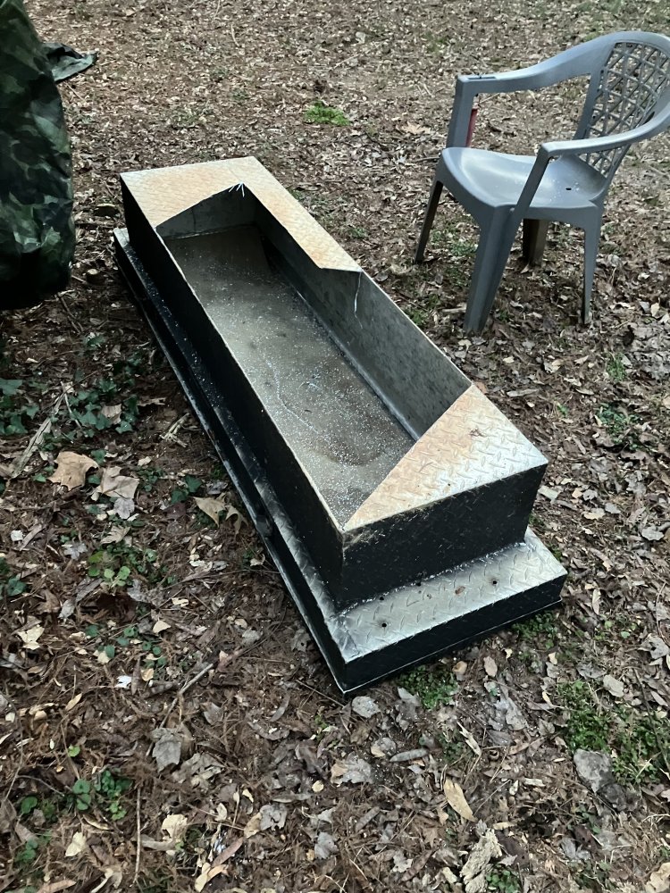

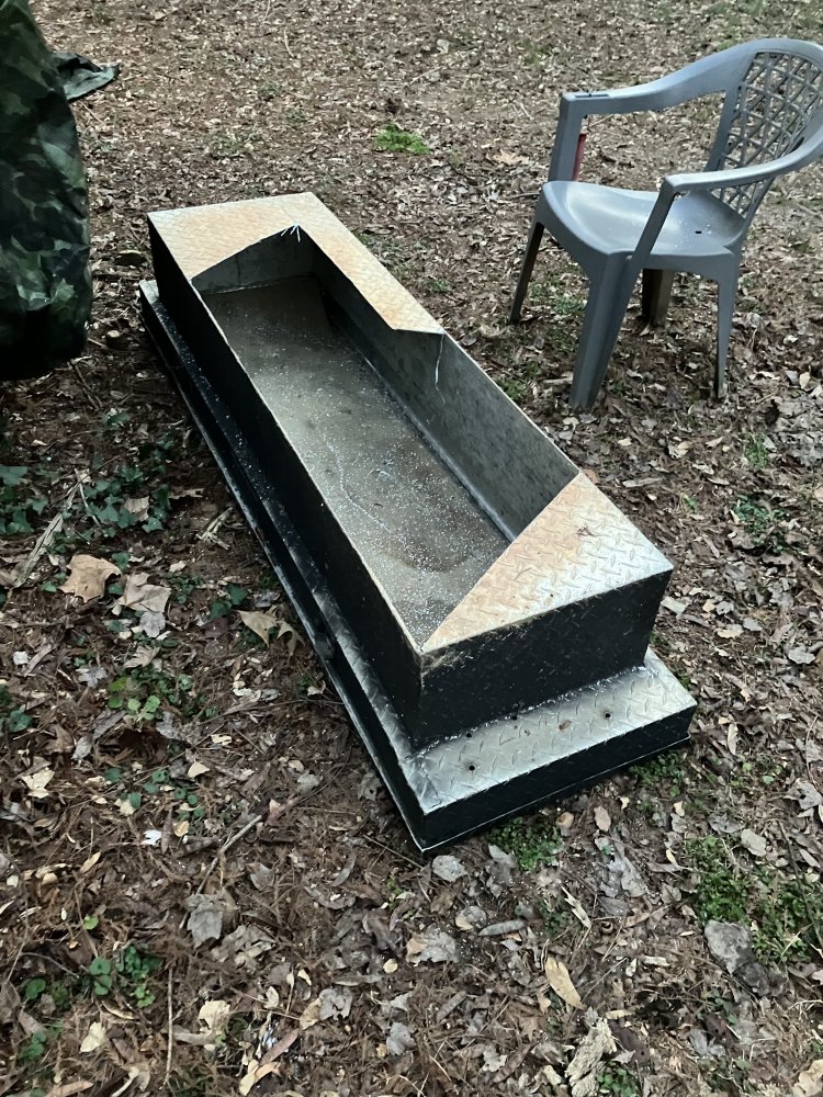

Inspired by @sgtsandman, I wanted to share one of the things I did to get that “professional result.”
It doesn’t just happen. You have to start with quality materials, and a professionally laid out and appointed workstation.
Here you can see where I used a relatively level place in the yard, mostly because it was 2 feet away from where I had the box stored (under tarp at left). I put my free toolbox upside down, so I could work safely with my Skil saw.
At least three legs of my plastic chair wrested firmly on the ground. But it’s all about the details. If you look very closely, you can see where I drilled a hole in the middle/rear of the seat of the chair to let the rain water out. It’s very hard to concentrate when you have a wet ass, especially if you sit down without knowing that’s going to happen. This chair doubles as my life guard chair when I let Lincoln run in the yard.
I’m still thinking of some kind of perimeter treatment around that diamond plate.
The back edge is held down by the angled face at the bottom of the toolbox. I’m going to put some type of clip on the front. Then if I put just two Allen screws where the two sheets overlap, it’ll all be snug, but easy to open up if I have to.

Your truck bed box is missing it's bottom. Is it still within the 30 day purchase window? You might be able to get it exchanged for one that has a bottom.
One of two I literally got for free, I don’t know how I’d swap it unless he’s got another one. I still have some of that nice diamond plate left, too. This one has a huge flat lid, and I’m pretty sure I’m going to split it lengthwise to make the fenders for the ‘Raith casket kitchen when I get that far.

I also finished off the cover plates for the tongue, and used two of those 2500 self tapping 1/4-20 bolts I got for 25 bucks just to see how they work (because I’ll be using them on the big Road Ranger trailer). Worked like a charm, and then I swapped them out for some stainless Allen head bolts I had. I took one of the thousand extra Allen. Wrenches, I had the right size, it made of water to handle forward to keeping the Trailer Tool box.

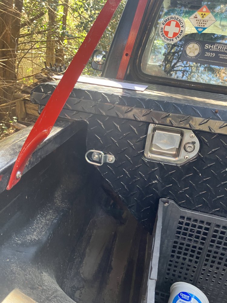

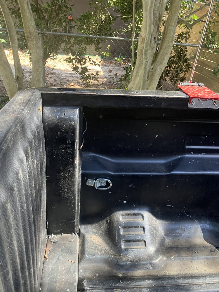

Anywho, I installed small D-rings in the Missing Linc. I think they were something like three dollars for four of them on sale at harbor freight.
I’m going to duplicate it in the Towncart.
License plate frames came in today.
I put 4 D-rings in the Town Cart in the same corners. The ones through the toolbox in the truck are bolted in, but everything else through the side of the bed is a self drilling, self tapping, hex head.
I learned a long time ago to punch the holes, and then coat the surfaces with that E 6000 stuff, and also put it in the screw hole and under the hex head. It stops the screws from loosening up from vibration.
And I’m never going to carry anything real heavy in either one of those, that’s what Big Red is for.
