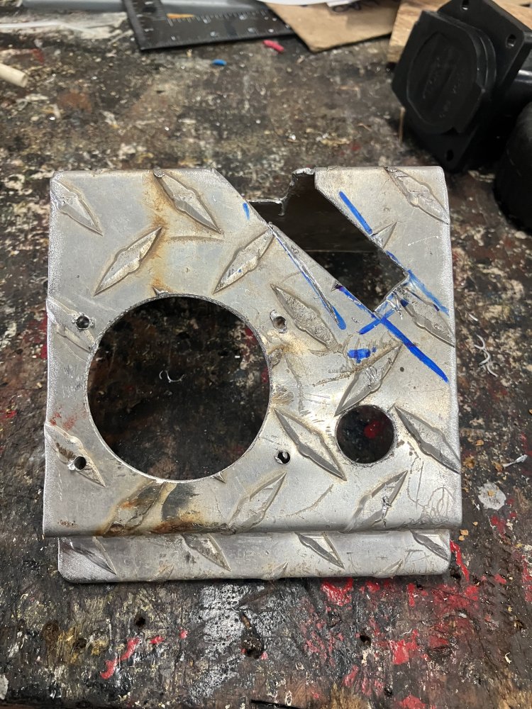

Remember I picked up a freebie beat up diamond plate truck box for a full-size truck a while back, and I’ve been cutting pieces out of it for all kinds of things.
I started with the section I had left under the work table. It used to run from the bottom, up the inner bed, over the rail, and up to the lid, about 8 inches wide. I cut off the top piece that had the lip, so I ended up with a 90° bend, with that lip on it.

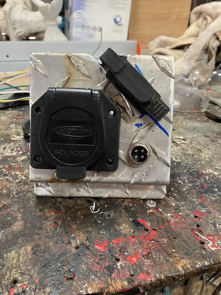

I cut it to an even width of about 7 inches. I had a 7-blade socket, a 4-pin sheet metal mount connector, and a 4-pin aviation connector already. The aviation connector was the only one I paid for, the rest were horse trading.
I drilled a 2 inch hole for the 7-blade, and a 5/8 hole for the aviation connector, and then I slotted across at an angle to mount the 4-pin trailer connector on a 45° angle. I cut the slot in a way that the mounting side of the mounts was not cut to maintain the integrity of the whole piece. The location was also to keep it up close to the bend, since it’s the one I’ll probably use most, and they would have extra strength the closer it is to the bend. Here’s how it came out:

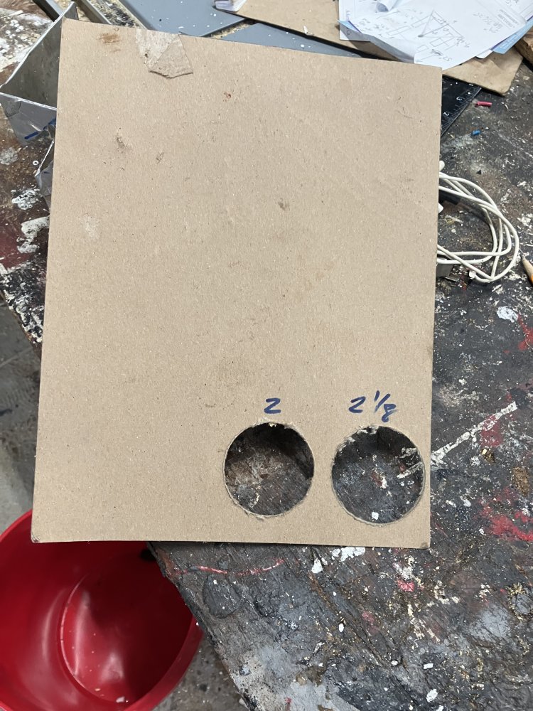

I misplaced my homemade hole saw template, so I started to make a new one. With all the weird fab I do on little stuff, it’s nice to have something easy like a piece of cardboard with the various holes cut out so I could just see what slides into what instead of fighting the caliper and figuring it out in my feeble brain.

I plan on running a little strut from the bottom to the top to keep it strong from bending when I plug into it, but I’ll be doing that and finishing it after I figure out how I’m going to mount it.
I haven’t thought about if I’m going to do polished aluminum, Silver, Red, black, or flat black finish on it, but it will all make sense when I get that far.

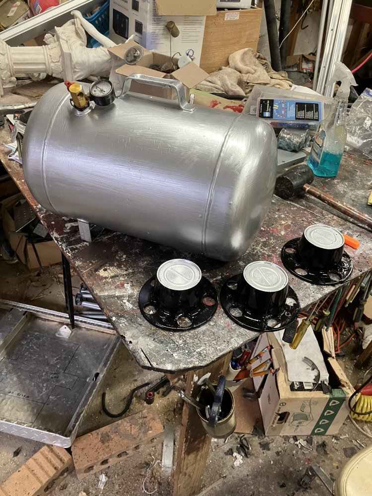

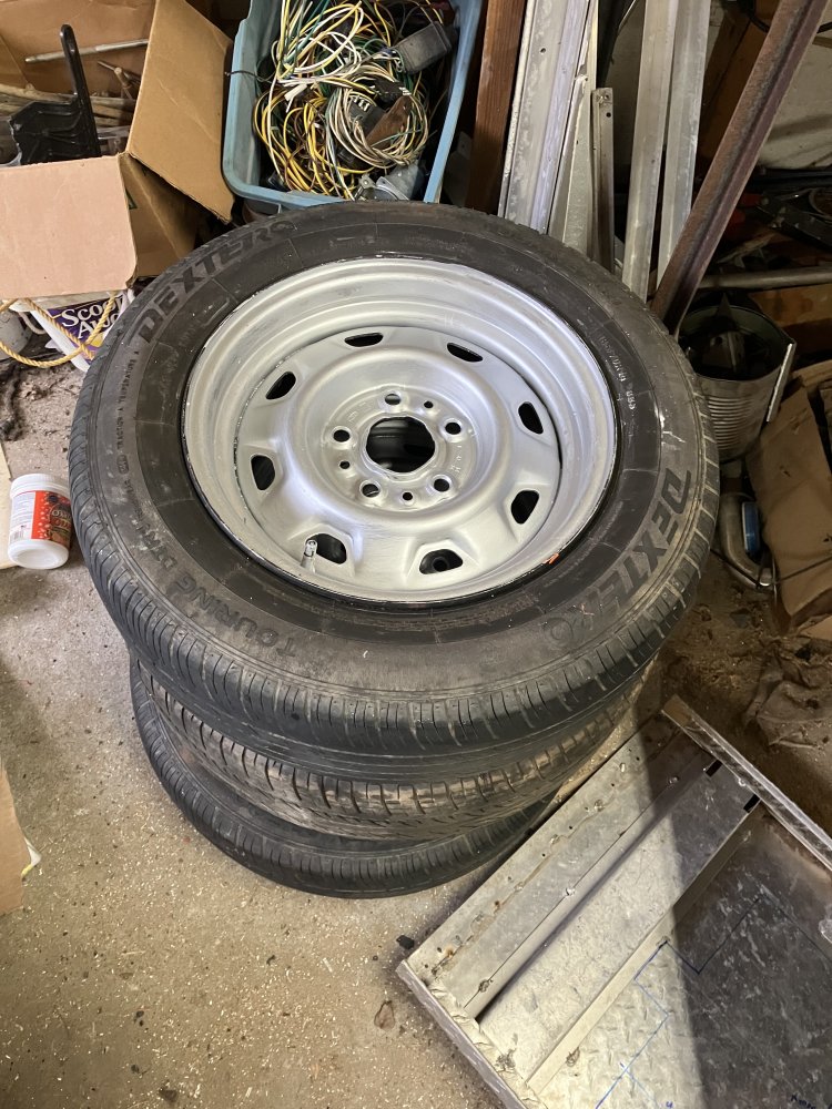

I put the second coat of silver on the 14” steelies for the trailer, and the first coat of silver and black on the center caps to match the truck.
The Missing Linc (1987 4WD 2.9 5spd short short)
When the silver dries, I’m going to do the red outline of the vent holes like the truck wheels, and I’ll paint the little outline circle with a cross line on the center caps to match the four-wheel-drive caps.
I have one 14 inch chrome trim ring, and I hate to buy four to get the second one, but they just can’t be found in the pull a part anymore. That will be a last minute thing, I’ll keep hunting.

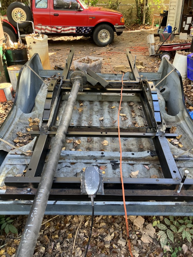

When I finally got my tail in gear today and went outside, it was actually drying up, so I decided to tackle the trailer a little more.
I got all the welding done on the frame that I needed to do when it’s upside down except two little braces. I also drilled the spring support channels, welded them on, and then bolted the springs on the front end. I’ll make the shackles for the tail end after I get the whole thing flipped over so I end up with the correct ride height to match the truck with the 3 inch lift. I mounted the spring mount channels “up,” actually down, a couple inches so I still have a little to play with to get it right
I also drilled through the frame so I can use the existing holes in the bed to bolt the bed on, and I drilled the holes to mount the back bumper and made up the bolts that I’m going to use.

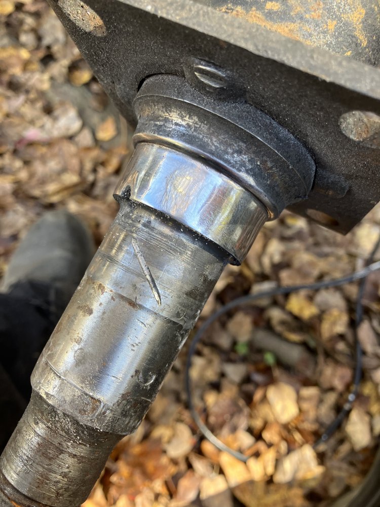

And before I realized I had a trailer hub problem, I finished cleaning up my axle w/2000 emery paper. You can see yourself in the reflection.
I wrote up the wheel issue in the thread “what did your ranger do to you today”

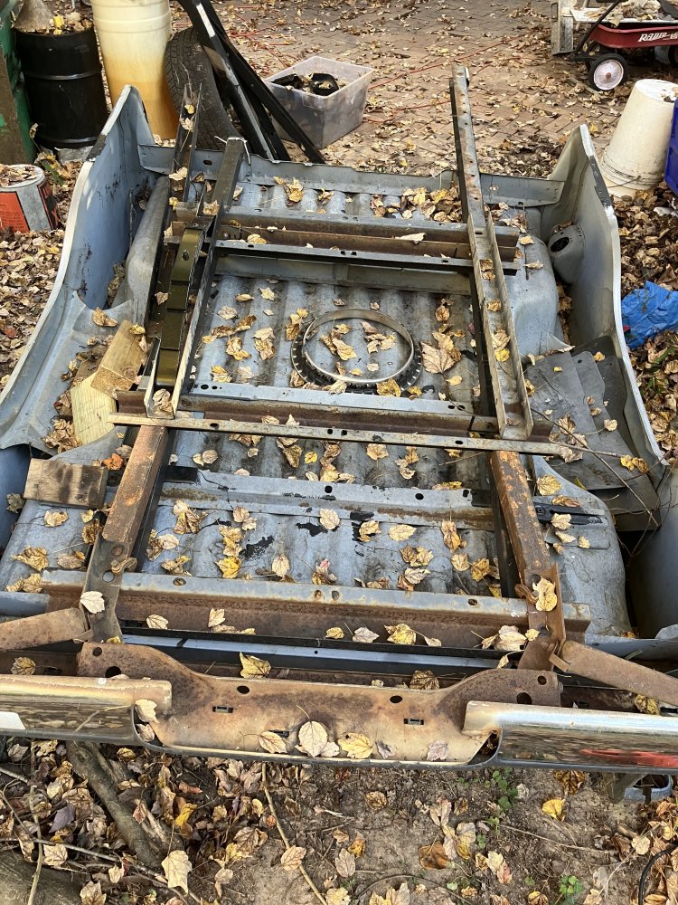

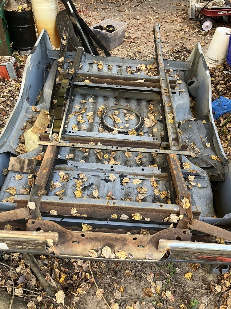

On the trailer, the ‘88 bed sits squarely on the straight 2x2s in several spots, but there is a gap in three places on each side. I was thinking of just cutting some oak blocks, painting them and sealing them, and then holding them in place with a bolt or screw.

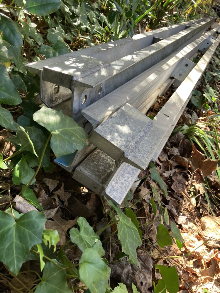

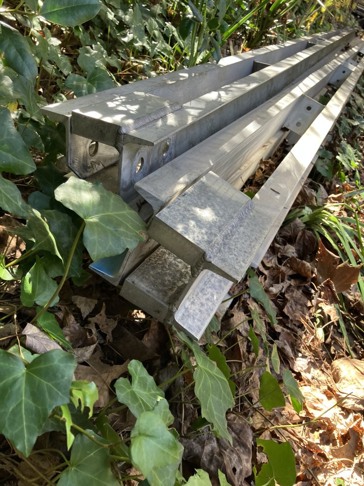

Then I remembered my aluminum channel beams had these solid aluminum blocks about 2-1/2” x 4” x 1-1/4”.
I’ve worked all the aluminum I’ve used to date with woodworking tools with no issues as long as I went carefully. I think I’m going to cut one of these blocks out with a carbide tip skill saw, and then see how easy it would be to cut it up to the right dimensions with my bandsaw. Then drill and tap it for retaining bolts. I’ll get my trailer frame blocks, and the experience I need for my next harebrained project at the same time.
When cutting aluminum, use lots of wd40 or equivalent while cutting. It keeps the blades from clogging up.
