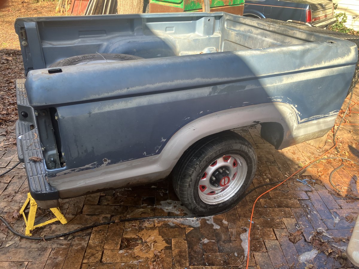

The Missing Linc (1987 4WD 2.9 5spd short short)

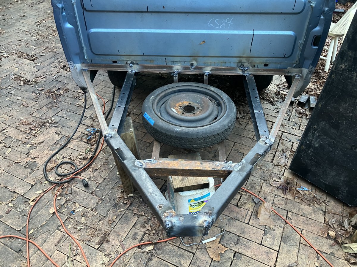

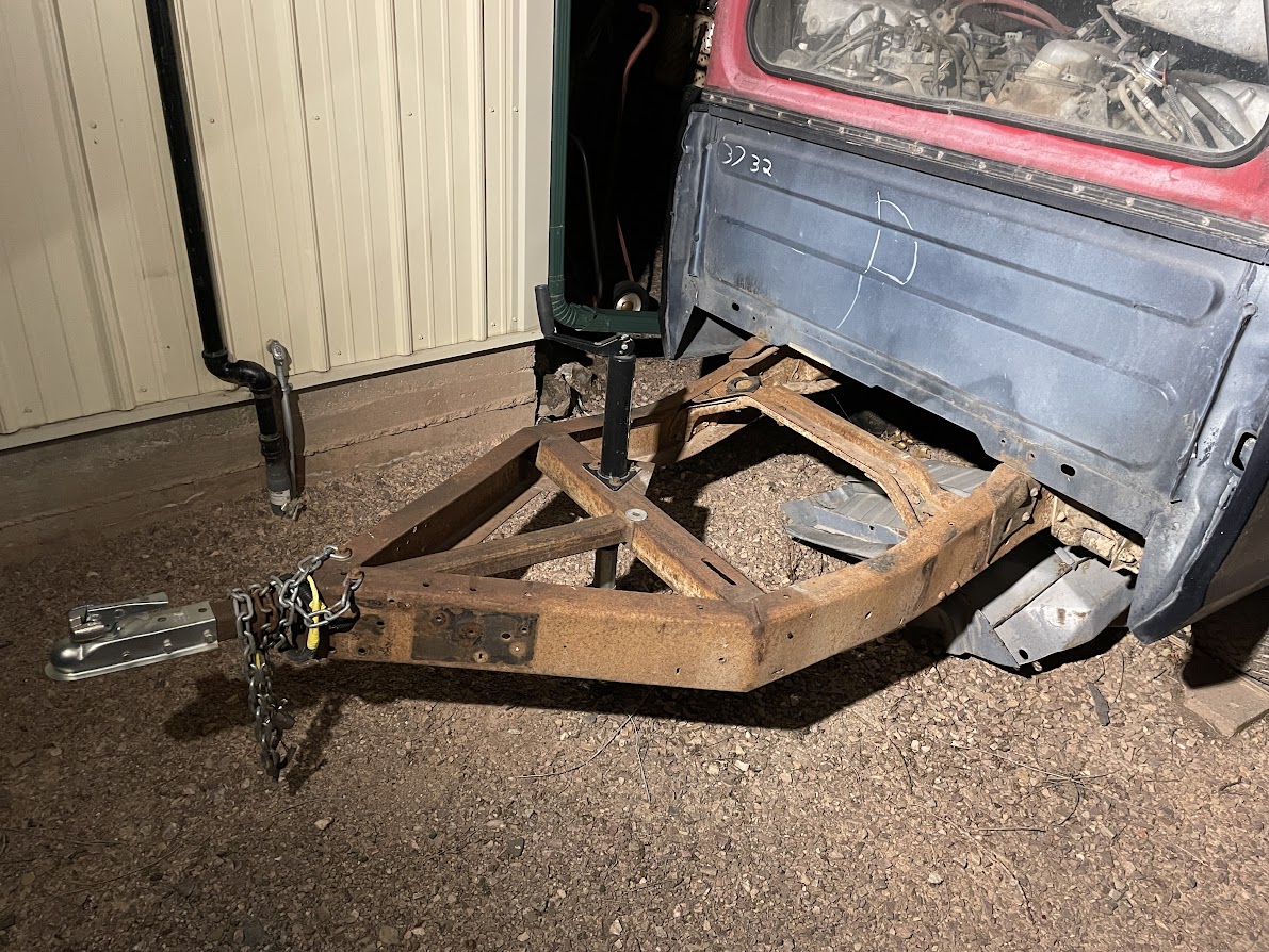

This is how I do Ranger trailers... and others. Note how much frame I left, lots of them have a really short tongue and they track like shit. You want long so you can put a tool box or something on there and generate some tongue weight.
I build a T out of whatever is on hand - 2" square works good. Tack that between the frame, cut pie shapes out of each frame rail near where you put the top of the T and bend the frame in so that it's touching the middle piece. Clean the ends of the frame up so it looks nice, burn it all together and then put a cap of flat strap over the ends of the frame and bend that around. The T also serves as an excellent place to mount a jack but I've done them on the outside that pivot on a swivel deal too.
As I've said before I'm not judging your project, most of mine just focus on two things - (a) the easiest route to my goal and (b) what I feel is the safest. I have no doubt that a Ranger rear frame can handle a reasonable load and not break. In fact the trailer pictured has two complete 351w engines and a 4.0 engine in it, plus a whole bunch of other heavy stuff. I build things so that if I died tomorrow and my wife had to sell all my crap to strangers, I could rest easy knowing that it wasn't going to fall apart on the road.
You can make these look as nice as you want. I spent way more time than usual on this one because I wanted to keep it... it's not done, I am going to build a storage box on the front and make it look a little more elegant like you say.

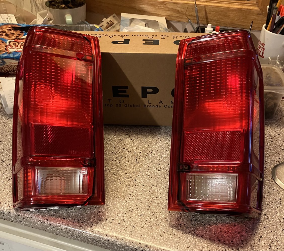

The new tail lights for the matching trailer came in today. They sure are purty!
I have 4 or 5 pair on the shelf from my scavenging, but they’re all pretty faded, and hard to sand, polish and clear coat. At $27.66 delivered, I can sell the rest as a lot on Craigslist, and have a little profit and new lenses.
Now I have to go scavenge at the pull-a-part to get a couple of Lincoln emblems to stick on to match the Missing Linc,

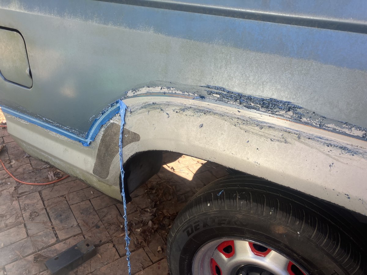

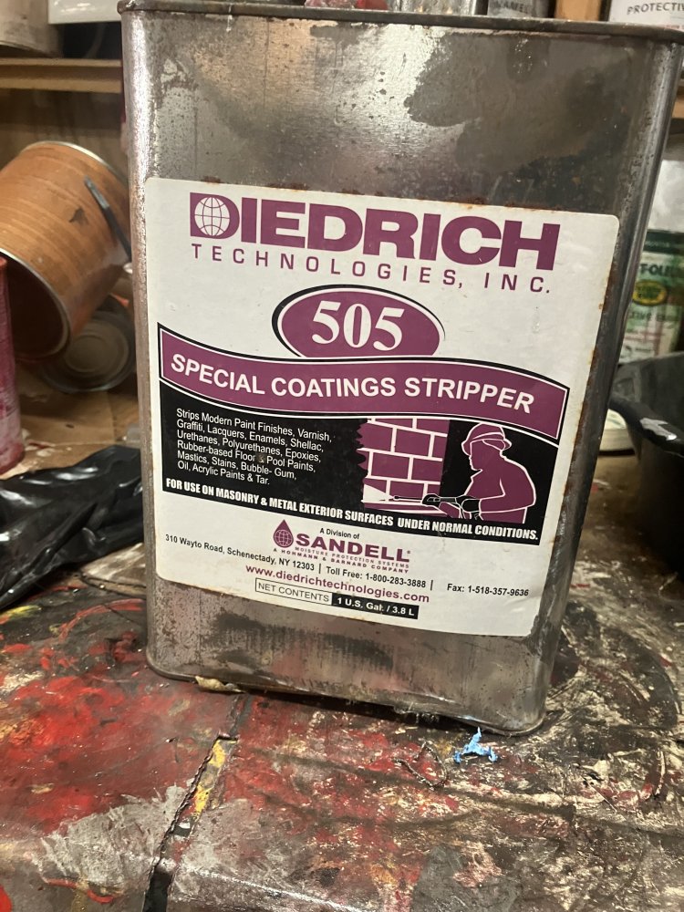

A while back, I picked up some of the old nasty as heck real paint stripper. I’ve done a few little jobs with it, but today I used it to take the pinstripe and the vinyl rock guards off the Towncart. I was just going to test a little spot, but it worked so well, I got the whole pinstripe off in about 10 minutes. But gosh, that’s nasty stuff. It took the blue paint off too!

I washed the residue off with super concentrated soapy water with ammonia.

Like always, I have to double check my welds, but I think I have the tongue frame the way I want it.
Using the skinny spare brought up the bottom of the spare tire basket about 5 inches. I’m not worried about it hanging too low now. I’m going to use something like expanded metal to make a basket around the tire, which could also a hold a jack and some tools, maybe a small toolbox. I have about a foot between the front of the tire and the support for the basket.

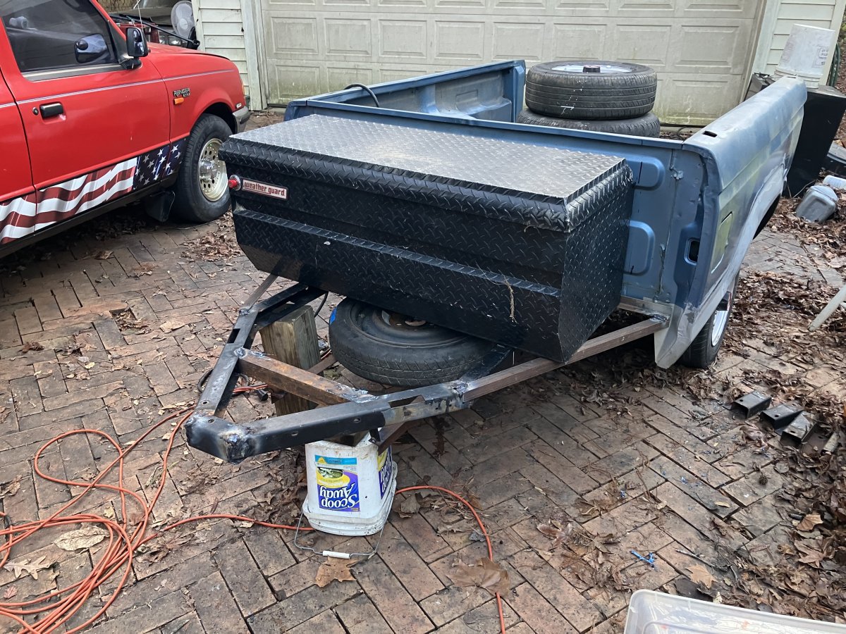

Here it is with the toolbox sitting on it

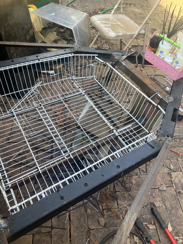

I lost the instructions from the wire shelving manufacturer, so I’m not sure if this is exactly 1000% right. But I think it’s pretty close.
It was under the fine print where it said. “alternate use of shelving material for spare tire, jack, and tool carrier.”

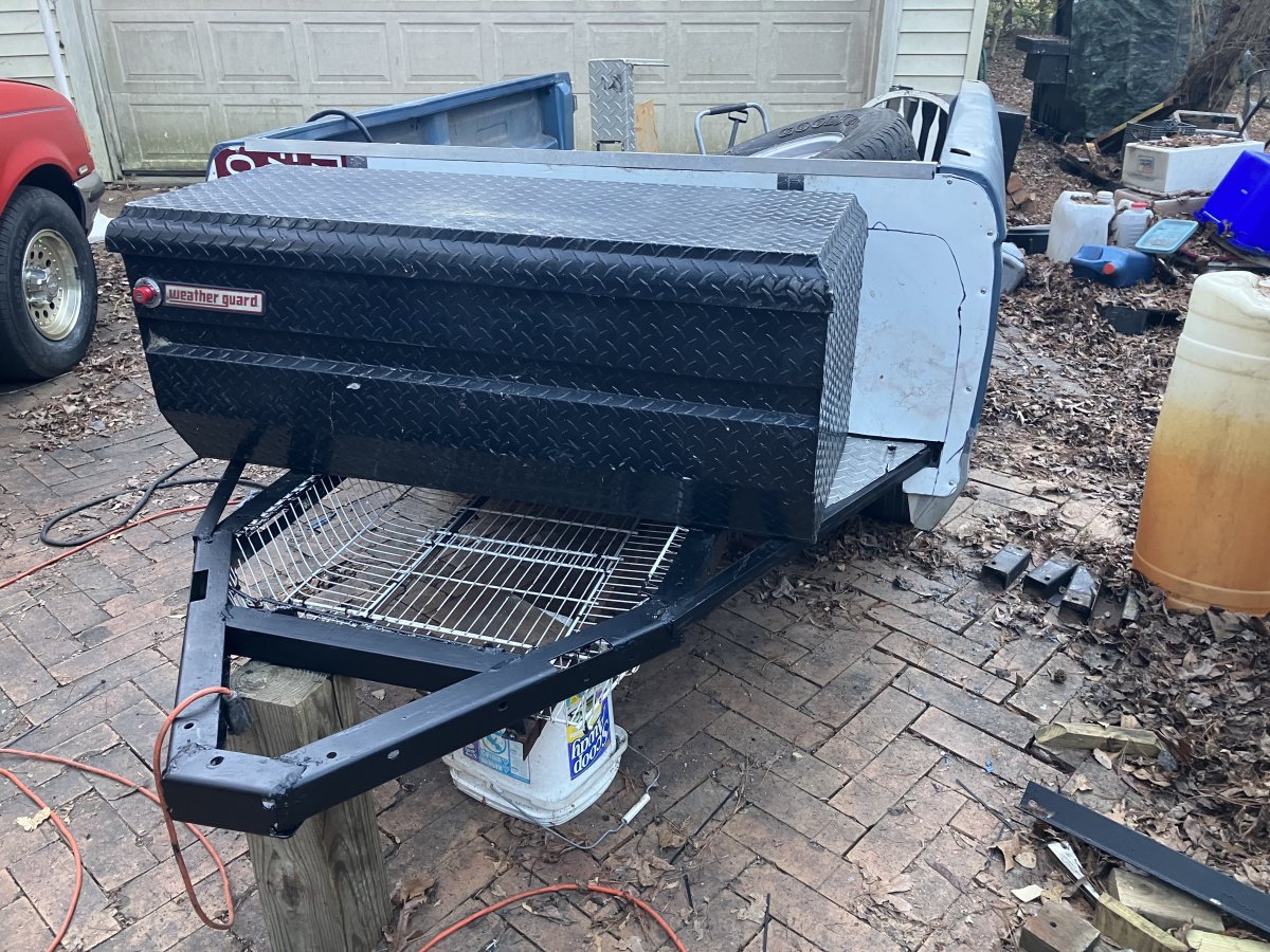

I only had a couple hours today, but I cut up more of the same toolbox (that I’ve been cutting up for two years) to make the little bottom plates each side of the toolbox:
I was able to use a piece of the long side of the box along the top under the lid. That way it has a double brake under the trailer toolbox that keeps it strong. Might look a little rough, but after I buff the edges, caulk, and paint it, it looked like it was made for it (by someone better than me).
I roughed in some diamond plate for either side of the toolbox on the front of the bed, and it just didn’t look right. Then I remembered I had this real estate sign made out of aluminum. It’s Aluminum that’s a hair thicker than a beer can laminated on both sides of some of that corrugated plastic sign panel stuff. It’s very rigid, and obviously it’s rust proof.
I contoured it to the outside shape of the bed. I’ll rivet it in, and then use caulk around the edge.

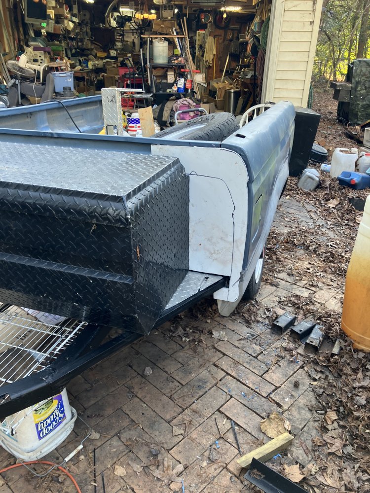

I riveted the face panels on the bed, capped them with a piece of my surplus 1 inch aluminum angle, riveted the tread plates down on either side of the toolbox, and I bolted the toolbox down.
The box is bolted to the face of the bed, and then bolted down to the frame, strengthening the tongue frame.
It was a pain in the butt because some idiot put a whole bunch of wire shelving underneath it, and it was hard as hell to get the nuts in place. I used another one of Rick’s Tips, I put a little bit of that E 6000 goop on my finger tip, and that held the nut steady as I screwed the bolt down from the top.

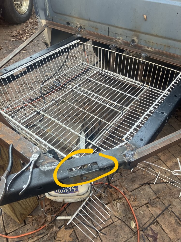

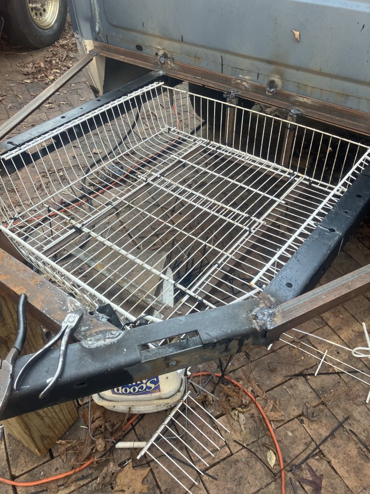

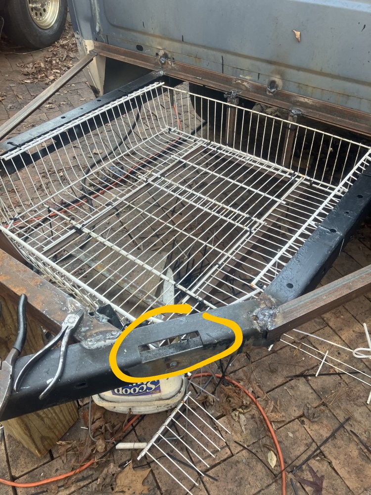

What's your plan for the hole in the top of the frame both sides? That a serious problem if you ever have a heavy load on that trailer. So easy for the frame to buckle there.

I was aware of that, but I haven’t figured it out yet. I know I have to beef up that whole area. I bought a tongue jack, but not sure how I want to put it in yet, and I still don’t have a Pintle Hitch set up that I like. It’s falling together like I did the Road Ranger trailer. I do have a good understanding of all the stresses and necessary bracing, just haven’t got that far yet. But thank you, more eyes are all better than less.
An afterthought on bracing the tongue. Remember that I started out with a harbor freight 4 x 8 trailer frame. As stated before, if I had to do over again, I would’ve just used 2 x 2 or 2 x 3 tubing, using the harbor freight frame actually complicated the work. That’s rated at 1,250 pounds I think with the little axle they put under it. I used a 3500 pound axle.
The Ranger bed itself it is pretty stout, and bolted to the 2x2s, I’m not worried at all about the load carrying capacity up to the front of the bed, up to 2000 or 2500 pounds, but I’ll never load it that heavy. No 57 stone, well, at least not deep.
If you remember on the Road Ranger trailer, I added two little tiny braces that were supposed to be temporary (remembering I was finishing welding it together at 5 o’clock that night before I was supposed to be at the Carlisle 40th, 700 miles away).
Little tiny braces like that, compared to the 2x3 frame member, can take a tremendous amount of stress off the angle joints. While they were temporary, they’re actually an interest point on my creation, and I’ll probably just clean them up and leave them alone. They’re welded to the upright, and bolted straight through the frame. The minuscule amount of motion allowed by the bolt, versus a solid weld, almost doubles the protection of the main corner. The little bit of flex removes a hard break spot where fatigue can develop. I’m not saying it won’t, it’ll just take much longer, and the brace will slip before the joint breaks (hopefully not at the same time). The diamond plate is pinched down by that bolt, the soft aluminum being another buffer
On this trailer, I bolted the toolbox through the frame on the bottom, and then bolted it through the face of the bed. That makes the sides of the toolbox the “braces,” removing a tremendous amount of flex at the point where the frame exits under the bed. The complete box further strengthens the sides as braces.
Of course, that just shifts the flex point up to the front of the box where those two rectangular holes were in the metal I used. Consider that the closer the “week point” is to the hitch, the shorter the “lever arm” and the lower the bending action. Point being, it wouldn’t have to be a very big brace.
