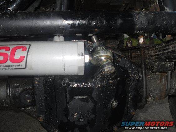

WHOA it's a fancy tierod end with no boot. and prolly Gob's more flex! kinda cool. somone should really start making high angle TRE's for factory application's
easy to put a boot on that critter
Those Evo TRE's are wicked. I was going to pick me up some of those, but a normal 1 ton Chev TRE should suffice.

If your using heims for 'strength' over a TRE, you may wanna click THIS link and check out Evolution Machines TRE's... they are the cat's ass.
Yikes! Those are pretty dang pricey! But as stated before, I'm using the Heims since that's what the holes were allready drilled out for.
also looks like you bought 3/4" heim joints. 3/4" shank 5/8" ball is the joint that size you want for steering.
5/8" would have worked, but as I noted before, the PO had allready drilled it out to 3/4". Work with what you got I suppose.

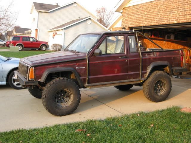

The Death of a Cherokee
The Ranger has been kicked out of the garage for the past few days to allow me to strip down my other wheeler. I did grab a few photos of the XJ and the Ranger hanging out next to each other for a bit. Considering all the places I managed to squeeze that XJ in, the Ranger looks way overbuilt sitting next to it.
The poor XJ had been sitting still long enough to become a bird sanctuary.
Pulling the Stroker out.
And a few more hours of wrenching left me with this.
Finally, the XJ moved out tonight, which is good as the garage has gotten a little crowded lately...

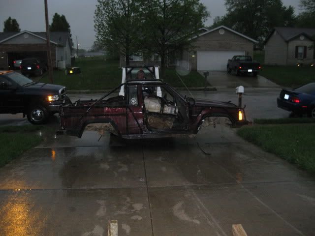

My pop came by with the Bobcat and we loaded her up for the "Last Ride". The rain was fitting, as I'm a a little bummed to see my first Jeep go away...
Quick trip down memory lane...
.. And there she is
This shell was utterly done for after 4 hard years of wheeling (2 without a top). So for the first time in over 4 years, I no longer have a Jeep. It feels kind of funny as I’ve owned this vehicle longer than any other vehicle prior.
wouldnt a 3/4''-3/4'' with the 3/4-5/8misalignment spacer's be better for connecting from the pitman arm to the knuckle? :dunno:
as for you knuck's bein drilled out to 3/4'' you could allway's drill them out to 1'' and buzz in some 1 ton tre insert's
what is your logic behind that? It still leaves you with a weak heim joint body.
you just use a 3/4-5/8 heim with regular misalignments
Like this -
I was gettin too much bind without the misalignment. was going to limit my down travel quite a bit. in a flat situation i was using 3/4 x5/8 (tie rod) but for the drag link i had to run the misalignment's and have had no negative effect's aside from wearing out heim's which is aparentely typical.
this is the first setup (d30) with the uber tall coil's in it. i ultimately had to lower the front to bring every thing back into check. but i'm still running the misalignmetn's or it would bind about halfway droped out. just no other way about it that I see. i do see where your coming from with strengh as the 3/4x5/8 is nearly twice as strong.

....as for you knuck's bein drilled out to 3/4'' you could allway's drill them out to 1'' and buzz in some 1 ton tre insert's
Whoa, such a beast exists? I was looking for something of that nature but couldn’t find anything so I just went with Heims (didn’t really have the time to make them myself). Got a link by chance?​
As far as strength goes, I’m not worried about killing these heims and I’d bet that they’re stronger than the 1 ton stuff. However, heims seem to get sloppy quick, so I’d rather go to at TRE at some point in the future. Possibly before our MT trip later this year.​
look at my picture again. that is a 3/4-5/8 joint with misalignments and 5/8" bolt. The style spacers you run sleeve into the ball. They make spacers, like mine.. that do not do this.
O.K. I see what ya got goin on. anywho I dont think i'll ever go with the HEIM's again as they dont last. that is unless the ruff stuff one's last alot longer. i am definately lookin at goin wit the GM ton tre's for 250$ dosnt sound like that bad of an option as they should last year's instead of month's
