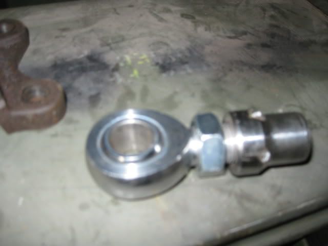

Broken stuff sucks, especially when its new. I bought my steering heims at an end of the year sale, I just now got a chance to play with them. Unfortuneatly, one of the tube inserts gave me alot of trouble.
The Lone Ranger – Kage’s ’94 X-Cab Leaf SAS and Bed Bob
It threaded on fine until abou the halfway point when it got "tight". So I tried to back it out to see what was up. No go, that dude some how managed to sieze itself onto the heim. So I put it in a vise to try to get it apart:
-12" pipe wrench wouldn't touch it
-24" pipe wrench wouldn't touch it
-24" pipe wrench, and some heat didn't do it either.

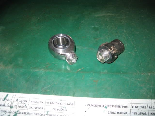

-24" Pipe wrench, Lots of heat, 6' Cheater bar, and a pissed off fat guy got me this:
Best guess is that it broke somewhere in the neighborhood of 800ft-lbs. Annoying since I now have to wait for another one to show up :annoyed:

Splitting the insert would have been cheaper.....

also looks like you bought 3/4" heim joints. 3/4" shank 5/8" ball is the joint that size you want for steering.
