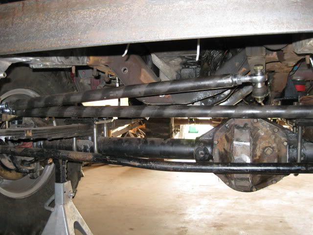

The photo is deceptive as the pumkin is offset of the K member some. I still need to trim a little more but it looks like this:

As for the steering, I did a little drinking on it and I think everything is going to work out ok after all. This photo is nearly at full compression (still has about 3/4" more uptravel to go) and full lock:
The Lone Ranger – Kage’s ’94 X-Cab Leaf SAS and Bed Bob
So while it dang tight, I think I'm good to go. If not, I'll go ahead and notch the frame to clear a longer/flatter pitman arm.
