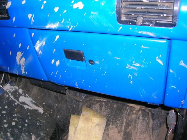

First off I popped out the glove box and hung it down so I could get a better view of the new ECM location directly behind the glove box up against the the outside of the heater box.
The Deuce
Here it is folded down and uncut.
The Deuce
Not the best comparo shot but here it is after the cut. I cut out approx. 2 inches of glove box with this mod. I ran a cut around the back of the glove box and then trimmed it so I could slide the back half back into the front half making it shorter so the ECM can fit behind it. Then drilled and riveted it back together. Still fully functional too, only has a little less room now.

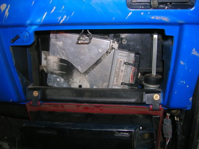

Here's the ECM mounted in it's new location. I was even able to use the factory mounting piece to secure it to the side of the heater box behind the glovey.
The Deuce
Here's an inside the glove box shot, as you can see it still functions as storage space and now allows room behind it for the ECM.
The Deuce
Here's looking up at the new ECM location from under the dash.

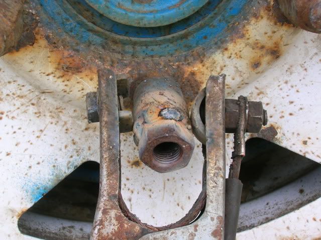

Also pulled the rear drums off to re-seal the axles, install the new wheel lug studs and clean up the back brakes. So I insert the key for the cheapo locking lug nuts I have on there and the drivers side just rounds off whats left of the key pattern inside the lock with very little effort....Damn, I knew it was coming as these locking lugs suck ass to say the least. You know the kind with the key that slides into a cut out pattern on the end of the lug nut. CHEAP JUNK IMO.
The Deuce
Then I grabbed my largest pair of vice grips to give that a try and no go whats so ever.....FAIL.
The Deuce
So then I start thinking grinder. Thought about trying to cut the lug off without damaging the wheel....yeah right hey, then I thought about cutting a big slot in the end of the lug nut and using my tire iron hub cap flat blade on it when it came to me..... weld another lug nut to the top of the locking lug nut.
So out came the Lincoln.
The Deuce
Weld spare lug nut on top of fubard locking lug nut.
The Deuce
Viola!! Spun right off without issue.

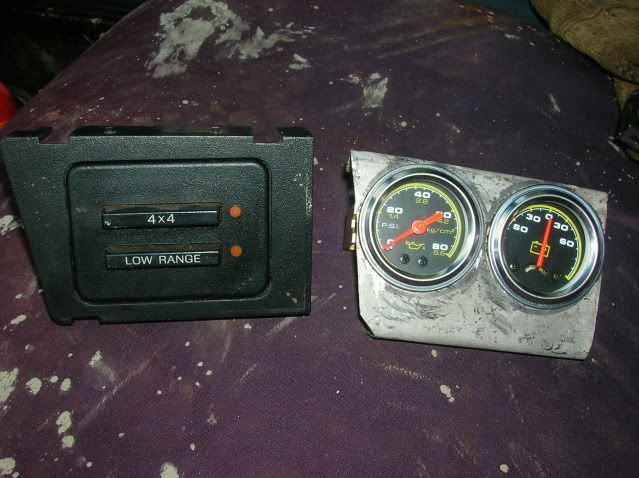

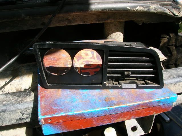

Also did a gauge install over the last few weeks as well. Decided that the factory elec tcase controls on the dash that aren't used in my application would be a great spot for a couple gauges to reside.
Factory 91 Explorer elec tcase controls, my tcase is a manual tcase and these controls aren't used.
The Deuce
Popped the tcase controls out of the dash mount.
The Deuce
Cut out and bent up a small piece of sheet metal to mount the gauges into.
The Deuce
Cut and shaped to fit where the tcase controls originated.
The Deuce
Threw some satin black on it.
The Deuce
Drilled both the factory bezel and the gauge mount for rivets to hold the gauge pod in the hole.
The Deuce
The Deuce
Riveted in place and ready for gauges.
The Deuce
Gauges installed in bezel, don't mind the actual gauges, I'm using water and oil in this set-up but was easier to use the amp and oil for mock ups.
The Deuce
Actually installed in the dash with the proper gauge combo I need.
