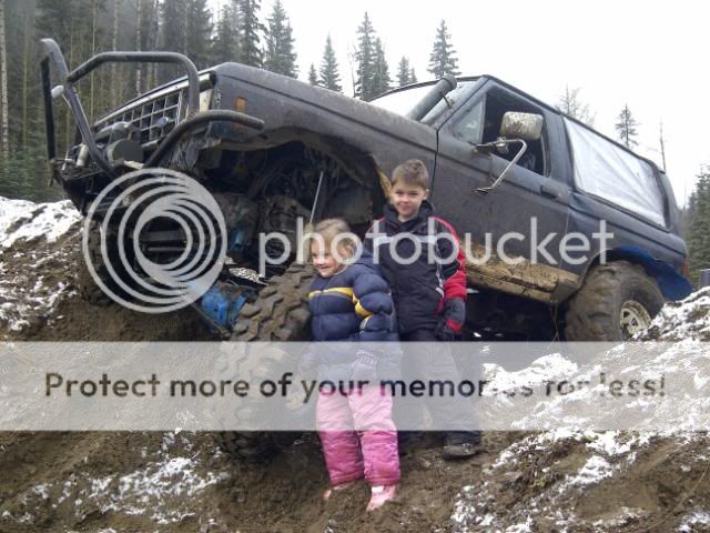

Couple days late but here's pix!
So we went out and first obstacle I snapped a rear ujoint AGAIN! GRRR! So I did the rest of the trail in front wheel drive and to my surprise it did pretty good actually. Had to winch up a couple hills but other than that she did good. Busted out a rear side window too, dammit. Had to take a bypass on a few obstacles and ended up leaning the back window into a tree and it popped. sigh. Looks like I need to either find a replacement used or plastic....
She actually drives real nice on the road in spooled front wheel drive too.
Airing down and disconnecting sway bar at the trail head.
Onto the trail.

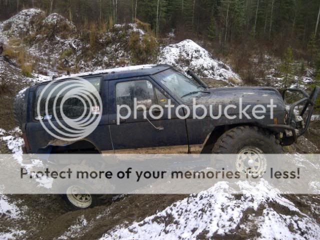

Then I take a few attempts to climb a steep short climb where my front bumper hits on the way up and my back bumper hits on the way back down for a second run at it. Few tries later and my rear shaft spits out the ujoint caps and goes BANG! DOH!! Rear shaft failure is too common lately, must be time to upgrade to 1350's.
Here's the climb, looks easy enough and should have been if that joint didn't come apart, I wasn't even being hard on it yet dammit.
Here's how far I made it and kept tagging that tree with my passenger rear tire until the joint snapped.

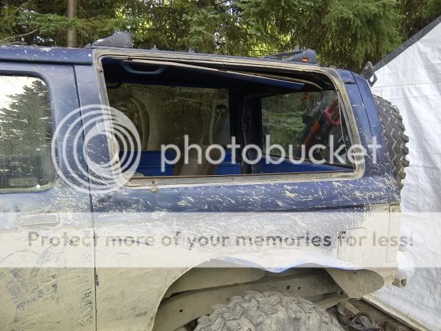

I was looking at it yesterday and I'm fairly confident it will still hold up I just gotta be careful to not hit it any more or bend it back and beef it up. The reason it bent up on me is because I dropped off a log and hit the shackle end of the leaf spring on the log and it bent the mount up, I've done this twice now and the mount has a good inch or more of upward angle to it, no cracks just bent it. When I bent it the first time I didn't realize I had done it,, but the last time I put 2 and 2 together. The same obstacle did both hits on 2 different trips, I thought it was just my rear bumper that hit, but last time my buddy pointed out my shackle and mount had bent on that hit, DOH!
I chipped away the undercoat and dirt and stuff and it looks like the mount is actually not rusted away like I thought, it's just a very light duty design by the looks of it, thin stamped steel. I'm thinking about just trying to bend it back and gusseting it for now just to add some strength back to the already bent and possibly fatigued metal. May as well gusset both shackle mounts while I'm at it if I do go that route. I just can't justify replacing the mount with another thin steel replacement part that I'll have to remove from both vehicles provided I can even find one worth taking. And going through the trouble of fabbing up a entirely new shackle mount for it to just be replaced with links in the near future is also not high in my books.
I'll definitely be wheeling her some more once I get funds in order again, no question there, lol. It's just a question as to whether I fix the mount or leave it for now. I figure if I pull the blocks out of the rear springs I may as well bend the shackle mount back in place and gusset it, but at that point it will require the front be lowered too, so again I'm on the edge of a few options and obviously haven't had enough to push me over the edge and actually do something about it. lol

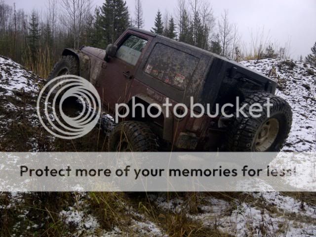

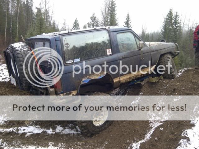

Here's another dilemma I have encountered again, went out wheeling and now I know definitively what is causing the Deuce to spit out its rear drive shaft from 3 of the last 5 trips out. Axle wrap. I kinda figured it was the culprit being I have 3" blocks under them sploder springs and I'm spooled on 38's, but I never actually felt any wrap or binding until this last trip. Full throttle hill climb assaults spinning all 4 tires in deep soft sand I could feel the drive shaft binding as it rotated and the more it dug in the more I pronounced it was. So after that I kinda took it easy on the full throttle aspect.
After a few hours out ditch wheeling we came to a fairly steep climb that was hard base dirt with a couple inches of goo on top, buddy in the Cherokee on 35" old style bfg's went up full tilt boogie red lined and mud flying all the way sawing his tires back and forth as he slowly spun his way up barely making the climb, JK second he has brand new 37" Xterrains he spun up the hill but was no where near as dramatic as the Cherokee, last was me. I pulled up to the climb and decide to crawl it, low range, first gear at just above idle, I had no trouble till about 3/4 to the top when I stopped moving forward and sat there spinning all 4 slowly. I started sawing the wheels back and forth but didn't climb any further. At that point I pressed the throttle to the floor and she started to spool up to about 4000rpm when I decided I would roll back and couple inches and gun it....Yeah All that happened was clunk and I knew exactly what that sound was. Then I slid down the hill backwards to pull the rear drive shaft and drive out in front whee; drive again. :(
Needless to say I'm now at a cross road so to speak. Do I take out the blocks and keep the leafs and possibly build an anti-wrap bar, or build an anti-wrap bar and keep the blocks and leafs for now, or pull it apart and start building links that I cant afford anyways. lol
I know I know do it once do it right, I know but I cant afford to do it the way I want right now, however I prolly can afford to swing an anti-wrap bar under there for very little coin. U C I have the old stock radius arms from the 76 d44 front diff I have under the Bronco and I have enough scrap steal kicking around to turn it into an anti-wrap bar. Weld a plate to the diff to bolt the rad arm to solid and then build a shackle mount at the frame end for it to move fairly freely throughout suspension travel, I have a couple 3/4" heims that would fit the bill for the shackle mount too.

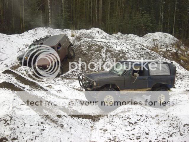

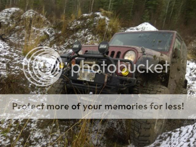

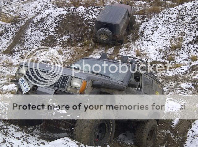

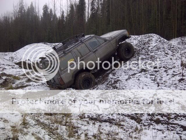

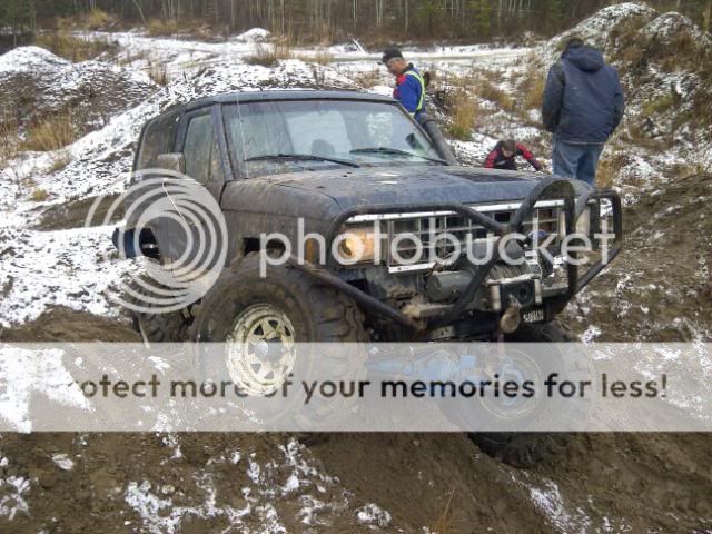

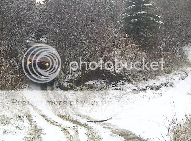

Couple of us decided to head out for some ditch wheeling.

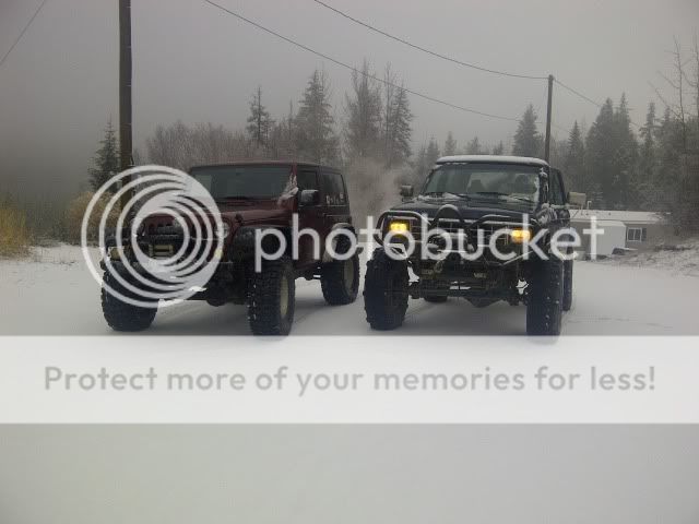

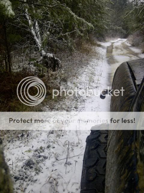

Yeah this is our 3rd snow fall this winter all ready the first snow fall was a couple days before Halloween, the first 2 didn't stay but this one has stayed since Friday. We usually get snow in mid to late December that stays but the last few winters have changed, more snow and colder weather seems to be the norm now as the last 3 years have been at least 3 feet deeper snow and a lot longer stints of below -40C ish temps.
Ah well snow wheeling is a blast and when you have snow on the ground for 6 months of the year you learn to make the best of it.

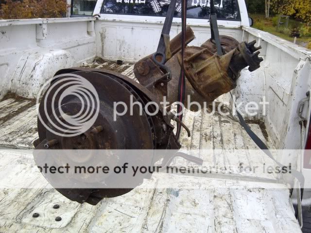

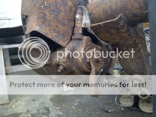

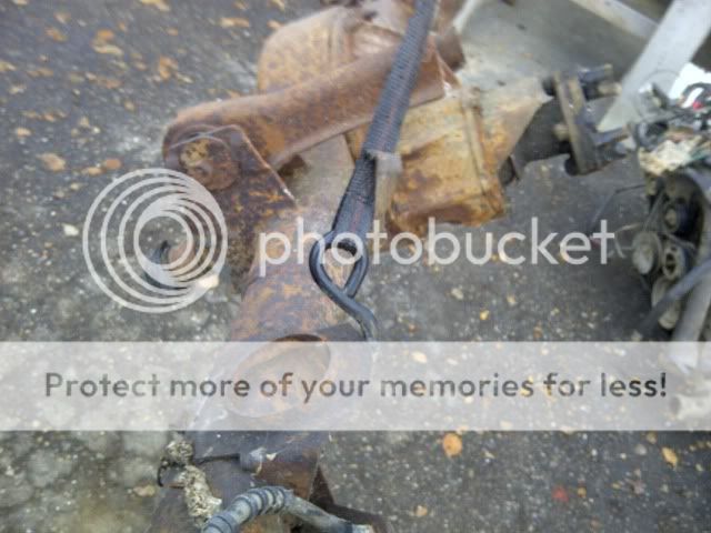

Did I show you guys what I picked up for 50bux about a month ago?
It came out of a Lincoln Mark 5 from the 70's. It's the exact same width wheel to wheel mount as my 65" truck 9" and has the same big bearing 31 spline axles and 5 on 5.5 bp as mine too. This ones already set up for 3 link and coils to boot. Only down fall is it has 2.75 gears lol so the r&p are not useful to me.
