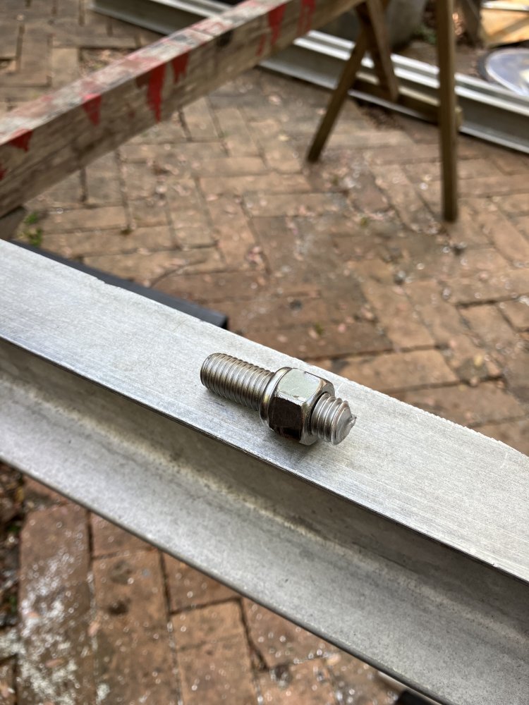

I got the bolts beefed up and swapped out. I’ve got enough aluminum to build 10 of these, but I was able to flip the brackets over and re-drill them, and only wasted the first one while I was figuring it out.
I feel like I spent the last week getting back to where I started. Anyway, I like this much better and I’m much more confident about dragging it behind me. The delays also helped me get my head right on how to mount my axles.

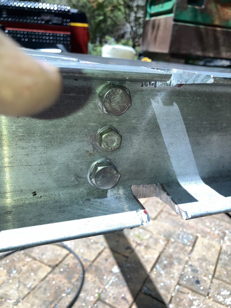

I don’t know how I did it, but I seized up two of the brand new half-inch stainless bolts in the brand new nuts. One I had to cut off with the saws all, and I was astounded that I snapped one!
I tried using a breaker bar to finish tightening the one I snapped off, and I banged my finger pretty good when the socket slipped off the bolt. But after seeing @superj ‘s guts hanging out the end of his finger, I’m embarrassed to just mention that I got a little pinch. And yes, my gloves were sitting right there.

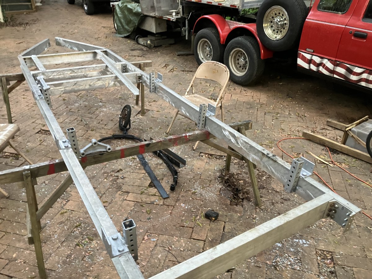

Now I’m seeing progress

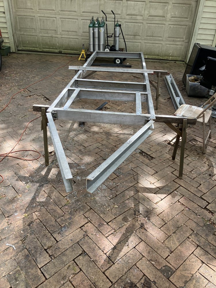

I wanted to start on the axle mounts and axles, but I realized it will be much easier to bend in the tongue, and do the frame for the gas grille etc.,, before I put all that extra weight on it.
Gas grill has a bolt on base that sits about 5” off the ground. The sides are bent inward and actually bolt to the base from the top. I’ll take that off.
I’m planning on more channel around where it will sit, but placed so the gas grill will slide inside the frame, not sit on top of it. Before I flip the frame over, I’m going to put a solid floor across that area, so when the gas grill slips in, it’ll actually sit about 4 inches lower. With removing the skirt, that takes 9 inches off the height, which should be about right - and I don’t have to cut anything. 20 pound tanks will still fit underneath it, but not the big tank. I’d like to keep the big tank, so that may take some more figuring. I might be able to let it hang out the bottom, but I don’t want it too close to the road.
I’ll also bolt through the sides into the aluminum frame so it’s solid solid as a rock.

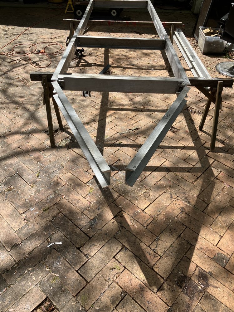

I think my biggest fear was bending the channel for the tongue, been fretting over it for weeks. I can pick up the whole frame (so far), almost with one hand. I slid it off the sawhorses, laid it standing on its side, and bent the channel in place in less time than it’s taking to write this. Flipped it, did the other side. Maybe 15 minutes total, piece of cake, perfect.

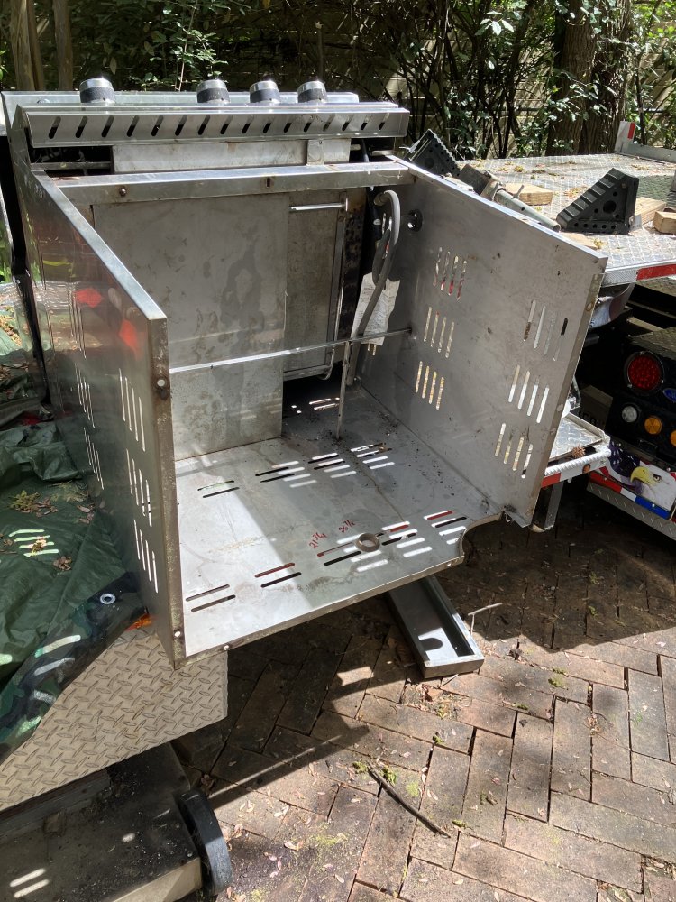

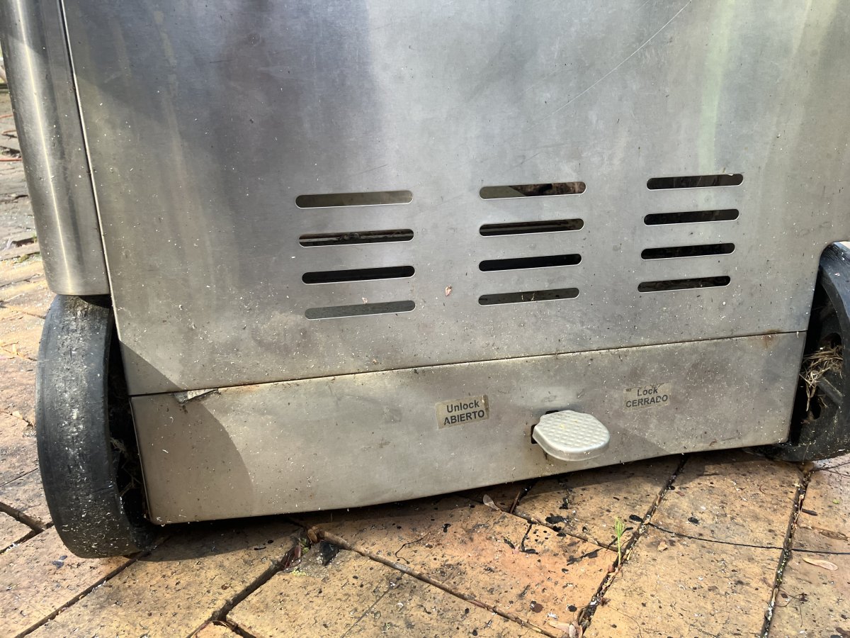

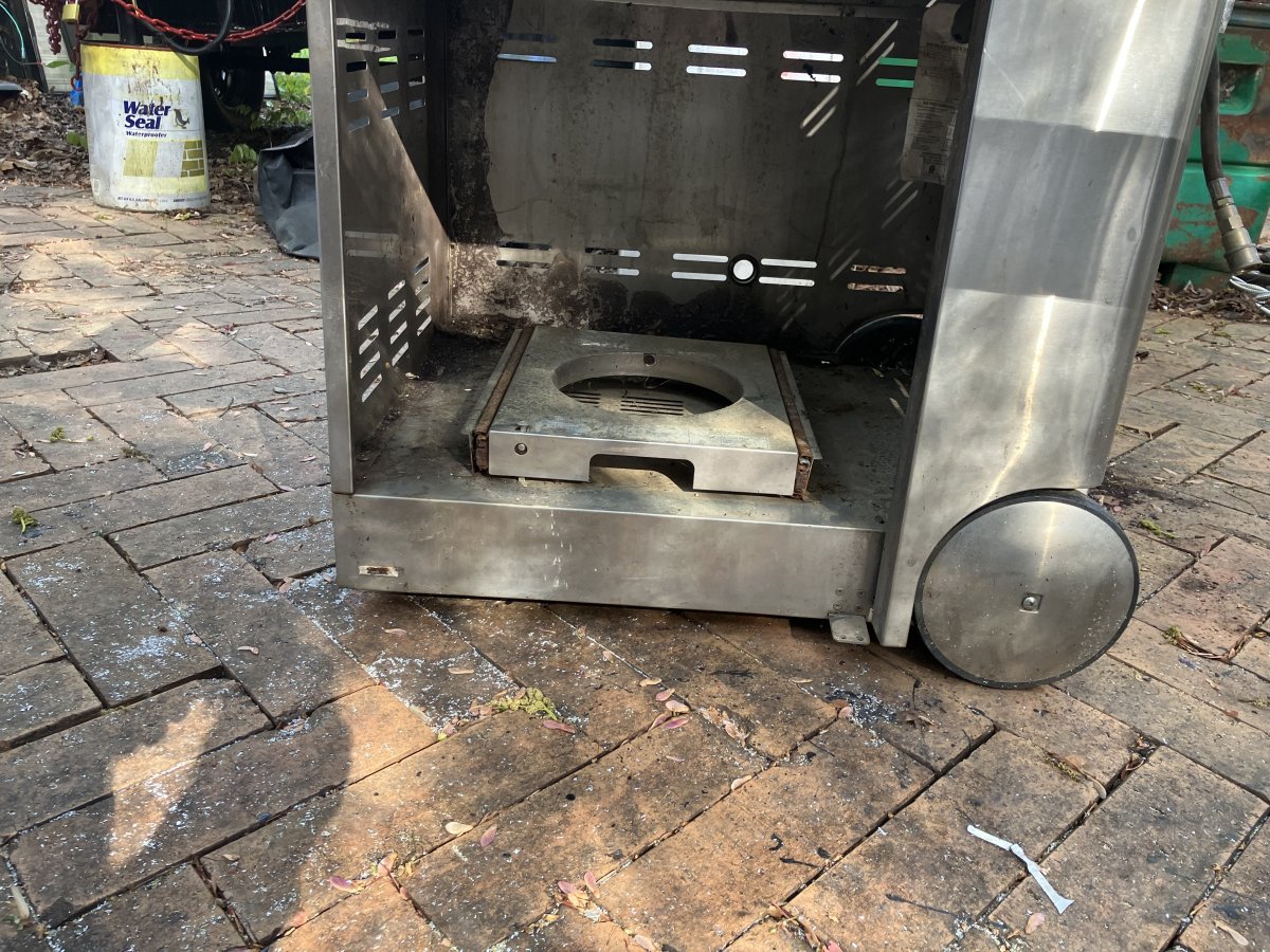

Then took forever to get the base off the grille: 6 Phillips screws. Actually 3.
There’s a lead counterweight on the bottom (40#s?), all together I think it weighs 80-100. Very awkward & top heavy, and I didn’t want to damage or scratch it. If I laid it down, I couldn’t reach the screws. I ended up laying on the bricks on some 2x4s and plywood. Too old for that crap.
6 screws hold the sides on the base. 3 zipped right out. The screws are high quality and the stainless is very high quality, but the built in female threaded thingies are crap and three of the screws were frozen. I stripped the Phillips slot on one, and the other two spun the nut thingies. Angle grinder couldn’t get at either side, and my fat ass (head?) barely fit inside. I took the guard off my 4-1/2” cut off wheel, and chipped away at the screw heads. And, BANG, just like that 2 hours later the base popped off!
The facia on the right also proved a challenge. Three teeny tiny high quality screws held it in from the back side. No way to see them, & couldn’t get a screwdriver on them, only about 2-1/2” head space. I fiddled with one of those tiny ratchet screw drivers for 30 minutes before I realized they were the only three screws with a slot head, not Phillips, on the whole thing. Got them off 10 minutes later.
With the grille sides free and clear, I got the measurements for the trailer slot spot. I made and installed another 4” channel cross piece and put it in in less than an hour, drilled, tapped, screwed and back up bolts. Then I split a piece of channel into two heavy angles and mounted them on top (actually under-it’s upside down), so between the channels and the angles, it’ll cradle the grill. I’m going to use the same six holes to screw it down, and also drill 4 bolts through the channel. I need one more little support I have to add across the back side.

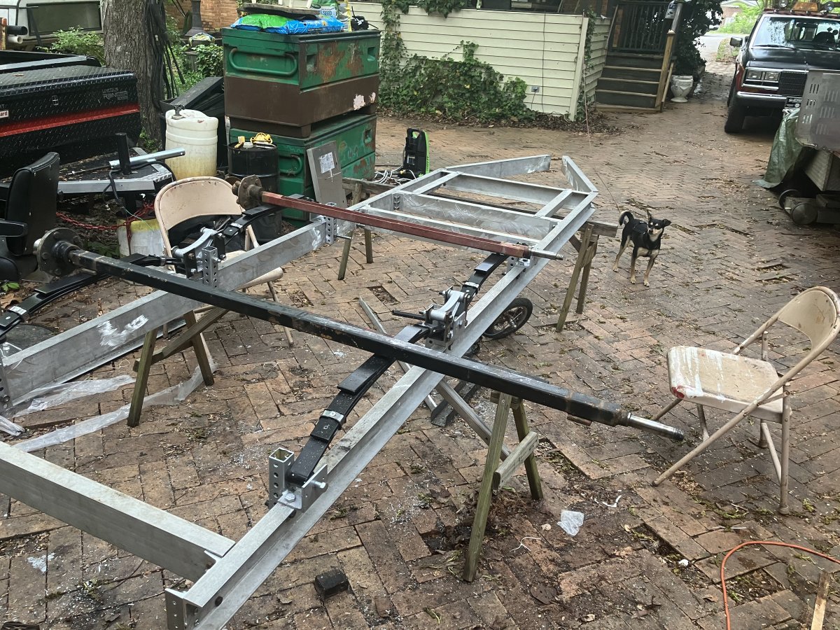

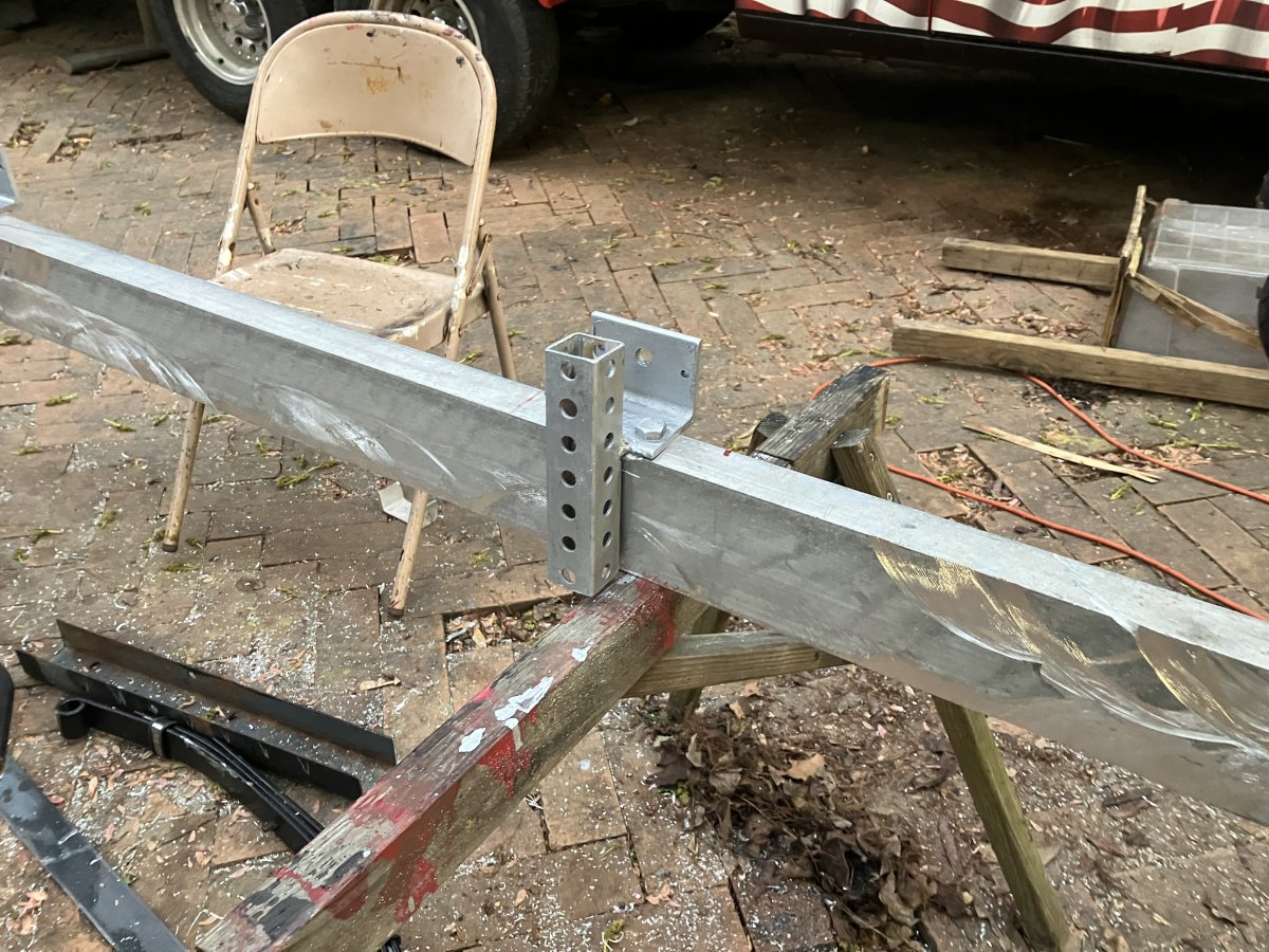

I finally figured out my spring hangers, got them made, and got them painted and temporarily installed.

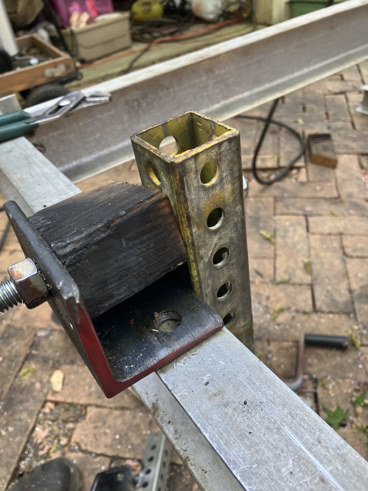

I used a piece of 2-1/2” angle, and welded it to some heavy unistrut pieces I had for the other side. Sounds crazy, but I want to mount a side to side cross piece to reinforce the spring mounts. I did a little research, and with potential liquid loading, sloshing around, there’s a concern with the aluminum channel warping. I think it’s all overkill, but it fits in with the whole fooling around with it with no purpose whatsoever motivation.
The holes in the unistrut were a hair smaller than a half inch bolts I’ll be using. I up drilled the appropriate holes to that half inch. I cut a little piece of 2 x 4 the exact width of the axle with its bushings, and then bolted the pieces together. That way when I welded it, everything would line up.
I also needed some kind of risers to hold the fenders. That little bit of unistrut ends up being a universal bracket to hold the spring, hold it to the frame, hold the cross piece, and hold the verticals to hold the fenders. And remember the two axles are overkill, so I’m not worried about any loading on these funky hangers.
Once they were welded, they’re the same dimensions as the 2000 pound spring hangers. The unistrut steel is a hair thinner, but the bolt will run through both sides, and both sides together actually end up being thicker. They’re bolted to the bottom side of the channel like usual, but there will also be a bolt through the unistrut into the web to take flex out.
I may have to shim the center mount on both sides for the equalizer, to make sure I have enough motion on the shackles. If I have to do that, I’m going to use one of those aluminum blocks that came off the channel beams.
Like everything, it’s taking time, but I’m pretty happy with how it’s going now.
Keep an eye on the unistrut. You might want to put a tube inside to prevent the wall from collapsing. The bolt goes thru the tube...
I’m not worried at all about the strength carrying the load. But I just realized you’re talking about crushing the unistrut, as if I continue to tighten the nut & just flatten it out. Yes/no?
That’s not a bad idea, and it’ll take a second, so I’ll probably do it. Having said that, I’m not sure it’s necessary. If you think about the loading, the load up from the road through the spring, would hit the spring hanger equally on either side of the spring. To put a significant load on the far side of the unistrut to the point that it pulls inward, the spring would have to twist so far off center, i’d probably already be on my way to the afterlife…
I realize that the hole in the side of the unistrut adjacent the spring may wear more quickly, but that should quickly be kept in check by the outer side of the unistrut.
And again, double axles aren’t necessary, just for show, and if this thing gets a couple thousand miles on it the whole time I own it, I’ll be amazed. But let me also say when I build these crazy things, I’m pretty good at looking at these kind of details every time I drag it out.
Funny thing is, I’m not sure I need it on the spring bolt, but it’s definitely a great idea for the bolt through the channel web. That bolt needs to remain snug.

Yes, im talking about inside the unistrut. Any time a bolt goes thru a tube there should be support to prevent crushing the tube. It doesn't take much to have some slop introduced and that's never good.
A lot of times I realize you probably already know about what I suggest. But there are (future) people reading this that may not know. So lets just say I'm talking to them... Lol

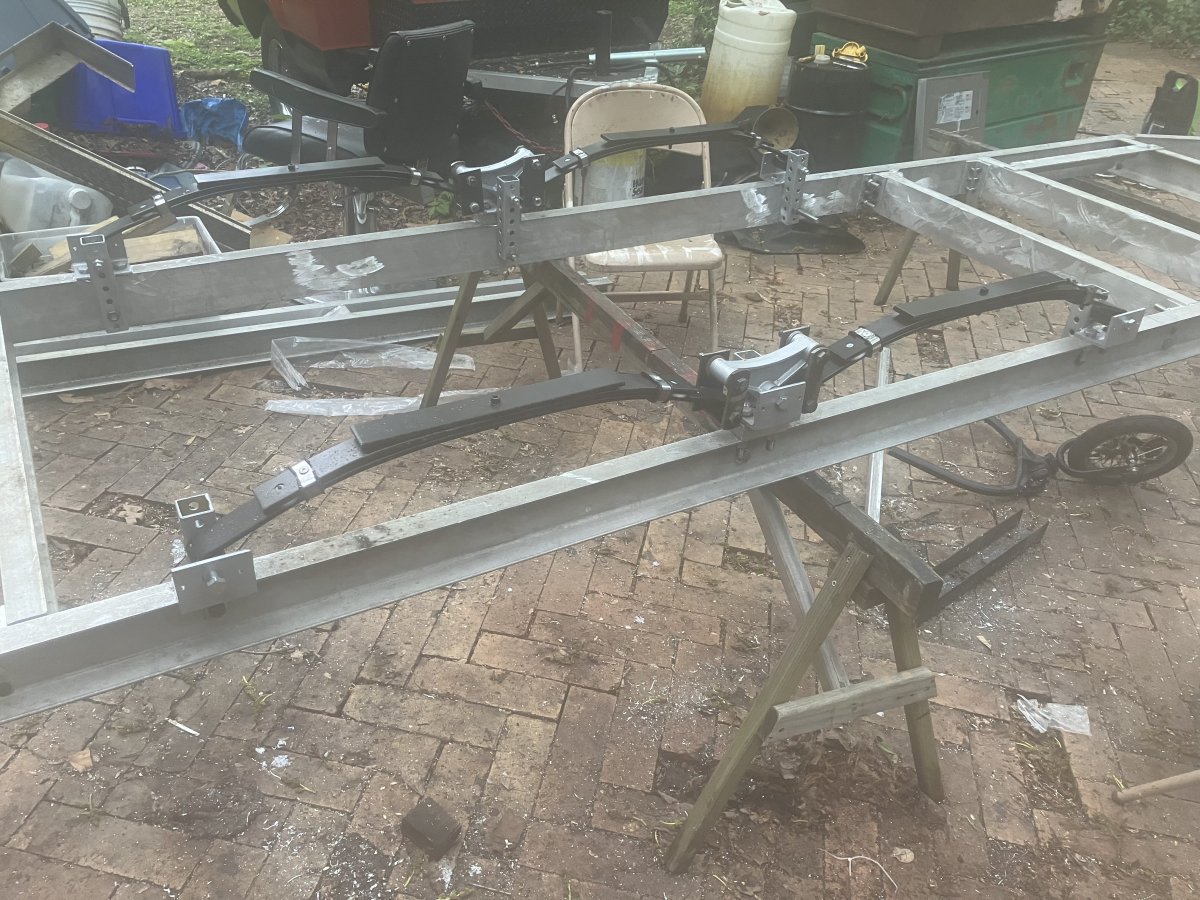

I had to go to an old timey hardware store here in town, Howard brothers, to get the bolts with the right balance of smooth shank and threads. Then I got all the spring mounts mounted and aligned.
You know a lot of my design on these things is based on what I have in the shed of miracles. You know how I hate buying anything at retail. I don’t want to imply I’m cheap, but I actually ran a dye over a couple of bolts to save them, in addition to the few bolts I had to buy. I still have to get three more tomorrow, but I was able to get the springs mounted.
Then I did some measurements to try to figure out if I want to be on top of the springs or below the Springs with the axles. From the tape measure, I think I want to be below, which puts my fender height next to the Casket only about 5 or 6 inches off the deck. It’ll be easy to swap it back-and-forth after I narrow up the axle widths.
I was out of time, but I threw the axles on top, just to see.
Lincoln was trying to tell me that they looked out of line from where he was sitting, but I think I can work it out with a crowbar. We’ll see…
