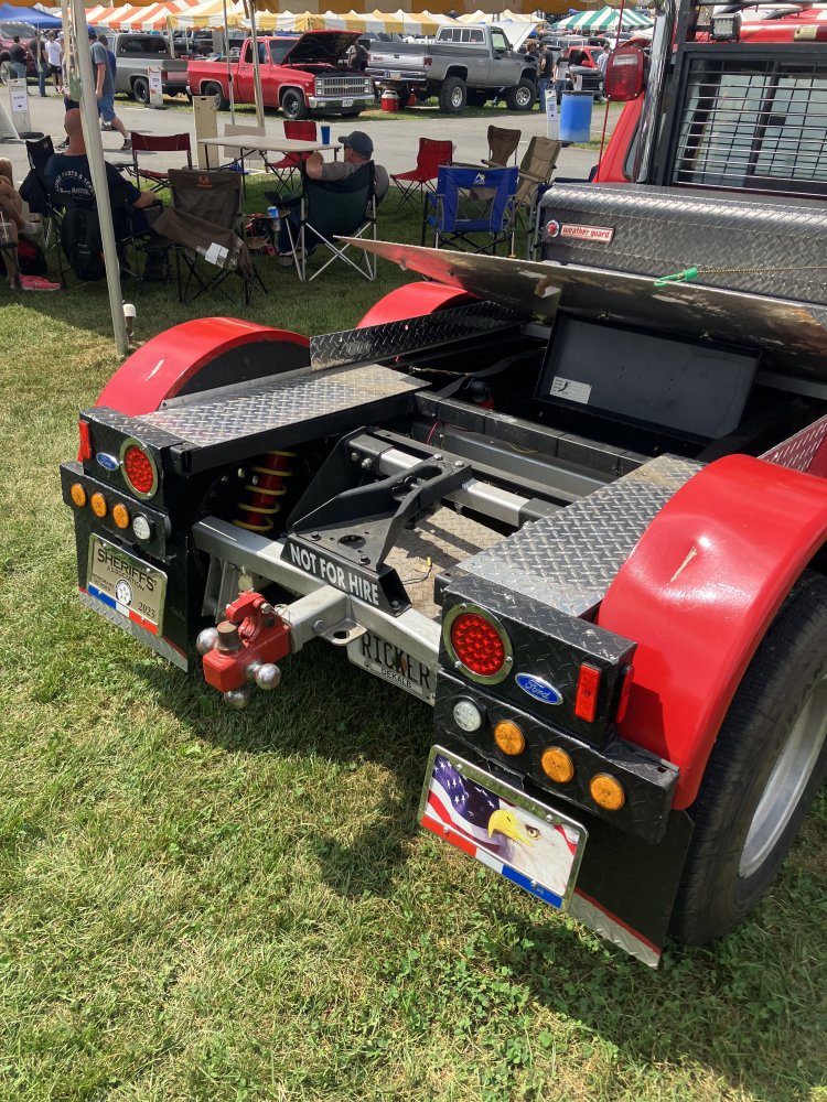

Seriously, you know how you can buy the exhaust pipe kits that have all the different bends, and turns, etc., so you can put together a custom system yourself without a bending machine or mandrel machine? And then you have some stuff left over?
When I look at one of those big aluminum truck boxes, I see a diamond plate fabrication kit. Especially if I picked one up for $30 or $40, or for free as was this case, I get however many square feet of diamond plate, but almost more importantly, you have the corners and the breaks and the different bends and welds that you can cut out and use for different things. A prime example were the tail light assemblies on the Road Ranger.
(EDIT: Picture those two black light assemblies upside down. They were the face of the toolbox that sat on the sides of the truck bed. I had to cut a 4 inch hole for the stoplight, but everything else was a surface mount LED, all I had to do was drill a few little holes.)
Those corner pieces were strategically cut out of another free box, and I only had to cut the holes for the lights. Cooler than anything I could’ve fabricated.

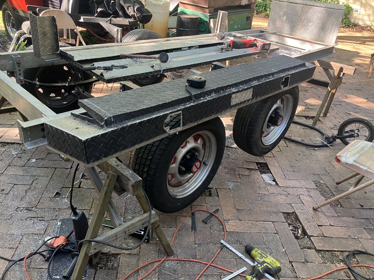

My original thought for the fenders on the ‘Raith was much more simple. I was simply going to use the 6 foot long lid, and cut it down the middle lengthwise. That gave me the right width for a double fender, with that really well constructed double turn down on the outside, which gives the edge of the fender a lot of strength. That’s basically what I did for the step trailer.
I won’t hash it out again, but I was having headaches with this one, and I just wasn’t liking the way I thought it was going to look, and then the whole fat chick sitting on it issue. Then I had the brainstorm of using the box with those custom breaks and corners and welds, and just turn it upside down and cut down the height.

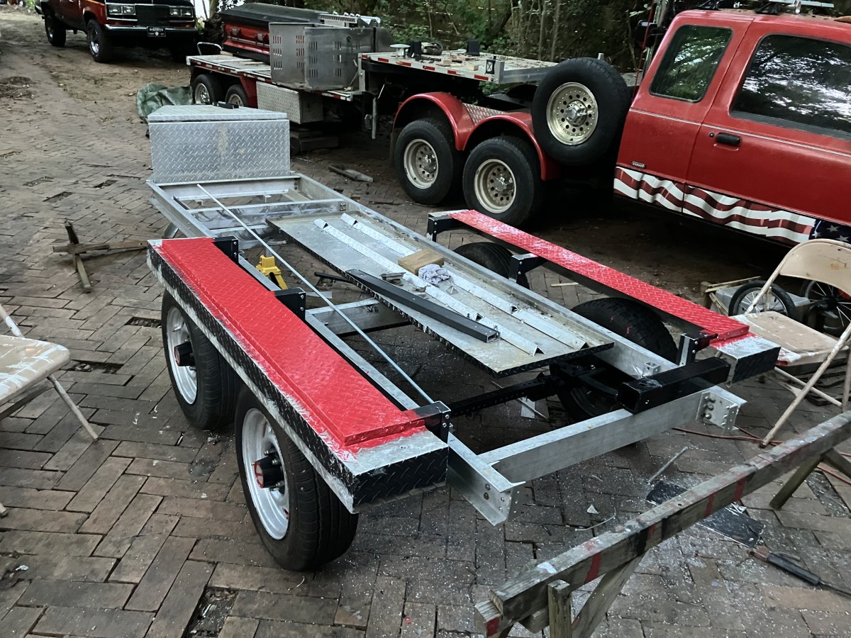

Progress so far:
A lot more work, but it will mirror the casket, and I think it will just look much better when finished.
This box was pretty beat up, but the aluminum is pretty easy to straighten out, and I’m going to paint these fenders anyway, so the rough finish doesn’t matter.
More to follow…

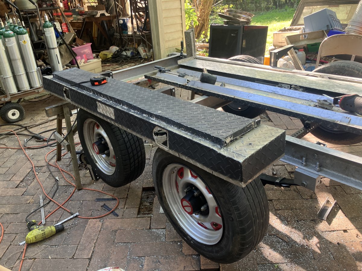

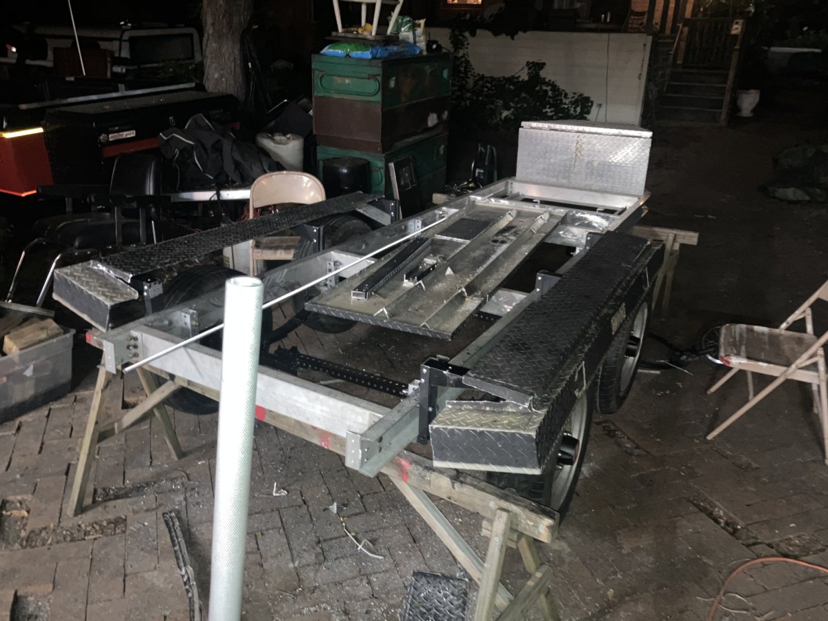

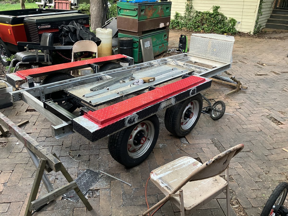

I got the box cut down and made the two fenders, but they need a lot of cleaning up. I also mounted all six fender mounts. Right now the brackets are too long. I’ll trim the ends off so they miss the tires by about 3/4”.
Ran out of daylight, and I’m exhausted, but I’m happy with the way it’s going now again.
BTW, the way I cut them out, I only had to make one fold to get that 1 inch rise. But with the ends on them, I didn’t have any way to bend them.

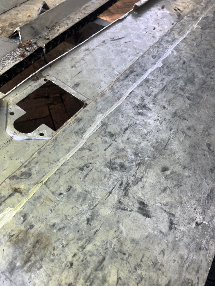

I marked them on the inside, and then I created a groove with my angle grinder. Then I used a cut off wheel on my other angle grinder to make that cut a little deeper without going all the way through. Then I clamped down the piece on the tail of that trailer frame, and just muscled it over to a 90° bend. The first side, I didn’t want to cut all the way through by accident, and it took a while. I still got a little crack, won’t show after I clean it up. The second side took about 15 minutes after I figured out the technique.
I went out this afternoon and finished up the fenders. Note these are the outer fenders, there are plans for the inside side.
I squared them up and secured them with self tapping screws. Those screws will be replaced with rivets a little bit down the road, but I had to get them “done” so I could go onto the next steps. I’m pretty happy with them..
I made patch panels for the toolbox handle holes, and I bonded them as I screwed them, caulked the openings, and then used some of the wrong color red as a primer.

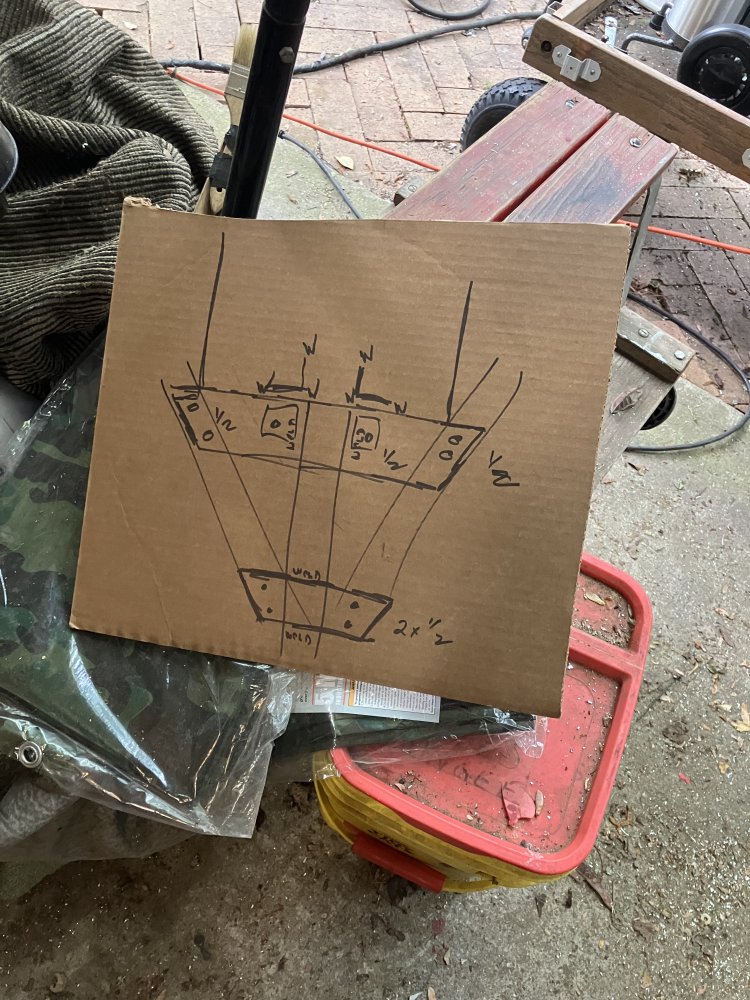

With that, the next step was to do the tongue. After fixing the oxygen cart tire and filling it with air, I moved the jack over and got the sawhorses out from underneath the ‘Raith. For the first time, other than in a drawing, or my imagination, it’s sitting on the ground under its own power!!!
Well, actually, that’s gravity, it has no internal power.
I needed it on the ground to make sure I would put the hitch in at the right height..
I worked extensively with Lincoln and Steve (Steve is the squirrel who lives in my attic), and developed sophisticated blueprints for the tongue assembly.
And then mocked it up:
I already had a couple beers, so I elected to chop the aluminum and steel and drill and weld it tomorrow.

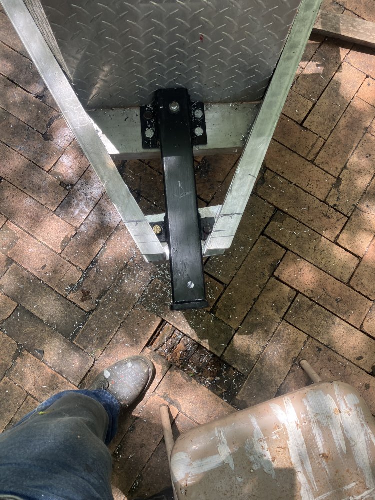

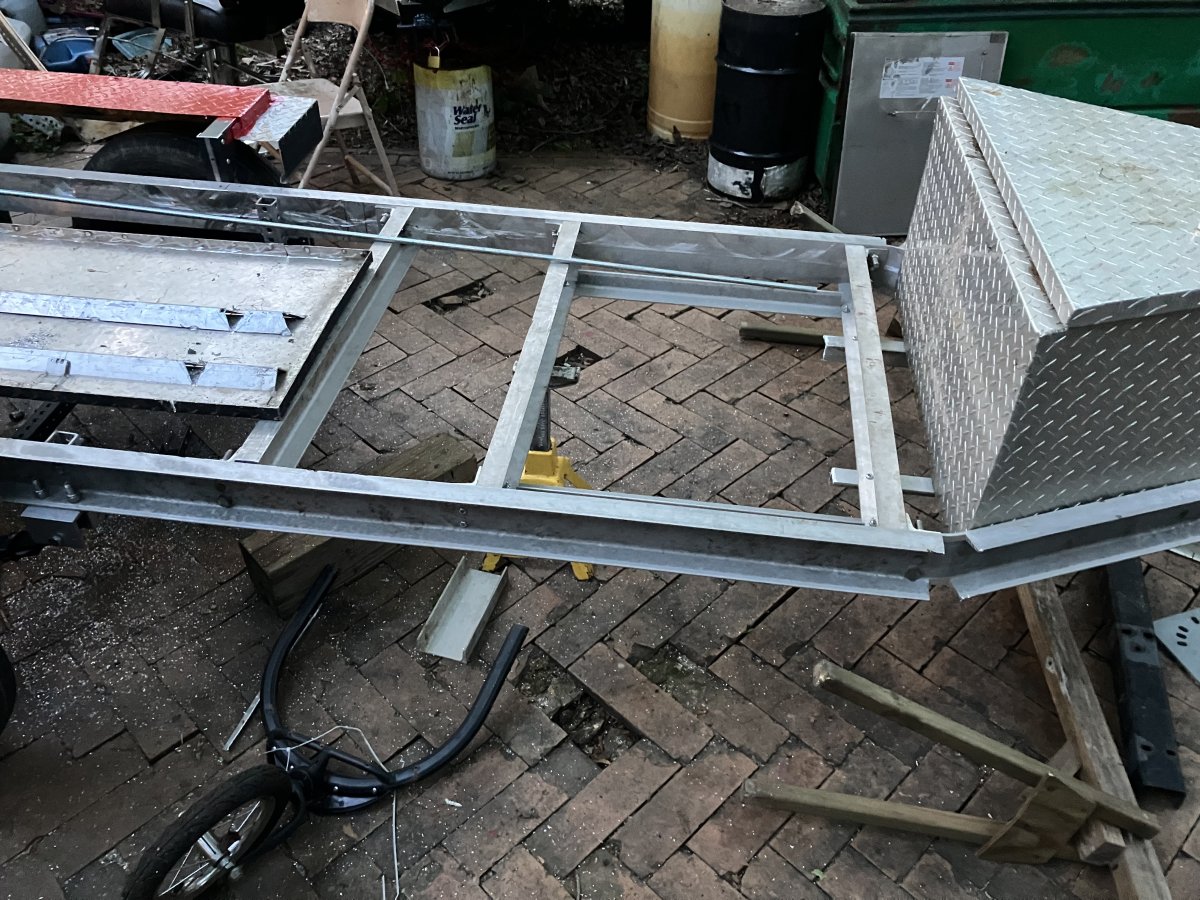

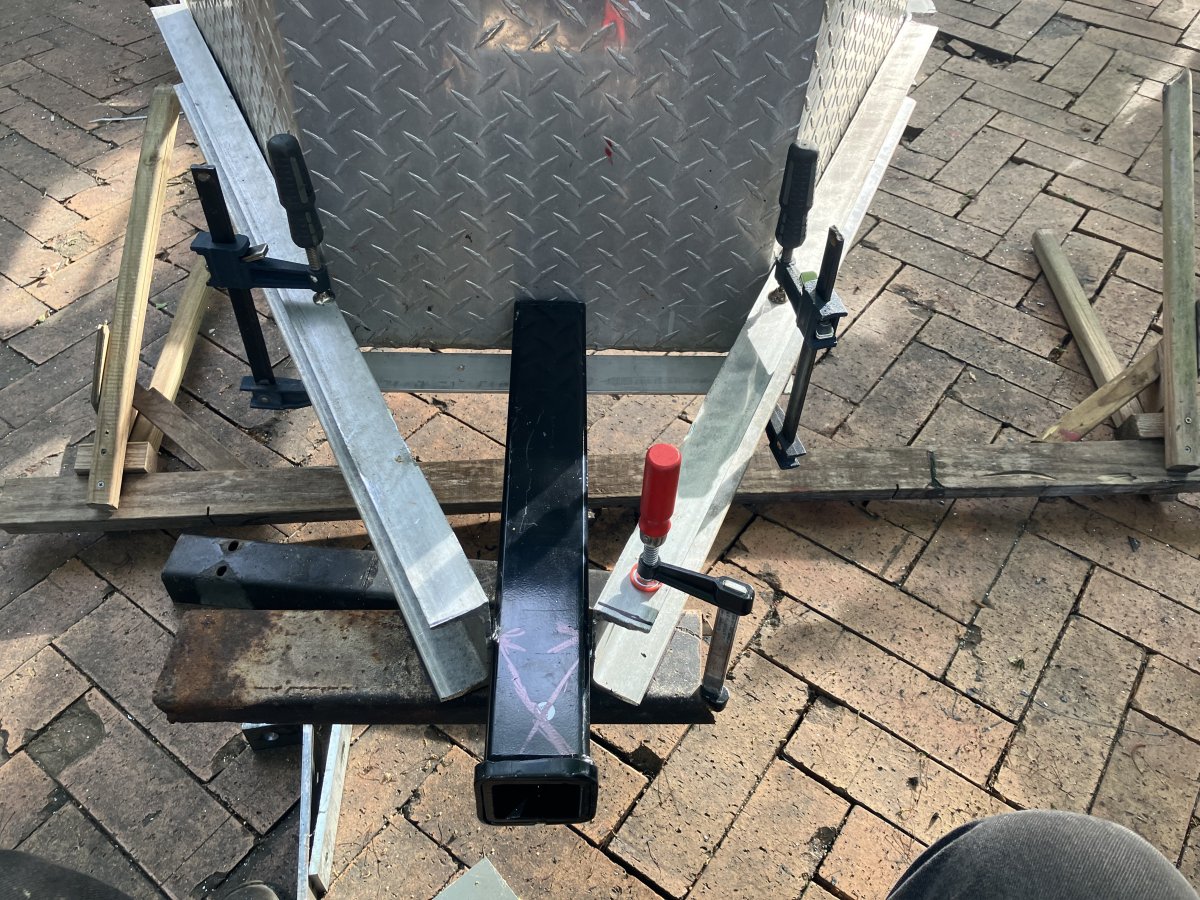

Cut and drilled the aluminum cross braces to hold the receiver tube, and I made the weld on bolt cleats for the sides of the receiver tube that I will bolt into them, but it started raining, so I gave up for the evening.

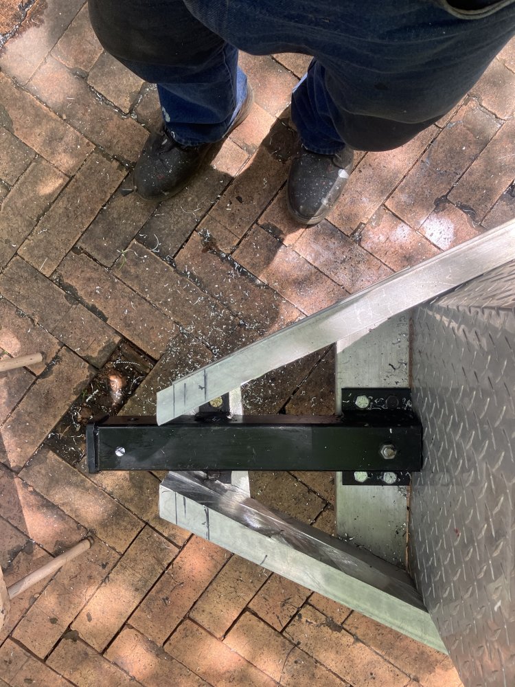

Last night I got the receiver tube welded up, took a break and ate some dinner, and then put a little paint on it when it cooled down.
Today I assembled the whole thing. Usually, I’m a big believer in function over form and I don’t mind if a couple of things aren’t just so. For some reason I’m looking for better detail on this thing.
When I cut the two long pieces of channel for the main frame, I didn’t even worry if they were the same length as long as they were long enough, figuring I would cut them down once I tapered them in around the toolbox. Cutting them relatively close was pretty easy, but squaring them up around the receiver turned out to be a giant pain in the rump.
I ran the Skil saw over the top side to side to square up the top of the nose, but it only cut down about 2 1/2 inches out of the four. The cut off wheel would’ve taken forever, and I was afraid of using the wheel of death. I tried the saws all, but it was almost impossible to get the cuts straight and parallel. If it went haywire, I didn’t have a lot to lose in the length.
I ended up digging in the shed of miracles, and I found 24 grit resin sanding discs from a former life. These are the ones that go on a rubber pad with a bolt through the middle and you use them on a drill. I used my big half-inch drill, and it was working pretty well, but you could tell it was still going to take half of forever.
I went back to the wheel of death, but I didn’t try to cut the aluminum the way the sawblade was designed. Rather, I held the wheel perpendicular to what I wanted to remove, and also at a downward angle, and I gently just slid it over the edge, very similar to the sanding disc. This was after I practiced the technique on some scrap. I did it in a way where there was no opportunity for the teeth to grab on anything. It actually worked very well.
That let me get the two channels to be mirror images of each other, but rough, and then I use the 24 grit sanding disc to clean them up. It took a while, but it came out great.
When I do things like this, I always pre-drill my bolt holes a little bit too small. Then I clamp the pieces together, and run the right size drill bit through the pieces so the holes are perfectly lined up. That worked well as well. The only problem I had was I galded a couple more of those half-inch cheap stainless bolts I got (before they bottomed out). I still don’t understand that. One was even after I lubed it with PB blaster.

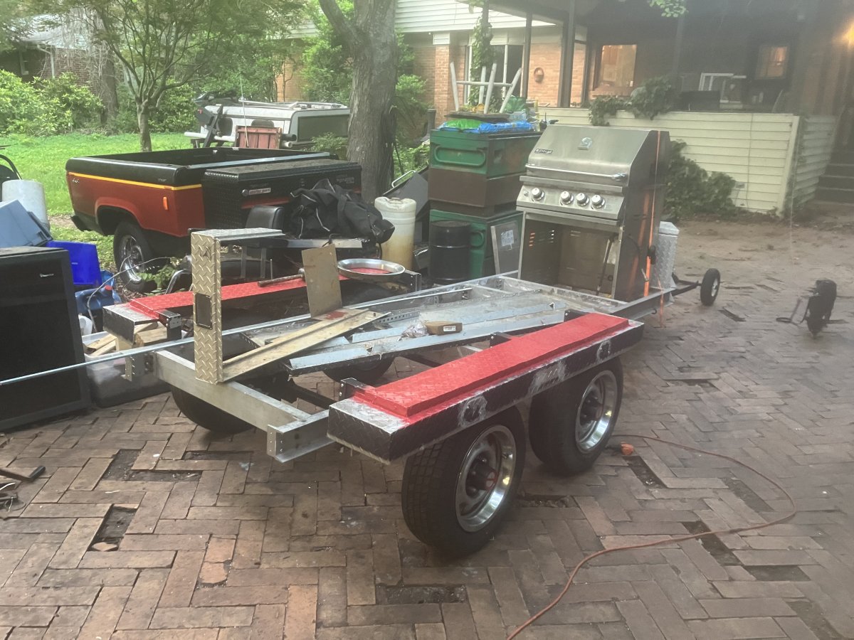

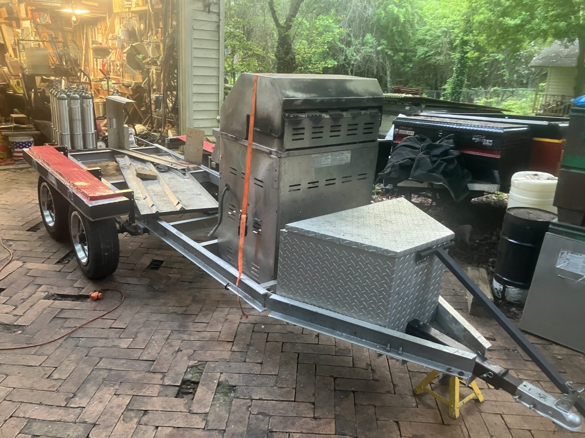

First thing I did today was dig in the hitch pile, and a 1 7/8 coupler was the first thing I found. I never use them, but I mounted it to a 2 x 2 tube as a temp, so I could move the trailer around. Trailer dolly had a flat, but it held air all day after I pumped it up. Project for another day.
I pulled it out to clean underneath it before the next step. There were so many aluminum shavings and ribbons and chips and bits and pieces on the driveway, it looked like it had snowed! I dragged it all with my wide magnet to pick up the screws and the welding rod stubs, etc., and then I just blew it off the brick, so it wouldn’t be grinding in my back anymore when I tackle the wiring and such.
I did a detailed inspection of the gas grill. Really the only thing that was wrong was that the connector to the propane tank was broken, the hose that has the regulator built-in. Of course I had a couple in the shed of miracles, so that was no biggie. I went through all the burners and the hinges, etc. etc., I couldn’t find anything wrong.
I stood up and hooked up a propane tank, and everything seemed to work the way it was supposed to (except the igniter). Yeah!
I had already removed the base, so the top is just sitting on the sheet metal walls right now. They’re very high-quality stainless, but it’s pretty top heavy and flimsy without the base. I had it sitting on the step trailer. Instead of trying to muscle it over to the new trailer, I tilted it on its side, and then moved the new trailer right next to it, so all I had to do was kind of lean it up and slide it into the hole. Worked like a charm.
It was pretty wobbly, so I temp clamped the bottom in a couple places, and then I ran a ratchet strap over the top, just for the 10 foot forward, and 15 foot backwards trip to the workstation again.
I used the same holes in the bottom of the sheet metal and four 5/16 bolts to bolt it down to the trailer. Removing the base lowered it about four or 5 inches, and I have it mounted so it’s actually flush with the bottom of the 4 inch channel, which brought the whole height down. Once I had it bolted down, I don’t think you could knock it over with a good field tackle.
I had positioned everything in the driveway before I measured out the channel, but I still think I might have the gas grill a little too close to the casket to stand between them and grill. No biggie, because I have about a foot of play forward and back with a casket.
Next step, I’m going to cut an aluminum floor for inside the gas grill, and cut out two round holes for the rings of the propane tanks to drop through. I’m also planning on making some braces that will sit on top of the channel and bolt into the sheet metal sides. I still have to put the outside burner, and the opposite utility table back on, but I’m probably going to do that close to last.
And after I get the floor in the grill and I’m sure it’s very secure, I think I’m going to slide the casket onto the back. I need to do that to make sure I’ve got the room between it and the gas grill, but I hope to have it bolted down before the end of the day tomorrow as well.
I also have to make some kind of legs for the front for when it’s parked. I’m thinking of mounting some temporary wheels (little bicycle wheels?) at the width of the trailer wheels so I can pull it on top of the step trailer. Once I get the casket located, I can tackle that because the balance will affect it.
Enough fun for today. I can’t believe I did all that in the grass still needs to be cut….
Afterthought, but moving it with the dolly - it was light as a feather. After I loaded the gas grille, maybe two feathers.

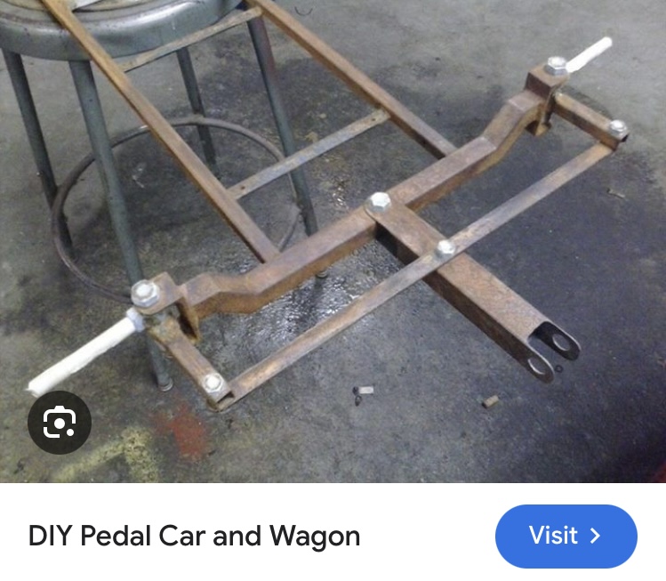

So then I had the thought of making a simple retraction mechanism like a Grumman World War II Duck. They could fold out and down when I need them, and fold in and up when not in use. Mine would not have to tuck in, it would simply be a matter of practicality to have them go down and lock, and come up and lock.
When I was working on the grille on the trailer yesterday, with a single point holding up the front, the trailer can weeble wobble wiggle. I don’t know if this is a matter of the aluminum frame, or just the play in the spring connections, but it dawned on me having two front legs instead of one is going to be desirable for when I’m using it. Obviously these two wheels could serve that purpose, but then I would need them to go down further, so the deck would be level. I am not opposed to installing fold up wheels, and also installing a couple drop down legs if the wheel mechanism gets too complex or too heavy
So, while I was thinking of all of that, I had the thought that when it’s sitting on the ground, and not connected to anything, there still may be a need to move it a little bit, and with two wheels in front, the wheels would need to steer.

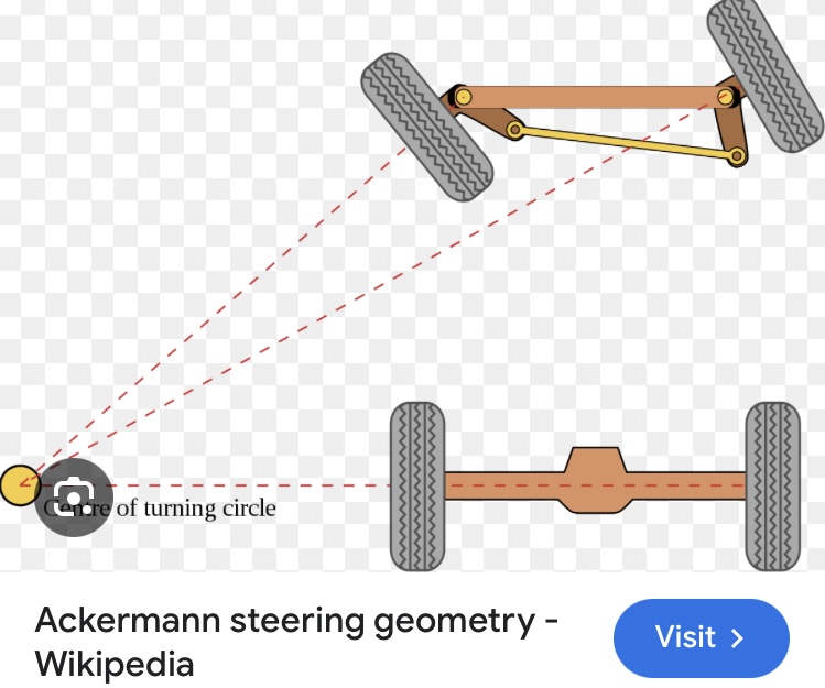

That lead me to 15 minutes of research back to the Ackerman steering geometry I studied in engineering school.
That gave me a headache, and I did a little more research on how a fancy Radio Flyer wagon steers.
To keep my planning and design reasonable, I walked through the shed of miracles to see what equipment and parts were available, and I remembered that I picked up one of those high end, three wheel, jog behind, canvas, baby strollers at Goodwill a while back ($15). The wheels are like bicycle wheels, but they’re only about 16 inches in diameter, and the pair is rated for 250 pounds more or less.
That triggered the sparkles and funny colors and loud noises in my head when I think of these things, and I said, if I use those wheels, this thing will look like a top fuel dragster with a casket on top like the Munsters drag casket Drag U. La:
That led me to thinking about Yvonne De Carlo (Lily Munster), which was great, but really didn’t help my productivity on the trailer at all.
Soooo, here’s the question. It’s easy enough to do the wagon steering, and it’s easy enough to do the fold up wheels. Is there a good SIMPLE way to be able to do both?
