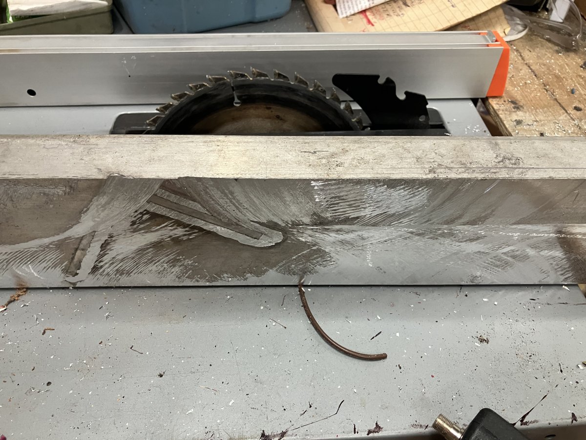

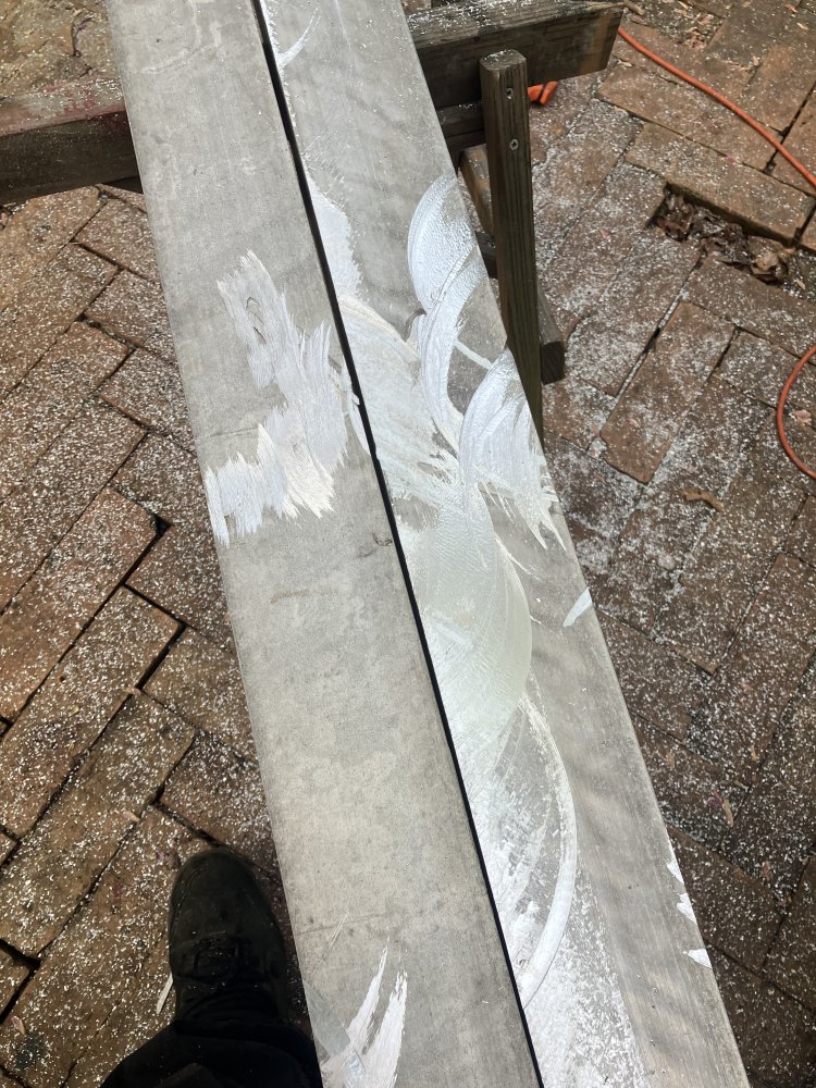

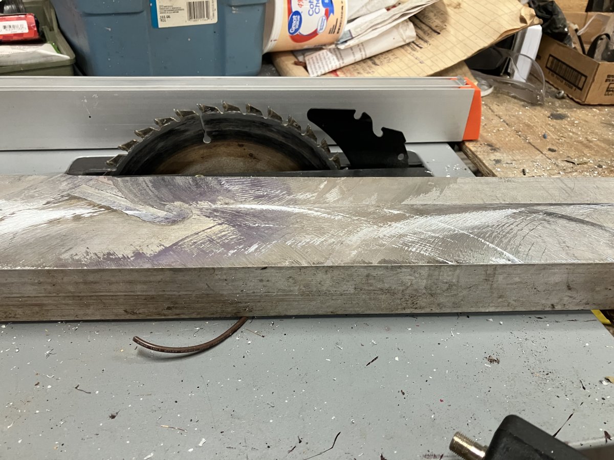

I was just doing general cleanup today, but I got enough of the top of the table saw free that I could test trim the 4” channel for the cross pieces.
Came out great. It’s hard to see it in the pictures, but on the right, I tilted the piece in just a hair, and it literally took everything off the surface. On the left, I just passed it through straight, and it left just a teeny tiny bit of the cross piece (V looking mark). That would be easy to shave off or grind.
I was taking a lot of time (and stress) trying to hold the circular saw blade as flat as I could against the channel when I was cutting the connecting pieces out. and even with the WD-40 trick, the blade was trying to bind up The channel is one and a half inches wide, so I imagine I set my table saw guide 1/32” skinnier than that. Then when I run the 4” channel, it just shaves the surface and anything that’s not flat on the surface disappears.
This will also save time because I can just rip through those connecting pieces with the circular saw. With the 10 inch blade on the table saw and the increased amperage, its slices the remainders off the surface like cutting a piece of cheese.
When I do my long side frame pieces, I’ve just got to get somebody to help me who knows how to hold it straight as I shave it.

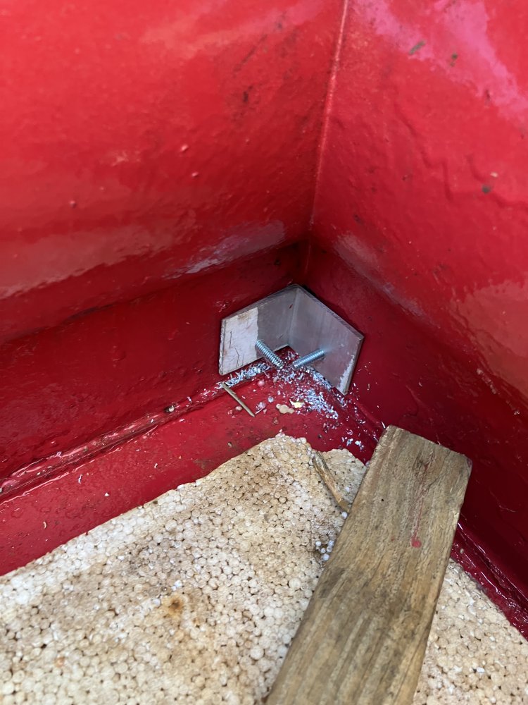

This morning I put the casket back together. Like any project it always takes 10 times longer than you think it will because there’s always 10 times more stuff to do than you thought.
I put the backing plates in the corners, and I used some chrome plated steel bars, hollow, I had from some kind of potato chip display rack, and I ran them 4 feet in the front and in the back as back up plates. I have about 20 left for whatever. But they worked out good because no matter where the two frame crosspieces go I’ll have a place to bolt them to the Casket. I drilled a 1 inch hole through the middle of the back one for a possible drain in the middle compartment, and I just drilled a pin hole through the outside so I could locate it later.
Half the Styrofoam came out in pieces, so it was a little bit of a jigsaw puzzle putting it all back together, but not too bad. Then, when I went to set the tub back in, I couldn’t get it all the way down. I finally climbed up and stood in it, and with a little wiggle, it finally dropped down. (I’m sorry for that visual.)
I caulked it all around, I put glue under the gasket, I caulked around the edge of the tub, etc. etc. it’s already in much better condition than when I got it, and I’m still planning on a few enhancement features, but they can wait for now

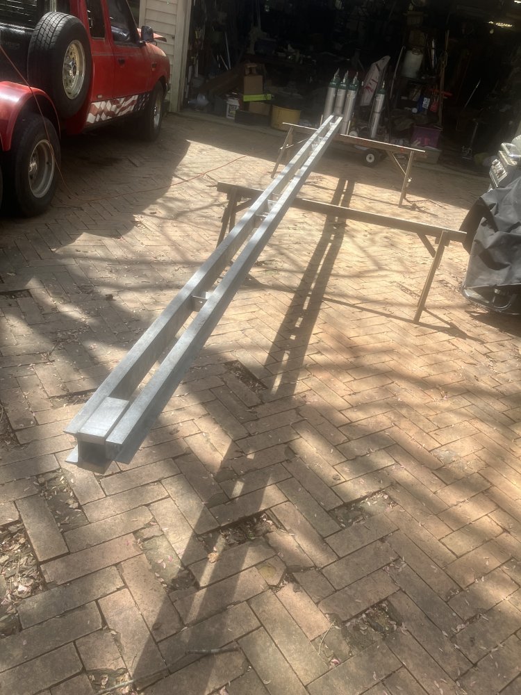

This afternoon, I started in earnest on the aluminum frame. I had pre-chopped the crosspieces too long, and from calculations, I cut them at 44 inches. That would make the outside of the frame 47 inches. The casket is 28”. The fenders will rise up about 10 inches, and these measurements were so that my 13 W shoes could step in between the fenders and the casket if I needed to go there. More on this later.
I used my chop saw with a carbide tipped wood blade, first, to true up one end of the channel, and then to cut them square to length. All the drops will be used.

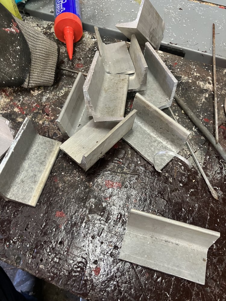

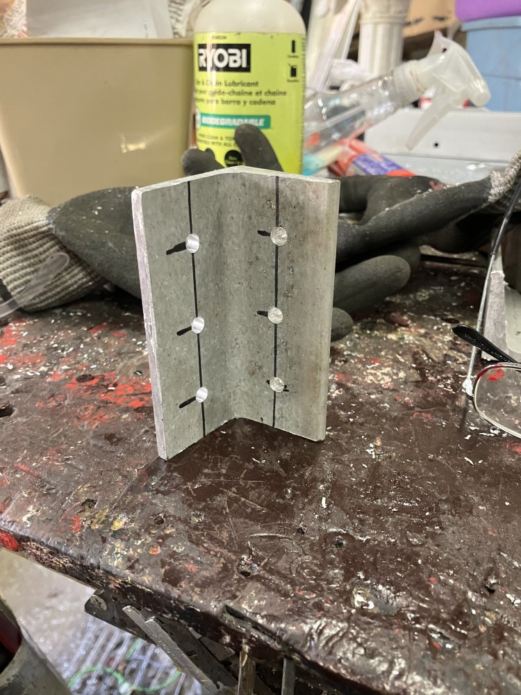

I took the drops and cut them just shy of 4 inches, and then split them to make the corner bracing to attach the crossmembers to the long frame members.
Then I took one of those pieces, and I drilled it in the right locations for the connecting bolts. I’m planning on using those self tapping 1/4-20 bolts I picked up. I drilled these holes way too small, and I’m going to use this angle piece as a guide, to drill the holes in everything else, way too small.
On most of the connections, the bolts will go through the side/long frame pieces, and tap into these angled pieces. I drilled the holes too small, and I will do so as I lay everything out. The aluminum is very easy to drill. Then, when I go to assemble it, I will open up the holes that are to be tapped to the right diameter, and open up the pass-through holes to just enough to let the 1/4-20 bolts slide through. After I put that together, I’m going to put backing nuts on the back side. I’ll use the E 6000 stuff on everything threaded as a thread locker, and I also plan on bonding those angle connecting plates to the cross pieces and long frame pieces.

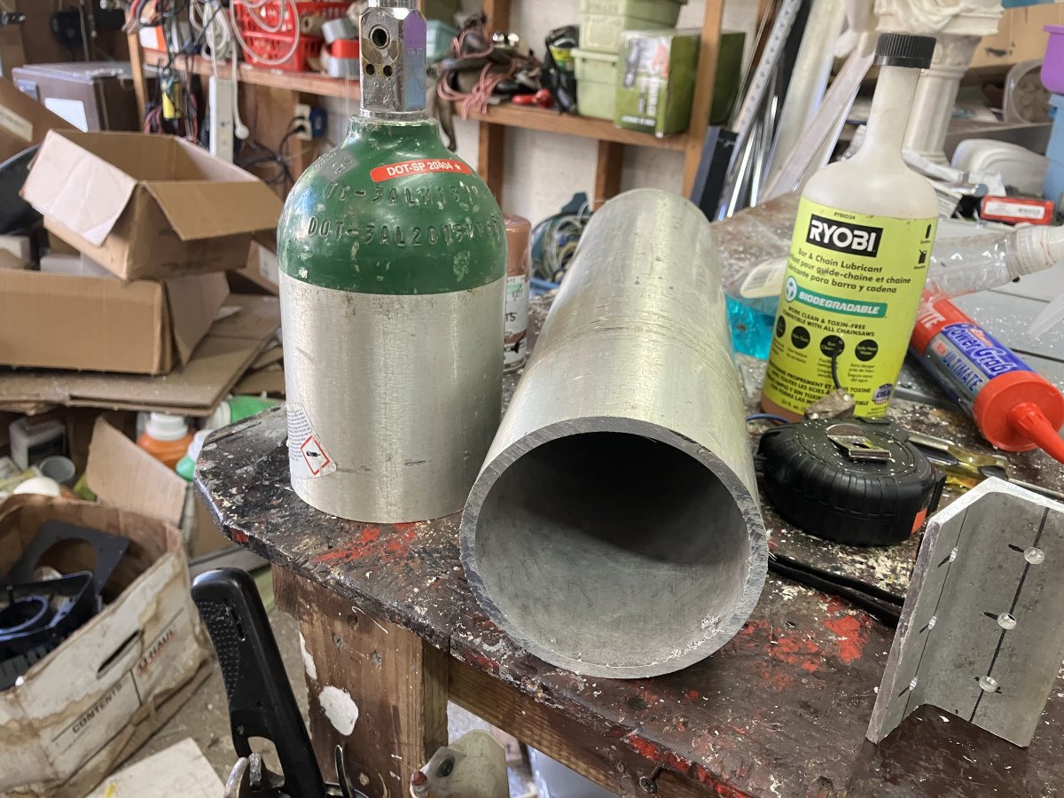

Before I quit, I took all my oxygen tanks out of the Missing Linc, and I couldn’t help my curiosity, I took one of the empty ones and sliced it just to see what I was dealing with.
They have about a quarter inch wall thickness. My juices are flowing on what to do with them, all but one are still full.

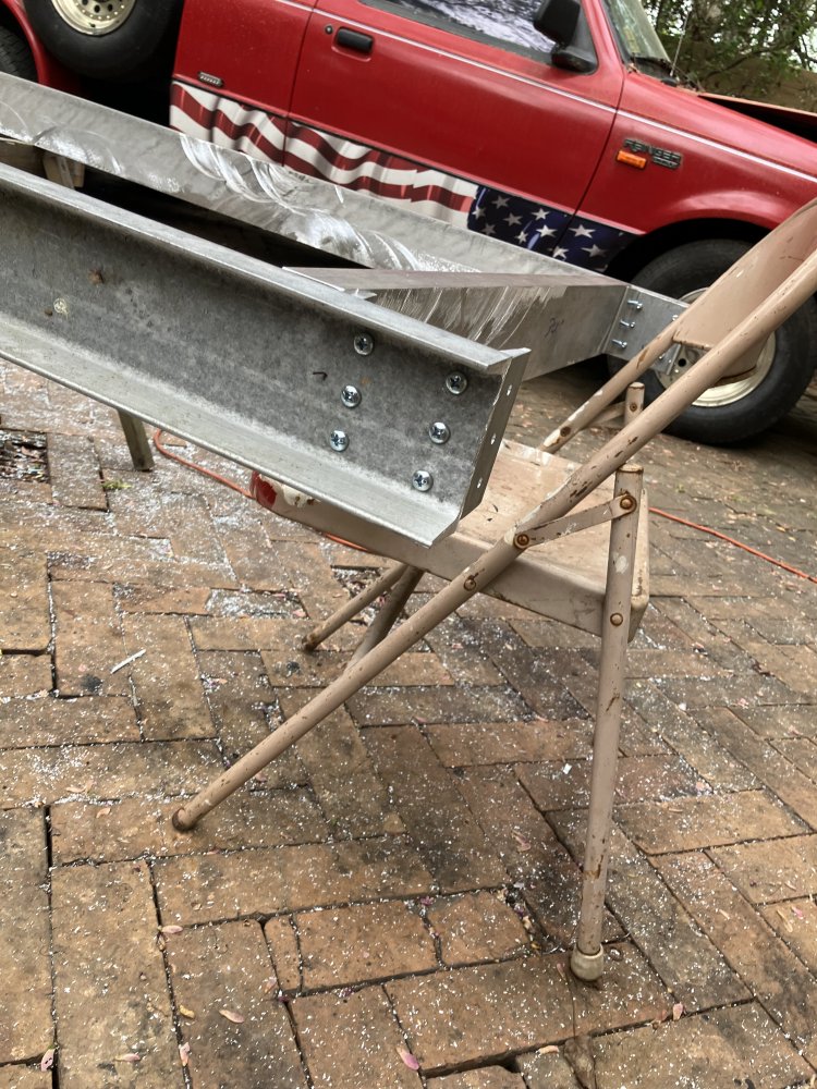

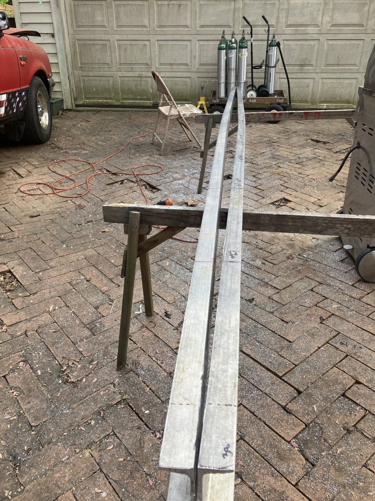

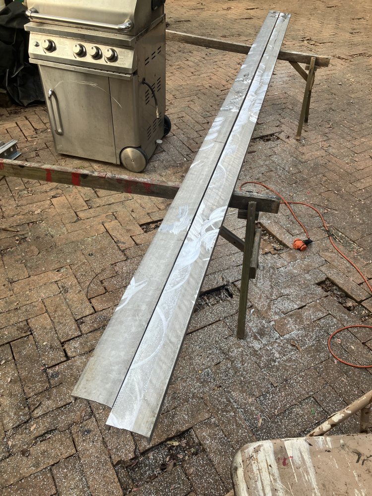

All the saw marks will be facing inwards. When I got down to the last few cuts, cutting out those web pieces, I just about figured out how to do it without butchering it.
Then it turns out the channel was drawn in (out?) where the web pieces were welded.
If there was any doubt about facing the flat side in, that’s over now.. I figure it will be easier to pull it in then it would be to bow it out.

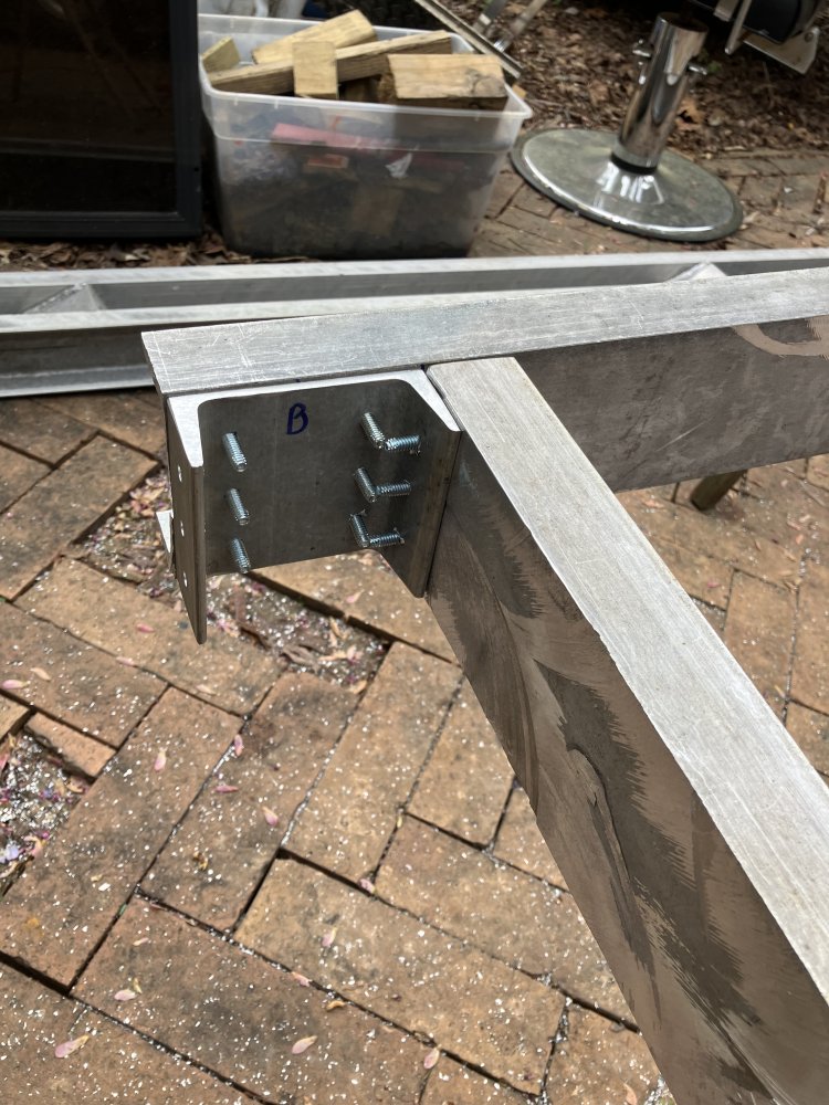

Some of these bolts will be drilled out and I’ll use those half inch stainless bolts I bought. The end result will be a combination of both. The self tapping ones just make it very easy to get everything in place. The ones that remain will have backing nuts.
The bow in the channel was a little surprise, no real biggie, but it once again changed my approach. The pictures are of the back cross piece. I’m going to have to do the front one next. Then for the three or four in between, I can use a threaded rod to draw the channels together to get the bolts in place.
It was a little learning curve, making those smaller pieces and drilling them in the right place, etc. etc. The rest of it should kind of fall together.
You should offset the holes so you don't have a problem putting on the washers and nuts. Also use part of a flange for an angled shim, otherwise the washers and nuts will not clamp properly.
Amen, yes, but….
When I drilled the holes, I drilled them a hair offset, so that when I bolted né side down, it would draw the channel together. Is that making sense?
The way I drilled/drove them, if I tightened up one side before I tightened up the other side, I could not have gotten the screws through. I did it, so that if I started the screws in one side, and then I started the screws in the other side, and then I tightened them up, it would jam the pieces of channel together.
And I completely understand that on the flange side of the channel, the flange side of the angle, but that’s a small compromise. With a little chemical bonding, and snagging the quarter 20 self tapping screws, I should have plenty of strength.
Then I look at that casket full of beer, 1,000 pounds, and I know I need all the reinforcement I could get…
Not that I would ever fill it full of beer…
I understand the offset holes. Good idea. And if you're using only self tappers tthen the hole orientation won't matter. But if you use bolts + nuts, like I think you said you would, then having the hole drilled so at 90° they are offset vertically will be a lot less work.
