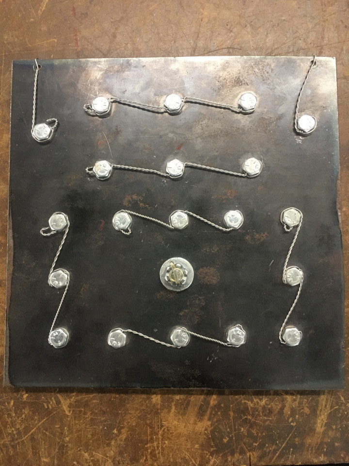

And another trick to make sure the bolts aren't backing off, is to use a paint pen and mark the side of the bolt to the frame with a slash. Makes it much easier to see if any are getting loose.
Better yet…. Drill the heads and tie them all together with stainless safety wire. That should keep a retired guy busy for a while.

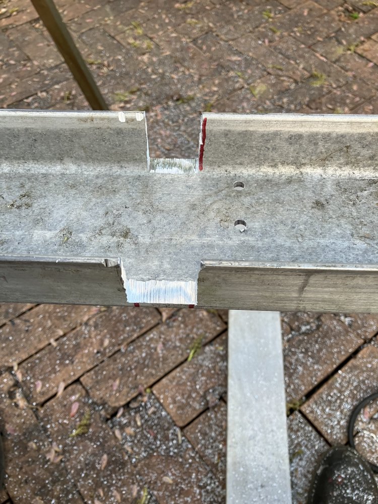

One minor goof, and a second thing I realized, just getting the one cross piece put in place. When I drilled the tap holes in the short pieces of channel that I’m using as brackets, the drill bit was a hair too large. The self tapping screws do what they are supposed to, but if you tighten up a hair too much, they strip. One of today’s projects is to use a piece of scrap and go down 1-2 64ths of an inch on the drill bit to find the ideal diameter tap diameter. Those short, full channel pieces will be redone. That cross piece will be under the end of the casket, and that 4 inch extension will hold another piece of channel that will be the bumper containing the lights.
Second, I cut my cross piece at 34 inches for a bunch of reasons. One reason is the tongue box is 33-3/4” wide at its widest spot. But that will be right where I’m going to have to bend the channel inwards to make the tongue. I plan on cutting out about an inch of the flange of the channel without damaging the web of the channel, and then pulling the two pieces together up near where the coupling would be. So I’m going to make my cross pieces a half inch or an inch like longer/wider to allow for a little bit of movement around the corners of the box.
I don’t know what’s going to happen when I go to band the channel. Most of me believes it will bend without incident. It’ll only be about a 20° bend. If there is any indication of any cracking whatsoever, I’m simply going to make a steel plate/bracket across the bend that will sit inside the channel and bolt in place.
When I have it all together, I can quickly disassemble it, and put the bonding in and set the bolts properly.
Finally, the top is going to be covered with the remains of my 1/8 inch diamond plate. At every joint, I’ll stitch it with a few extra bolts or rivets to further enhance the joints. It will be bonded in those areas. I’m not going to cover the whole bottom side, but I will make up similar braces for the most important joints and bond and bolt them in.

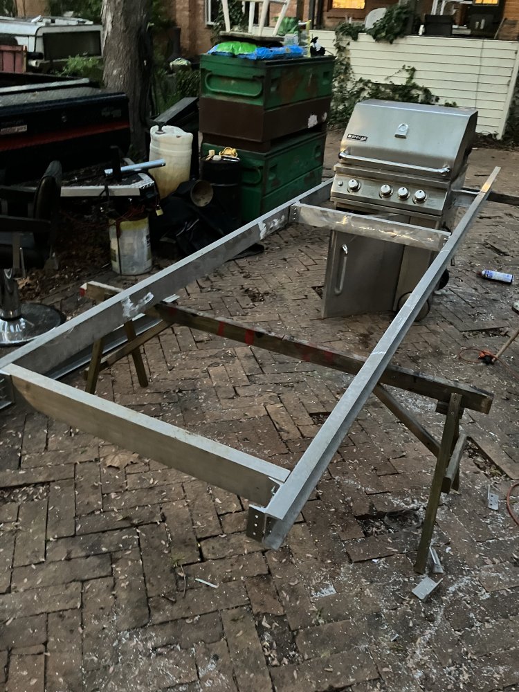

I made a new crossbar for the rear with the new width in mind, and two more. There will be a total of five, but I’m going to locate two of them after I have my springs and axles installed. I want to place them over the center spring mount and the front spring mount.
I drilled half a dozen of my angle plates with the smaller bit so the self tapping screws will hold better. Then I took apart what I had, and reassembled it
The self tapping screws are, and are not, a disappointment. They’re actually doing exactly what I had planned, giving me a rapid way to bolt this all together, but I wish they were better quality.

Before I bolted it all together, I notched the flanges of the channel where the tongue will be bent in.
After I get it where I want it, I’m going to make mending plates for the top and the bottom of the channel, maybe some other additional support.

You might want to raise up that grill a little. It's going to drag for a bit sitting that low before the bottom bends or breaks off.

In trying to shrink this thing to a manageable length, one of the things I have some flexibility in, is where my 13 W feet fit between the casket and the gas grill. I’ve done the measurements 100 times, but there’s nothing like sitting on it and putting your feet into it. That’s what this is about. And if you think it looks low now, I think that frame is 10 inches higher than where it will be on the tires!
The aluminum frame is so light, I can easily pick it up and move it side to side over the gas grill. The crossmember behind the grille will be at the end of the casket. The cross piece in front of the grille will be the last cross piece before it tapers in. I’m going to add connecting pieces between those two cross pieces to support the grill. (Along the sides of the grille). My current thinking is to get that much put together, after I have the wheels on it, support the grill up from the bottom with the x4s, until it’s in the right place to avoid smashing the bottom off, but not too high on the top, and then bolting it through the sides to the frame, and then cutting the bottom off
The other issue is the propane tanks. It doesn’t change my plan, I just have to consider them in the various adjustments. And I’m planning on two tanks, but the reason for the second will remain a surprise…
One last thought, If you’re worried about it hanging too low, consider this: the frame is actually upside down right now. So it’s not the bottom we have to worry about, it’s the hood over the burners when I flip it over!
