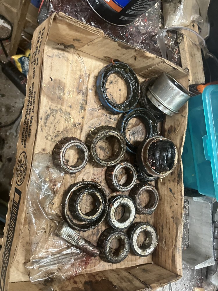

One afterthought. I’ve had a tub of Valvoline grease for probably a dozen years. When I went to nationals, and I spun a bearing on the trailer and then had to rebuild one of the truck hubs, and I bought a tub of STP grease. In my mind, I think of Valvoline as a quality product, but I think of STP as a really superior product.
The Valvoline was definitely thicker, and in my impression, better for something like wheel bearings. The STP was relatively thin. The only thought I’ll add, is I don’t know if the grease thickens up when it sits around forever. But the next time I need grease, it’s definitely going to be the Valvoline..

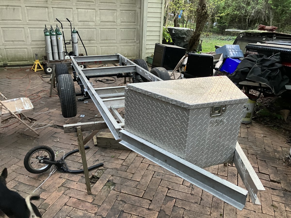

Finished up the wheel hubs, double checked everything from below, and flipped it over.
No sweat for feeble old me to tilt it up on one side on the saw horses, balance it as I walked around the tail end, and set it down on the saw horses. And I’m no Superman….
Balance point front to back is about the front bolt on the front springs. I’m guessing it’s 250-300 pounds total plus or minus.
Welded the top of the axle splices, and installed an aluminum channel cross piece across the equalizer point. Made the executive decision that the front and rear of the springs are close enough to the existing cross pieces that I didn’t need to add two more. 99% comfortable with that, but jury is still out.
I temp clamped two 1-1/2” x 3/16”aluminum angles I had (oriented front to back) under the tongue. Several purposes. In the rear, they extend about 2” under the front of the gas grille face to bolt it down (splits front almost evenly in three, and the main support and secure bolts are on the grille sides).
The angles run to the front of the tongue box, same width as the flat face, bolted so the tongue box sits on them, but you can’t see them under the tongue box and frame. They hold the box, but also reinforce the tongue structure.
The tongue box sits on those angles and is bolted to them front and back bottom of the box, and also front and back of the sides through the frame. Again, holds the box, reinforces the tongue.
I did it all without completing the front of the tongue so the frame exactly follows the tongue box angle. Hitch will be a receiver tube (later).
I did another front to back check, cleaned up the axle splices and painted everything not aluminum (not much).

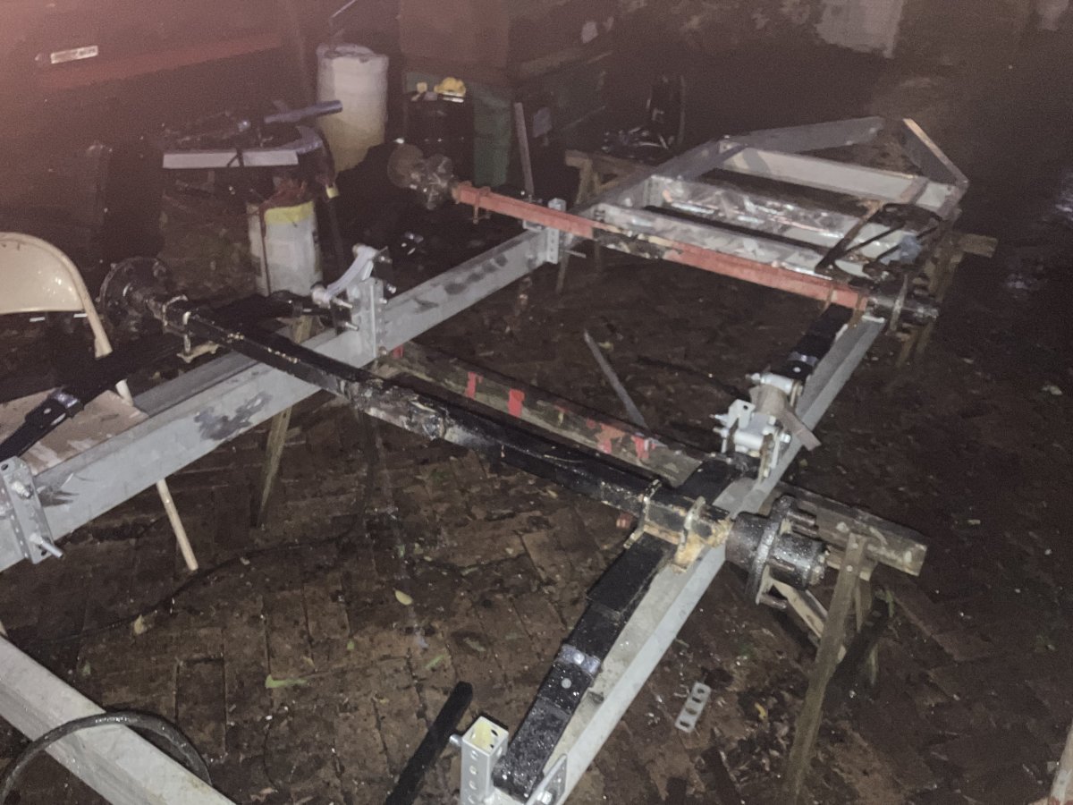

So much for planning. When I went out this morning, I really looked everything over in detail. Everything was sort of OK, but who wants to do anything “sort of OK.”
I didn’t like the axles. I spliced the big one, and the little one had already been spliced once, and I spliced it again. In my inspection this morning, I realized the tires were going to be very close to the frame. Remembering that any job worth doing is worth doing twice, I tackled the axles again.
Basically, I cut the whole midsection out of both axles, and I reset the width, saddling a piece of that unistrut on top of the remaining axles. It’s actually the same dimensions as the big axle, and since the little axle was a channel, it’s actually stronger than the smaller axle.
I also redid the U bolts on the smaller axle. I can’t say that there was really anything wrong with them, they just look shaky. Better now.

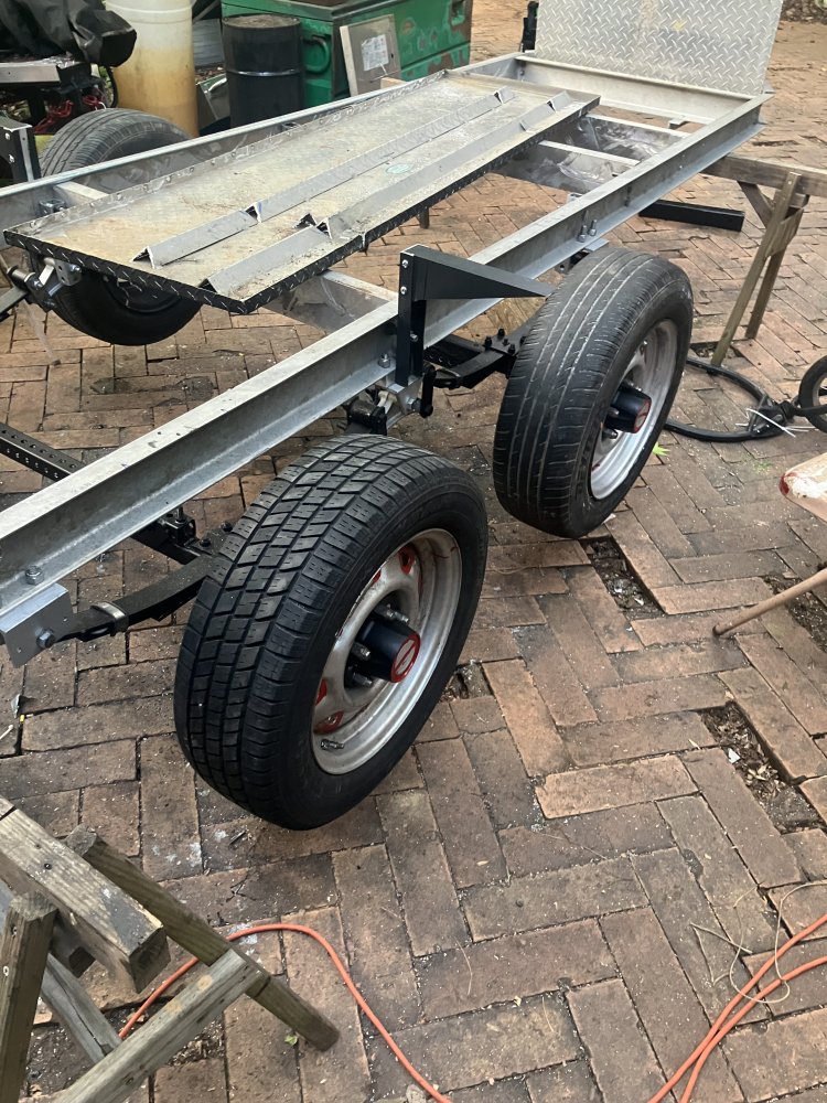

Then I painted everything again after I put it back together, and I hung the tires.
The tires are exactly where I wanted them by my measurements, but as I’m looking at the whole thing, I wish they were closer to the frame now, maybe 2 inches on each side, which still leaves me about 2 1/2 inches clear of the frame.
Did I say any job worth doing is worth doing twice? Now that I rebuilt the axles and u-bolts and hangers, it really wouldn’t be that big a job to narrow them up a little bit. I’m going to mock up the fenders tomorrow, and the width of the grille, before I make a final decision.
I am happy I ran the axles under the springs, it gives me the ride height I like. Can’t see it in the picture yet because it’s still sitting on the sawhorses.

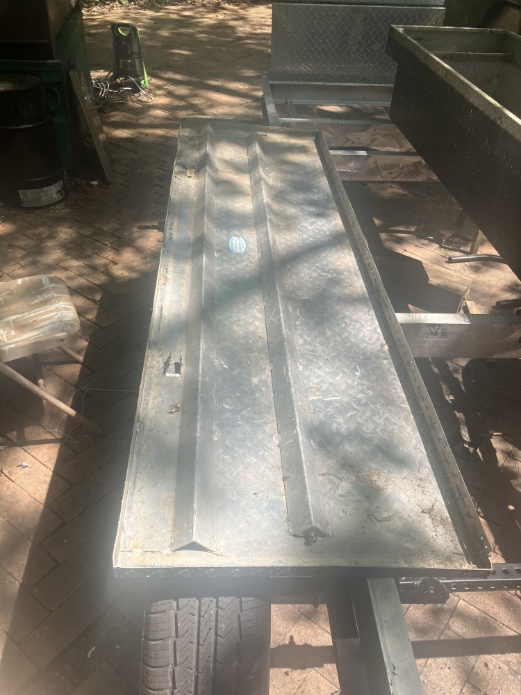

Moved on to the free toolbox for fenders. 72” lid with the square turned down edges, 20-1/2” wide. Perfect.
Perfect except when I redid the axles, the turn in the tread pattern was 11-1/2” out. I like the tires to run a hair outside the fenders, so if the truck/trailer misinterprets my perfect inputs, the tire scrubs instead of the fender bending. A little more free rubber than I wanted. So I figured I’d pull the lid and strip it and mock it up.
Box was free and was a cheap one to start. First pain was the piano hinge was held in by about 10-12 rivets on the bottom side, but (aluminum) spot welded every 3-4” on the lid side. ??? Had to grind every one so I didn’t destroy the straight lid. Another hour.
Turns out the midpoint to rip it equally is 2/3 the way through the center angle. When I notched both of those angles for the front and rear turn down, I realized the lock side was actually a layered panel that ran all the way to, and into, the turn down for lock security. No real biggie except more time.

Total epiphany on how to do the fenders this morning. I was just going to use the float tool box lid, and tilt it down in the front, and a little more in the back.
Today I had the thought of using the top of the box box, which steps out a few inches on every side, turning it upside down, and then putting a cap on it.
That squared off section of the box is about the same height as the base of the casket. Now I just have to figure out if I’m going to step it up again when I cover it, or just let it run flat. The way the whole thing is folded together, it also illuminates the need to put any kind of bracing underneath it (unless we run up on a real jumbo, and I’m going to need you guys to corral that a little bit!).
