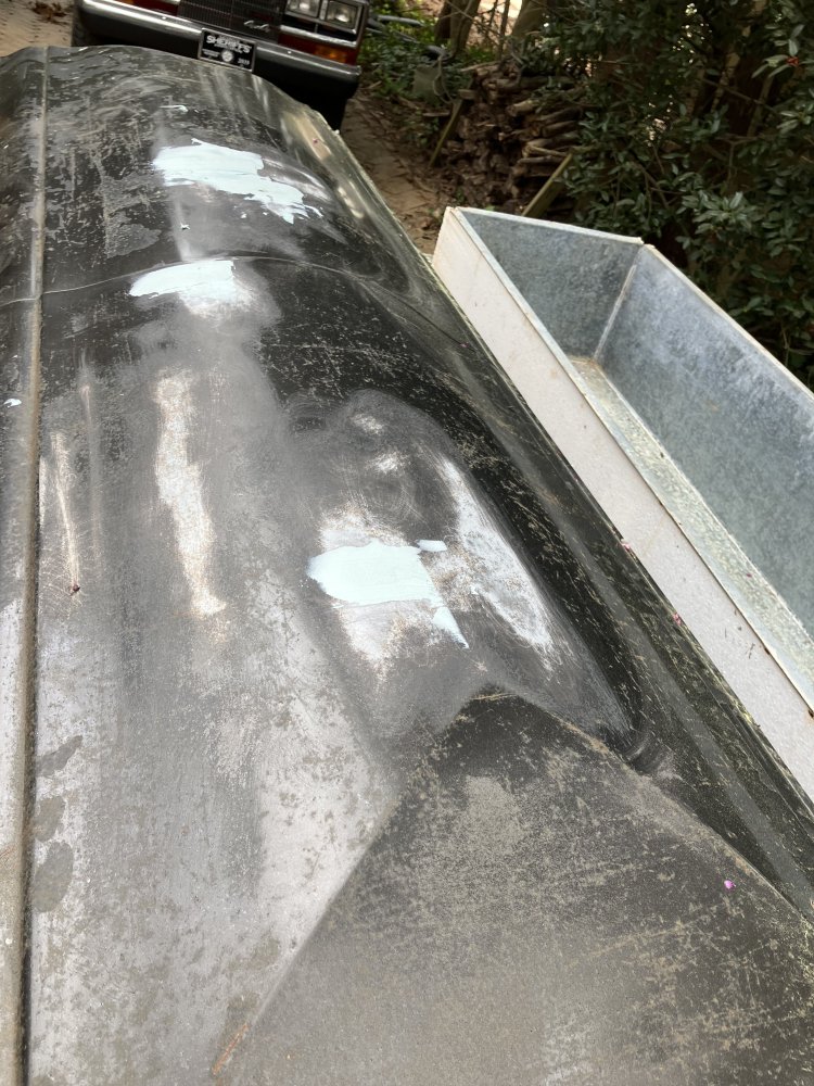

I took a very detailed look, before the rain drops today, for body damage. It’s in pretty good shape, just a few little things in the roof. I sanded the surface of each to identify them, and to take the slick away so the Bondo had something to stick to.

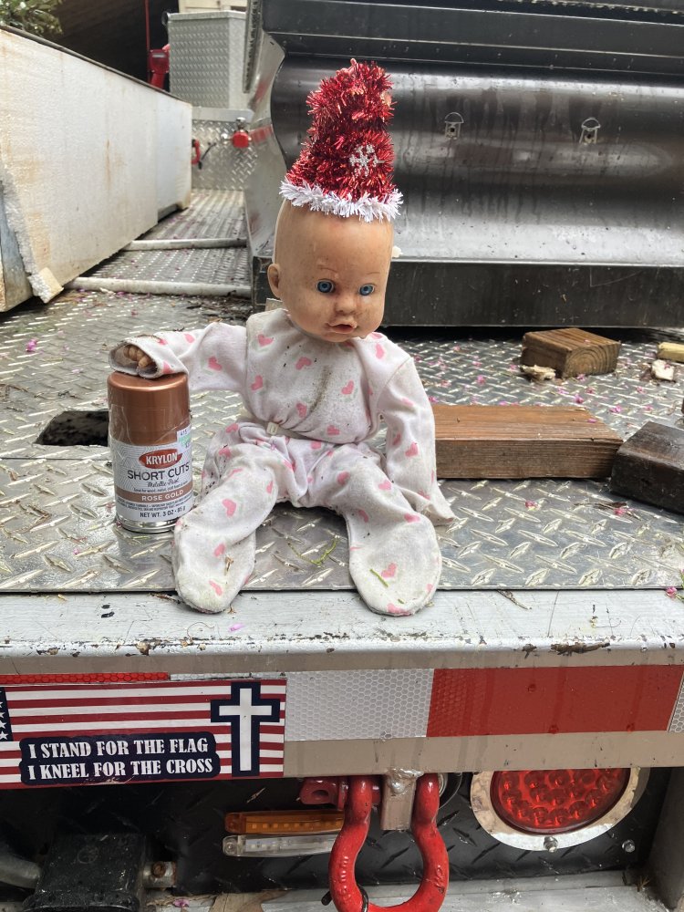

Then Lincoln and I went to the local Hobby Lobby, and I was able to buy a Krylon can of spray paint in Rose Gold to touch up the flower accents on the handles.
It’s the smallest can of Krylon paint I’ve ever seen. It’s like a fat salt shaker. Current thinking is I will spray that into the lid of a cottage cheese container, and use an artist’s brush to touch up the bad spots, and then put clear urethane over those panels. I’m afraid if I just spray paint them, even if I clearcoat them, then I’m going to have a problem with peeling and ongoing maintenance.

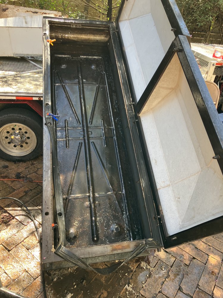

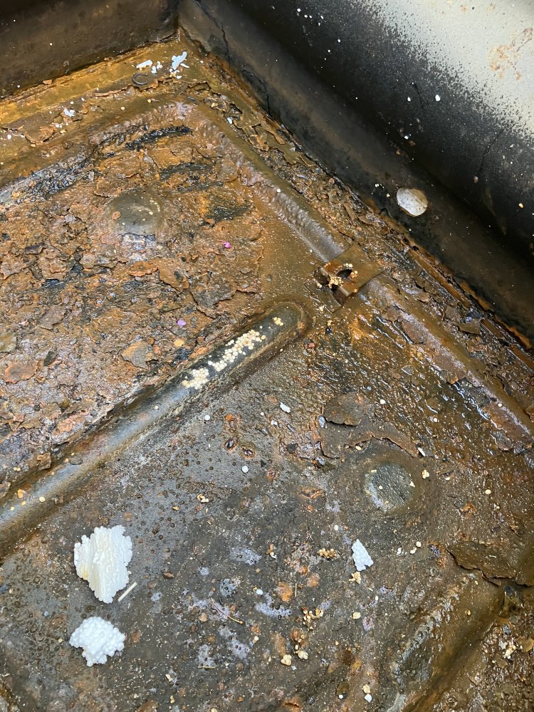

I almost didn’t do it, but I decided to take the Styrofoam out and check the bottom on the inside. I am and I am not happy I did that now. What a f’n nasty job!
This whole thing is near perfect outside, but between the tub and the Styrofoam, and the fact that there’s no drain holes, no way for the inside to breathe (no pun intended), the inside on the bottom was pretty rusty with some pretty good pits, and a few pinholes.
After wire brushing and pressure wash:
Let this be a warning to all you guys to do the routine maintenance on your caskets.

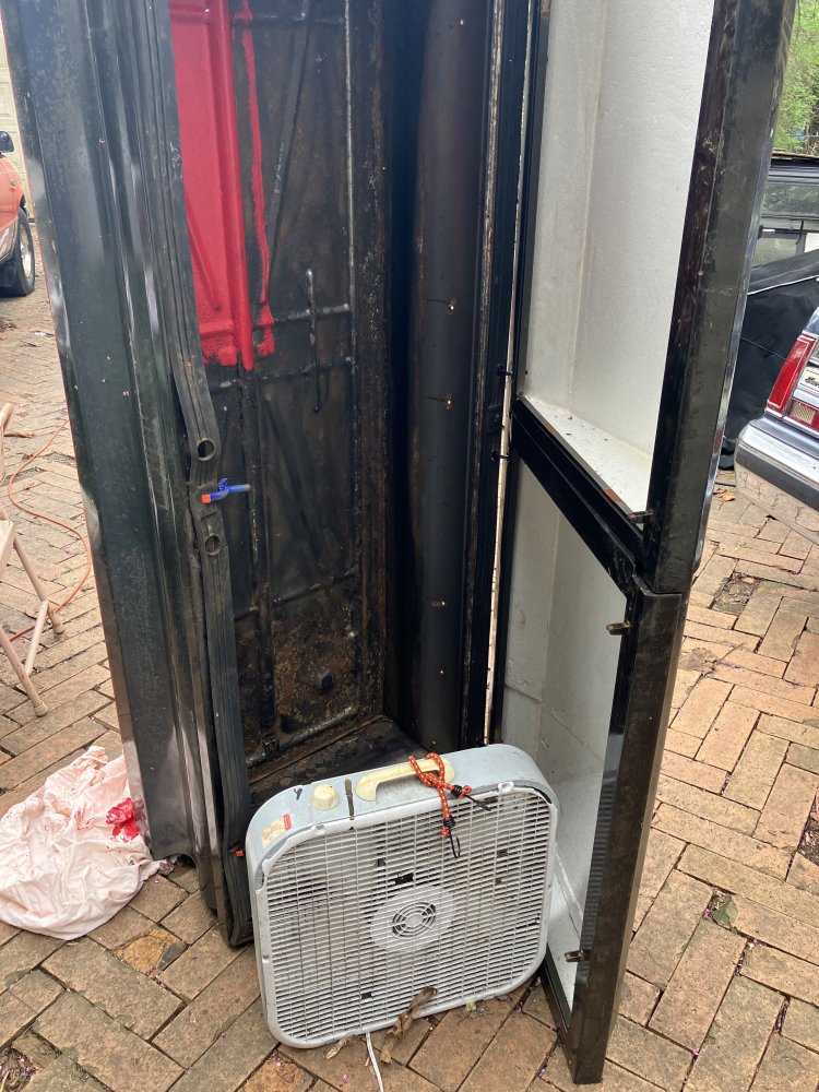

Then I stood it on the end, and put a 24 inch casket drying machine in front of it.

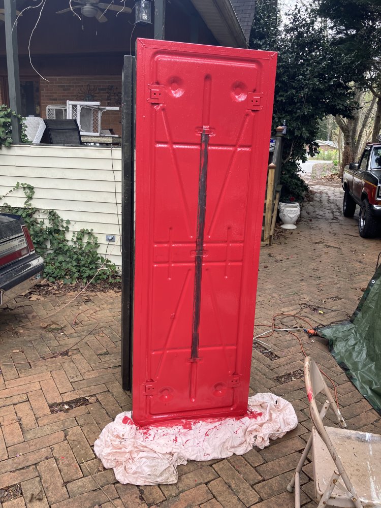

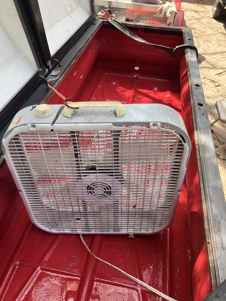

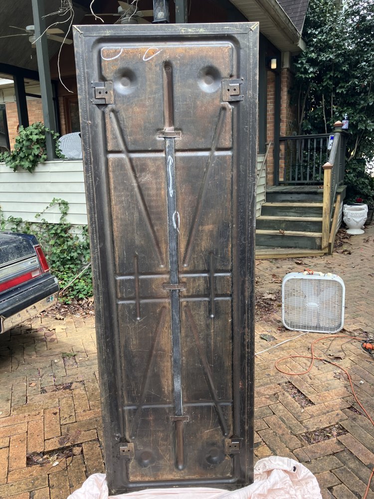

Let me jump ahead to the bottom on the outside. In my previous discussion I was talking about options of how to mount it. I’ve come full circle, and I’m pretty sure I’m just going to bolt it to the aluminum frame before I put any decking around it. If you look at the structure, from the inside, there are all kinds of pockets that would trap water if water got into it. So I am going to drill drain holes in every one of those pockets/low spots. Hence, if something hit it from the bottom and poked a hole, it would be academic.
What do you think about that Christian Louboutin pink/red? I’m thinking the women are going to love it. For the real country boys, Christian Louboutin makes play shoes. This pair was listed at $2600, which doesn’t include the Young Lady. I’ve got a feeling she is much more expensive…
His trademark is that red/pink on the bottom side. Really catchy, huh? (I don’t want anybody to think that I’m using that color on the bottom and then the inside around the tub simply because I had four extra cans of it.)
The dark strip down the middle is a sacrificial aluminum anode (cathode?). For what I’m doing, the design may seem crazy, but it’s actually designed to be buried in the ground, and that sacrificial anode keeps the steel from rusting. It’s not supposed to have liquid on the inside, with the outside exposed to the elements.
I did the first coat 50-50 with mineral spirits. Like I’ve said before, it’ll seep and wick into all of the little nooks and crannies. I also put two 100% coats on it. Drying in the sun now.
If you look at that structure closely, the sides fold underneath, and then the bottom actually sits inside on those folded-in pieces. Inside, you can tell that that was originally caulked with something. Half of that caulk is gone, and that is some of the worst rust.
Fortunately, it’s surface rust with a little pitting, there’s no real structural damage, nothing that needs to be repaired. I mention it because I’m going to mix up a super thin maybe a 70% mineral spirits/30% rustoleum mix, and pour it in /force it into those gaps. Second coat will be the 50-50, and then one or two coats of the pure stuff. I plan on literally mopping the bottom with it. The sides just have a little surface rust. All of that red/pink will be on the bottom, and all around the inside, but behind the tub, nothing you’ll be able to see unless you lay on the ground.

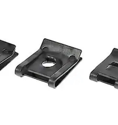

Those holes on the bottom. Is the metal thick enough to install some threaded rivnuts and use those for bolting the casket to the frame or deck?
From my extensive research, I think those four bolt hole things are to hold the Casket on top of one of those accordion dollies they use in the funeral home.
The bottom sheet metal is a hair thicker than the sides, but it’s like tinfoil. I wouldn’t trust any of it if there was a load of soda and whatever inside going down the road.
EDIT: Hence my plan to put angle all the way around or in pieces, a structure that will keep the box from moving and breaking loose.
I did think of running bolts through the bottom, with big backing plates on the inside to reinforce the thin sheet metal. But I don’t know where the frame cross pieces will be yet.
I’d actually prefer your idea or the backing plates so there are no brackets showing, but again, I’d have to leave it all apart until I could set it on the frame.

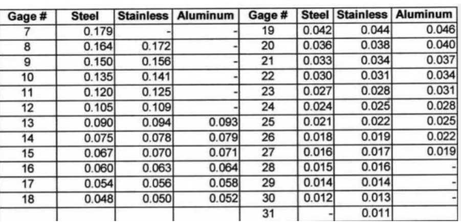

Most metal caskets are 22 gauge. You can literally put a dent in 22ga with your thumb by pushing hard. Quality goes up by even numbers. A premium casket is 20 gauge. A super duper top of the line Casket is 18 gauge, and after that would be a completely custom built.
You can’t get the 18 gauge unless you also get a bunch of other deluxe features like premium handles and trim, the sacrificial anode, better sealed, welded corners and bottoms, an enhanced full bed, etc., etc., the way you would like to go if you have to go.

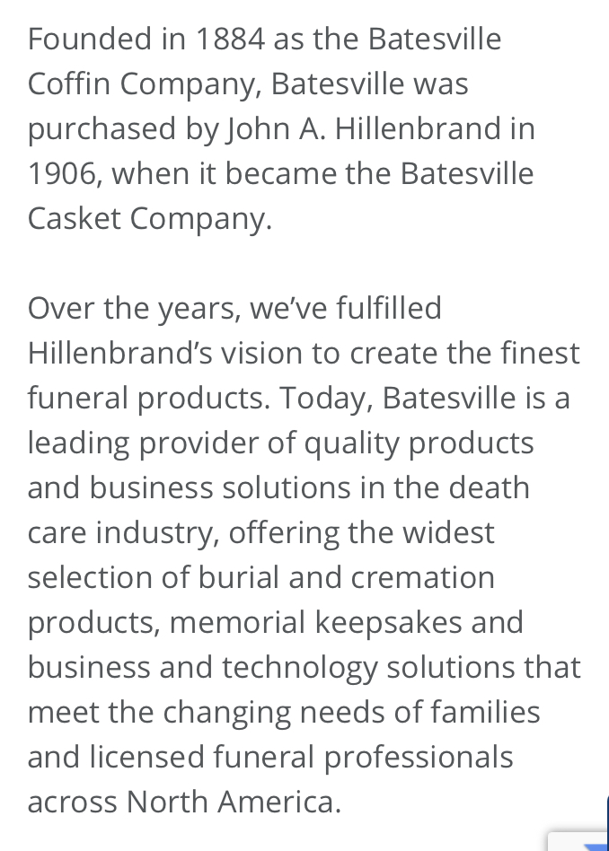

When I was inspecting this thing, I figured out it’s a Batesville casket. That’s like the Mercedes-Benz of caskets.
I’m trying to run down the model number and the original cost, but the 140 year old company was sold just this year, and when I called them, they said they could help me, but all the records and everything are being re-organized with the merger at the moment
The guy I talked to recognized the corner pieces and he did say that it was a very limited production, a very high end item (YAH!!), probably around late 90s or early 2,000s.

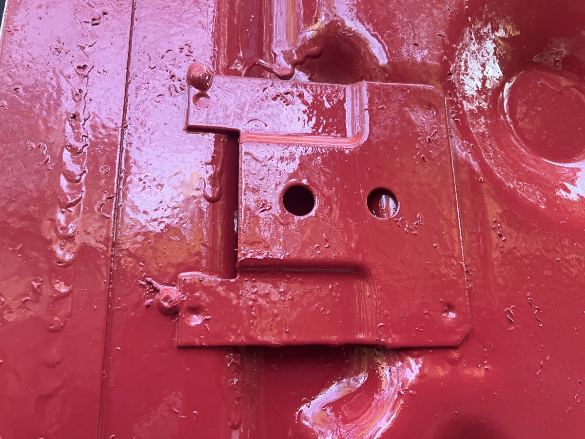

I took a closer look at these brackets on the bottom. I think the bottom sheet metal might be like 16 gauge, a little heavier than the sides and top (but it has been weakened by corrosion). These brackets look like they might be even a little heavier than that, but…
They’re only held on with four teeny tiny spot welds, and then the makers didn’t even trust those, so when they welded up the corners of the box, they did a quick mig spot on the two outside corners of these brackets. It almost looks like it’s designed for a big screw clip.
The inside of the box is about 24 inches wide and maybe 20 inches deep. And then it’s a little over 7 feet long. Thinking of it as a cooler, 50% full of soda, ice and water, that would be about 12-13 ft.³ of water, or about 750 pounds, and that would be in motion. I just don’t see those clips holding it if I had to hit the brakes hard.
The next thought might be to weld them on more securely, but again, it’s like welding to tinfoil. Even if I could do it with my crappy welding skills, the only way you get strength would be if you almost replace the whole bottom with something thicker.
It did lead me to a thought of putting backing plates around the bottom of the box wall, and extending some bolts from the inside out. Then I could put an angled brace outside that’s bolted through the skin and then the aluminum frame. I’m planning on aluminum frame cross pieces at each end of the casket, but I don’t know exactly where any in between will be, they will be set by the spring mount locations.
Another thought I just had was to put an aluminum angle inside around the bottom of the box. Then wherever I put my hold down cleats, I could drill through from the outside, and put in some of those self tapping 1/4 x 20 bolts. I’ll have to think that out, because I only have like 2490 bolts left.
EDIT: note that the folded in part of the side is seam welded to the floor pan. I just noticed that from this picture.

I can see why you don't want to trust them. Normal duty for a casket is no where near that weight and is expected to be a one time use and at a slow, dignified speed.
My guess is some kind of securing bar is meant to go into those slots to hold the casket in place while being transported to the funeral and final resting place. Holding ice and drinks for a party or celebration of some sort was never in the planning and design.
Agreed. I know hearses have clamping mechanisms, so it’s not that (I think), and I come back to the dolly. But you may be right. If we all get liquored up and drop it, it’s a little different than if it’s dropped during its intended use….
But check this out! Two quarts mixed with one quart of thinner. I literally poured it around the edge, and then worked it in with a long bristle three inch brush.
