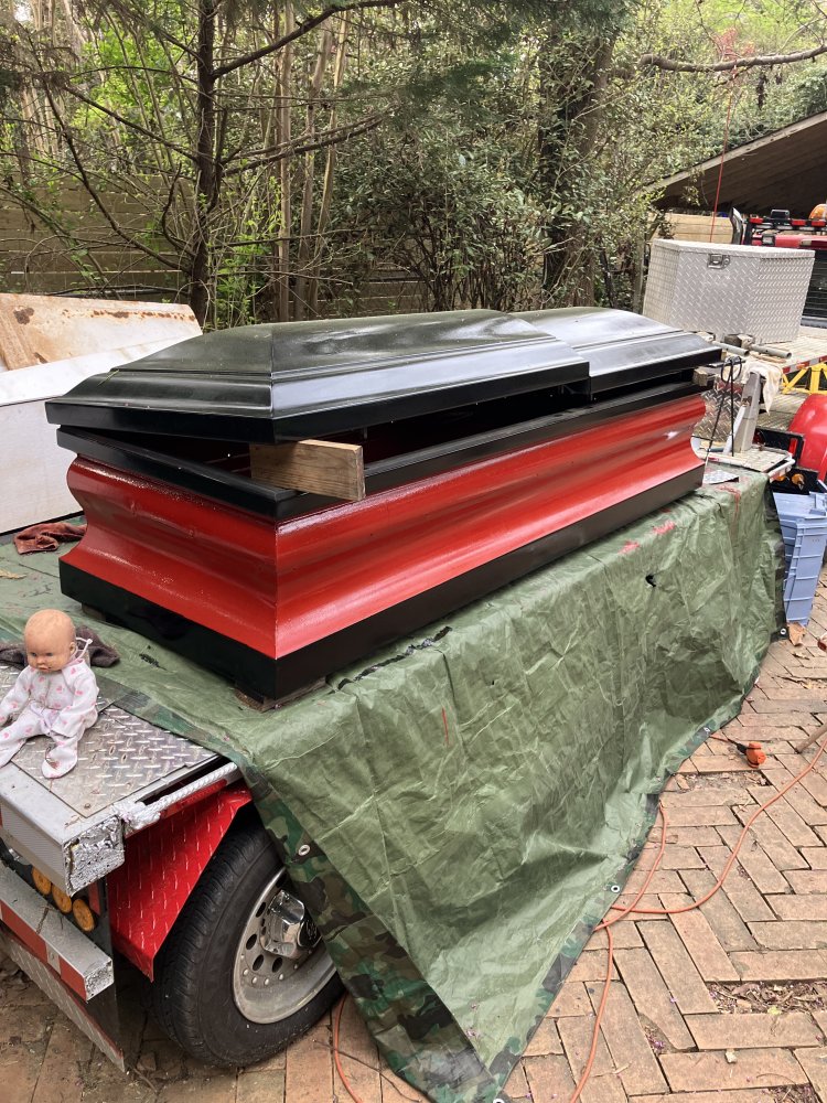

I got the second coat of regal red on the outside, and the first coat of the gloss black on the top and bottom. I drilled 10 holes in the bottom in all the pockets to let any water drain. I’ll smear some paint on those holes from the inside before I put the insulation and tub back in. I’ll touch them up with paint on the outside before I bolt it to the frame.
I want to drill another drain hole right underneath the drain valve. The way this thing is made, there is a raised edge about 2 inches inside the perimeter. I want to drill a hole at either end to let water drain, but I can’t access it from the inside, too much of an angle.

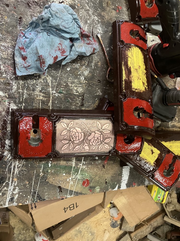

I got all the handles and hardware first coat painted with my homemade maroon.
I’m liking the way the basic box came out:
The ‘RAITH Party Cart….
I still have to put another coat on the top, maybe two for durability
It all looked good on test panels, but I am not so happy on the handles and accents, but I’m working on them.

That’s not black. That’s a mixture of two parts regal red, and one part black. Technically, it has to match because it is a mixture of the two colors.

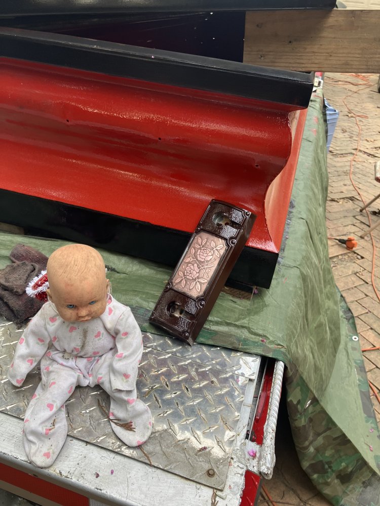

It almost looks brown instead of maroon. I’m trying to save the rose gold inserts, but I’m not liking that match either.
There are different aspects to the ornamentation, so I’m painting the inserts behind the handle holes red, and I’m going to put some red accents on the smaller pieces of hardware. When the paint dries, I’ll put one together and install it on the end and make a decision.
Part of me is thinking to just make it silver or gold, or both, which always goes with black and red. Remember it’s going to be on an aluminum diamond plate trailer
I’m thinking of some pinstriping, but I’ll hold off on that until the whole trailer comes together. These handles and accents are much easier to paint sitting on a workbench, so it’s a momentary bottleneck.

It’s supposed to rain tomorrow, so I went out about 5:00, quick sanded the top, and foam rolled on another coat of black. It should be cured enough by the rain so it won’t get hurt. I envision a final coat after the rig is all together. Probably no way I’ll get it all done without scratching it somewhere.
Those rose gold inserts are stamped aluminum stickers. I put masking tape over them to paint the handles, and when I went to pull the tape, the one use for a few days good looking cheap as crap stickers wanted to come off too. I’m exploring replacement insert stickers.

I know I can save them. After the first one started to pull up, I used a couple of picks and went very slowly, and didn’t have any trouble getting the tape off. Question now is do I want to save them.
The reason I bought that teeny can of spray Rose gold, was to shoot it into a cup, and then use an artist brush to touch these things up. There are eight of them on the handle brackets, and then four of them are folded 90° over the corner pieces, 12 total. Two are badly damaged, and another four have deep scratches. I’m pretty sure that if I touch them up with the rose gold, the defects will disappear in the grand ensemble.
My bigger issue at the moment is when I did my test panels, it looked like they would match ok, and now that I’ve got everything painted, they don’t look like they match at all. They’re roughly 3” x 5”, but again, in the grand ensemble, they probably just about disappear. If I can’t replace them, I want to save them, simply for the ghoul factor because they’re real Casket stuff.
I already have a call into Batesville Casket. I’m assuming this is a standard item that I could maybe purchase, but I don’t know what they cost, and again, they are in transition right now. If I can replace them, I would prefer #1 gold, or #2 silver. And they may have other colors. To look at them you’d think they’re $.50 each, but if they’re $10 each, we go to Plan B even if they’re available.
I don’t know if you can see it in my pictures, but where I painted the two ends of the handle bezels red, the pot metal is textured. From the little bit I could see underneath the corner of the one that started to pull up, I believe it’s textured in that center panel too. Options could be to just paint it to match or contrast, or to just get a completely different sticker, like a picture of it @snoranger , and use that.
I may have been overly concerned with the color of my inserts. Looks a lot better when it’s all together.

Every time I put a coat of red or black on the outside, I chocked it open with some 2x4s so the interior paint would dry (I poured it in pretty thick). The lids are actually designed like a pagoda, to shed water, and they extend past the box, so water will drip down and not run under. There was a little bit of water where I had it chocked open, outside the rise I described before that runs around the perimeter about 2 inches inside the wall. The rest of the inside was bone dry (get it?). I’m almost glad I saw this, because the solution will be to drill a hole in each corner, not simply on each end.
The thing was designed to be watertight, but that’s only if you crank the lid down. I suspect the water damage inside was from imperfect installation of the drain in the tub, and the way the tub was attached around the lip (not caulked). If water got into the interstitial space, there was no way for it to get out. Cleaning it up was nasty, but actually it was very little rust considering this thing is 10 or 15 years old or older.
There’s a very stout rubber gasket that runs around the top. The lids ratchet down with about a half a dozen catch points, operated by 3/8 Allen wrench from one corner. The design overall is really excellent, and the fit and finish are excellent, it’s just not built for durability (other than being covered with dirt!).
I’d be surprised if any water gets in from the top after this, nor from the tub or the tub drains when I redo them/add them. But if it does, it can leak out, won’t affect the insulation of the tub to keep the beer cold, and it can dry out now.
