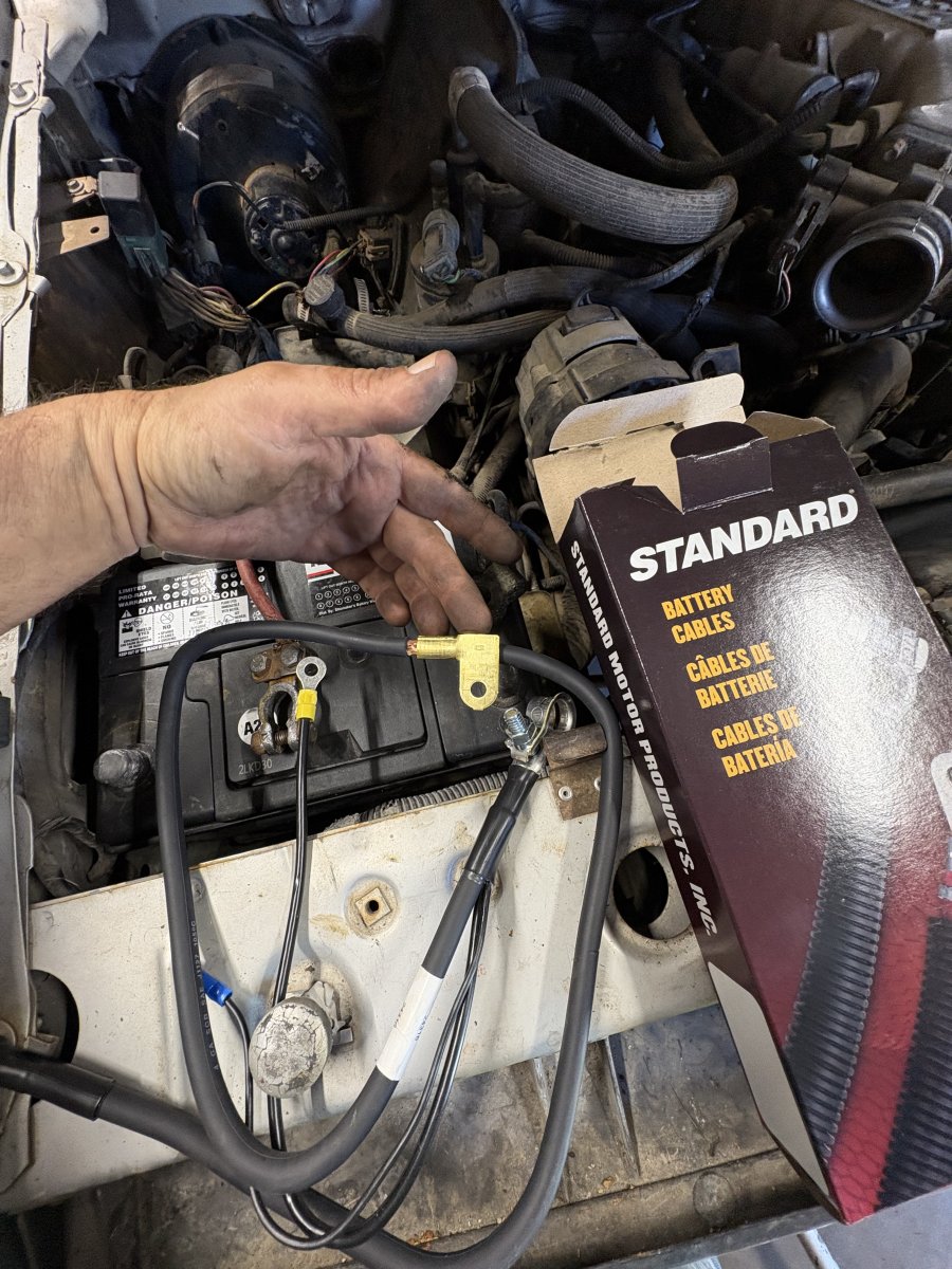

I got my factory battery cable in today. Got it from partsgeek. I posted this on my Ranger build but someone might nit seen it and not see the factory grounds.

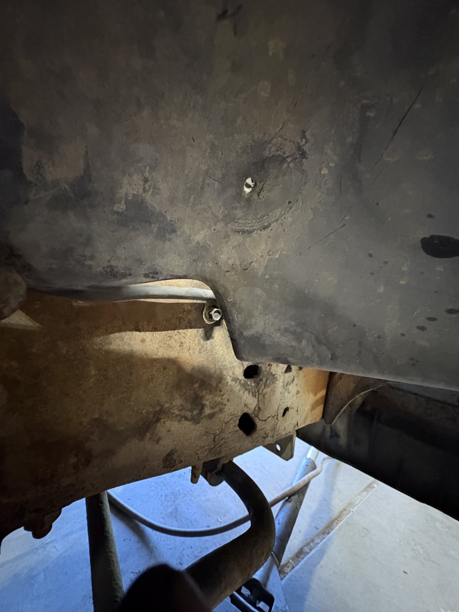

From battery post to frame. Frame ground is hidden behind inner fender. Stub frame with a wire brush to bare metal.

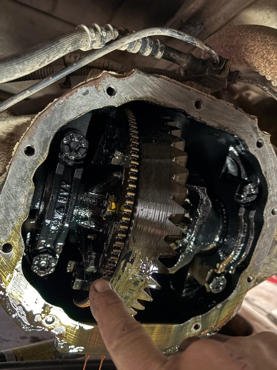

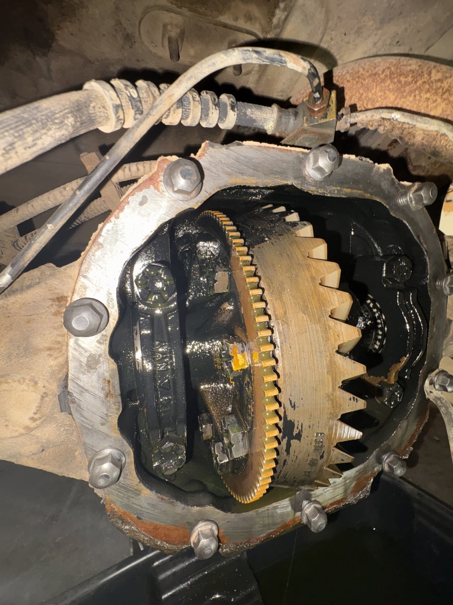

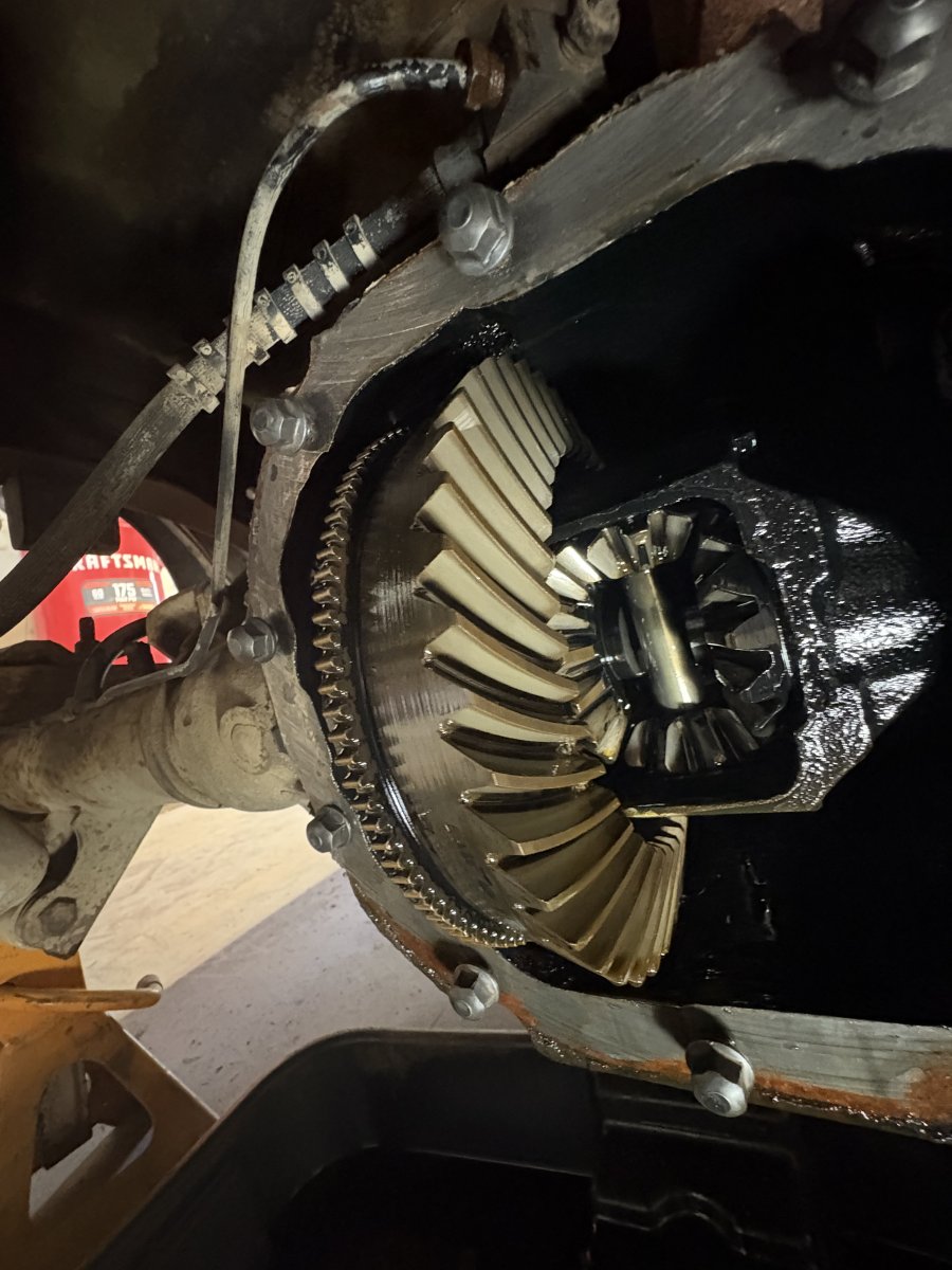

I am guessing this has limited slip. First time I ever had a vehicle with limited slip. I don’t see any issues here but will have my friend to take a look as well. Seems to spin ok. I will eventually change all fluids on this truck but current issue brought this up.
I don't think that is LS. I don't know them well enough to tell from that angle tho. Can you get a picture from about 90* to the right?

Wow. The top picture makes look rusty but it is not rusty at all. I tried to get further right and it would disappear. Also got one from the left.
Yeah. No spring. That's an open differential.
While not a bad idea to verify what you have by opening up the differential, the tag indicated it was an open differential. If it had a limited slip, the tag would have had a 3L73 on the tag. But people have been known to change the internals from time to time. So, without verification, you really wouldn't know outside of putting it up on jack stands and testing it.

Thanks @sgtsandman, I was fairly sure it would of been on the tag just had not gotten around to verifying it. Also I want to do a complete fluid change and was glad to see it had fresh gear oil in it. My truck had original 1988 gear oil in it.You never know what is hidden.

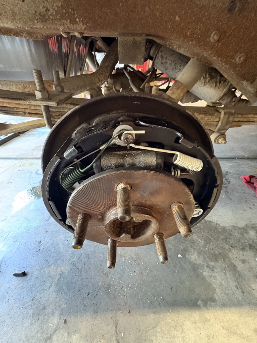

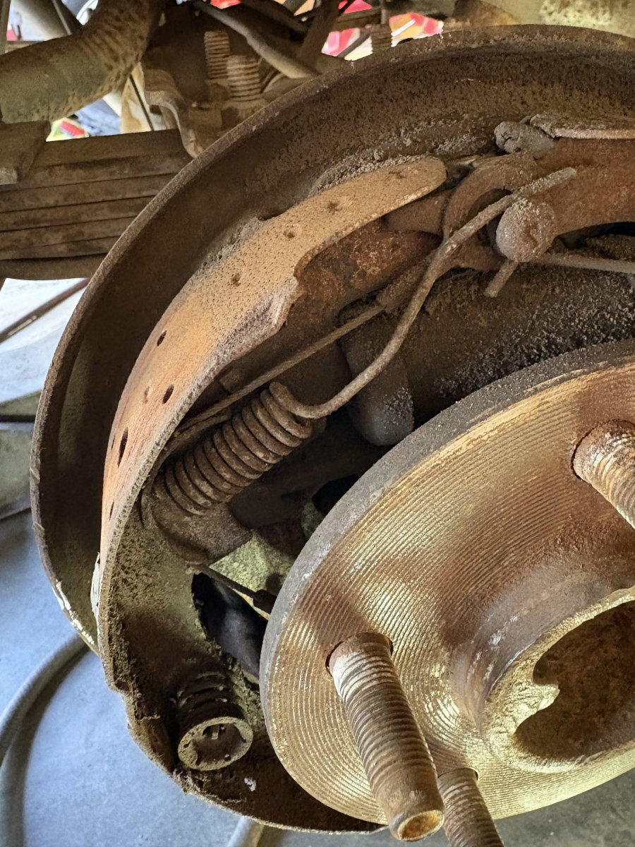

A friend of mine help me get the rear brakes done. Irritates me I can not do them by myself but they are done. Went to test if they were holding truck down and my return battery is dead. It tested bad so will get it replaced. Rain all weekend long so will see what I can get done. I got plenty of work to do between both trucks. Looking forward to seeing what I can get done.
I see all this work you do and I just have to think you have yourself convinced you "can't" do drum brakes. If you're trying to do it without the proper tools... that could be part of your problem.
I did notice two things...
The self adjusting cable has a crimp to keep it together. The crimped side of the eyelet should be away from the brake shoe. It doesn't always touch the shoe if you have it wrong... but I've seen many times that it does. If the crimp is rubbing on the shoe... you should reverse it.
The green secondary shoe return spring. It looks like the hook end that goes over the anchor pin got spread out a bit. When that spreads out... the spring tension from that spring is weakened. Simply taking a pair of channel locks and squeezing the hook back together will help.
Just a couple tips from Uncle Gump...
