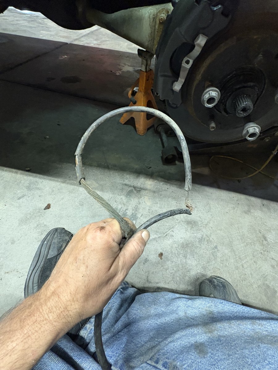

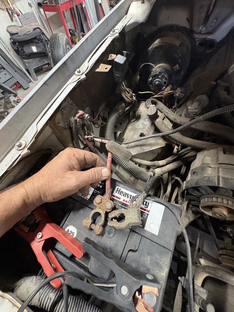

I found my loose cable. The factory goes from battery to frame to block. They just cut the connector off. It was still attached to block.
1/2 inch bolt. Yea for 80’s trucks. Metric and standard. I think this cable is wore out.

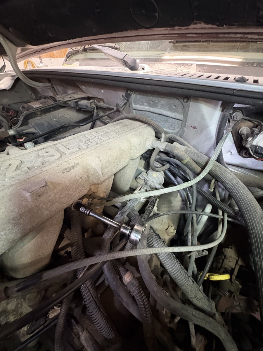

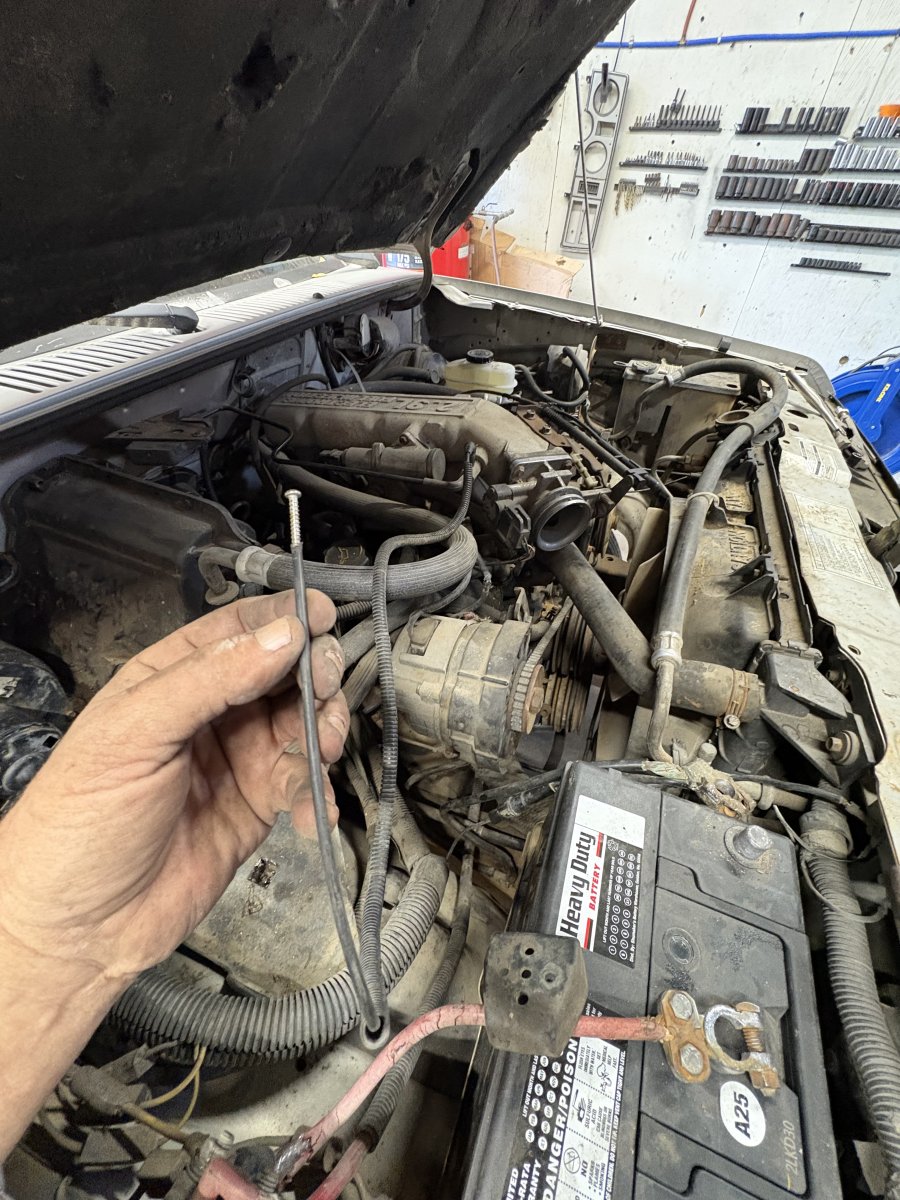

And, what in the hell is this that's in the circle?
Unless I've accidentally smoked something that I've forgotten about, it sure looks like a screw has been run into the bat cable as a master hack power tap.
Thanks RobbieD. I will look into tagging. I have tried the quote thing still not figured it out. I’m an old geezer and some if this technology is getting harder for me to under and kids aren’t here to help.
That is a master hack but not a bad one. It is a screw plugging off the vacuum line to the air box. Luckily that will be an easy fix.

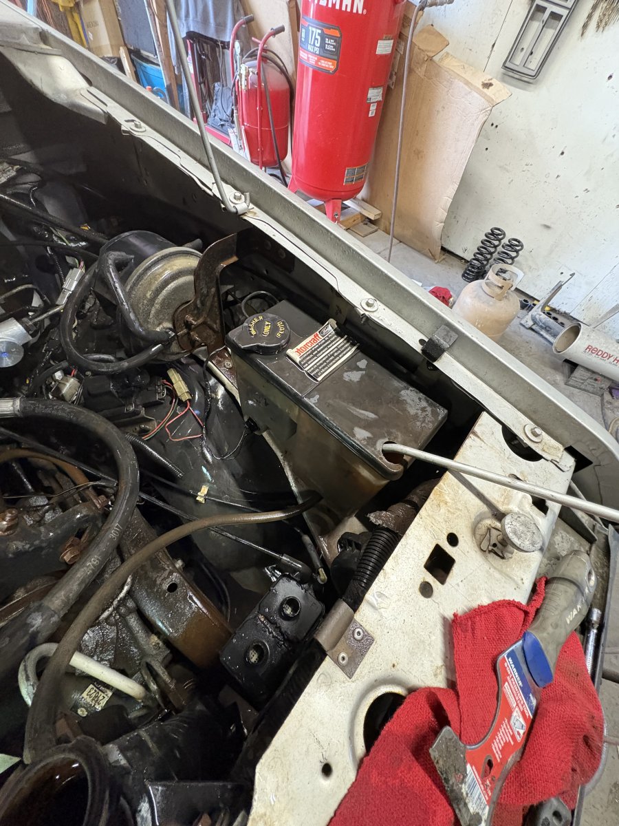

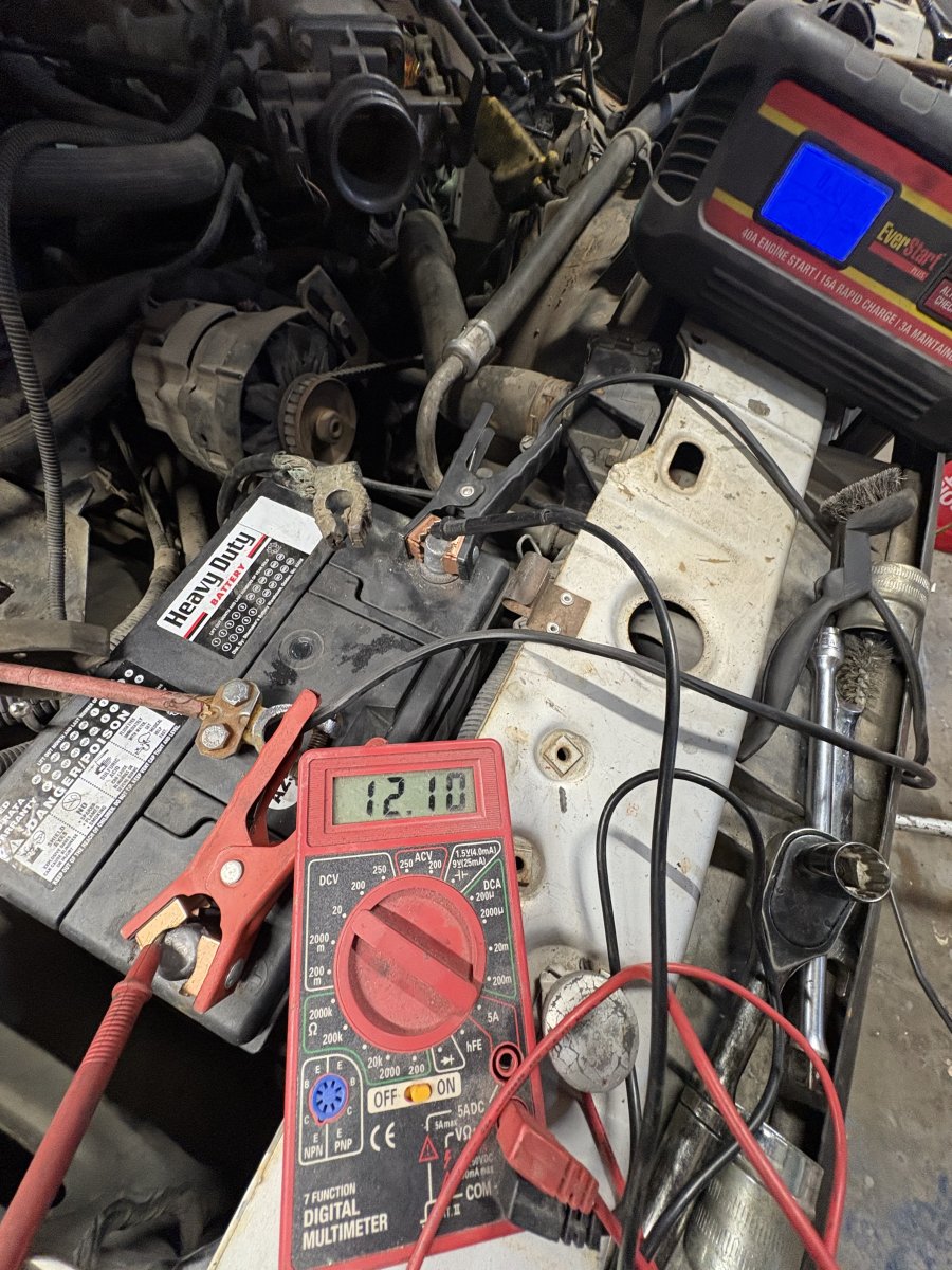

Took a wire brush to some grounds off of cable to battery.
7mm ground. Still not starting.
While waiting for battery to charge thought I would clean another ground from plenum to wiper motor. Yea!! Wiper motor ground just spins but I cleansers ground on plenum. 8 mm

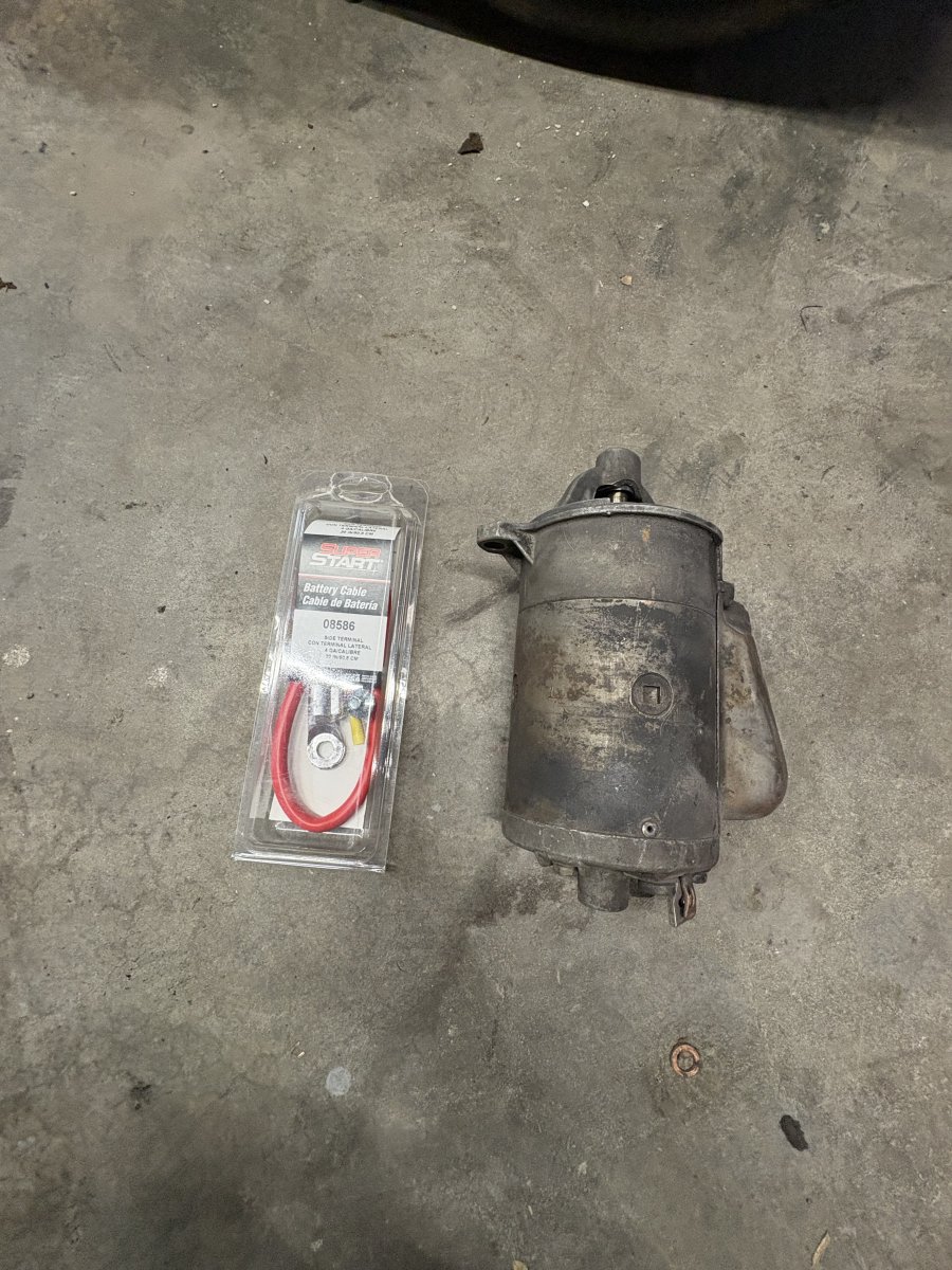

Checked battery voltage. Brought battery out if Ranger to jump start. Cleaned contacts on starter relay, and jumped terminals to starter on relay and still no start. It will crank slowly for a second or just clicks. I think my starter went on strike. I have a used one. Going to Orielly to have them test an old starter. I will have a mom and pop rebuild my current starter if it is bad. Off to test starter and if good I will swap starters. On a good note truck will roll in shop so hoping I got the biding issue fixed. Once I get it starting again I can see if it will move with no difficulty.

Had starter tested at Orielly it passed. It is one from another motor I had on the shelf. I got a cable to help with some of the problem. I will get a cable from starter relay to starter at a later time. Cables are shot and some of my problem.
Battery cables can make a HUGE difference in starting, charging, and electrical gremlins in general. The cables that were on my 68 F-100 weren't much different condition when I got it. Replacing them made a heck of an improvement. Installing a updated 3G alternator and a high torque mini starter were both major improvements. When/if you have to replace those with new, I'd suggest looking into it. The alternator can be done on nearly any older Ford, not sure if the HTMS is available for the 2.9L. Found a company on ebay that offered one for the FE in the F-100 that seemed to be a good balance of reputation and price. It has worked great so far, but it's been many years and I don't remember the manufacturer.

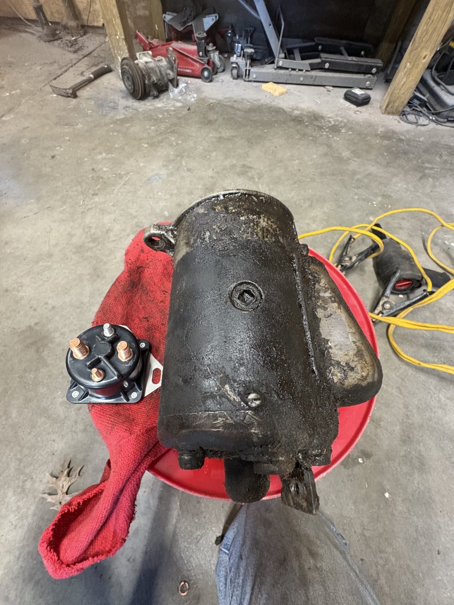

This is the starter that come off of the Bronco. I took it and it tested good. I for giggles went a head and got a new starter relay. This is 4 post. Bronco has 3 post. Ranger has 4 post. As I understand it, 3 or 4 post is interchangeable. ??? Still acting like a weak battery. Both starters are testing good. I’m thinking battery is bad or the cables just finally gave it up. Battery is at Orielly getting tested.

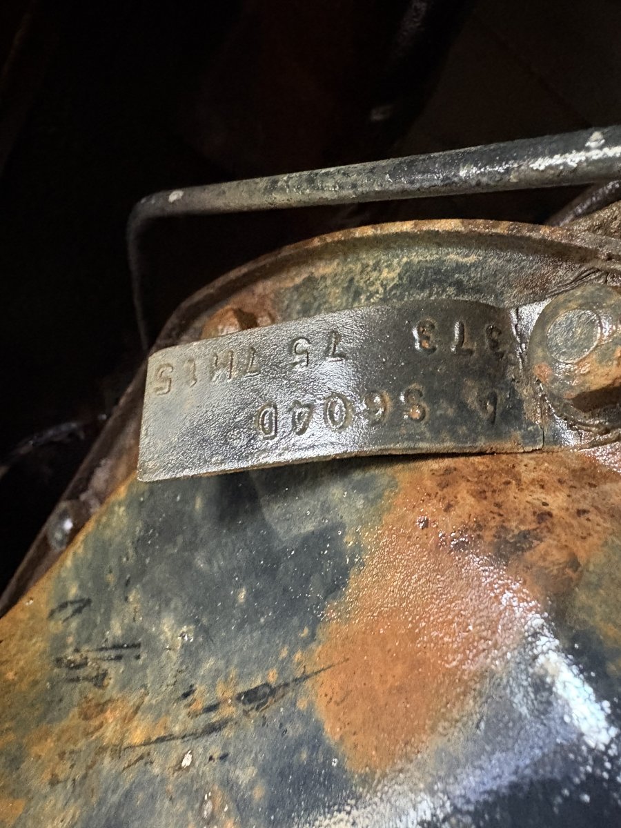

I tried to turn camera upside down. Don’t think I have Limited Slip. I knew I had the 7.5 axle and now I know I have 3.73 gearing. I will decipher the other information later on.

Is the old bad ground cable that's present, does it go to both the frame and the engine block?
A photo you showed earlier of an old ground cable, that was still bolted to the block. When that replacement was made, whoever did it may have cut corners and used a single, shorter universal grounding cable and just ran it to the frame. That means the starter would be grounding through the smaller braided ground strap to the body, and also through the driveline. That would work for the most part, until the ground path degraded and then it won't work. And it would be harder on the starter.
The correct replacement cable that you want will have a large eyelet about midway, that goes to the frame, and then end in a large ring terminal which bolts to the block. And it will also have a separate smaller wire which bolts to the fender to ground the body.
Some one in the past did a bang up job on it. They just cut the old cable and left it to the block. The current cable they used is way shorter and it does go to the frame but and then routed to the alternator bracket. It is not good by any means. I am hoping my correct cable will be here some time this week. I ordered a day or two ago. While replacing the starter, I seen a couple of small wires disconnected. I would not be surprised if it has to do with the transfer case shifter. I got a few wire issues I am going to have to chase out.
