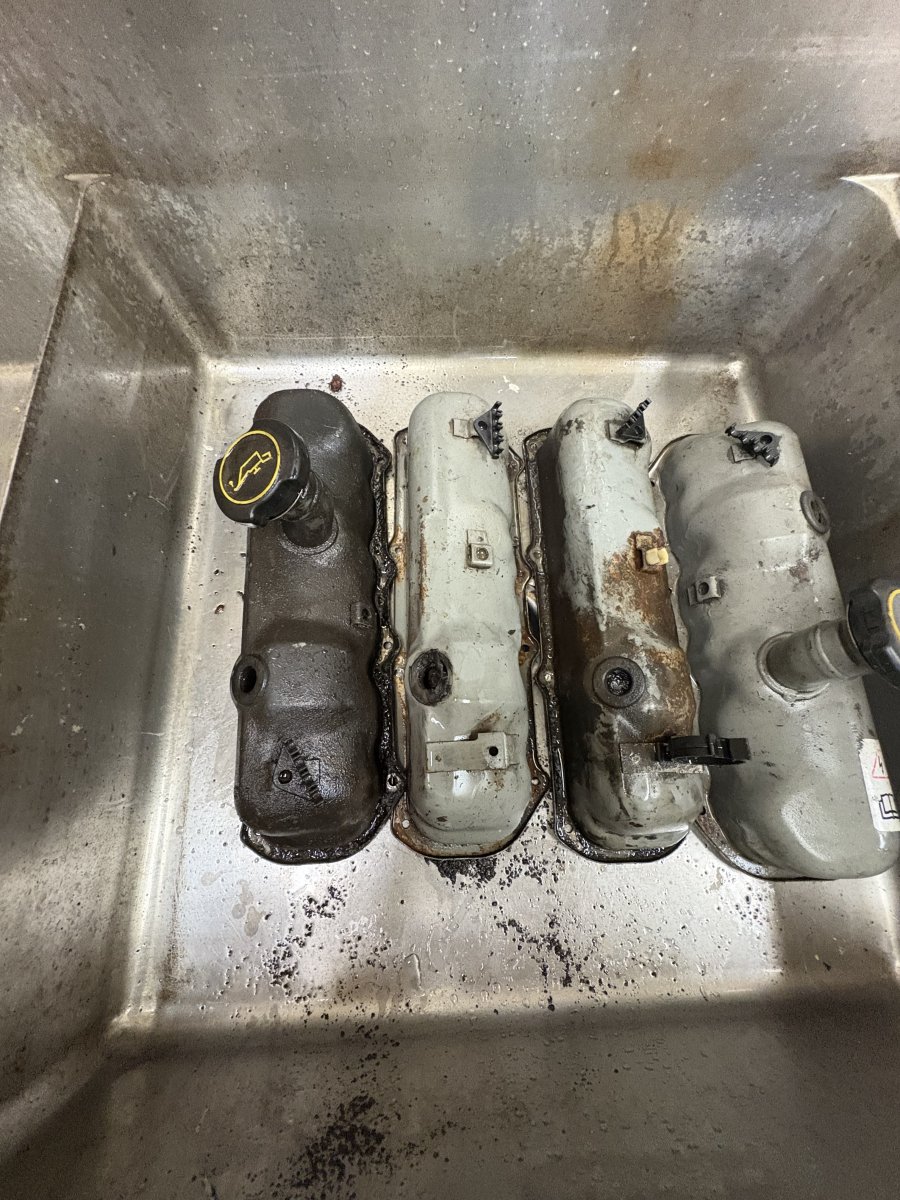

I have a spare set of valve covers. Cleaned them up and used the best set.

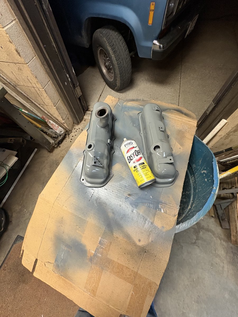

I tried about every engine degreaser there is. For baked on carbon grease, Easy Off works the best. I use it on axles, engines, transmission. Freshly painted covers.

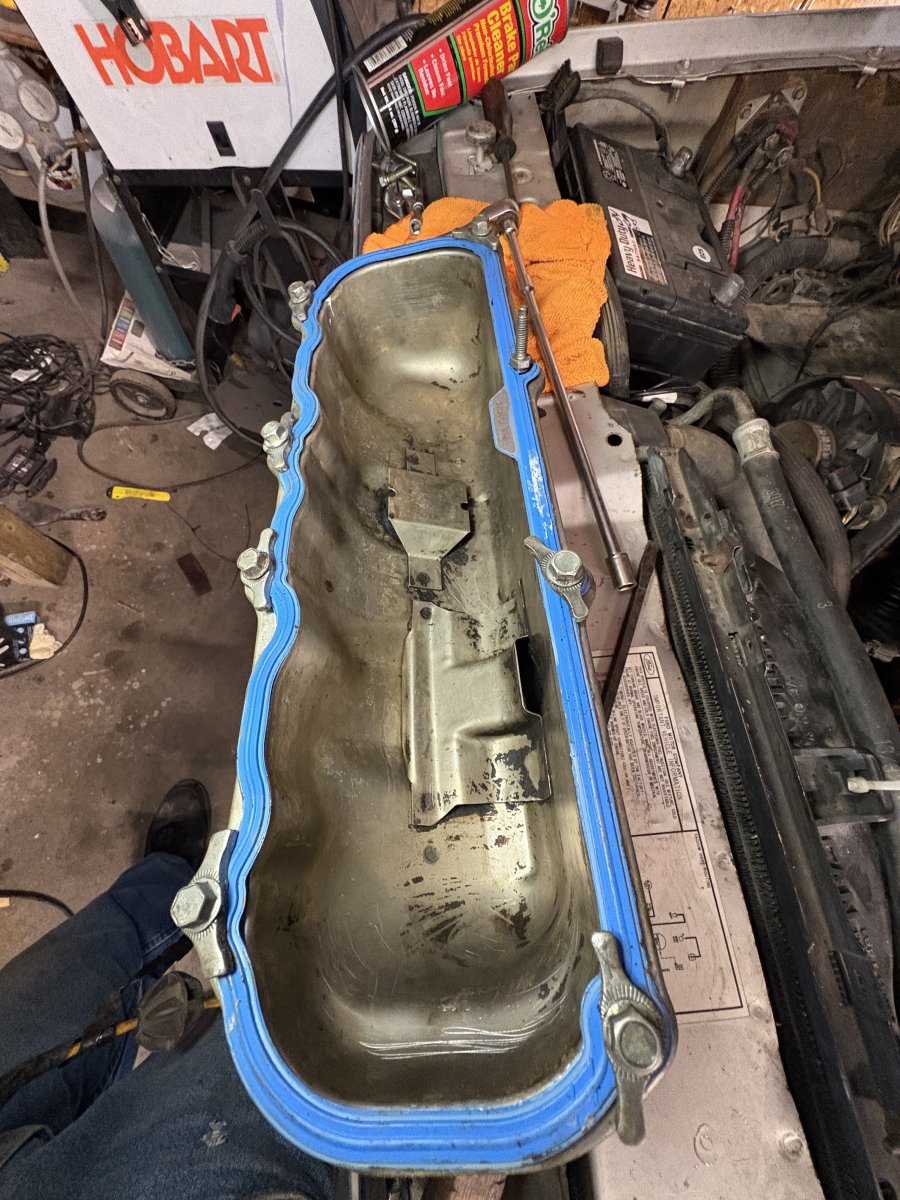

I finally got the old gasket off. That was a work out getting it off.
Some reason I could not get the gasket to line up with bolt holes in the head. Patience is good. It is getting muggy already so will let gasket sit until tomorrow and form to bolt holes.

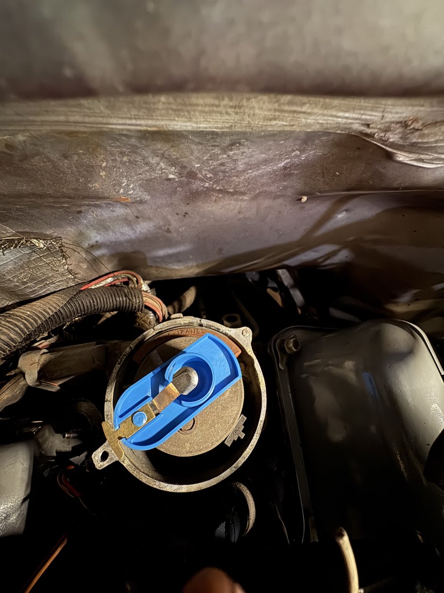

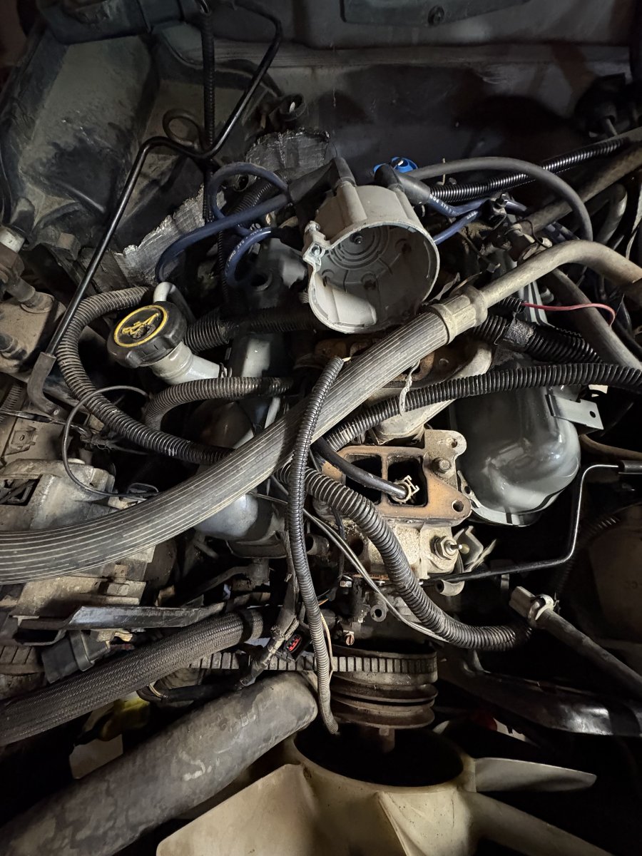

The plan was to get valve covers on and then work my way up for a complete tune up. That was the plan. The picture did not turn out. Left side distributor cap had a zip tie holding on. You can see the screw hole is wallowed out. Right side screw is broken inside the hole.

I did finally get drivers side cover on. Ended up using original valve cover. Guess the one I had was tweaked. I went to bone yard and found a distributor but did not have the necessary tools to get it all the way out. Going back next week to get distributor. I am finally building me up a salvaged yard tool kit. Not first time I have been bitten not having the correct tools. Lesson learned.

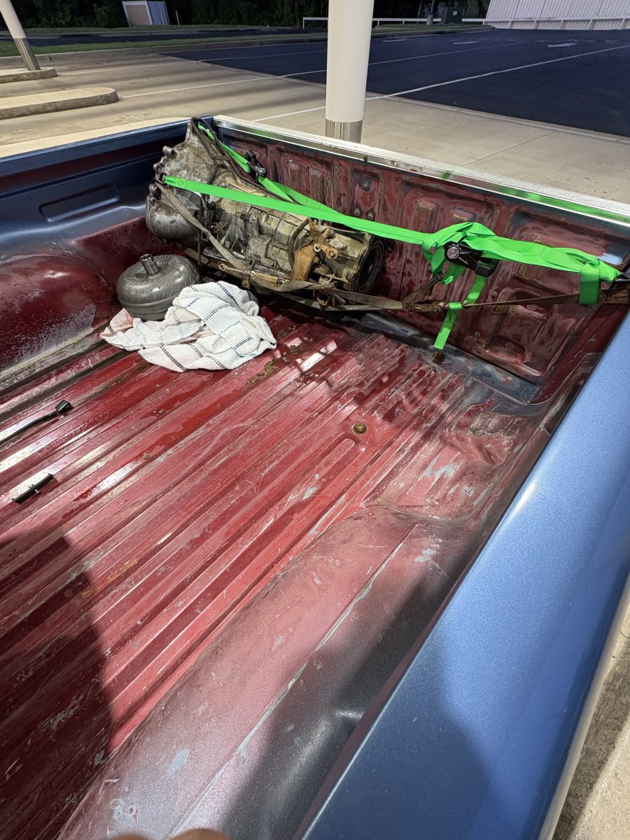

I was going to have my transmission rebuilt. This come out if a wrecked truck I come across and the owner thought thinks it was rebuilt not long ago before it was just setting. It does look promising.
Fingers crossed. 🤞
