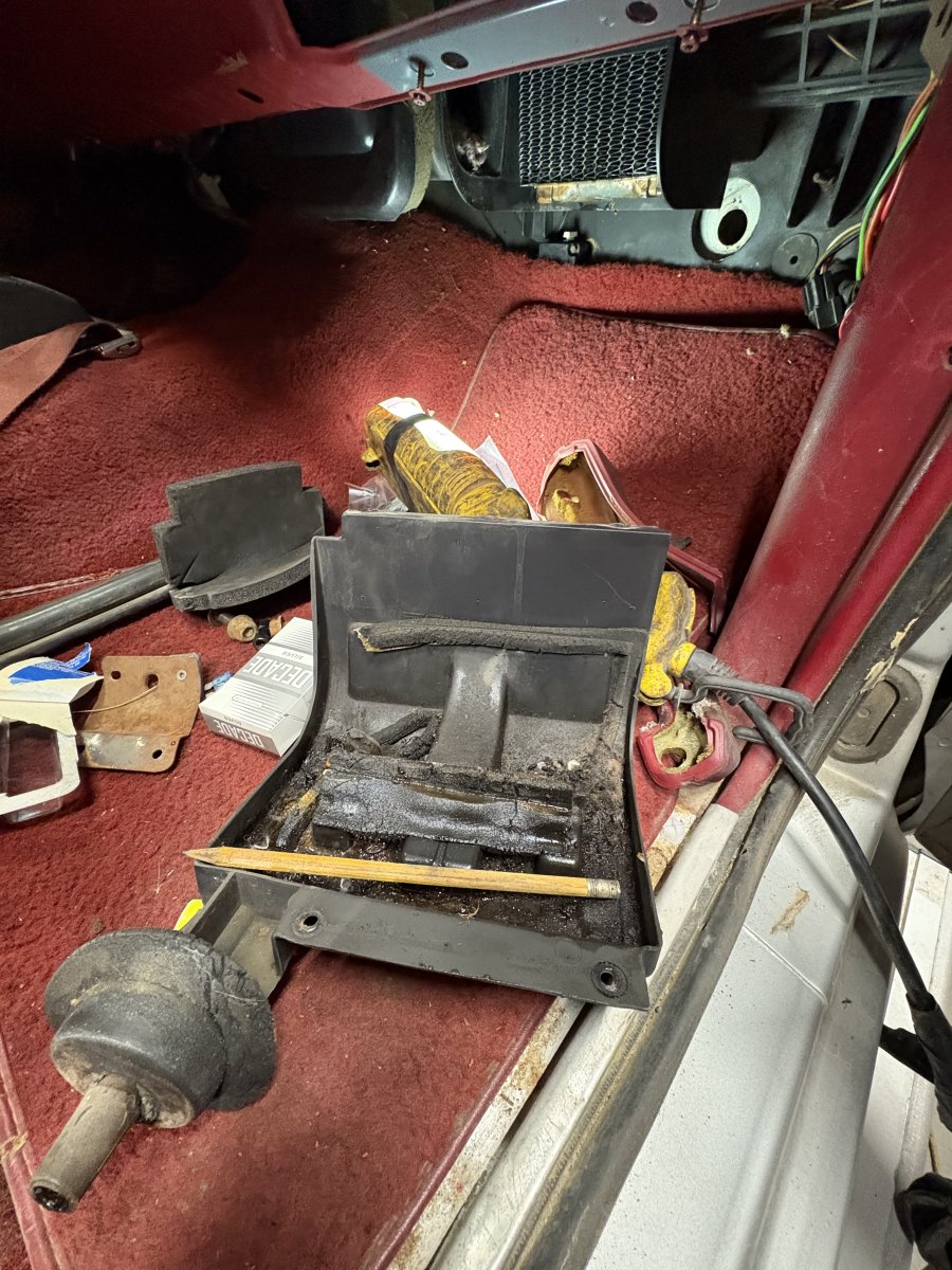

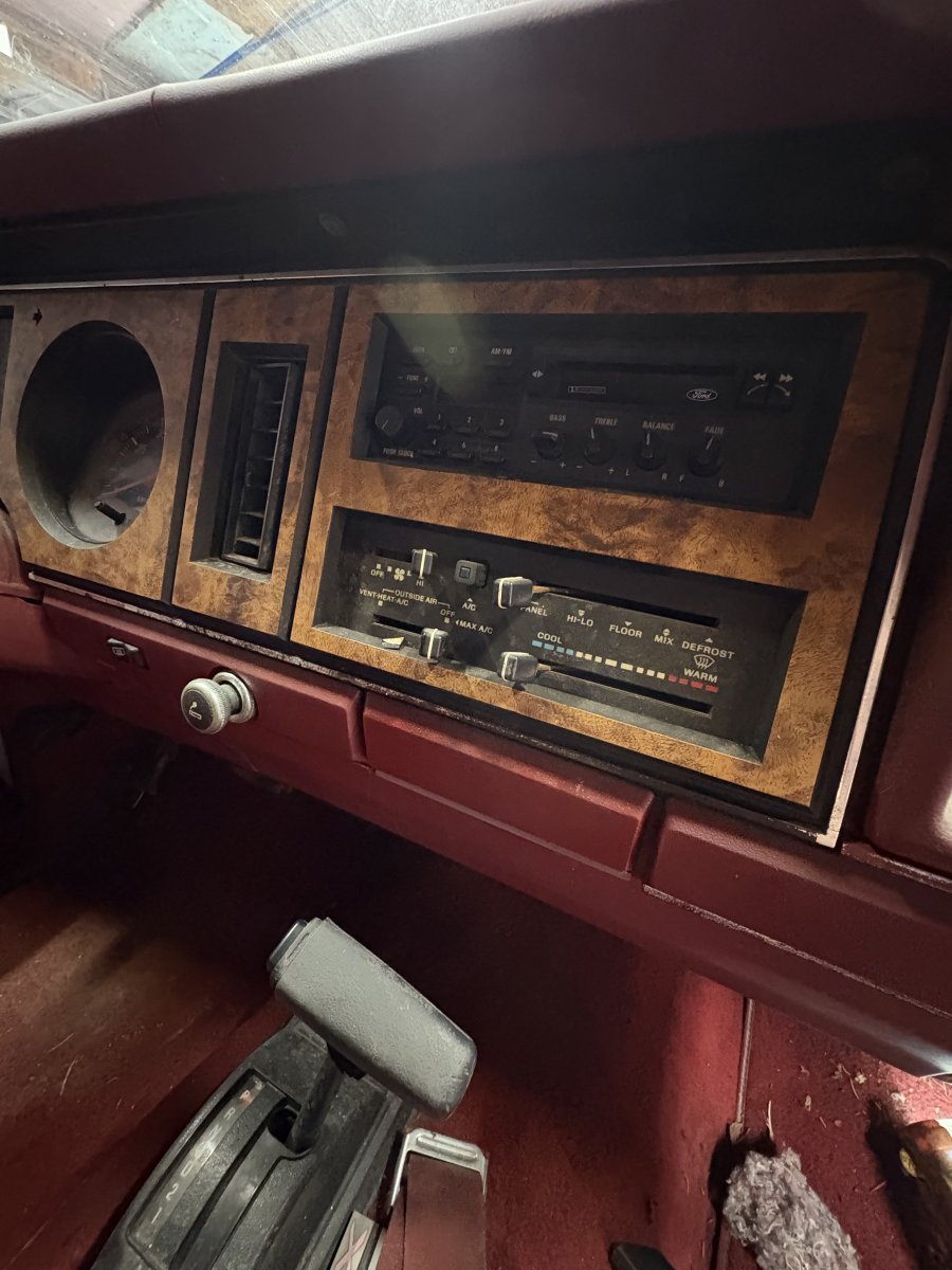

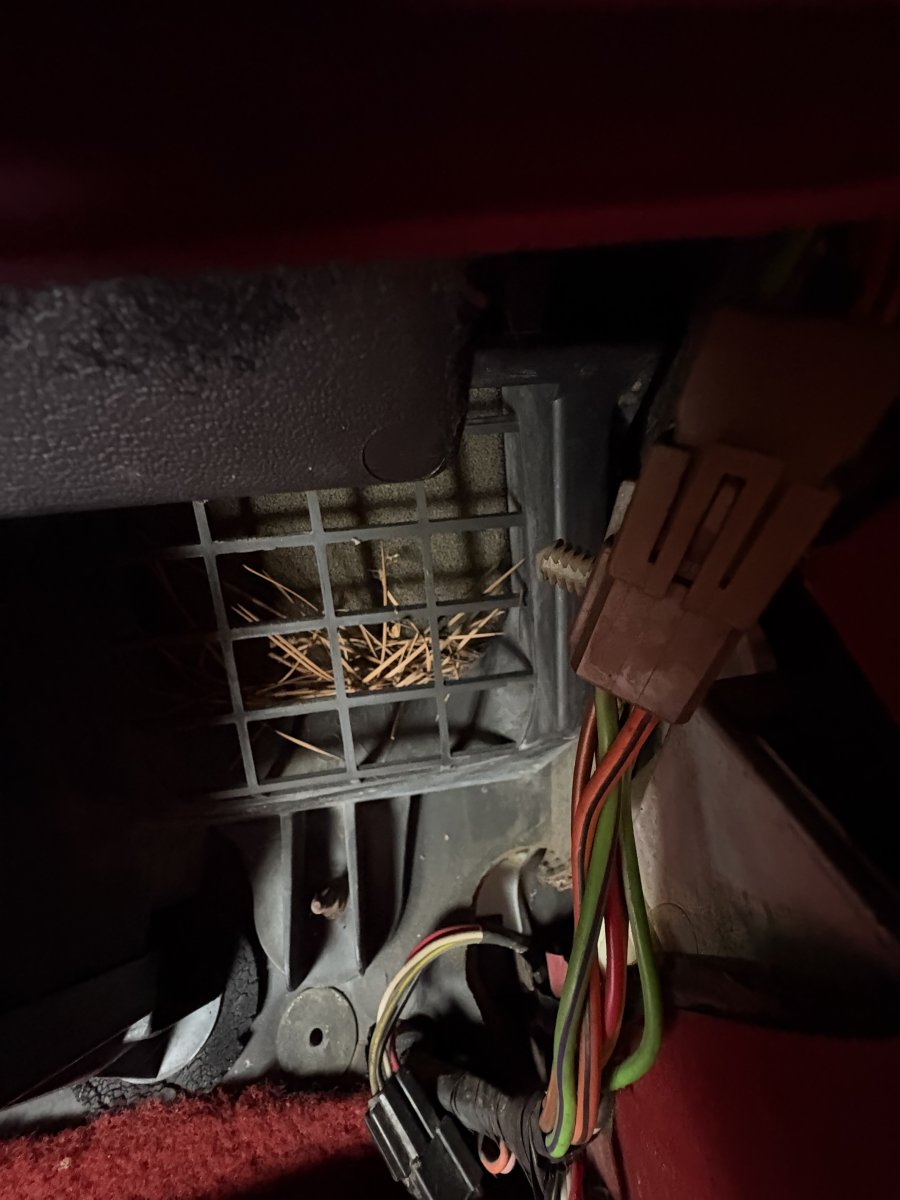

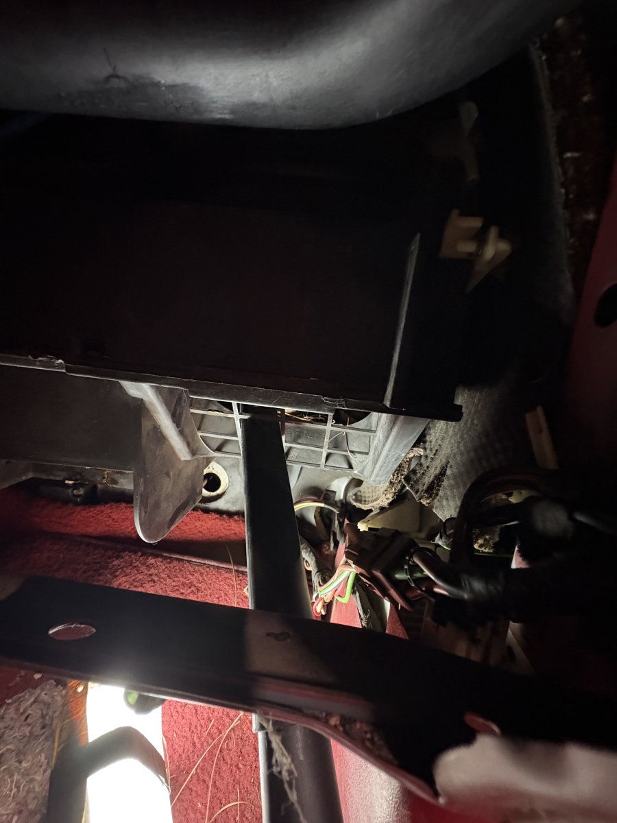

Use a T15 to remove glove box. Some signs of why lever is not working. It gets worse

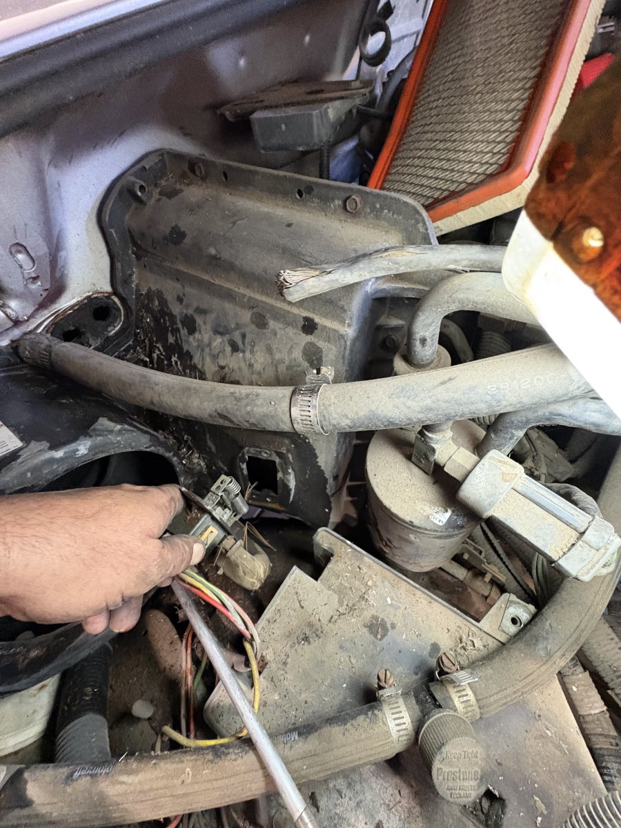

8mm to get 3 screws off of front of heater core and 2 more in the back. Remove cover. Already signs of a mouse making a home in here at one time. No idea how pencil was in there.

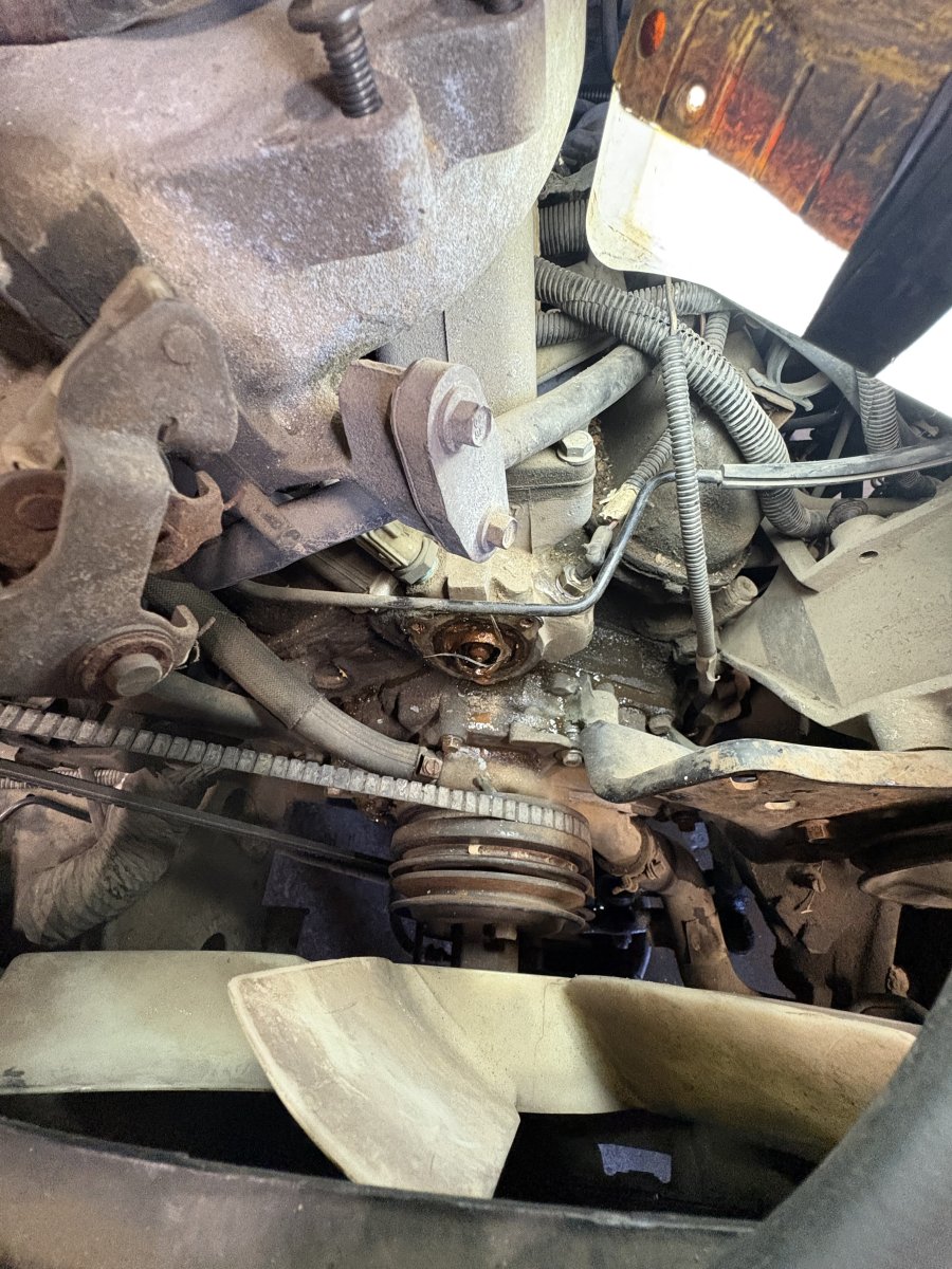

Remove hoses under the hood and work core thru carefully and not spill fluid inside.

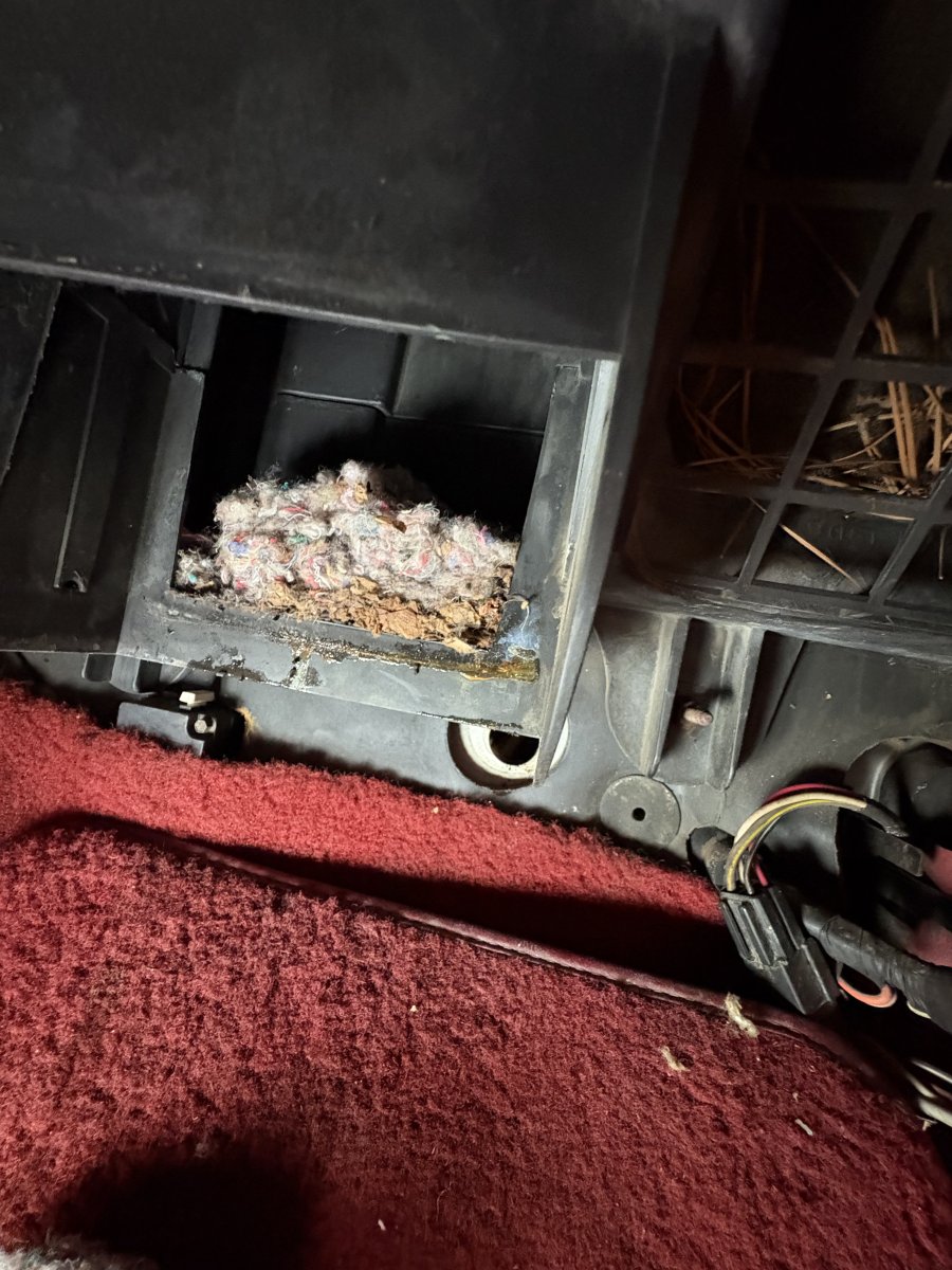

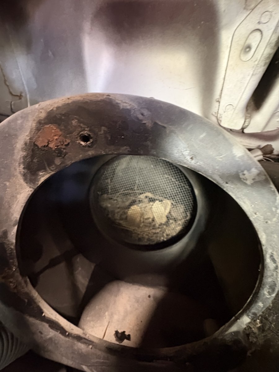

I removed my Air Filter Bix and the 3 screws to get blower motor out. More debris. This is why my lever is not moving. Seen it on the Ranger. Will order a new Heater Core.

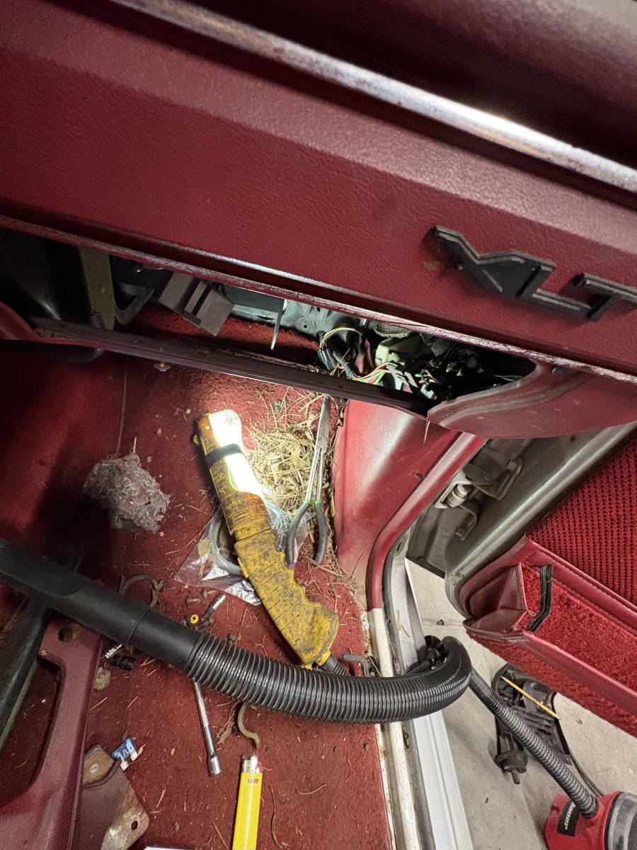

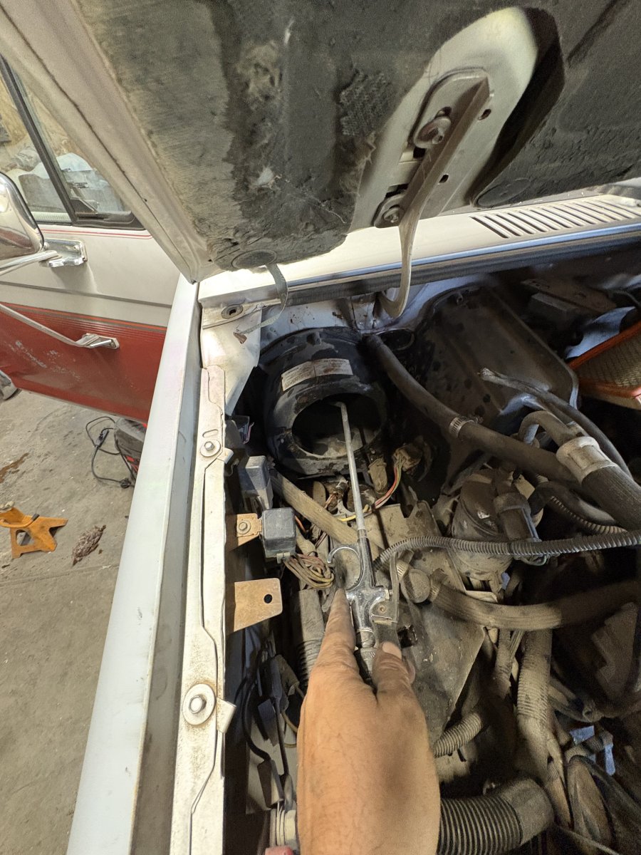

I stick a vacuum cleaner in the passenger compartment and an air gun thru blower motor. You could rip out screen but I don’t jury rig. Between air gun and vacuum cleaner just work both sides.
More trash from core area.
Vacuum Cleaner inside.
I had to use needle nose pliers to pull some trash.
Lower left lever freed. Yea!!!

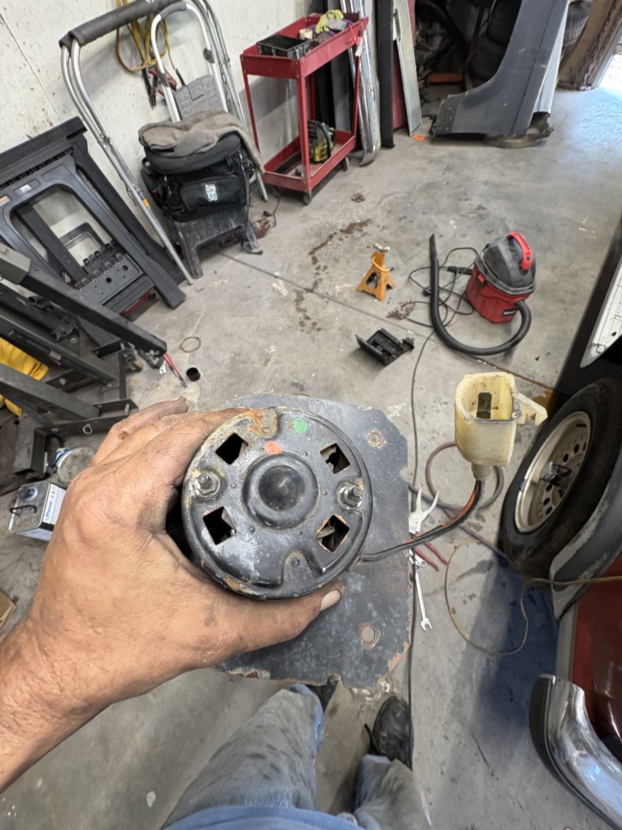

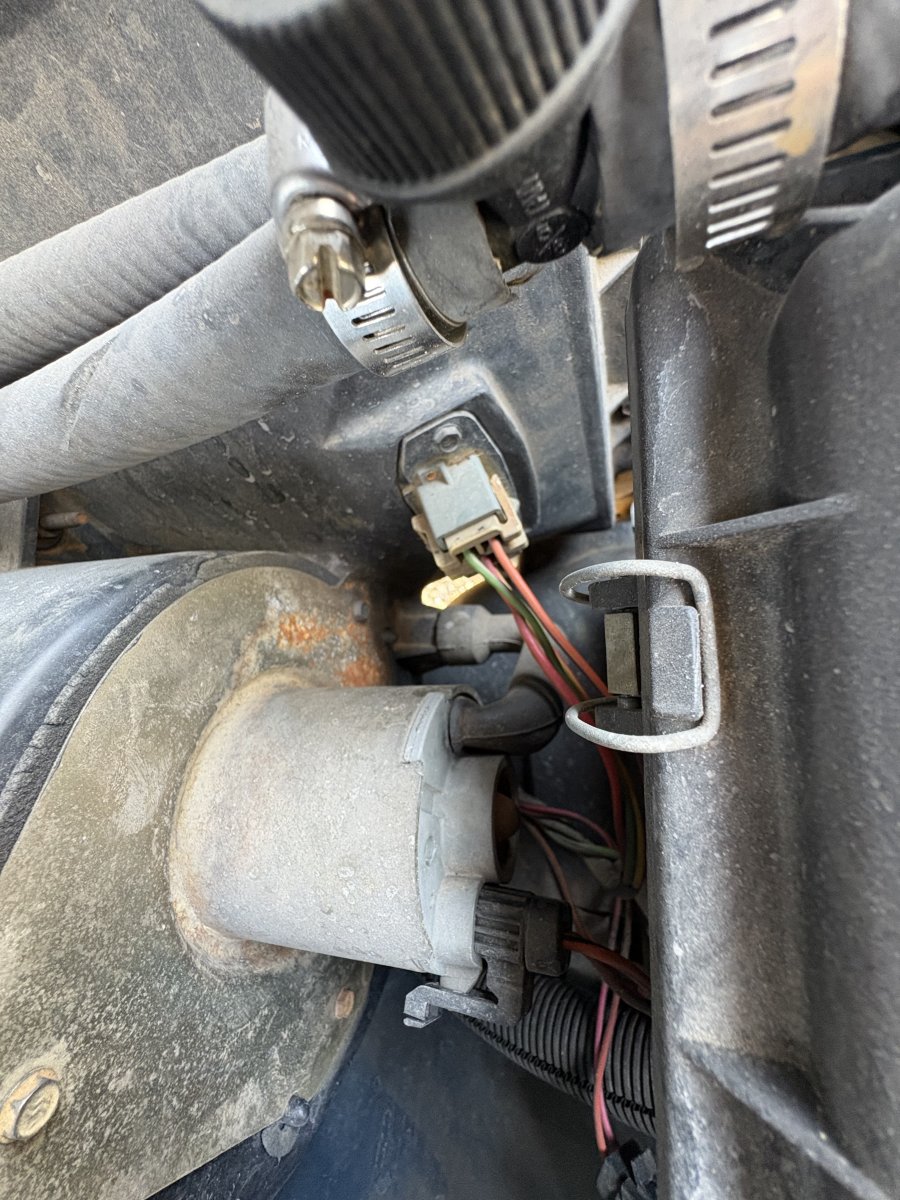

Two 8 mm bolts. Remove blower resistor and get more debris. Mine is in great shape but get these out if bone yard when possible. Not even sure they are available from part store.

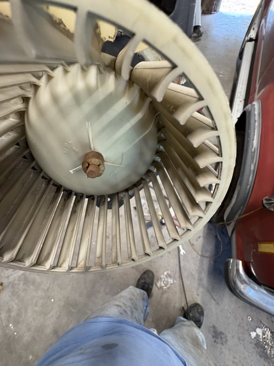

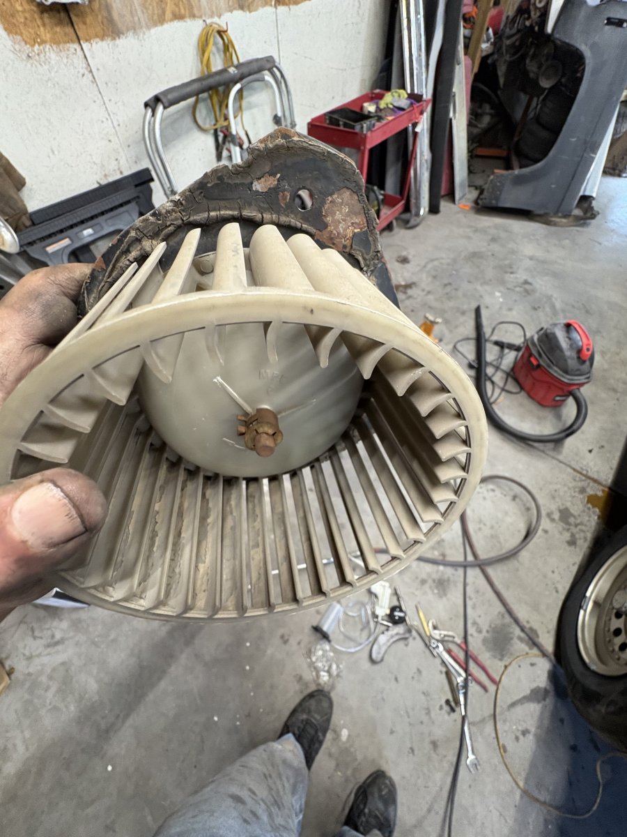

You may not be able to tell in picture but there is a lot of mud built up in each blade.
I took the air gun and cleaned each blade. What a dust storm.

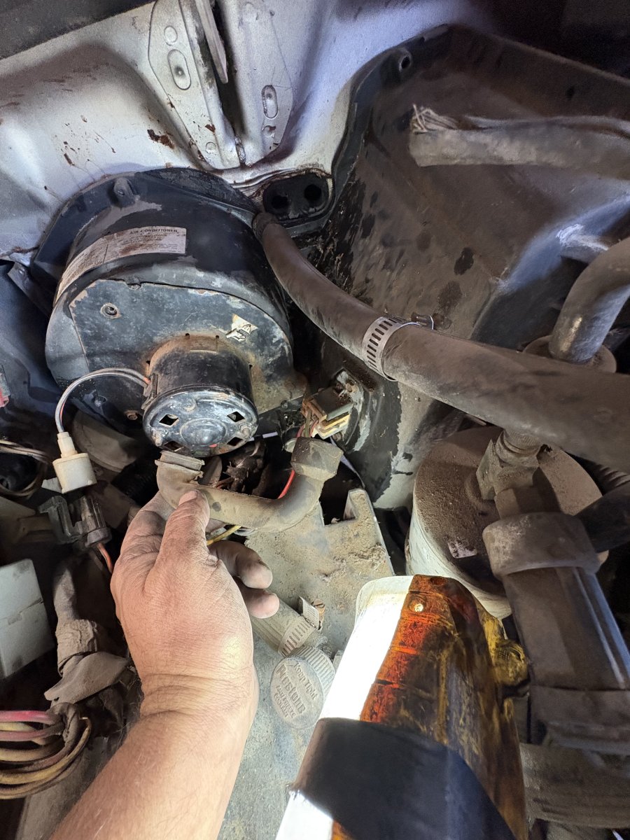

I hope to extend blower motor life and blew what dust I can out if motor. The brushes do wear done and create dust.
Thus is an aftermarket blower. The rubber tube should connect to the blower and also connector is not factory
Here is factory. No big deal. Factory actually runs dust back into system.

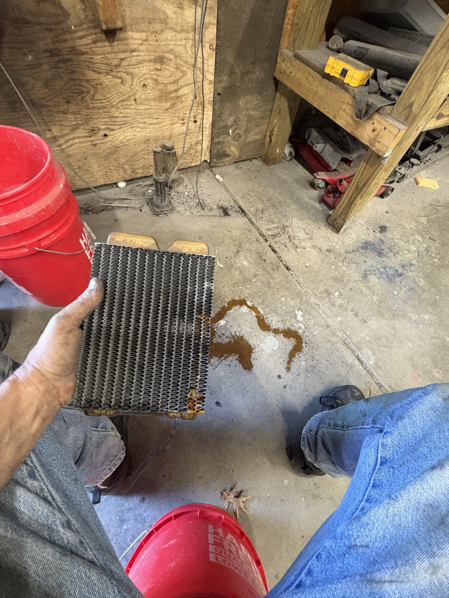

I just ordered a heater core and driver window motor. I can hear it run but nothing. Cheap enough from rock auto so will just replace it. Passenger side not working. I will look into it later. No one still around to pump brakes to find leak so I guess I will get onto valve covers and then plugs, wires, cap, rotor. Break is over, I had another cup of coffee. so excuses are done. Back at it. Still a couple of wins. Windshield pump motor now works, front brakes will work, and trash removed form blower that the lever is working.

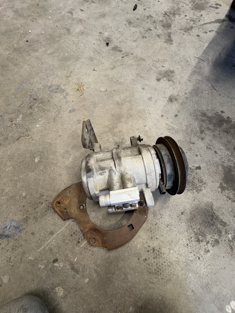

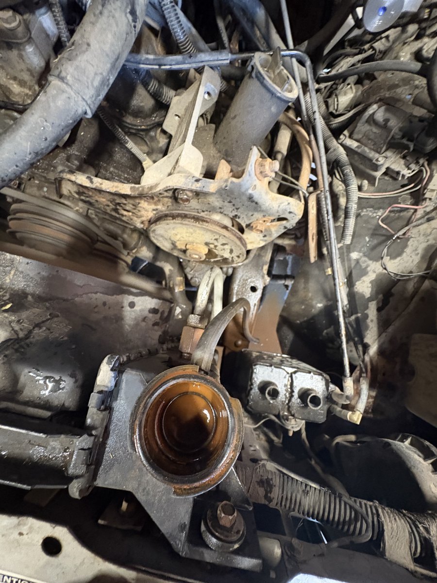

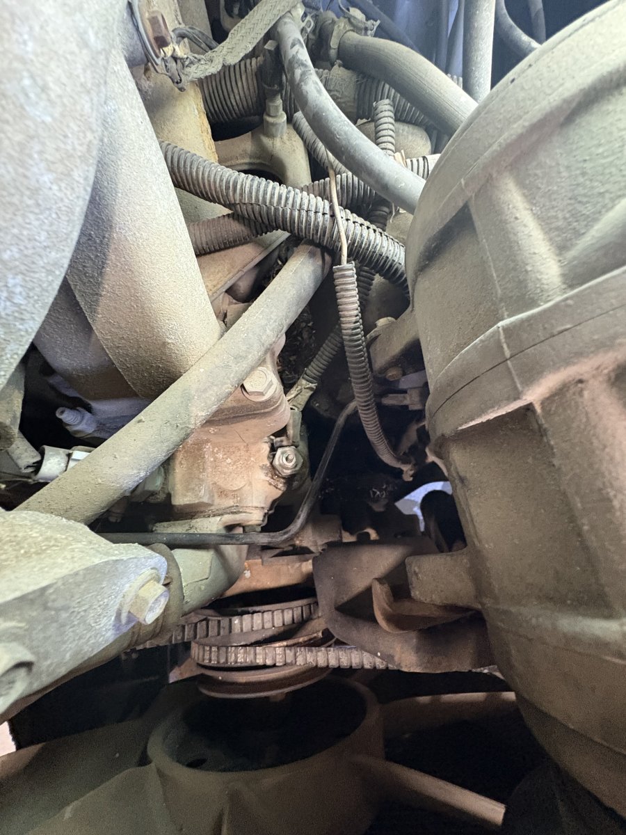

Trying to get AC Compressor took way to long. There has to be an easier way.

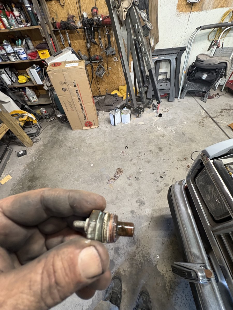

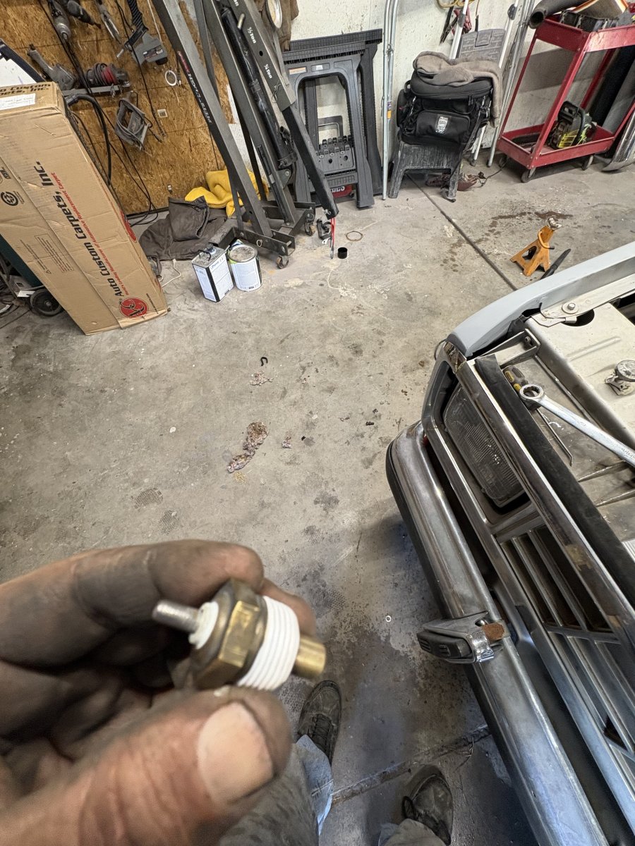

Instead of getting frustrated I go for a simple accomplishment. Usually a solid brass sensor just needs cleaned and doesn’t need replaced but as cheap enough I will probably replace at a later time.
A 17mm deep well works great.
Cleaned with a wire brush.

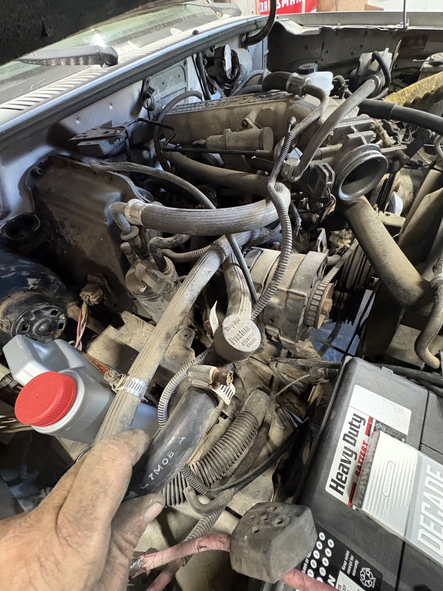

Since I am not going to get valve covers replaced today, I will go with flushing the cooling system. Since I got the heater core pulled, I just looped it around back to water pump.

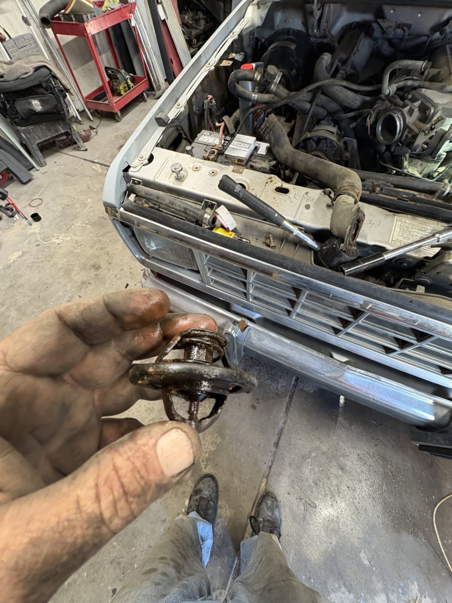

Mostly a reference picture for me to remember the direction of thermostat.
Nasty. Can’t even get the seal off. It was replaced before. I am leaving thermostat out to flush cooling system. Truck starts really quick.

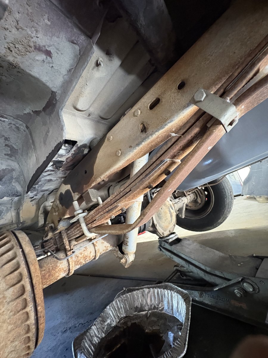

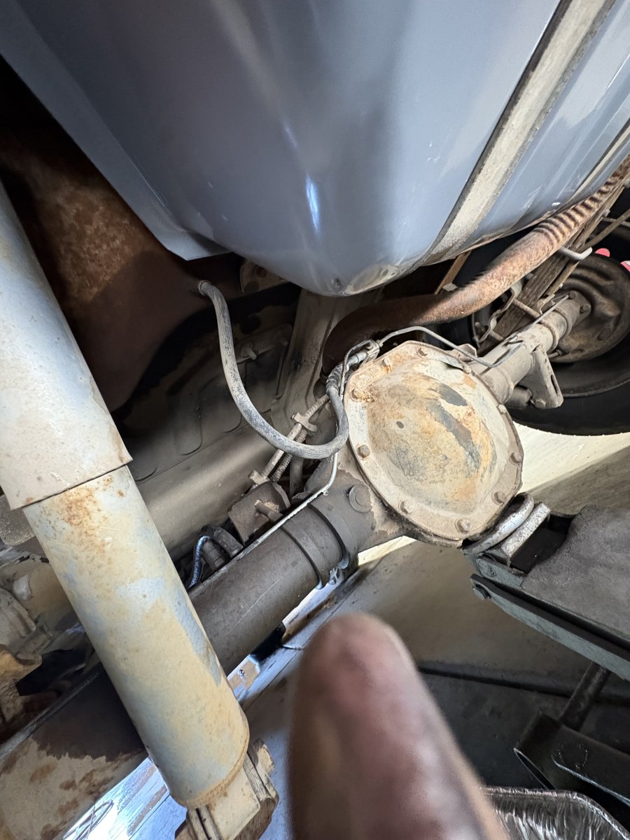

I have never seen helper springs like these before. It is an add on. These to carry more weight for towing?

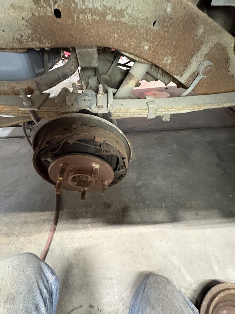

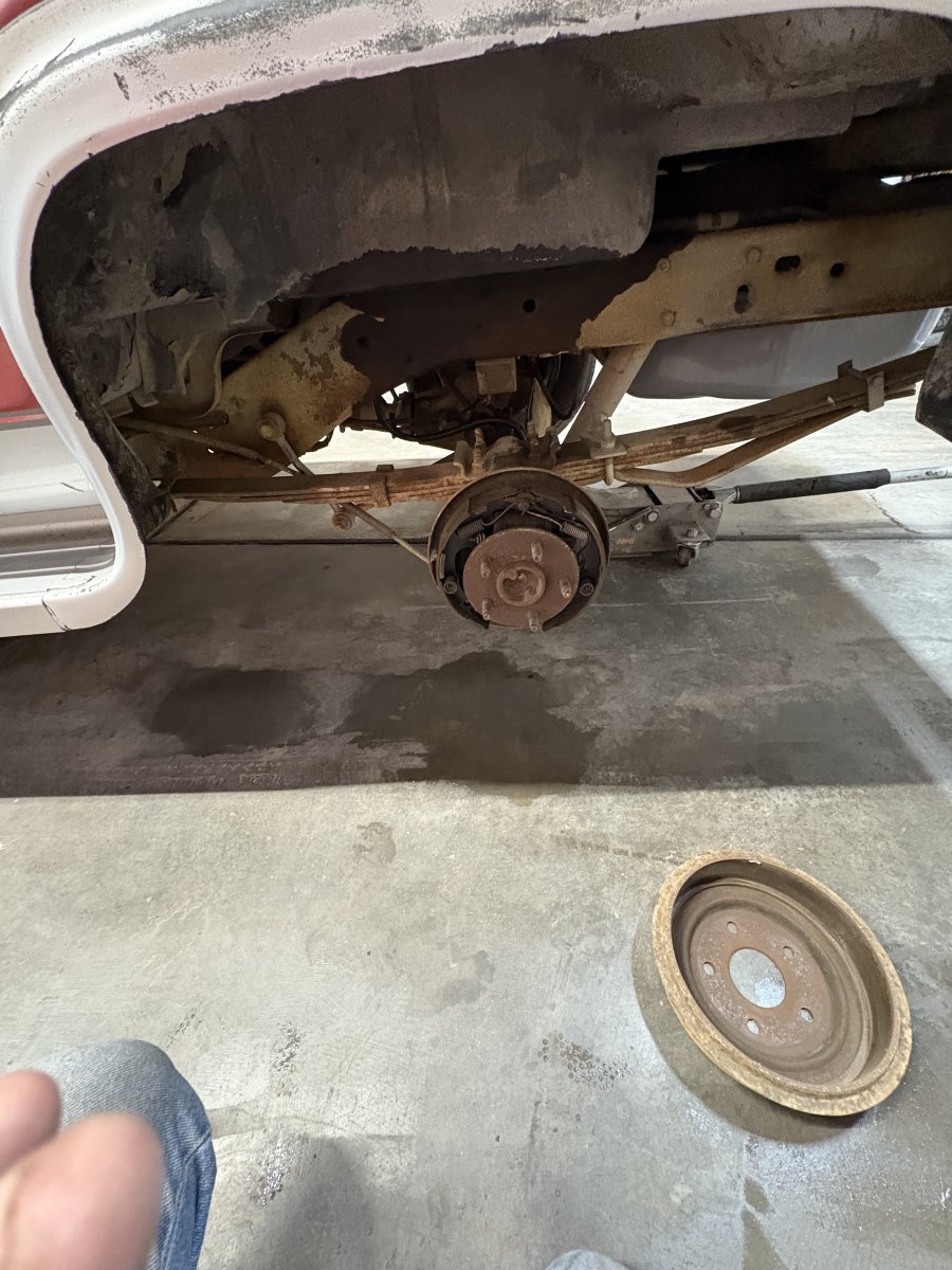

I left the shop last night concerned I had a bigger issue ahead of me. Luckily I think it was just the passenger brake holding the truck down. Drivers hub looks ok. I eventually will do a complete brake rebuild. Right now I need it movable around the house.
Passenger side has pad missing and thinking/hoping this was binding axle.
Those do increase the load carry ability. They work. I had them on my 2011 Ranger for a while before I upgraded to heavier leaf springs. I wouldn't use them to increase towing capacity. The loading is different and you still have the same brakes. The abilty to go rarely is a problem when towing. Stopping on the, other hand, is a different story.
