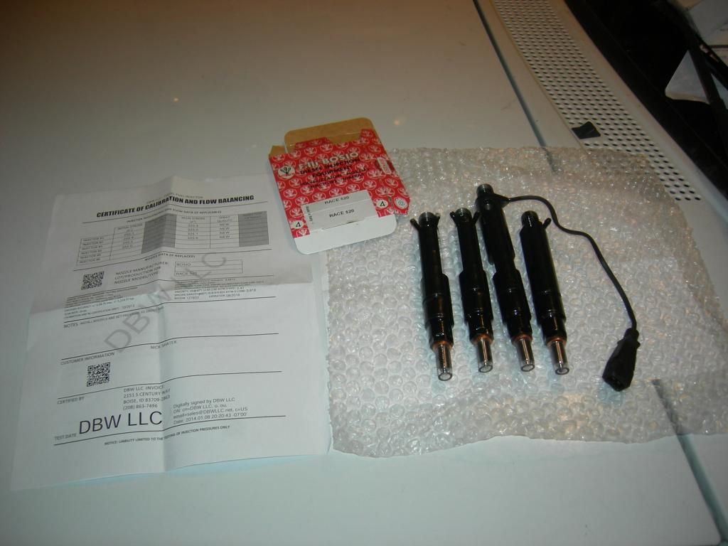

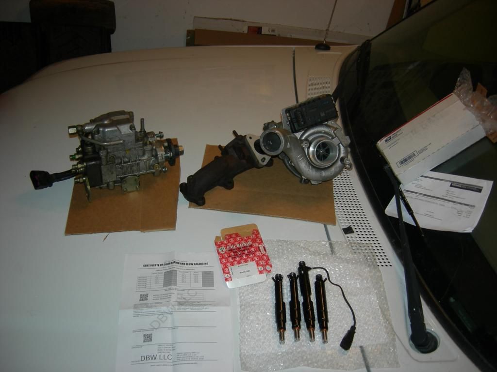

Since I'm out of fuel at the top end my first step is to add fuel and I'm doing this in the form of increased nozzle orifice size. I'll get a retune to pull back the fuel as these nozzles will flow way more fuel than my little vnt15 turbo can provide air. I'll redyno at the same place to see how this improves power....it'll definitely help torque.
Once I've done that I'll get going on installing the rest of this:
Here is quick overview of installing the new injectors/nozzles.
