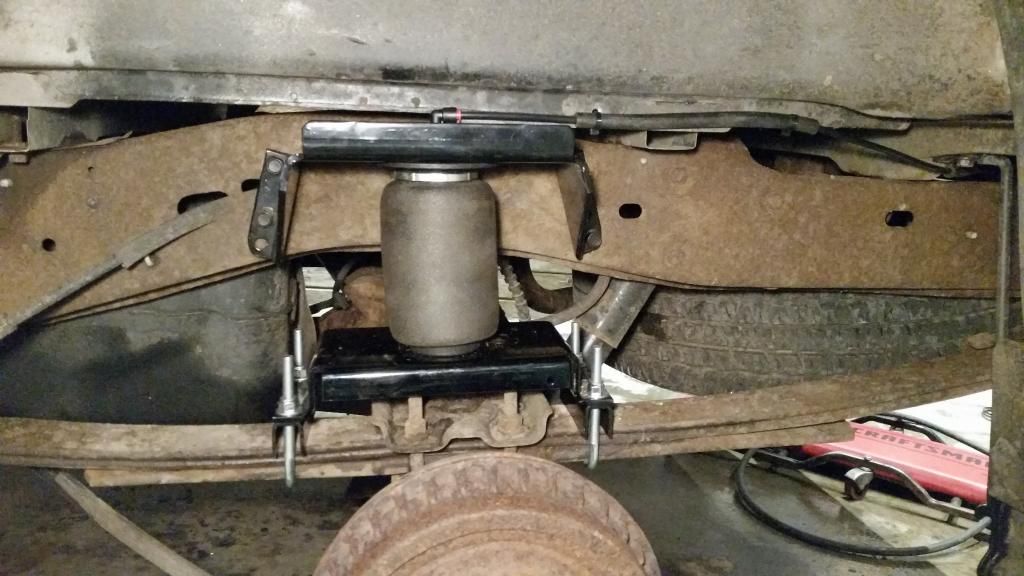

Pictoral update
TDI Ranger Build
TDI Ranger Build
TDI Ranger Build
TDI Ranger Build
TDI Ranger Build
TDI Ranger Build

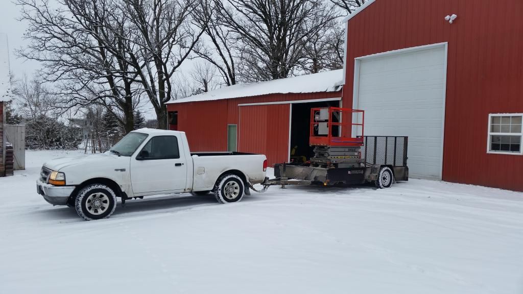

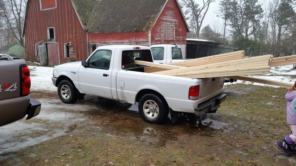

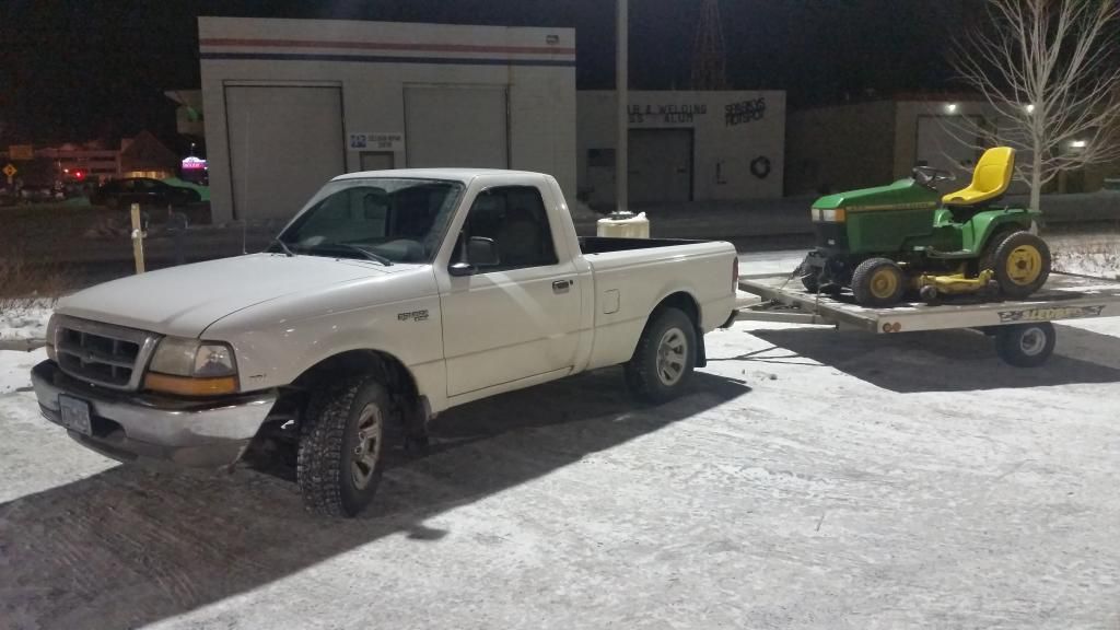

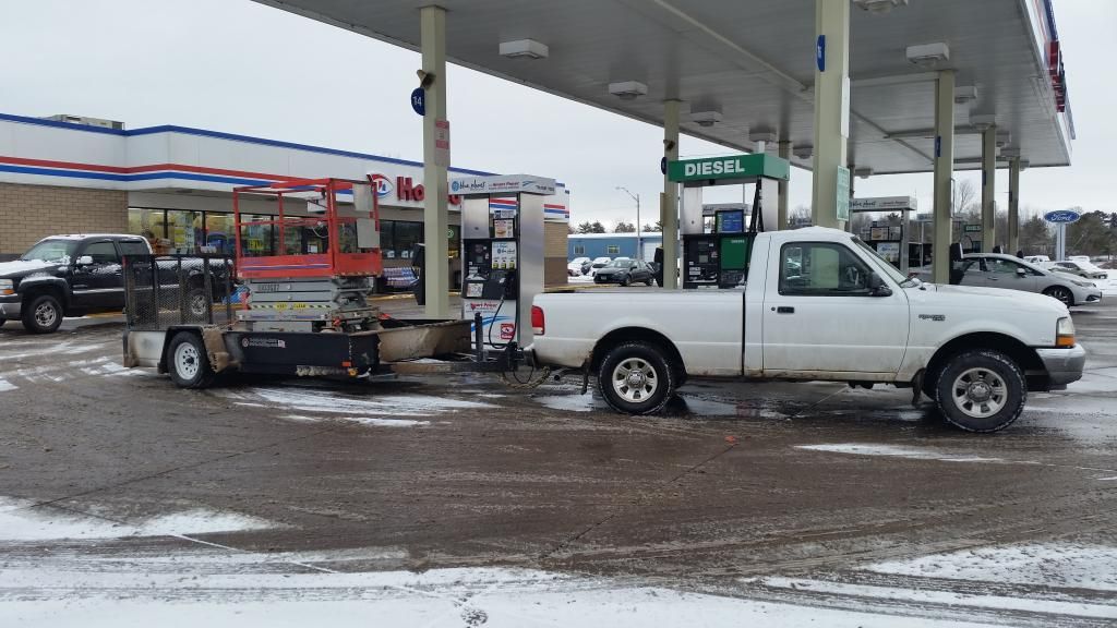

100% towing tank
I've now put on an entire tank of fuel where I was always towing something heavy and/or had terrible aerodynamics (flat front trailer).
Trips on this tank:
  • Two trips towing the scissor lift
  • Four trips using same trailer hauling stuff: building materials and then misc household items (helped someone move some stuff out of their house)
  • Two trips hauling dolly empty
  • One trip hauling Eurovan
  • One trip hauling mk4 Golf
Mileage: 28mpg
I should also note that while towing I was pushing the truck trying to test out my pyrometer. With the EV in tow I was able to rev out to redline (at WOT) through 3rd gear before I was starting to run into EGT issues. I think under these circumstances it hit 1500F (limit on this turbo is 1650). Cruising down the interstate doing 65 I would also hit 1500F after a long grade climb.
