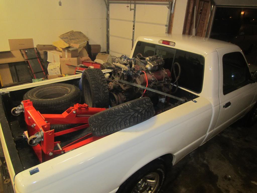

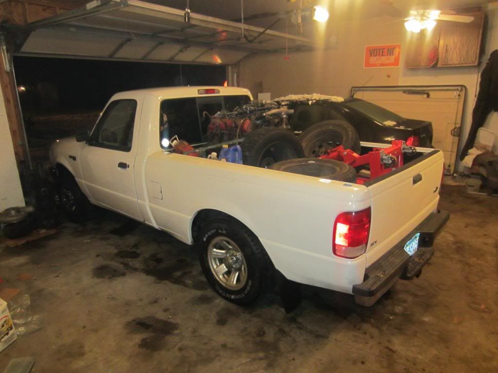

For fun, a shot of its current load: 6.2L long block, cherry picker, tdi short block, 15gal of coolant, and a set of snow tires.
lol
the starter for the 6.2 is bigger then the 1.9....and has more hp then the 6.2 it starts:icon_rofl:
