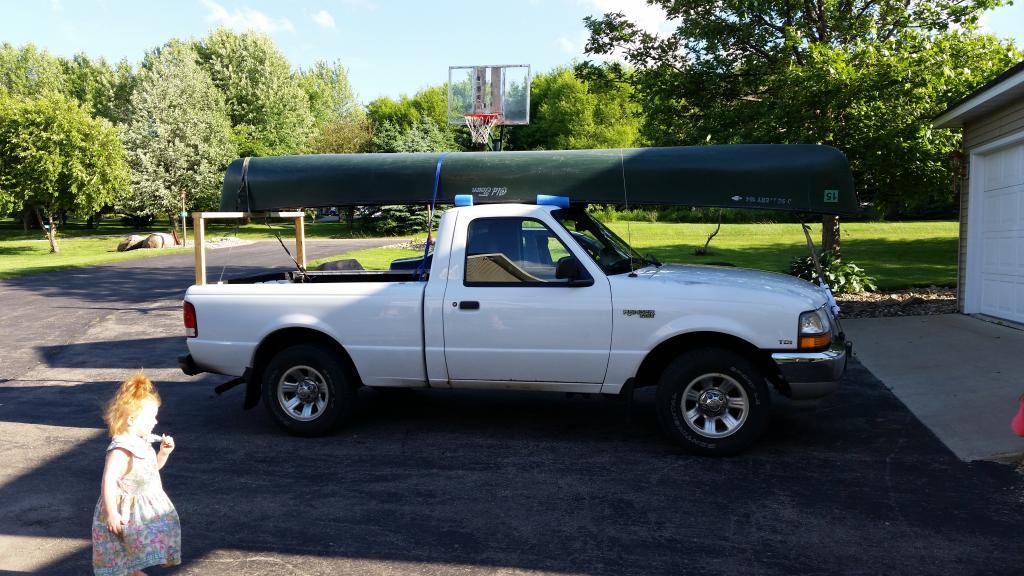

1 year update
I finished the truck as a Father's Day present to myself in 2013 so I've just surpassed the 1 year mark.
TDI Ranger Build
I've been very happy with the results of the swap. Every time I get in the truck I enjoy the work and time I put into the effort. I've been keeping track of every drop of diesel put in the truck and at just under 10k miles I'm averaging exactly 38mpg and keep in mind I've used this truck as a truck.
