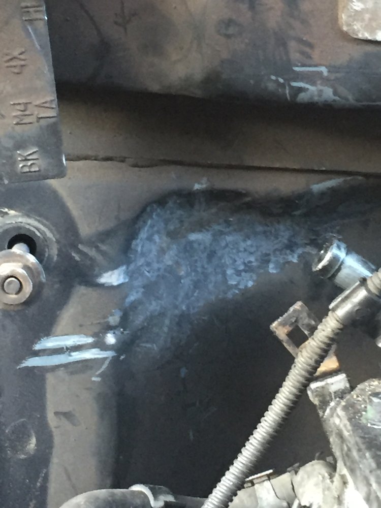

I swapped an ALH into an 87 XLT Super cab. The engine fit between the stock x member & hood with sagging original body mounts with @ 1/2’’ clearance to the x member. The only 2 clearance issues i ran into were at the firewall and steering box. I pounded the firewall for clearance and cut the stock a/c bracket off & ground down the flashing for Steering box clearance. In 70k miles is has not rubbed once.

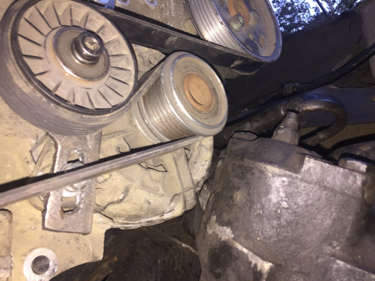

The crappy part here is that the power steering box has to come out to replace the alt. I would recommend a new alternator while the engine is out.
